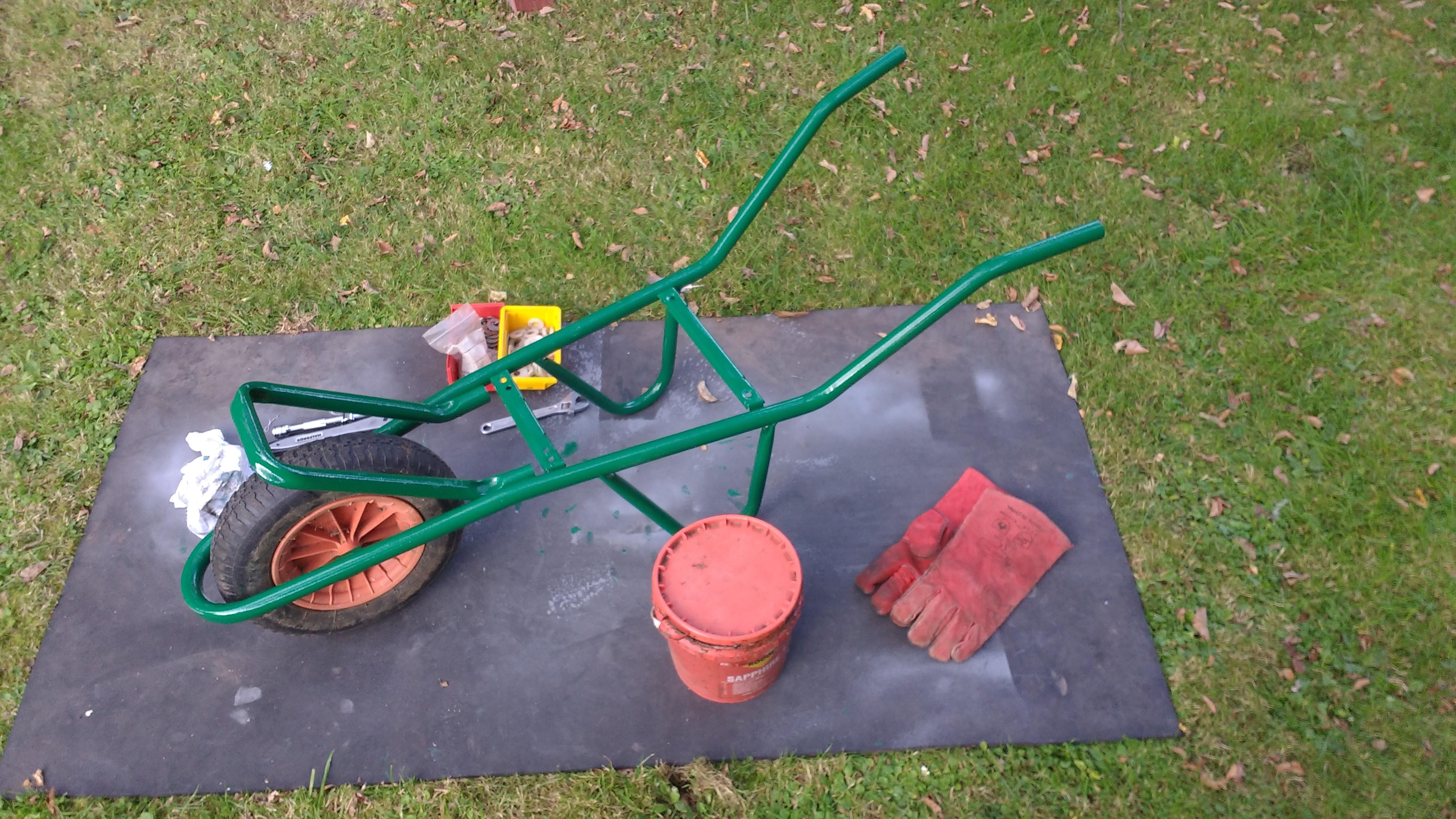

Onoff Posted August 23, 2019 Posted August 23, 2019 (edited) My trusty albeit much abused wheelbarrow. Rotary wire brushed and flap disc'd the frame. Got No2 daughter to etch prime it with a rattle can yesterday. Then in a big clear up I came across some green gloss paint left by the previous owner. Opened it up to an oil slick on top. Mixed it up and it was lumpy like porridge! Today I stuck it through a kitchen sieve (sanctioned) and employed some slave labour: But what to do with the old galvanised tub? It's rotted thru at 4 points. Let's be honest, cutting out a rectangle and TIG welding a new panel in is overkill. Thinking just 4 big square washers maybe bonded with CT1? Quick rotary wire brush and galvanising spray underneath: Edited August 23, 2019 by Onoff 3

PeterW Posted August 23, 2019 Posted August 23, 2019 Isn’t that where the bolts for the frame go, so a couple of penny washers and a coach bolt through the frame on each one .??
Onoff Posted August 23, 2019 Author Posted August 23, 2019 25 minutes ago, Temp said: Two big "washers", one either side with a bolt. Perhaps loads of polyurethane based glue to prevent water being trapped between washers and barrow? Was debating Starretting some round washers o/of stainless steel. It's either that or some mild steel. I've not got any Zintec. Was half thinking to do that then seal up all the other holes with CT1 and pour in my citric acid mixture to get rid of the rest of the rust...
Onoff Posted August 23, 2019 Author Posted August 23, 2019 2 minutes ago, PeterW said: Isn’t that where the bolts for the frame go, so a couple of penny washers and a coach bolt through the frame on each one .?? Yep the holes are probably about 1" dia. It's rusted where the original washers were. Had to cut all 4 original bolts out.

Onoff Posted August 24, 2019 Author Posted August 24, 2019 (edited) 8 hours ago, Temp said: Or something like zinc plated "plate washers"... https://www.gsproducts.co.uk/bzp-square-plate-washers/ Did think of those but maybe a bit thick if I'm shovelling stuff out of the barrow as in the blade will catch. Thin sheet plus dome headed coach bolts will give me the best chance I reckon. Edited August 24, 2019 by Onoff
PeterW Posted August 24, 2019 Posted August 24, 2019 In that case just dish the metal a bit around the washers ..?? Should recess them enough.

Onoff Posted August 24, 2019 Author Posted August 24, 2019 3 minutes ago, PeterW said: In that case just dish the metal a bit around the washers ..?? Should recess them enough. If you zoom in on the picture above it looks like the cross bars on the frame are themselves pressed/recessed to receive the pulled down tub. Maybe one penny washer in the recess then another to take up the lost thickness of steel then the big disc washer.
