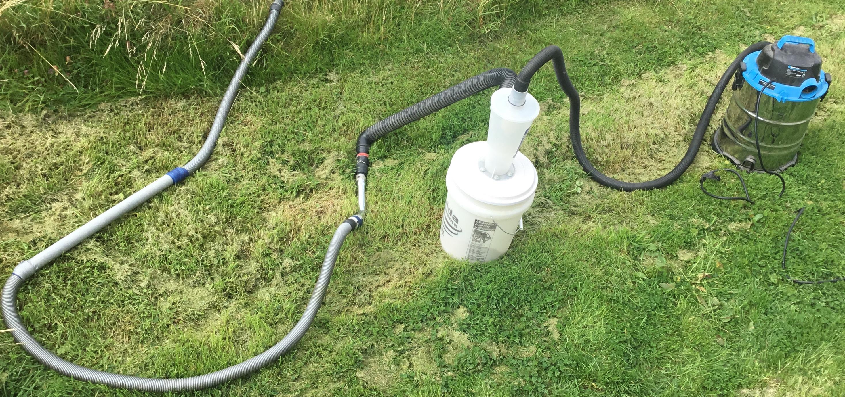

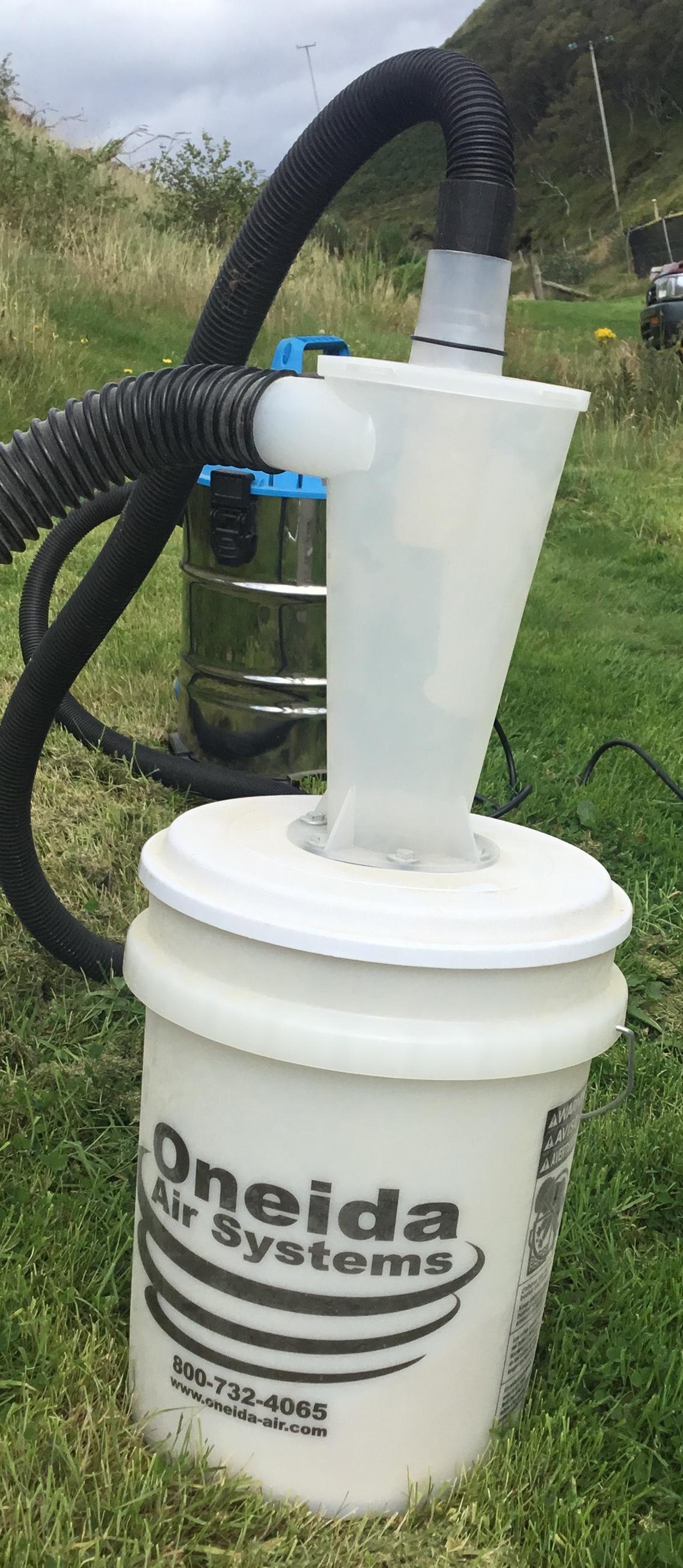

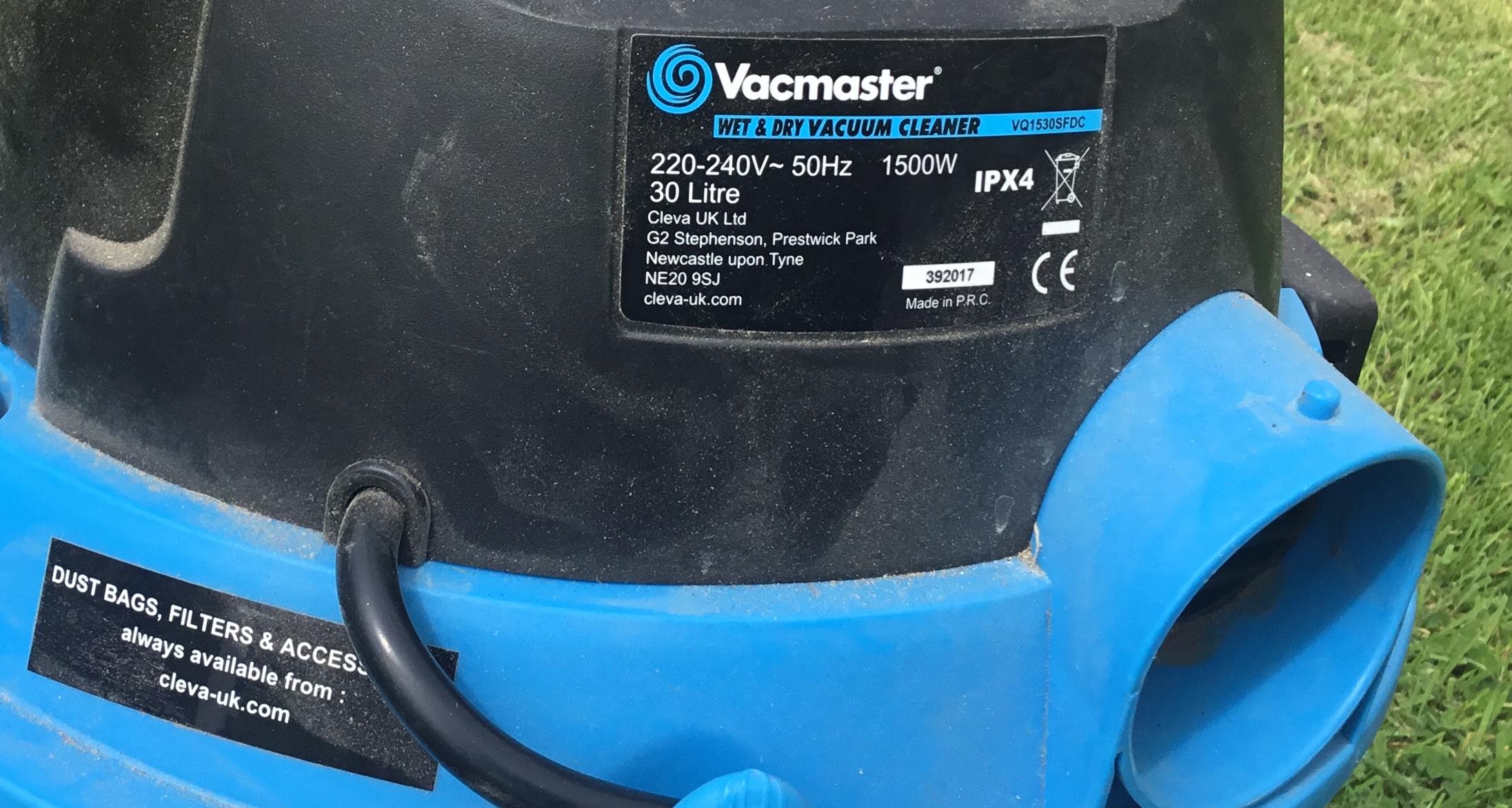

Cpd Posted August 23, 2019 Share Posted August 23, 2019 I have got one of these, the GREAT thing about this is that it blows or sucks and has a power take of for hooking up small tools like sanders, planers etc so it comes on automatically when the sander is switched on. I use it on my big table saw and for sucking up building waste and sawdust. The Amazing bit of plastic / drum (buy from Rutlands or some other place but there one is great as you can see when it’s full and if it’s working) Is what goes between the hoover and the the sucking end, it collects about 98% of all the stuff so you NEVER need to replace bags ! It has saved me a fortune and is one of my best bits of kit. I could not be happier with the whole set up, I just join old bits of hose together depending on the job, you can get them for nothing from a dump recycling centre ! Or again buy a hose adapter set from Rutlands or similar. I have put this through it’s paces over the last few years and it’s still on it’s first bag and has never missed a beet. Great kit and I am sure it will do what you need. I have used a whole bunch of hoovers and this one is by far the best I have got. 2 Link to comment Share on other sites More sharing options...

nod Posted August 23, 2019 Share Posted August 23, 2019 3 hours ago, Cpd said: I have got one of these, the GREAT thing about this is that it blows or sucks and has a power take of for hooking up small tools like sanders, planers etc so it comes on automatically when the sander is switched on. I use it on my big table saw and for sucking up building waste and sawdust. The Amazing bit of plastic / drum (buy from Rutlands or some other place but there one is great as you can see when it’s full and if it’s working) Is what goes between the hoover and the the sucking end, it collects about 98% of all the stuff so you NEVER need to replace bags ! It has saved me a fortune and is one of my best bits of kit. I could not be happier with the whole set up, I just join old bits of hose together depending on the job, you can get them for nothing from a dump recycling centre ! Or again buy a hose adapter set from Rutlands or similar. I have put this through it’s paces over the last few years and it’s still on it’s first bag and has never missed a beet. Great kit and I am sure it will do what you need. I have used a whole bunch of hoovers and this one is by far the best I have got. Amazing bit of plastic Love it Link to comment Share on other sites More sharing options...
ToughButterCup Posted August 23, 2019 Share Posted August 23, 2019 With the prices Bosch charge for filters.... No brainer Link to comment Share on other sites More sharing options...
Cpd Posted August 23, 2019 Share Posted August 23, 2019 It’s easily saved me a few hundred pounds already, I have one of these plastic cyclone heads mounted on a 200 litre drum that’s dedicated to the table saw as this produces a lot of sawdust when your ripping stuff down, again the sawdust NEVER gets near the bag ! It’s like magic !!!! Also have another one dedicated to the router table ...... when you own one you will just wish you had another...... Link to comment Share on other sites More sharing options...

scottishjohn Posted August 24, 2019 Share Posted August 24, 2019 (edited) 16 hours ago, Cpd said: It’s easily saved me a few hundred pounds already, I have one of these plastic cyclone heads mounted on a 200 litre drum that’s dedicated to the table saw as this produces a lot of sawdust when your ripping stuff down, again the sawdust NEVER gets near the bag ! It’s like magic !!!! Also have another one dedicated to the router table ...... when you own one you will just wish you had another...... looks good --only comment would be its not very compact +portable the first filter in the trend ,which is cloth bag just blows out or knocks out --paper filter never got bocked yet --same again blow out with air line or knock it on ground my brother -- being an idiot used it to suck up plaster dust -- that then set in cloth filter and required changing then - If he had emptied it whe he had finished quite sure the plaster would have blown out as well -- but a year later --no chance Edited August 24, 2019 by scottishjohn Link to comment Share on other sites More sharing options...
