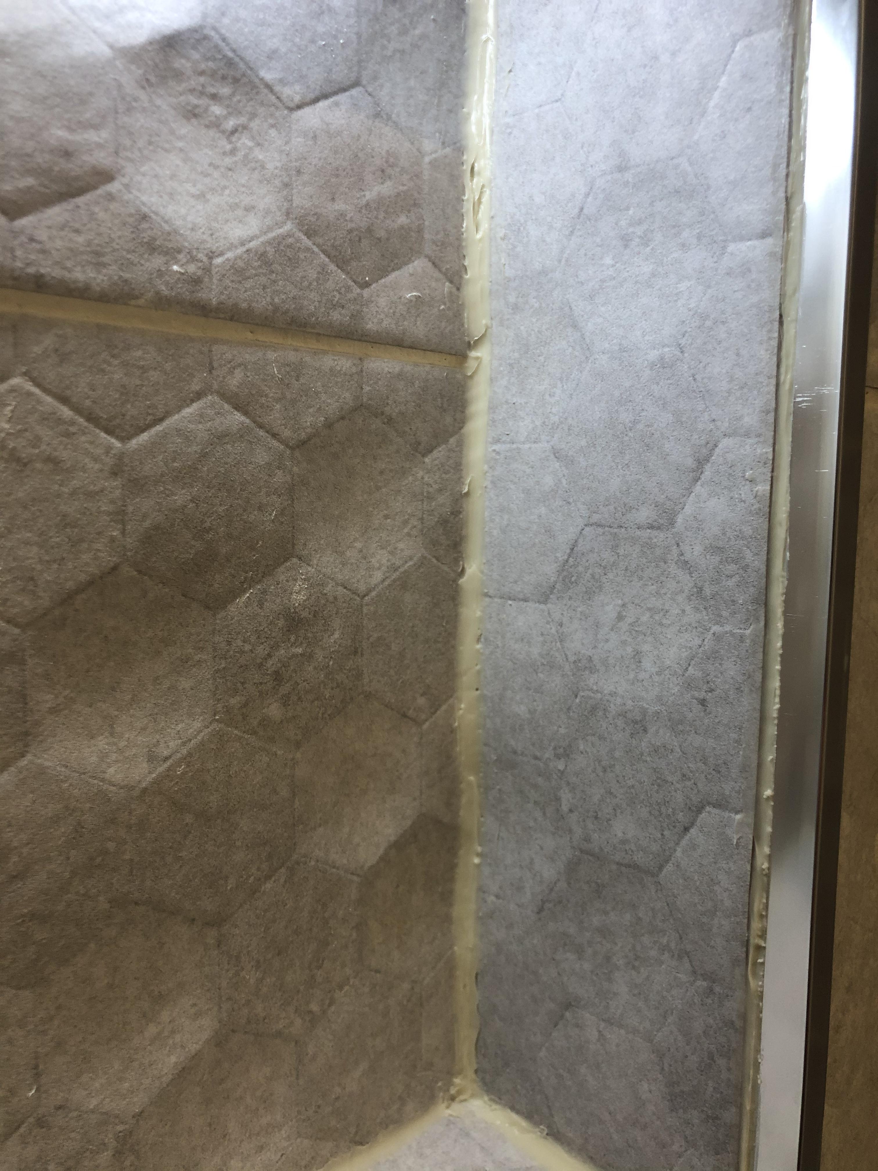

Pocster Posted December 2, 2020 Author Posted December 2, 2020 8 hours ago, Nickfromwales said: If this is your first baptism-of-fire tiling job and you have turned out something that looks like that ( regardless of how much filing and dremel work you did ) then you should be standing 10 feet tall my strange avatar’d friend. ?? Have a beer on me, at your expense Thanks Uncle Nick . Technically my 2nd attempt . Things I much prefer are flat tiles I.e not bloody textured and this wedge levelling system . Out of interest I looked at recesses on Pinterest . Lots of high spec bathrooms there ! . Over 50% easily didn’t seem to bother about lining tiles up exact with recess . Some are truly awful . Spewy green only half the issue here .....
Bitpipe Posted December 2, 2020 Posted December 2, 2020 My tiler had OCD, the way he lined up the recessed flush plates with the rest of the tiling is a thing of beauty.
Pocster Posted December 2, 2020 Author Posted December 2, 2020 Just now, Bitpipe said: My tiler had OCD, the way he lined up the recessed flush plates with the rest of the tiling is a thing of beauty. That wasn’t one of his above then ??

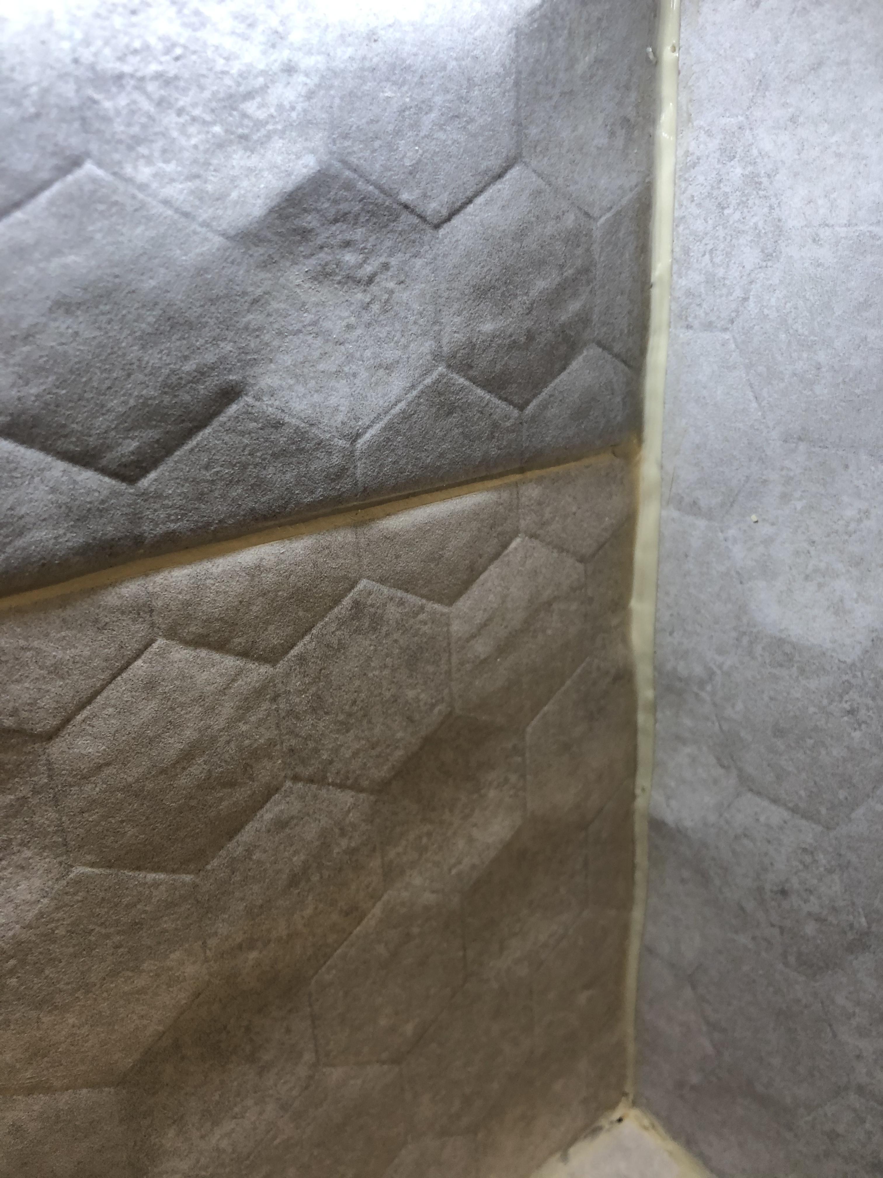

Bitpipe Posted December 2, 2020 Posted December 2, 2020 On 24/11/2020 at 08:56, pocster said: Here we go Looks ok from a distance . Some Mastik lines more acceptable than others ... This looks like a 1980's Tardis interior. 1
Pocster Posted December 2, 2020 Author Posted December 2, 2020 42 minutes ago, Bitpipe said: This looks like a 1980's Tardis interior. It is a bit tardis ! Horrible to clean !
Bitpipe Posted December 2, 2020 Posted December 2, 2020 1 hour ago, pocster said: It is a bit tardis ! Horrible to clean ! Dr Who has the same issue. Its why he/she gets through so many assistants.
Pocster Posted December 2, 2020 Author Posted December 2, 2020 Just now, Bitpipe said: Dr Who has the same issue. Its why he/she gets through so many assistants. Probably true . I guess the ‘male’ doctor didn’t have a SWMBO as he gleefully swapped her when the cleaning argument began .

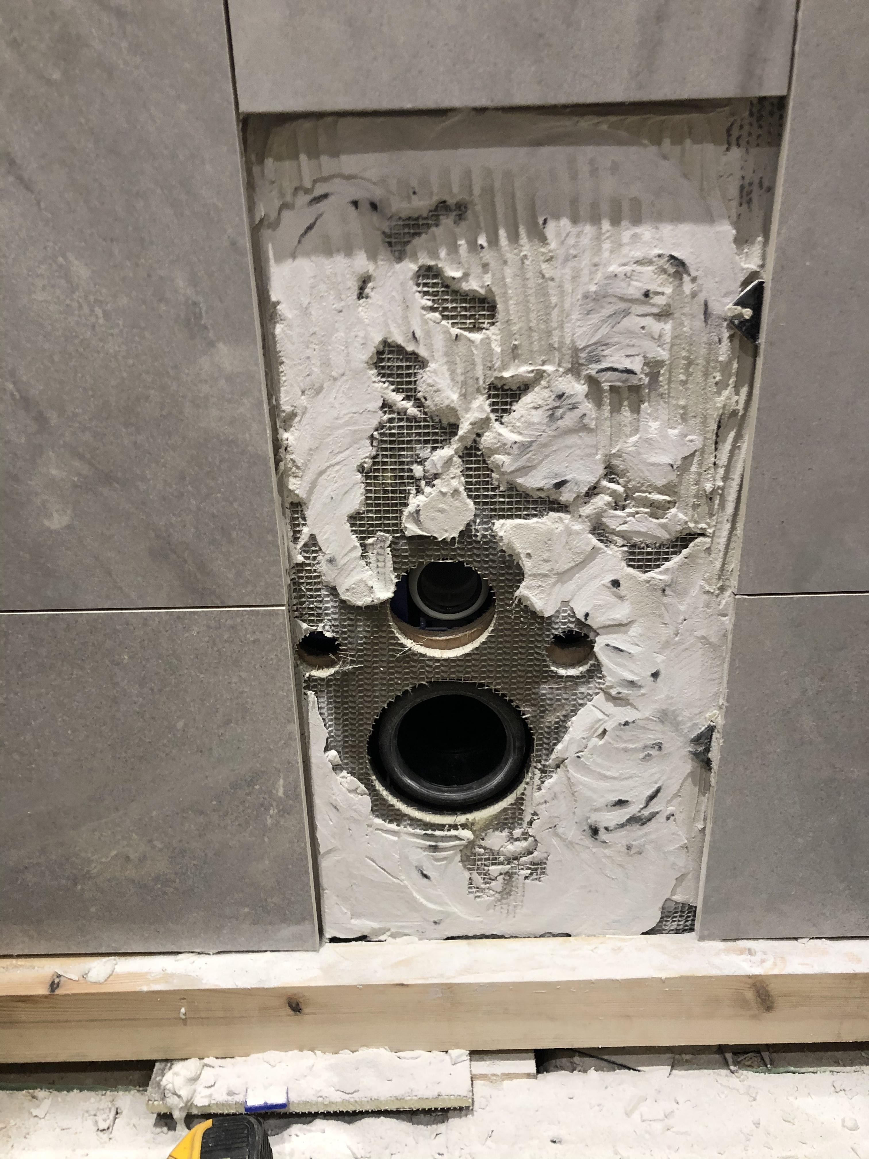

Mr Punter Posted December 12, 2020 Posted December 12, 2020 There is quite a big gap above the flush pipe of the wall hung WC. Offer the pan up to make sure the gap is covered before you grout the tiles. What is the wire at the end of the bath for?
PeterW Posted December 12, 2020 Posted December 12, 2020 6 minutes ago, Mr Punter said: What is the wire at the end of the bath for? Electric fire for heating the bath when he gets in it.... 1 3
Pocster Posted December 12, 2020 Author Posted December 12, 2020 You (expletive deleted)ers ! Talk about shooting me down in flames ! It was a test so I can start tiling the floor I.e pipework I can never get to is leak free . Tiles missing on wall because I ran out - currently on order @Mr Punter you are indeed correct - they don’t give you a lot of room for the inlet - need to replace that tile - thought I checked it but perhaps not ! Cable is a cat5 for bathroom iPad obviously ?

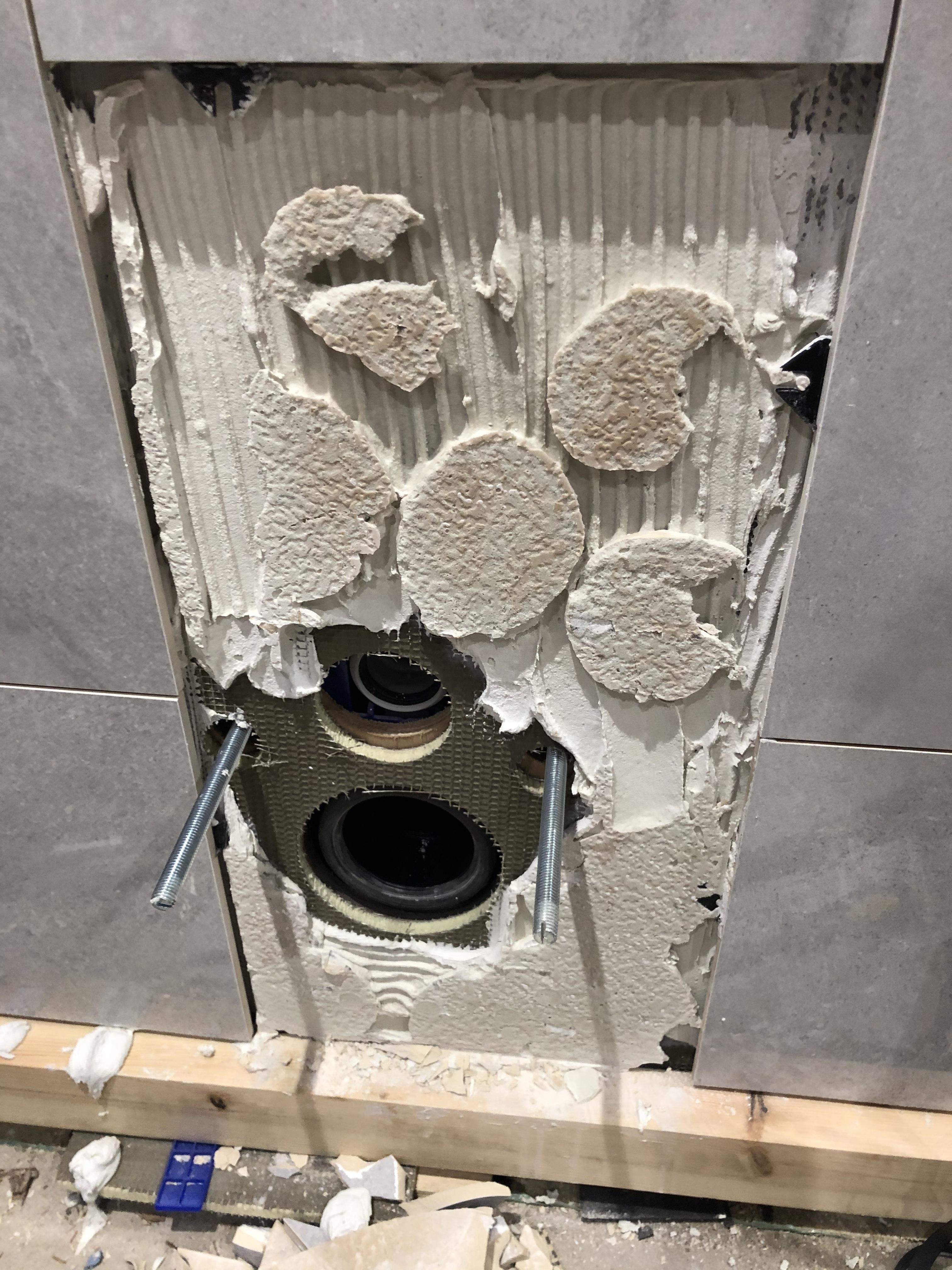

Pocster Posted December 12, 2020 Author Posted December 12, 2020 Right @Mr Punter I’ve got the offending tile off . But I do know from experience getting the adhesive off will just destroy the delta board . What’s the best option here ? ( spoil sport ! )
PeterW Posted December 12, 2020 Posted December 12, 2020 3 minutes ago, pocster said: What’s the best option here ? Multi tool with carbide sanding plate 1
joe90 Posted December 12, 2020 Posted December 12, 2020 20 minutes ago, PeterW said: Aren’t iPads wireless ...?? I thought only android devices had wires..?? it’s so he can charge it whilst bathing ?
Pocster Posted December 12, 2020 Author Posted December 12, 2020 12 minutes ago, PeterW said: Multi tool with carbide sanding plate I’ve chiselled the chunky parts off now will try the tool ! ?
Onoff Posted December 12, 2020 Posted December 12, 2020 23 minutes ago, PeterW said: Multi tool with carbide sanding plate I found the chisel style multitool blade pretty good. I've even ground a sharp edge on some blunted serrated blades. 1
Onoff Posted December 12, 2020 Posted December 12, 2020 46 minutes ago, pocster said: You (expletive deleted)ers ! Talk about shooting me down in flames ! Gentle ribbing is all. It's all coming together, looks really good. 1
Pocster Posted December 12, 2020 Author Posted December 12, 2020 49 minutes ago, PeterW said: Multi tool with carbide sanding plate Only got 1 carbide blade it would seem . Horse shoe shape - so not the best fitting . Coming off though slowly
Pocster Posted December 12, 2020 Author Posted December 12, 2020 Nose full of dust but I think that’s about as good as I can get it ( or tolerate )
PeterW Posted December 12, 2020 Posted December 12, 2020 Make sure when you redo that tile there is a full bed top and bottom of the holes as they take the weight when you sit on the pan and you can crack tiles if they aren’t loaded correctly. 1
