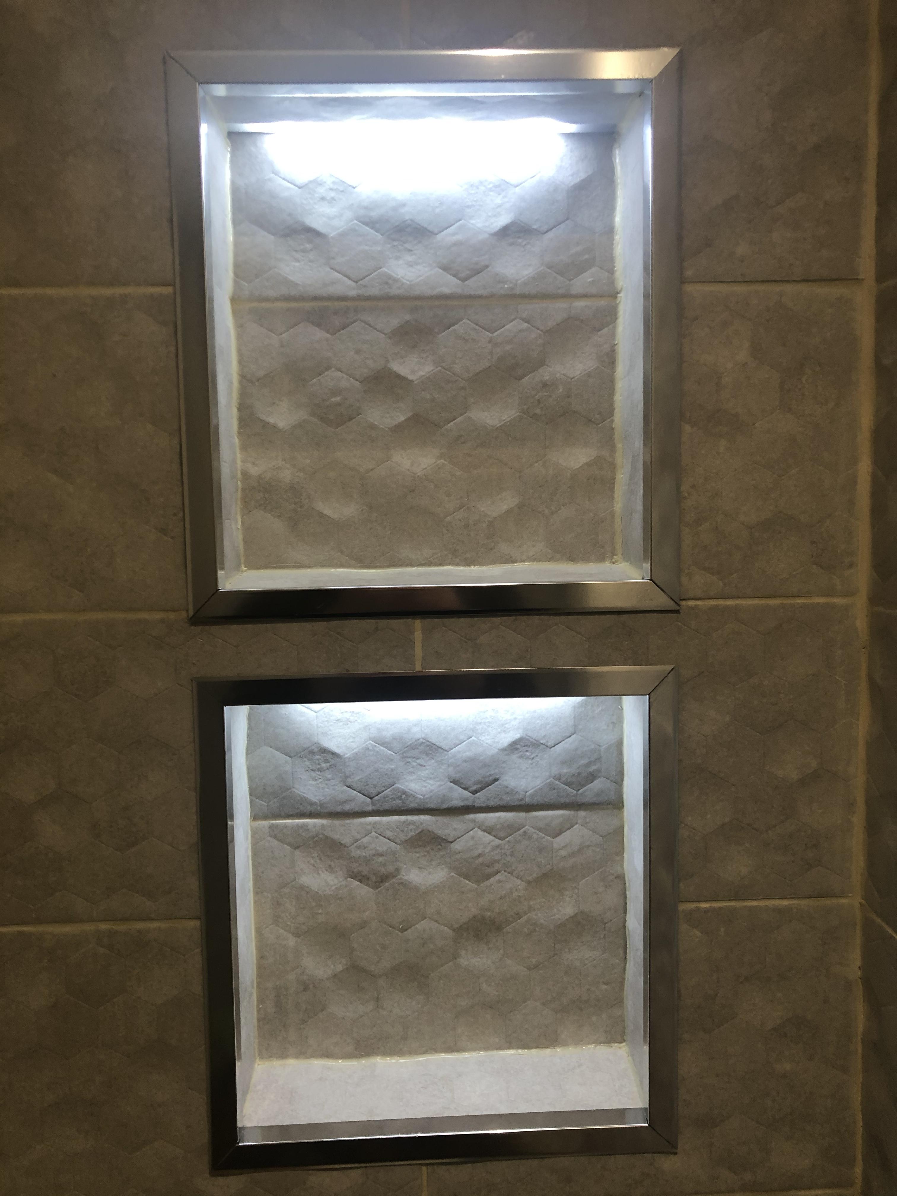

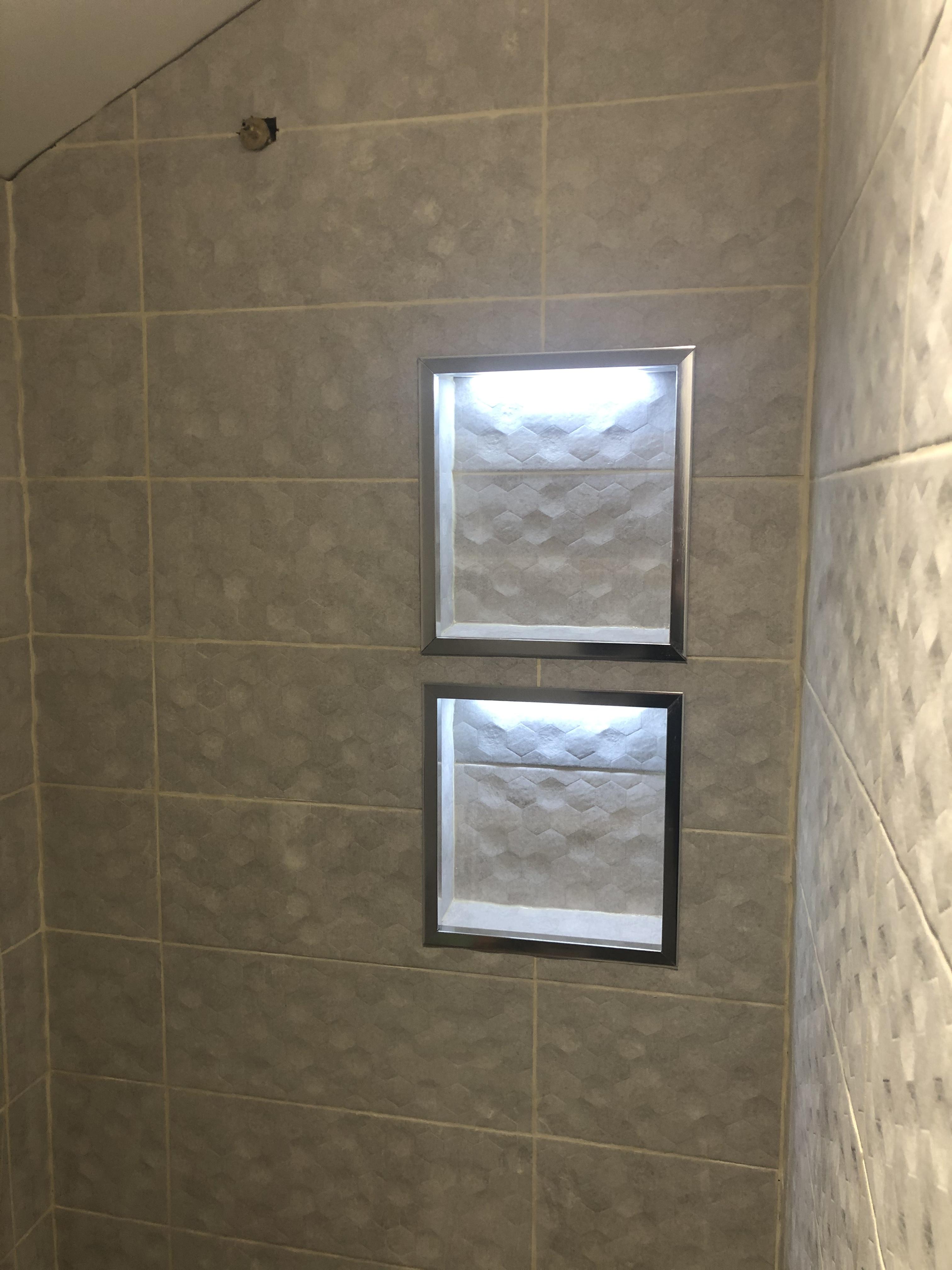

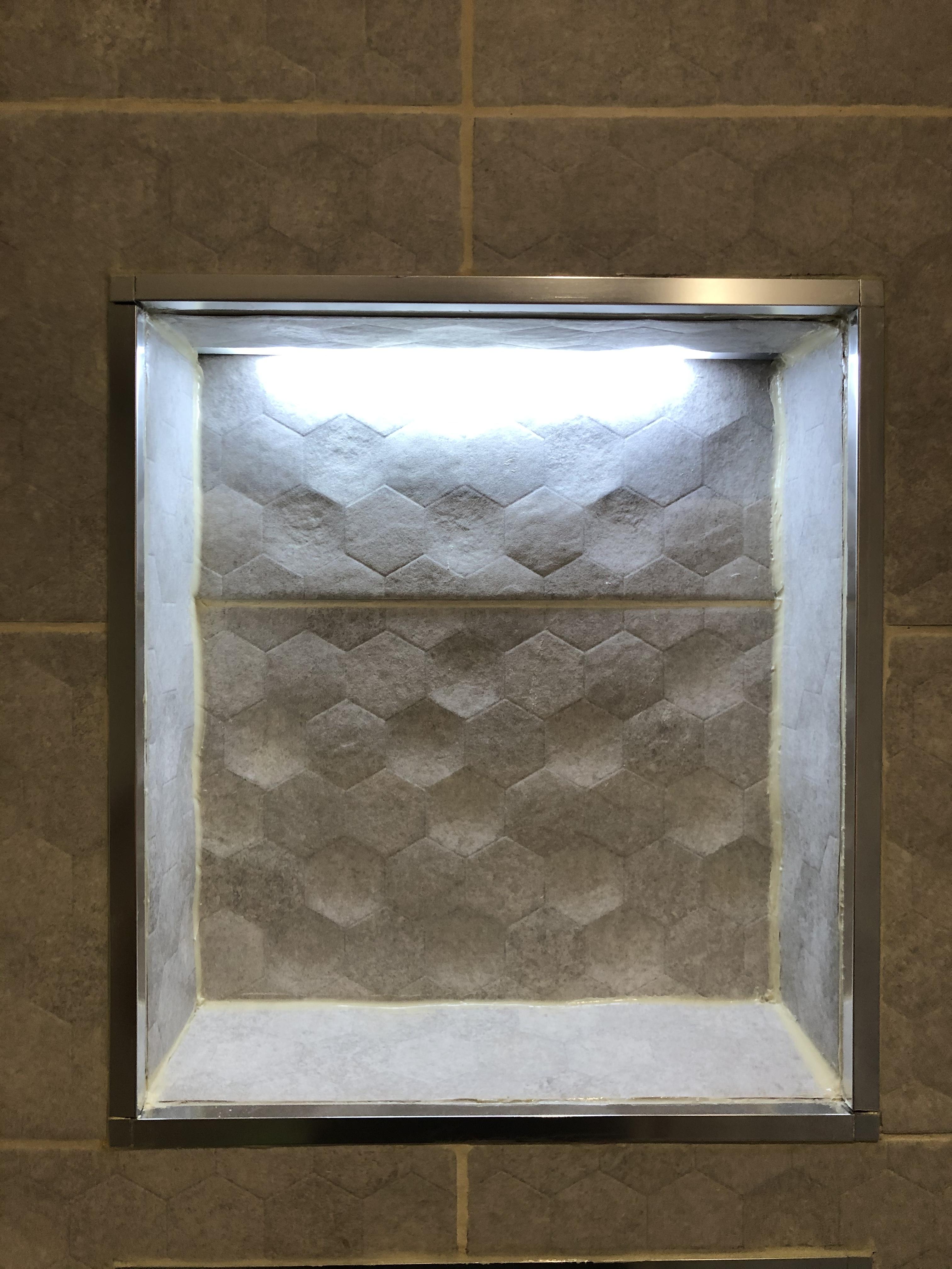

Here we go
Looks ok from a distance . Some Mastik lines more acceptable than others ...

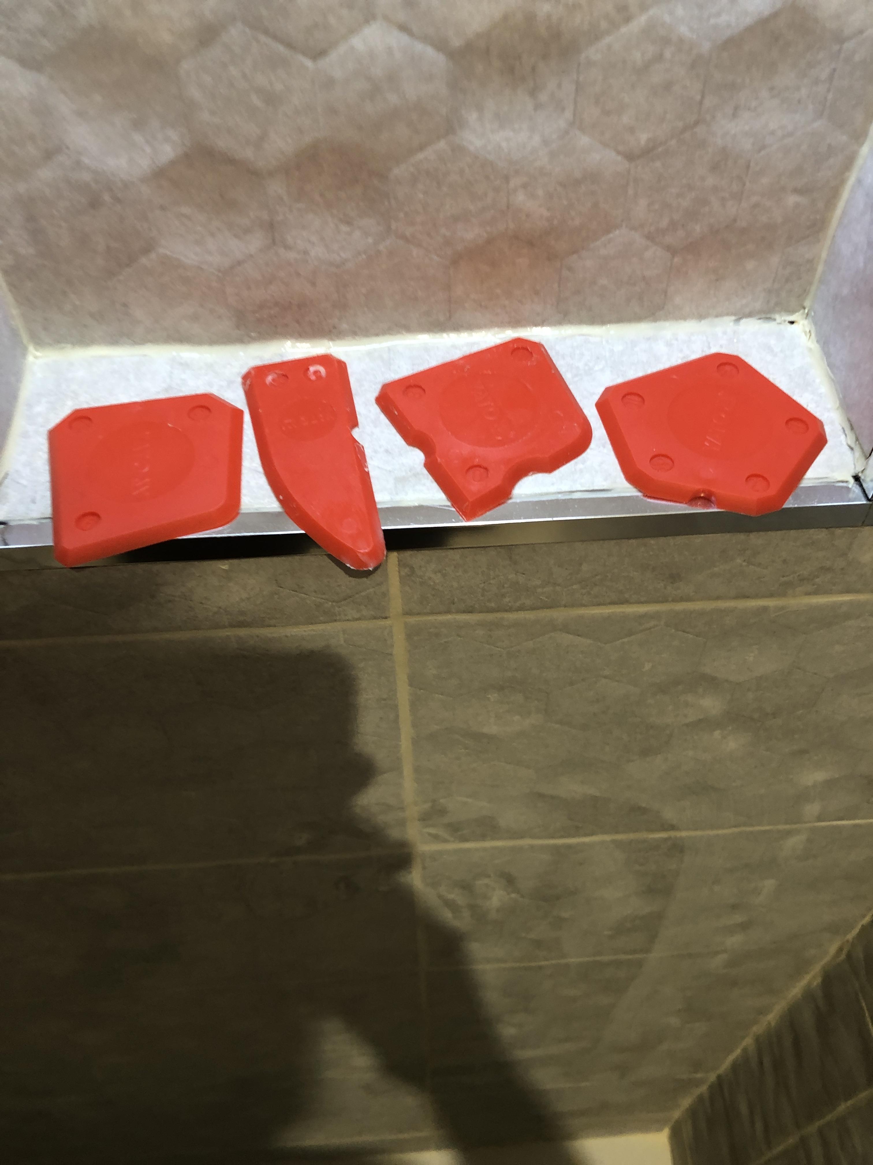

That really is the icing on the ?
Crap tool by the look of it. The real Fugi is a revelation. Made of magic stuff.

It’s a collection of shapes
For the edges I’m definitely go over the expensive bead with the corner protector .
Buy the proper Fugi kit today. I had some similar "shapes" to what you have there. Look and feel similar to the Fugi but they're just not. As I say, something magic about the Fugi material.

Could you.....re tile the back and sides using internal corners, even to the point of CT1'ing new tiles to old. Then use that bfo angle trim on the front?
...re do back and sides in a smooth tile?
...get a fabricator to make some 316 stainless boxes to insert in the pockets?
With hindsight eh?

Yeah . Kind of things I was thinking of . Will get some  10 x 10 L trim and just sit it in there - see what it looks like .
Gotta be the concave faced, internal trims if anything imo.
How the experts must look at us and laugh!

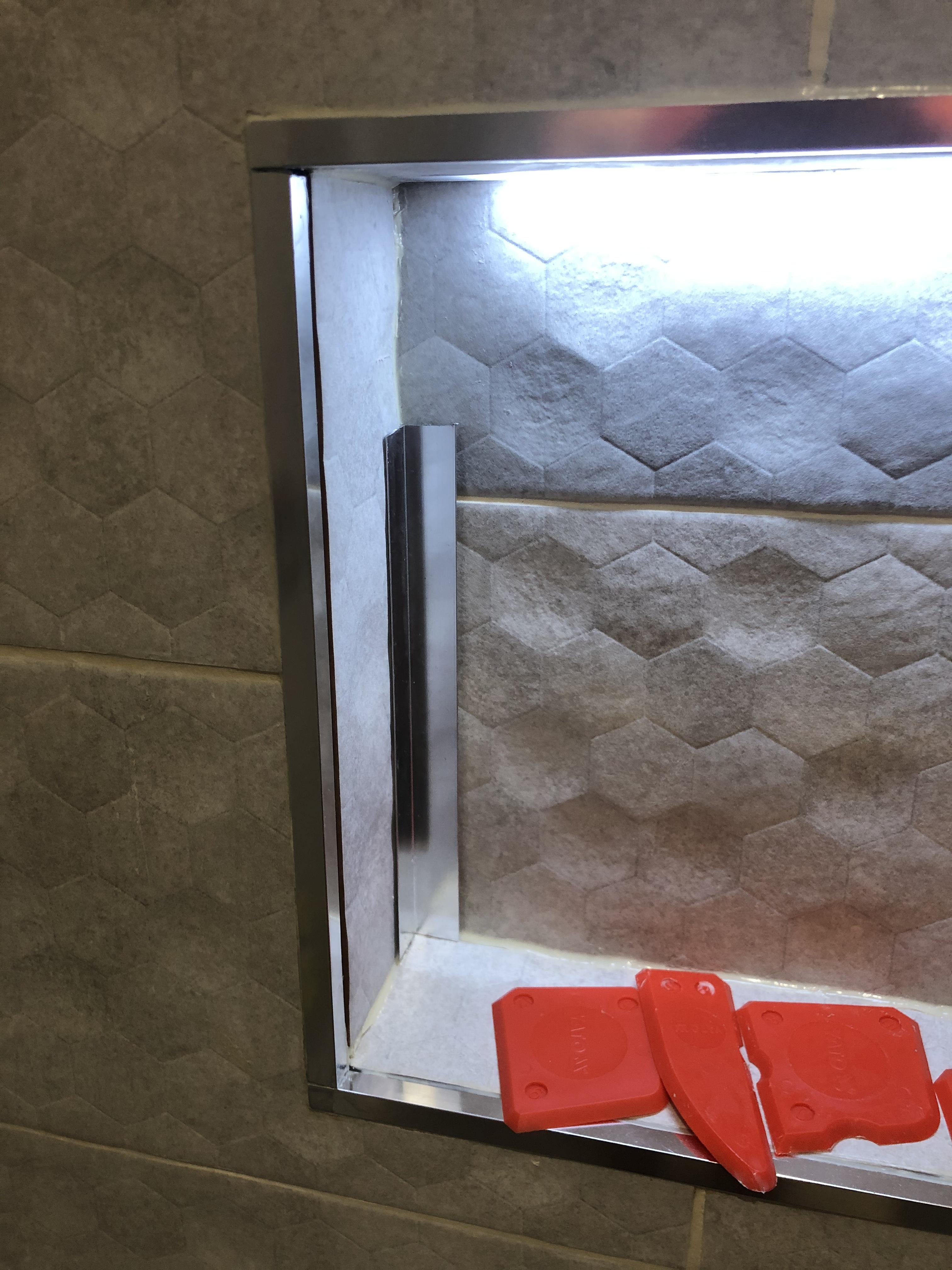

Not this type of thing ? This is 20 x 20 - so a wee bit chunky - 10 x 10 is the smallest I can find
If you can live with it. Watch SWMBO doesn't go breaking nails and catching the J cloth in it when she cleans!
I'd still persevere with the silicone.
Do some trial runs on two spare tile offcuts butted together at right angles.
SWMBO does cleaning ??
If I found a really small quadrant / curve that would be ok . But because it’s not flat when I get to the opening I’ll have an end showing

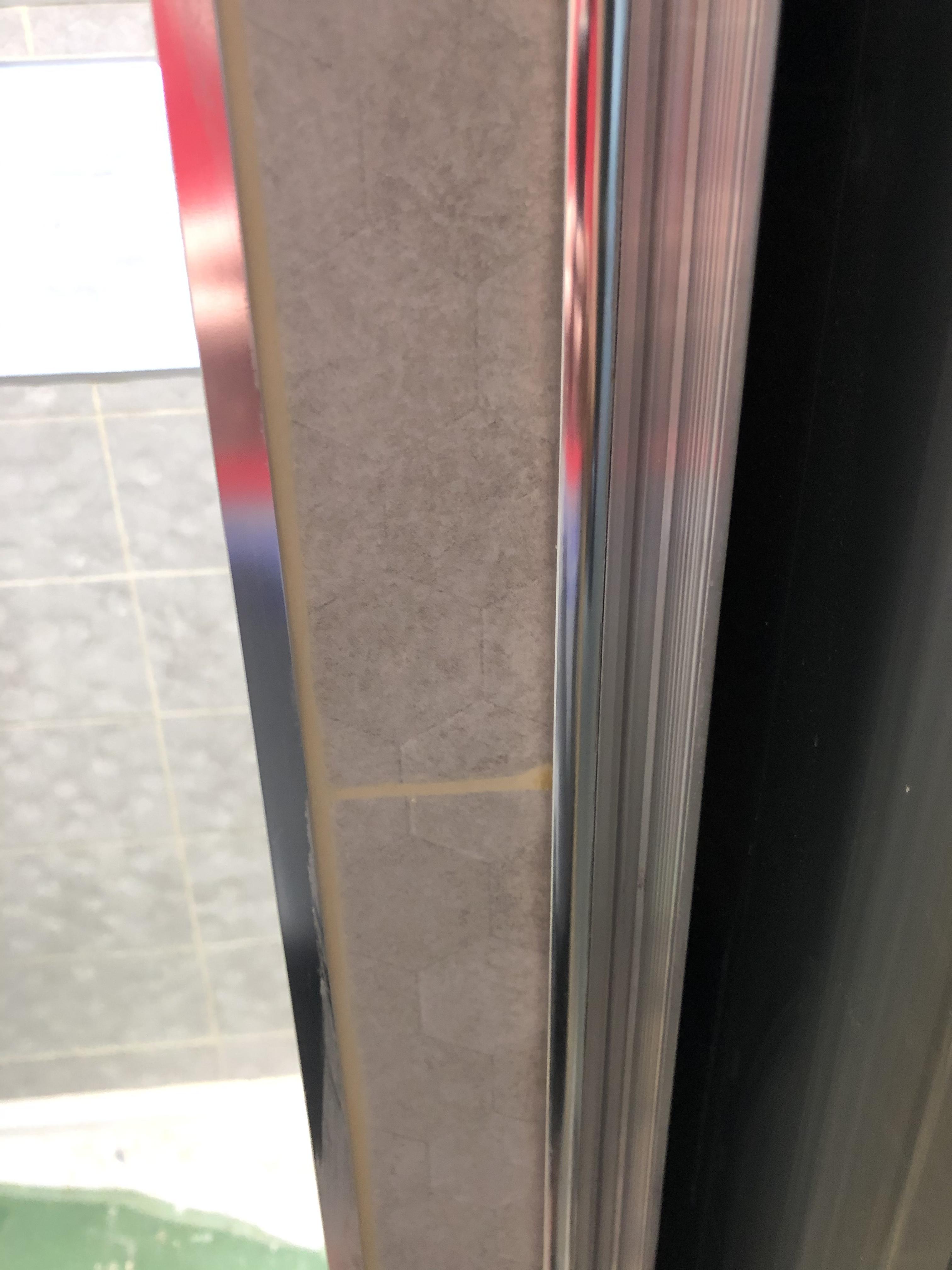

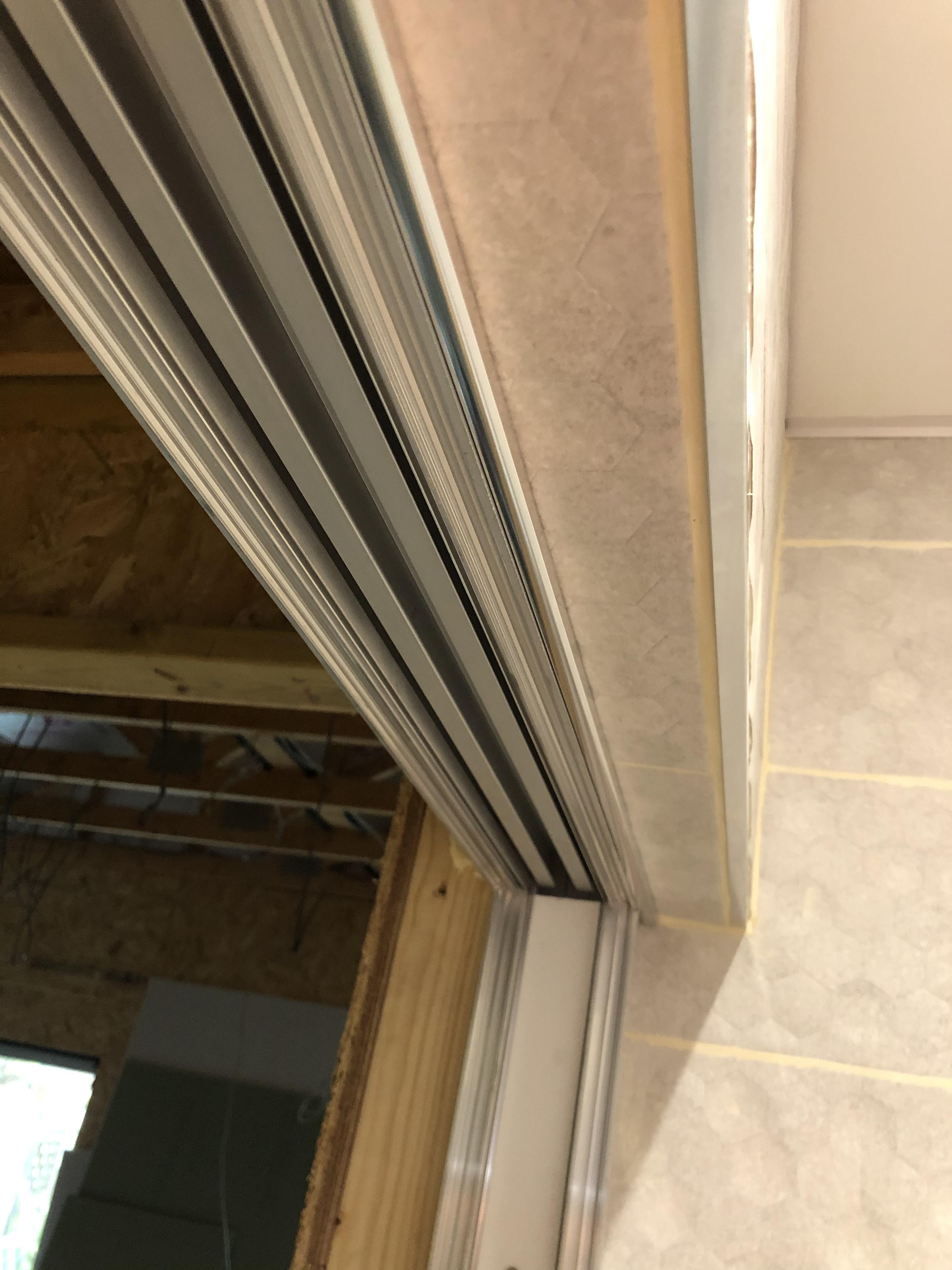

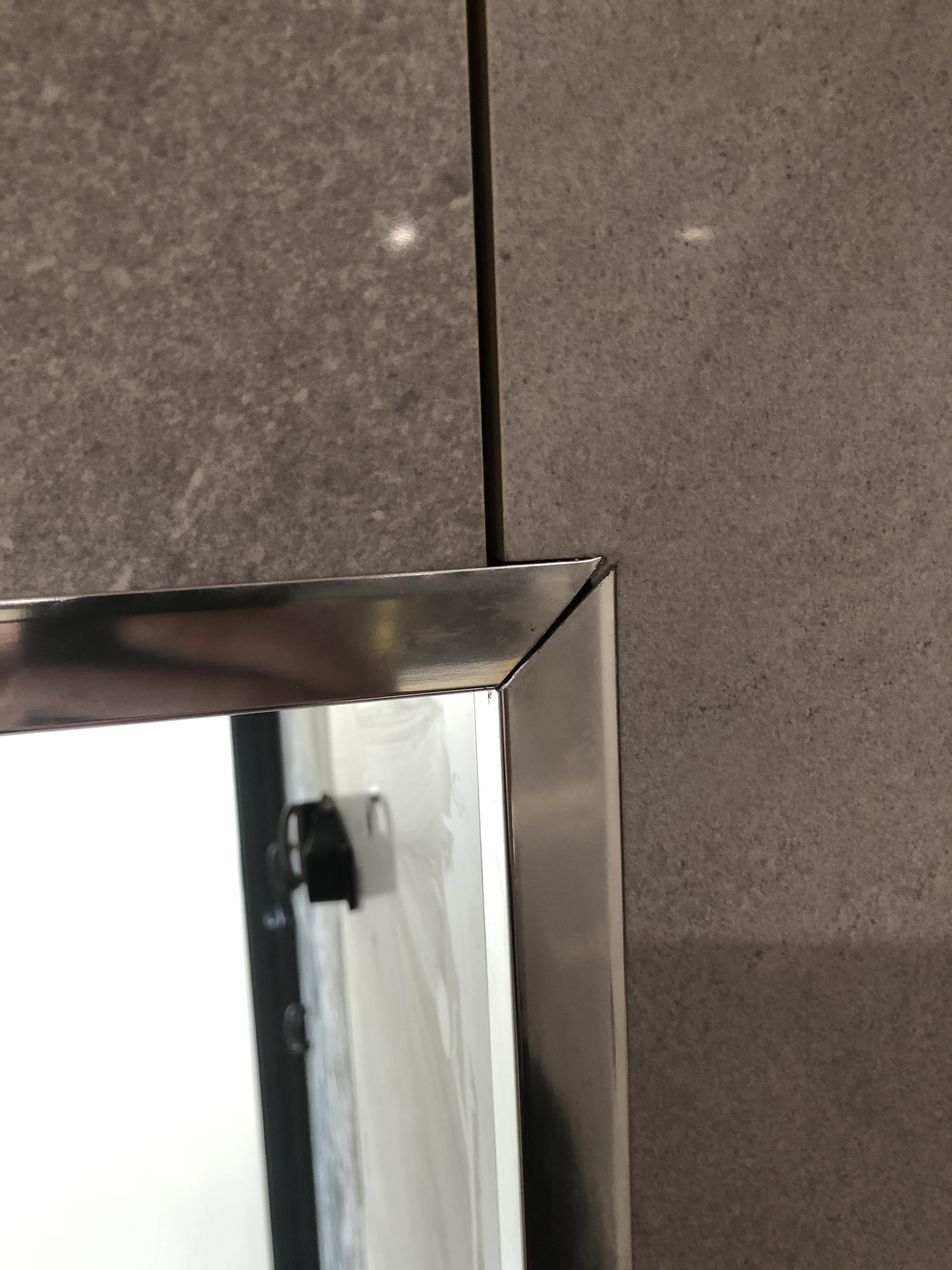

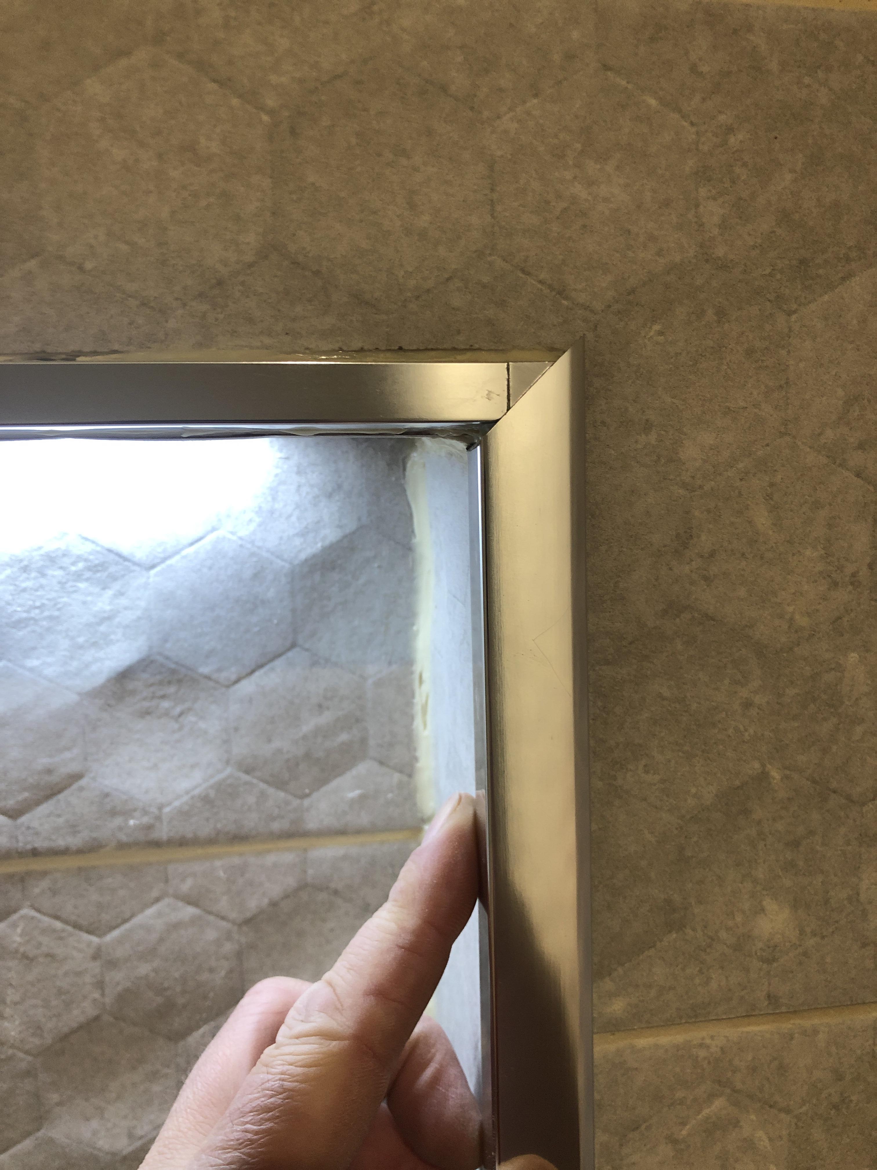

Decided to do the beading around the bathroom window . Fraction of a mm out shows up on the corner mitres . Will silver ct1 hide this good enough ??
Did a dummy setup with silver ct1
See how it looks tomorrow
Actually might just be easier and look ok if grey grout goes in there ...
Edited by pocster

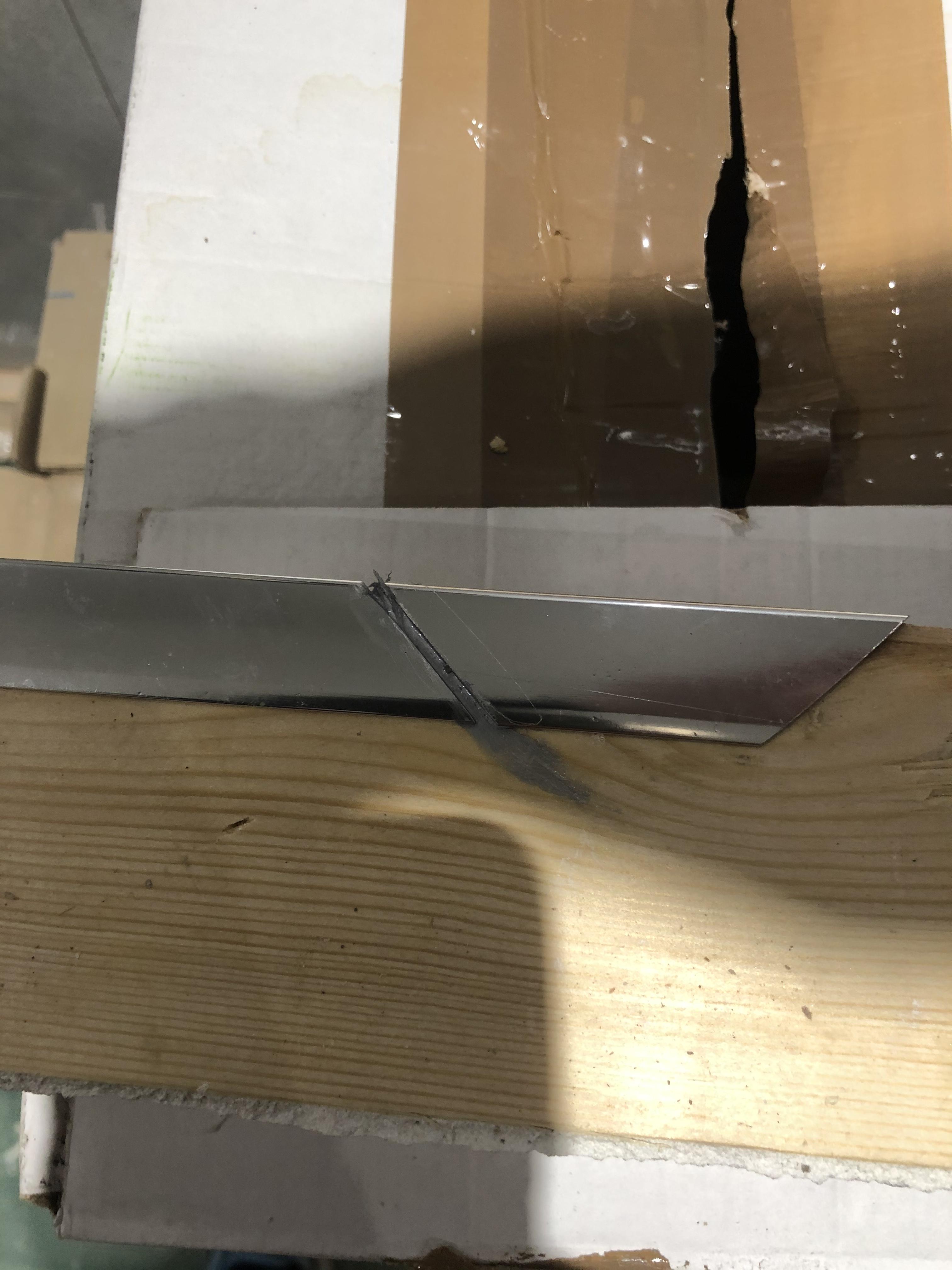

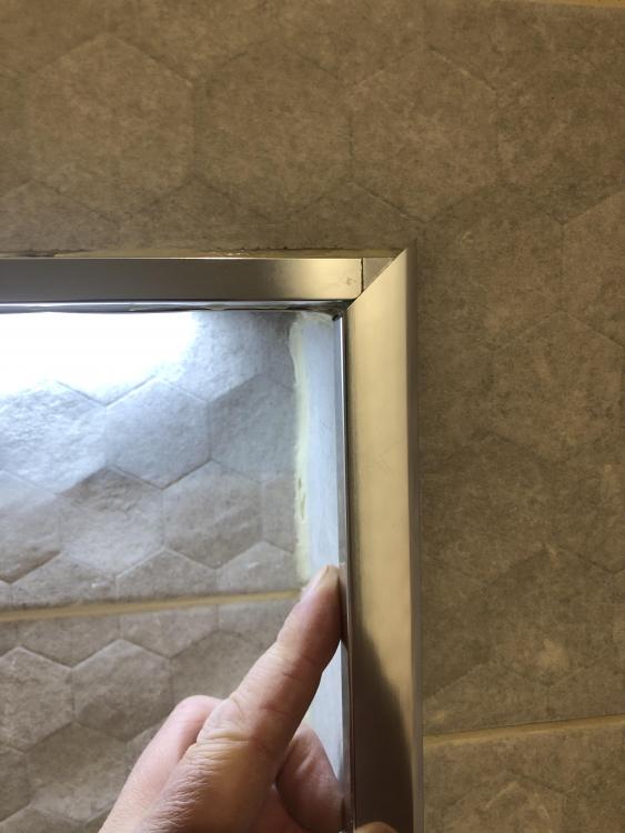

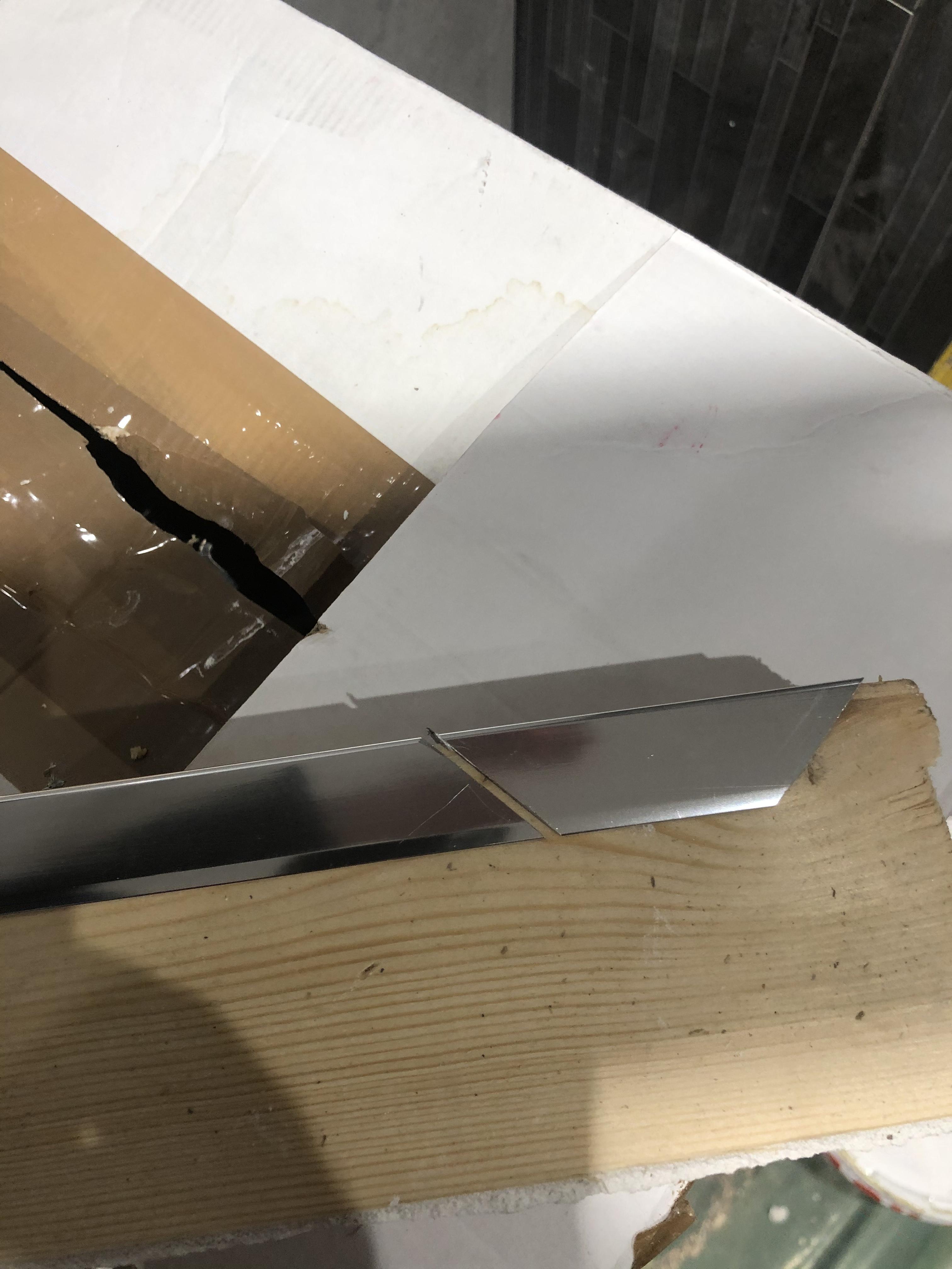

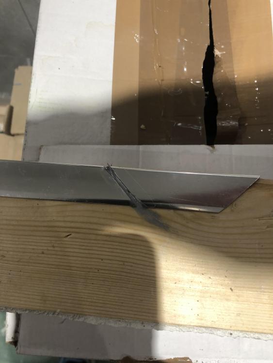

Decided to persevere with my home made beading - until I ran out of trim . Got the mitres as tight as I can .

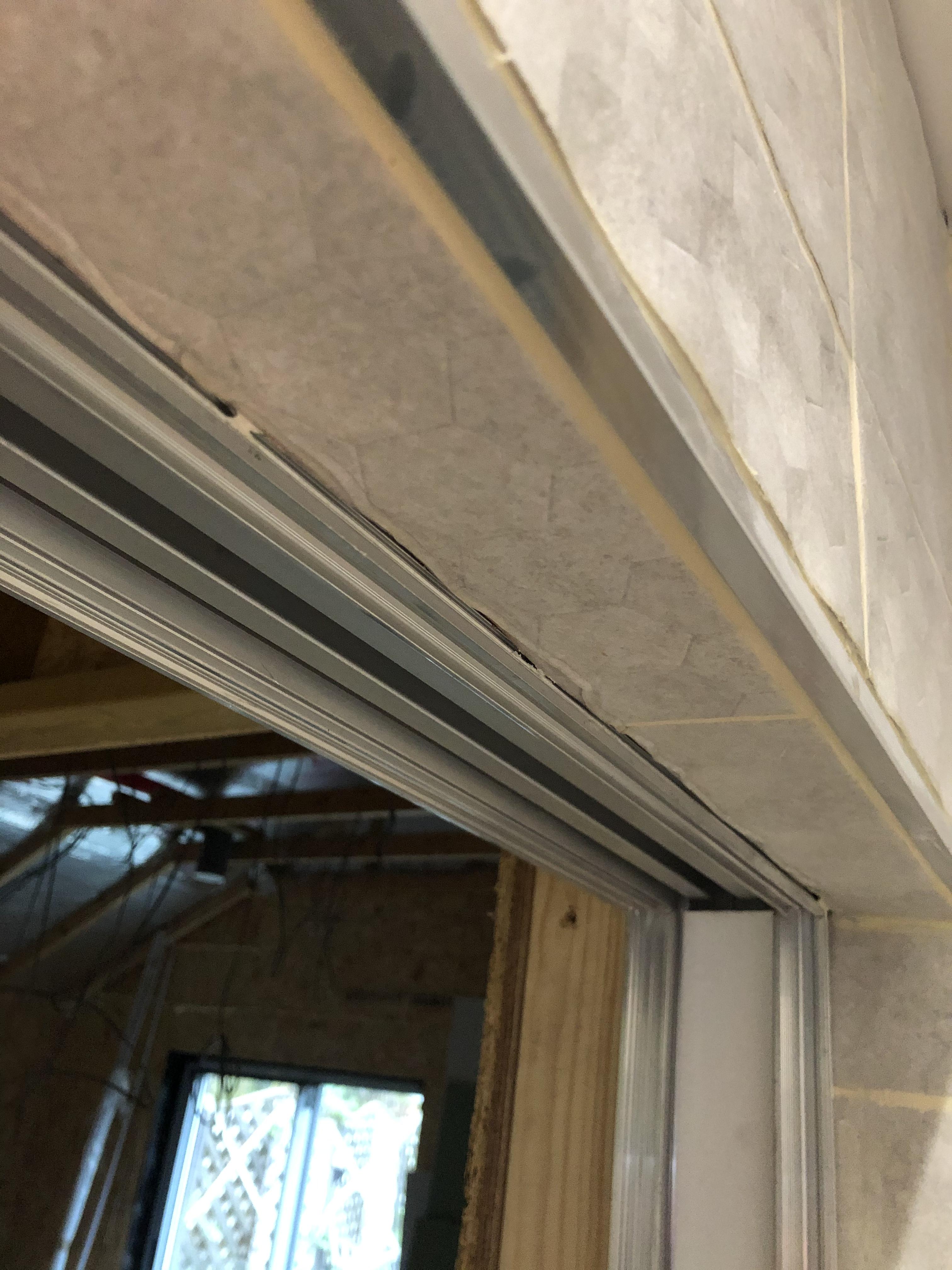

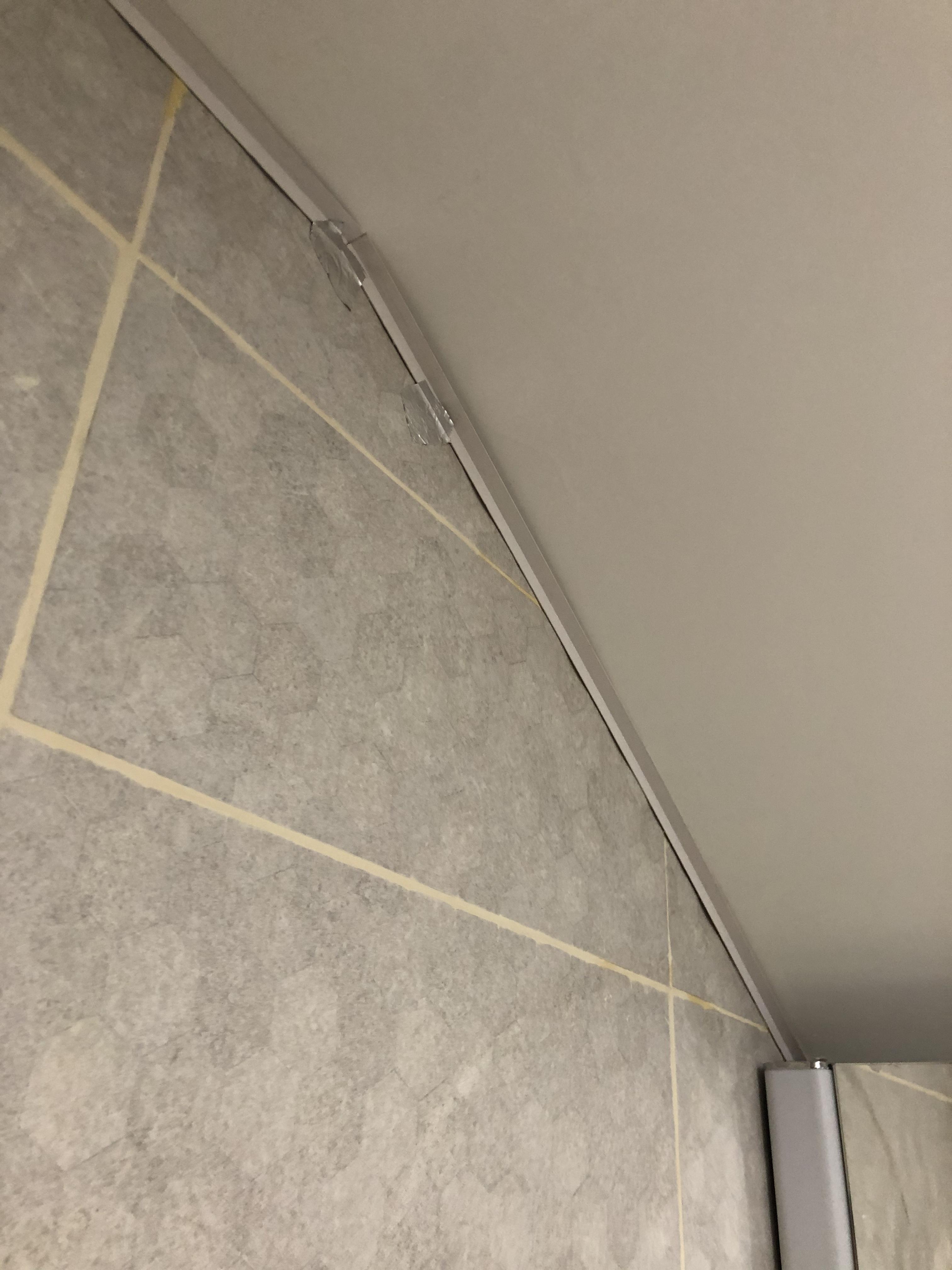

Trying to bead the ensuite wall to ceiling gap . Bloody tiles - because not flat ; a dog !
Tried this first bit stuck up with ct1 - foil tape just to hold it in place . If ok tomorrow will still need white Mastik under the upper edge against the wall
White mastic to match the trim rather than that pi$$ yellow grout colour?
Yes of course!
Trims going to save me .
Bits that were ok - I think are not now . Until they are trimmed out ! ?

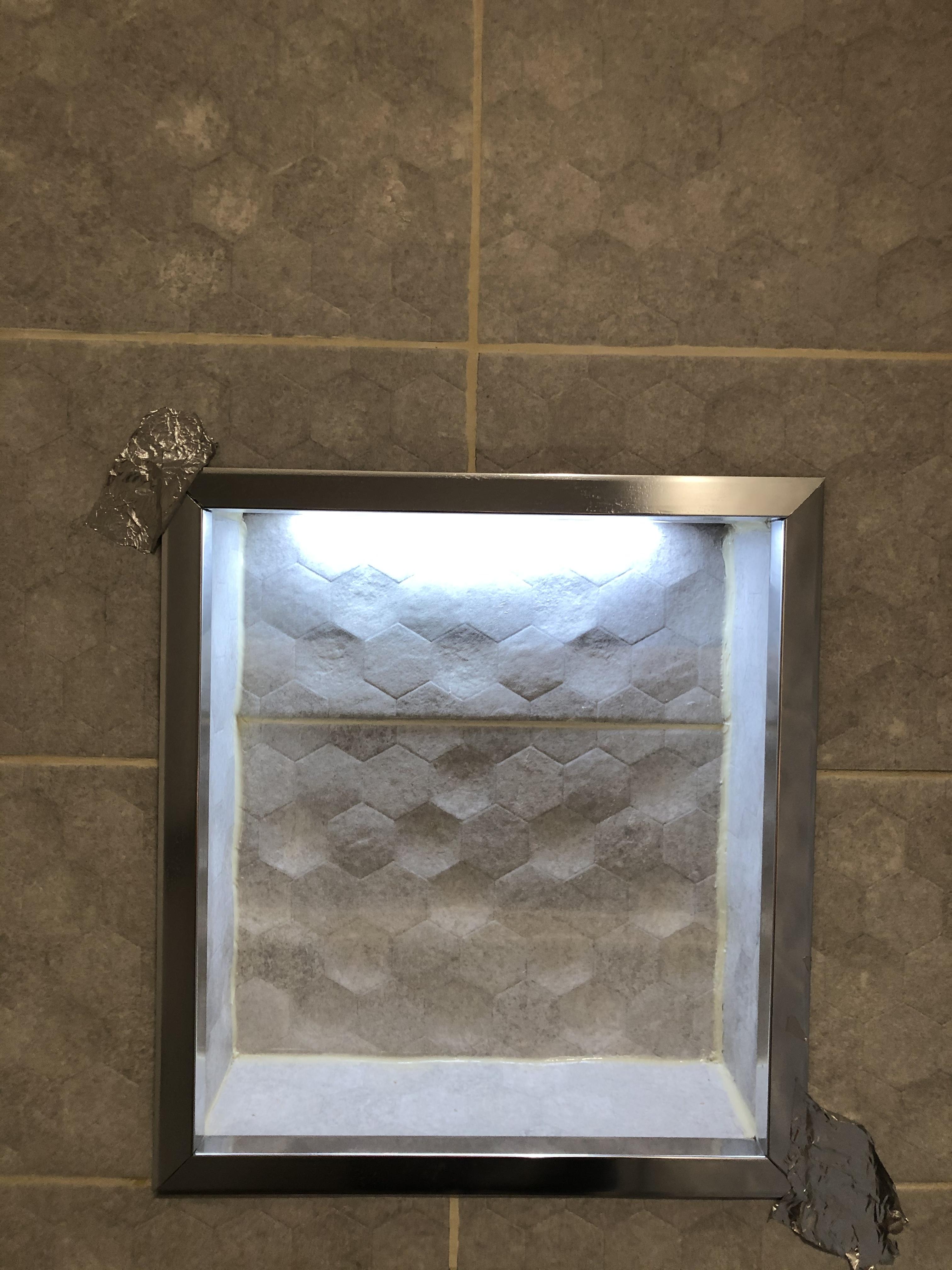

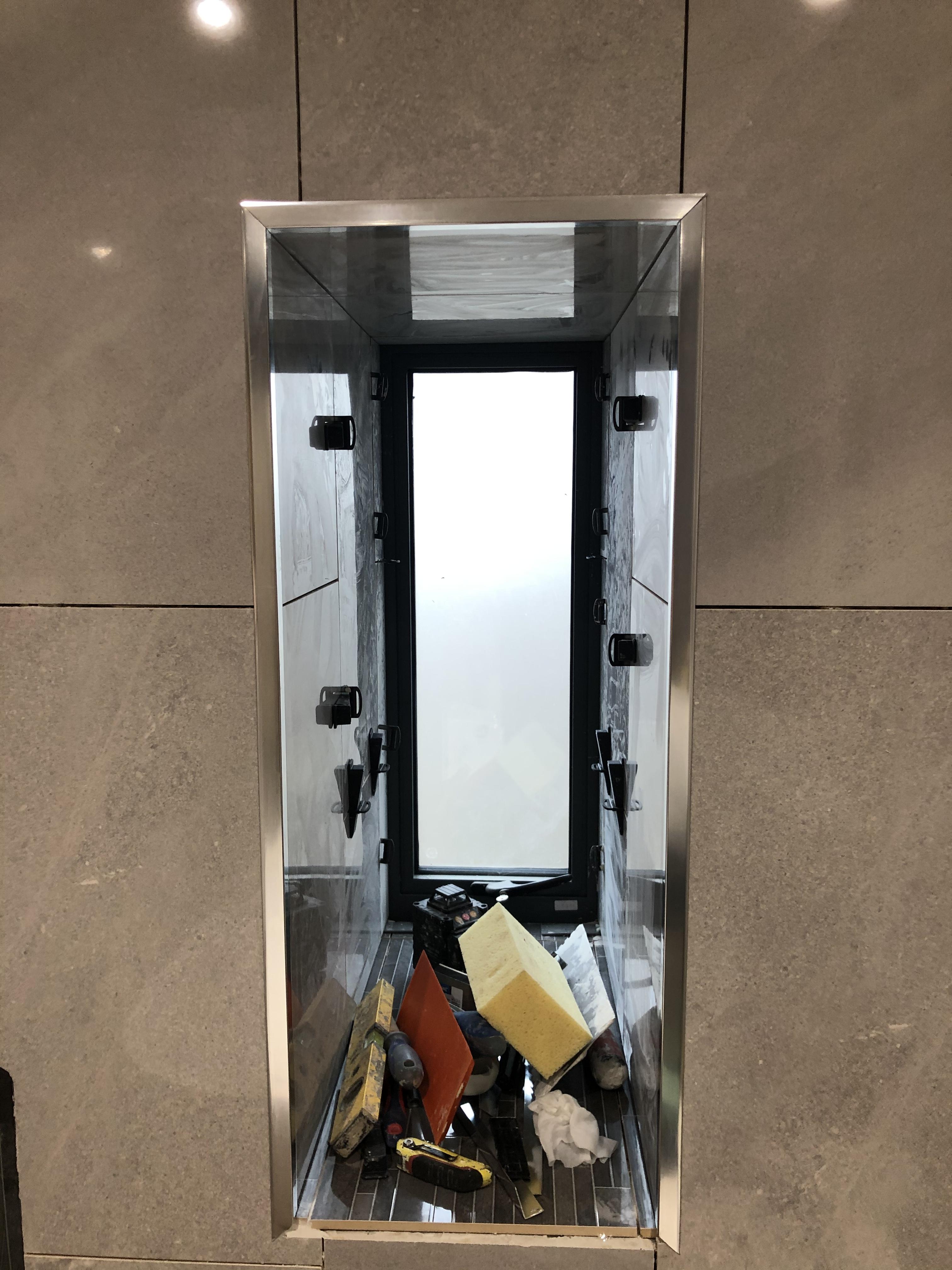

I decided to get my mate Mandy to take a look at my before and after work .
He turned to me and simply said “ This is the way “
35 minutes ago, pocster said:
Now I am happy !
