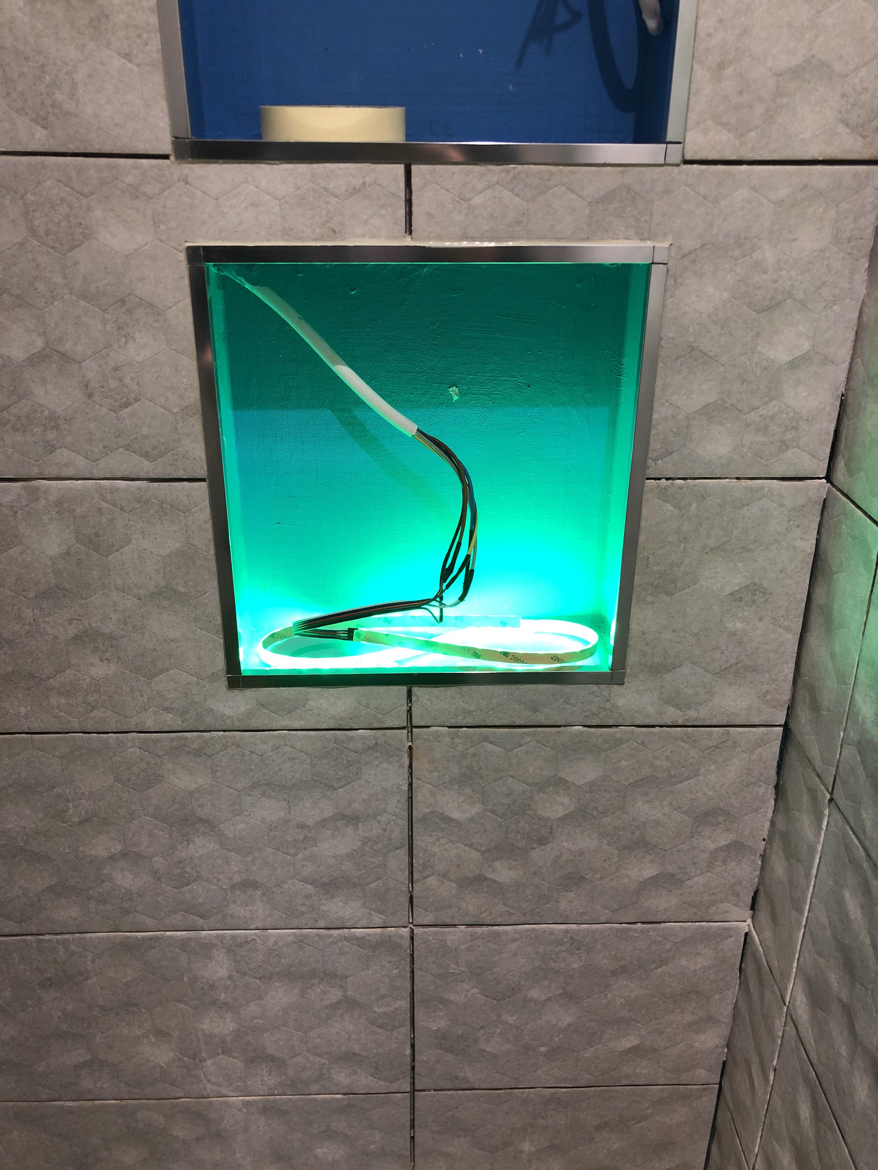

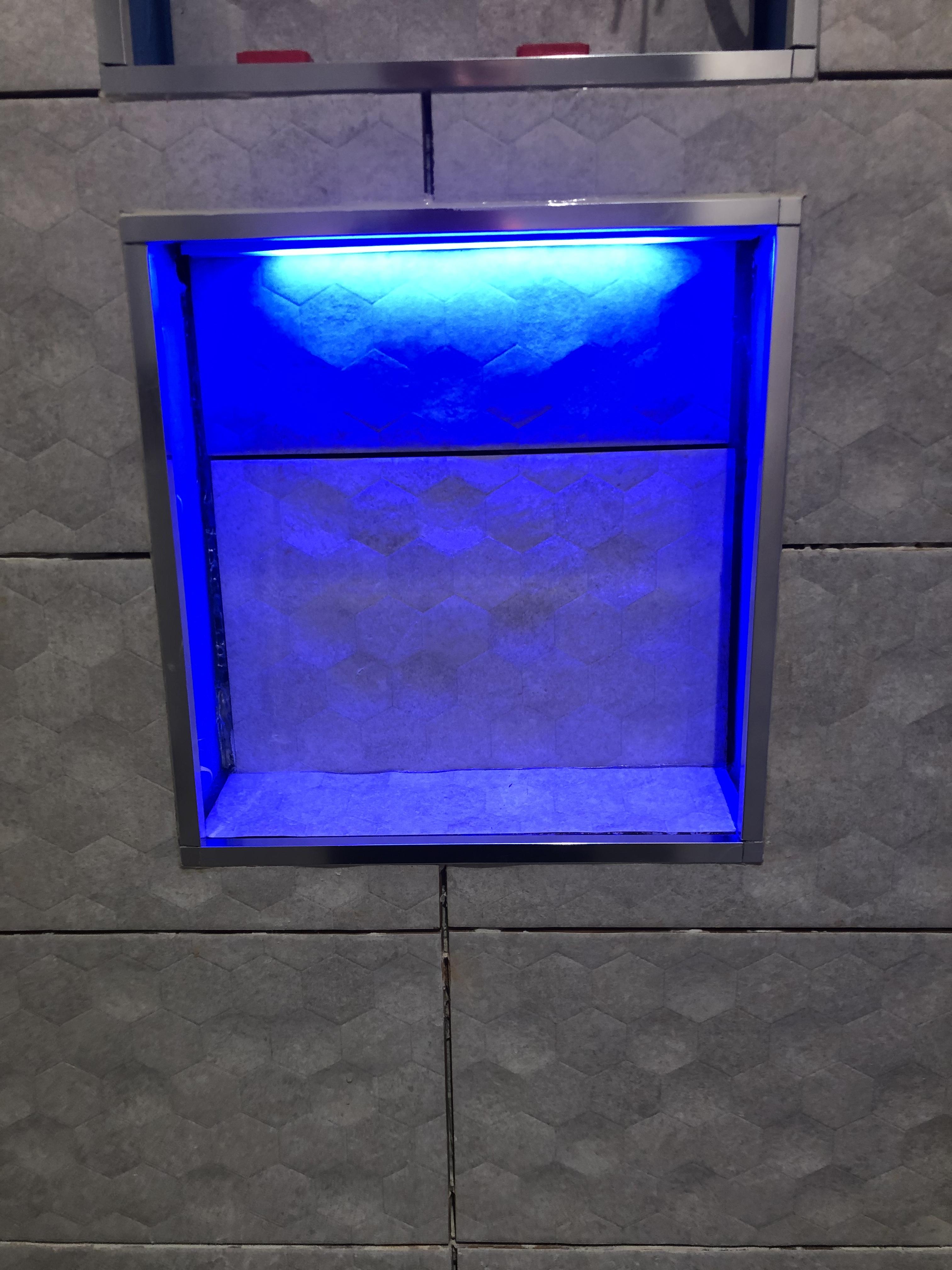

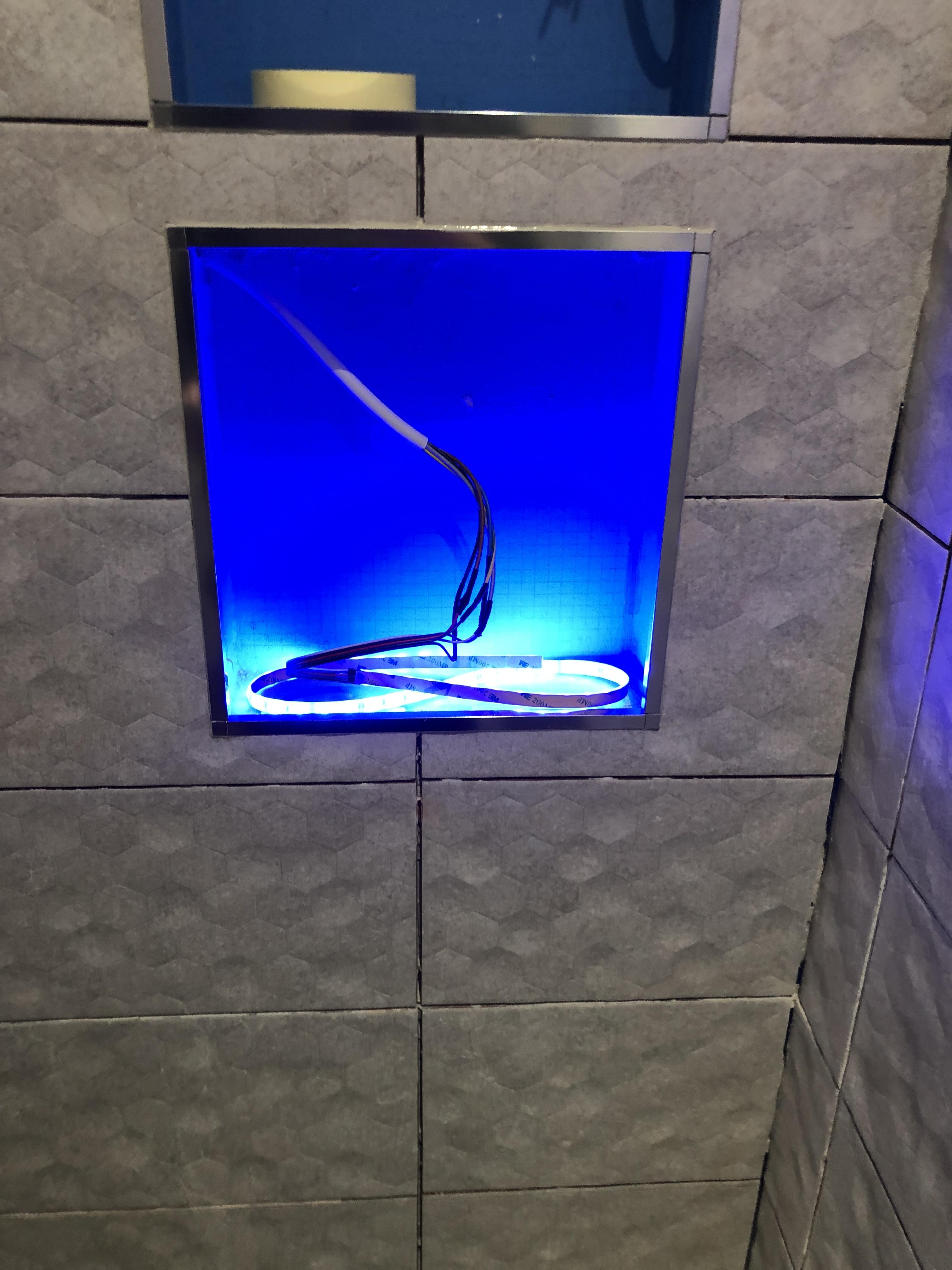

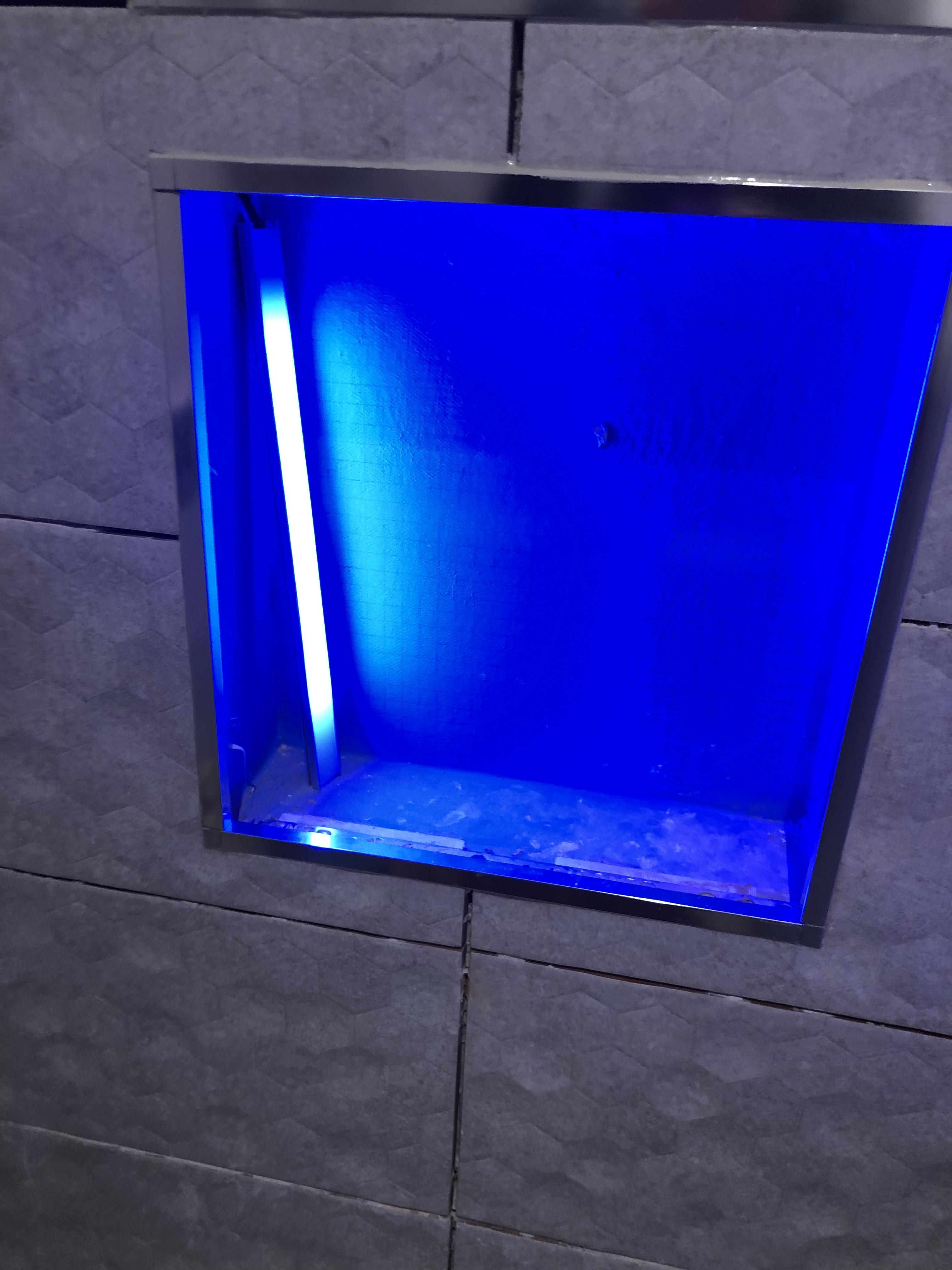

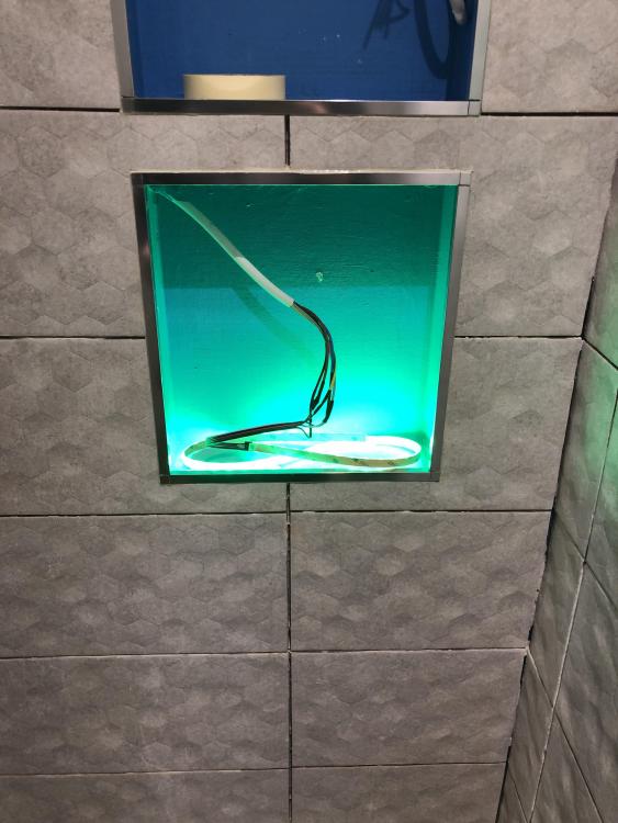

Couple of pics of the underlying detail where the LED strip is:
2 strips of ply to give depth:
20181113_194740
20181113_194701
Then a capping piece. Sort of forms a shelf the LED channel sits on. Tbh it's sat up there "loose" 'ish:
20181114_202143
Back to back trim on the capping piece:
20181202_200850
20190112_115243
20190112_122850
When you're lying in the bath you can't see the strip, you just get a "glow" washing the mosaics.

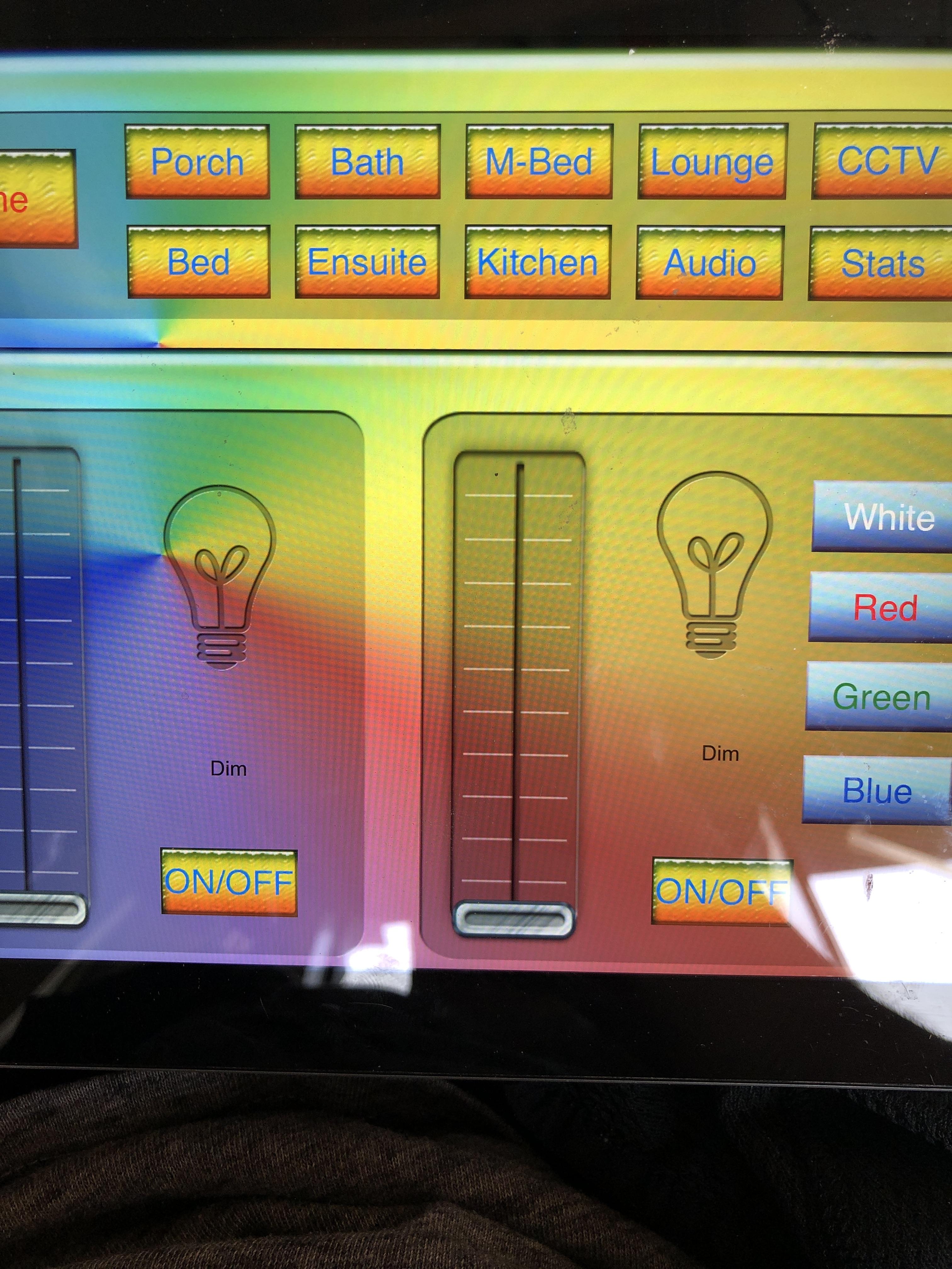

Just been playing with my rgbw controller . Got everything working crudely - could do with a colour picker in the HA .
But pretty , pretty ...
Looks spot on with that vertical grout line dead central ?

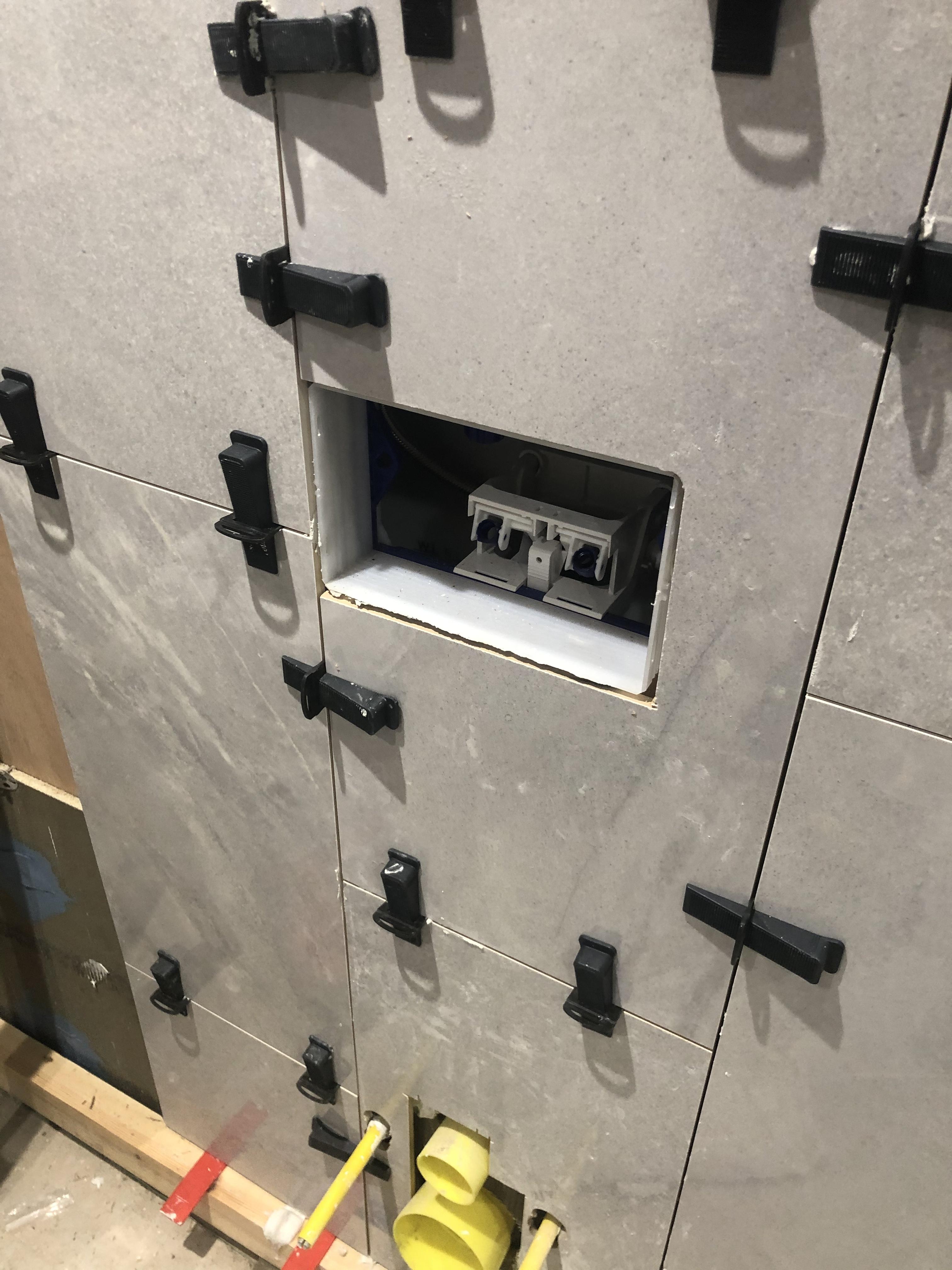

For reasons I now remember! Toilet flush plate a little to recessed ! . Don’t have any geberit flush plate buttons to hand but assume I can extend the presumably plastic plunger . Reason this is so recessed is I had problems getting the waste in as right next to concrete lintel on one side and ufh in screed on the other .
The Geberit mechanisms look complicated to start off with (imho), then when you've figured it you wonder why anyone would do it any other way!

Doh ! . For reasons unknown I put 2 tiles in the rear of the recess . If I just rotated the full tile would of got rid of the grout line . What was I thinking !!
If SWMBO says nothing then that’s good - if she mentions it I’ll just stick a tile on top ! . Those ain’t coming out an easy way .

Are the angles going to lap over the 4 tiles that line the reveal?
Herringbone would have been much more forgiving..
