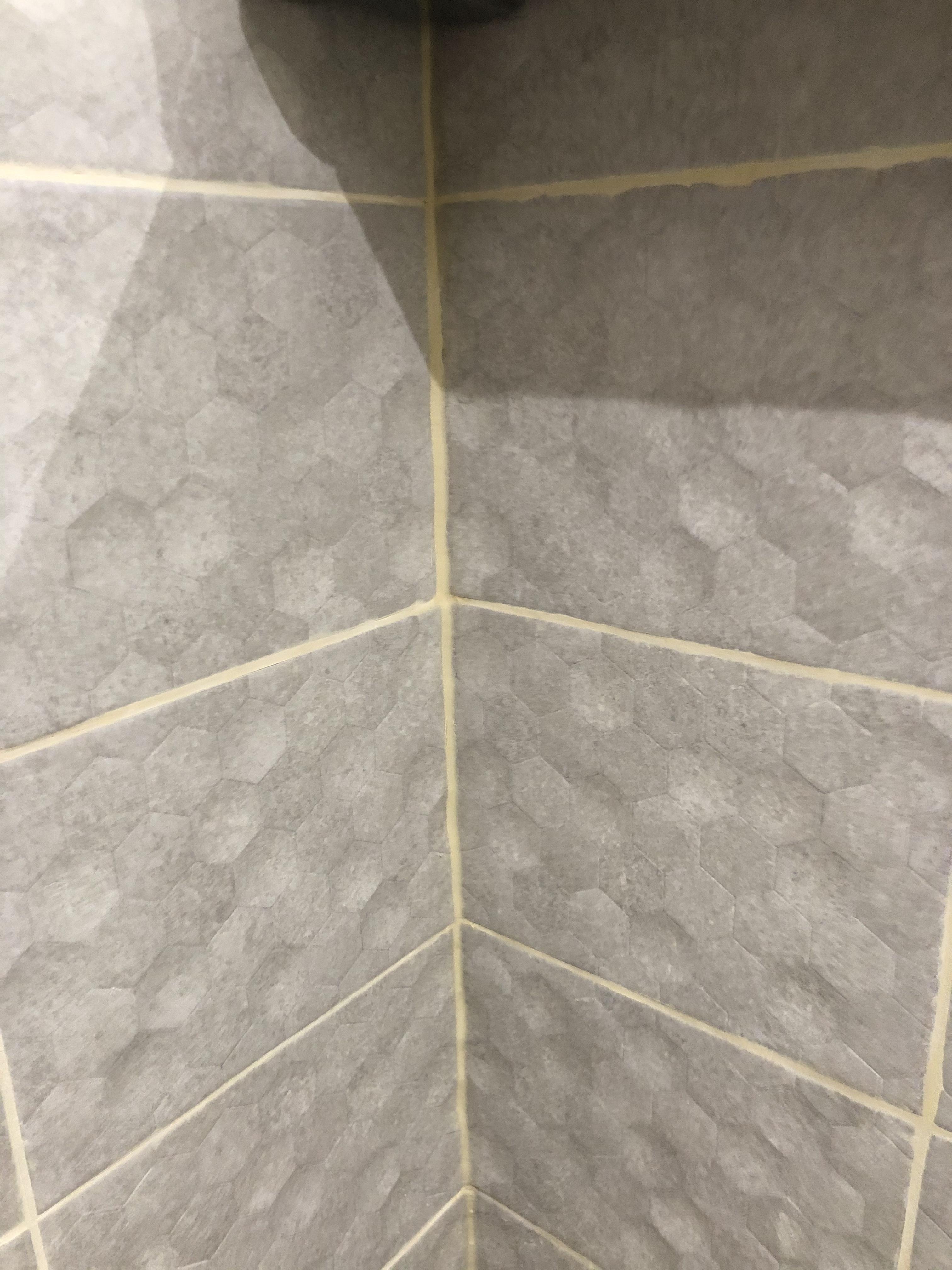

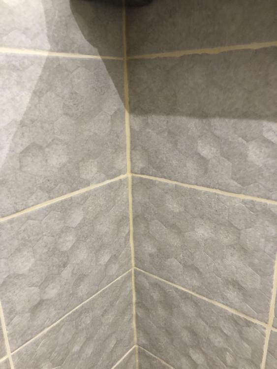

Pocster Posted November 21, 2020 Author Share Posted November 21, 2020 Decided to try the silicone on the tiles . A test run . Choose a corner where the sink is going , completely unnecessary but a good test . So just a vertical line ontop the grout in the corner Think I did ok Link to comment Share on other sites More sharing options...

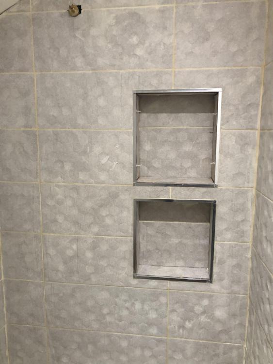

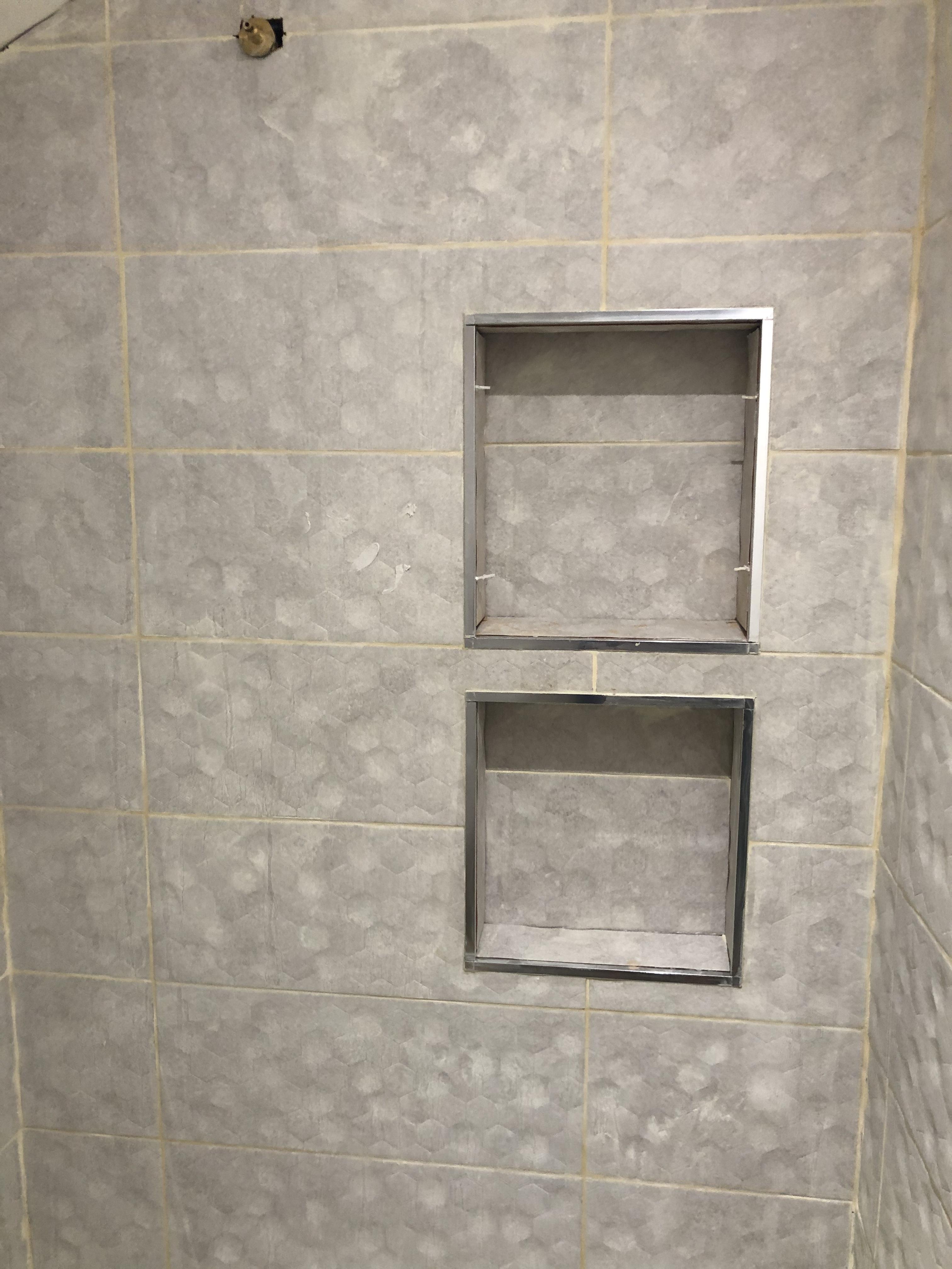

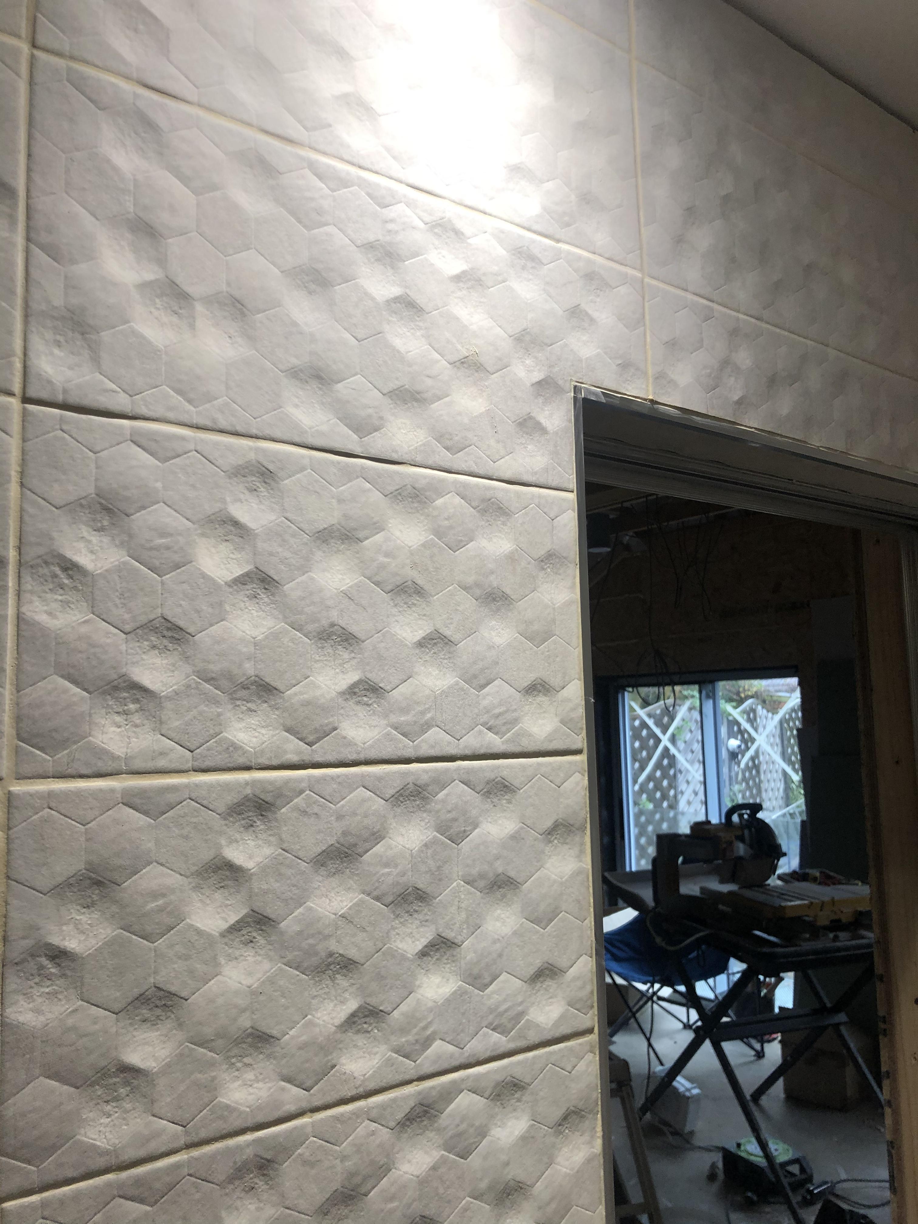

Pocster Posted November 23, 2020 Author Share Posted November 23, 2020 Sigh! I'm struggling with the ensuite recesses . To silicone an easy access wall corner using fugi thingies no problem. To try and do the same in the recess is just to awkward - it looks a bit crap ( hence no photo ). Overall I'm not happy with the ensuite recess trim - wish I bought a recess you don't tile and just goes straight in! Anyway! I could use the mitre corner edges to cover the opening edges ( as I plan to use in the bathroom recesses ). But I'm struggling to find any 'trim' for all the recess internal joins. I suppose I could reverse the corner edge to make an 'L' on the inside. Not really sure......... Or of course I could not worry as no one will ever notice apart from me!!!. The issue is these bloody hex tiles. The surface undulates as they are textured so to get a nice straight mastic line is almost impossible... f ucking tiles - SWMBO's fault ! Link to comment Share on other sites More sharing options...

Pocster Posted November 23, 2020 Author Share Posted November 23, 2020 2 minutes ago, Onoff said: I reckon your hex tiles would look all right. I'd want to keep them symmetrical mind. Say two whole hexes and halves either side. That’s not the problem . It’s getting a semi decent silicone line over an undulating pattern in an awkward area . Tempted to cut out the silicone and just grout it - that would be a pita ... Link to comment Share on other sites More sharing options...
Onoff Posted November 23, 2020 Share Posted November 23, 2020 15 minutes ago, pocster said: That’s not the problem . It’s getting a semi decent silicone line over an undulating pattern in an awkward area . Tempted to cut out the silicone and just grout it - that would be a pita ... You can get internal corner trim... Link to comment Share on other sites More sharing options...
PeterW Posted November 23, 2020 Share Posted November 23, 2020 @pocster have you got a decent Cramer / Fugi silicone set as they have guide runners for doing uneven tiles. Link to comment Share on other sites More sharing options...
Pocster Posted November 23, 2020 Author Share Posted November 23, 2020 3 minutes ago, Onoff said: You can get internal corner trim... Yeah ; I see these NOW! - but the tiles are in!. TBH I could tile ontop the tiles AND then insert proper internal trim. Link to comment Share on other sites More sharing options...
Pocster Posted November 23, 2020 Author Share Posted November 23, 2020 (edited) 2 minutes ago, PeterW said: @pocster have you got a decent Cramer / Fugi silicone set as they have guide runners for doing uneven tiles. I think so. I bought a set of 4 - i.e. a variety of shapes. I'll bite th bullet and put some photo's up tomorrow. I've been over and re-siliconed it twice - but not having a nice flat vertical surface is a pain. Edited November 23, 2020 by pocster Link to comment Share on other sites More sharing options...
Onoff Posted November 23, 2020 Share Posted November 23, 2020 You use the little black inserts to ride over the grout lines: Link to comment Share on other sites More sharing options...
Pocster Posted November 23, 2020 Author Share Posted November 23, 2020 3 minutes ago, Onoff said: You use the little black inserts to ride over the grout lines: Mine never had any black inserts - that’s new to me . Even so it wouldn’t help with internal recess corners . Link to comment Share on other sites More sharing options...
Onoff Posted November 23, 2020 Share Posted November 23, 2020 Remember you're not alone! I did my silicone then took it all out and redid with the Fugi kit: Pockets were a pita to do. Still not happy with bits (quite a few actually). 1 Link to comment Share on other sites More sharing options...
