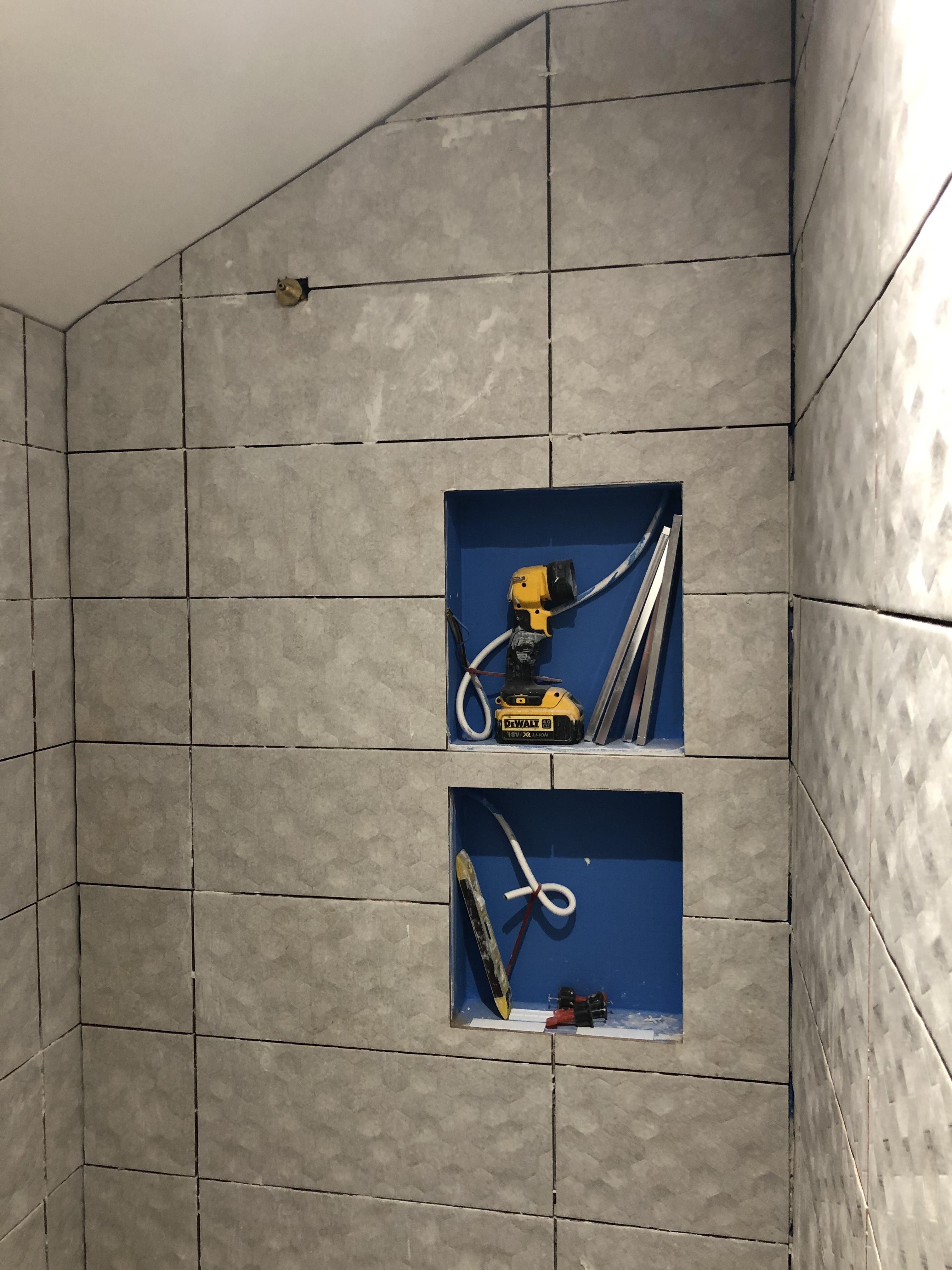

2 hours ago, pocster said:
Only way I could see to do this would be to tile AND build the stud ‘around’ it - I.e to suit .
Nope.
Plan and build the stud first. Calc for everything inc the joints, tile heights, thickness. Aim for a tolerance of 1mm or less and be happy if you get anywhere near it! Do pockets to suit tile size.

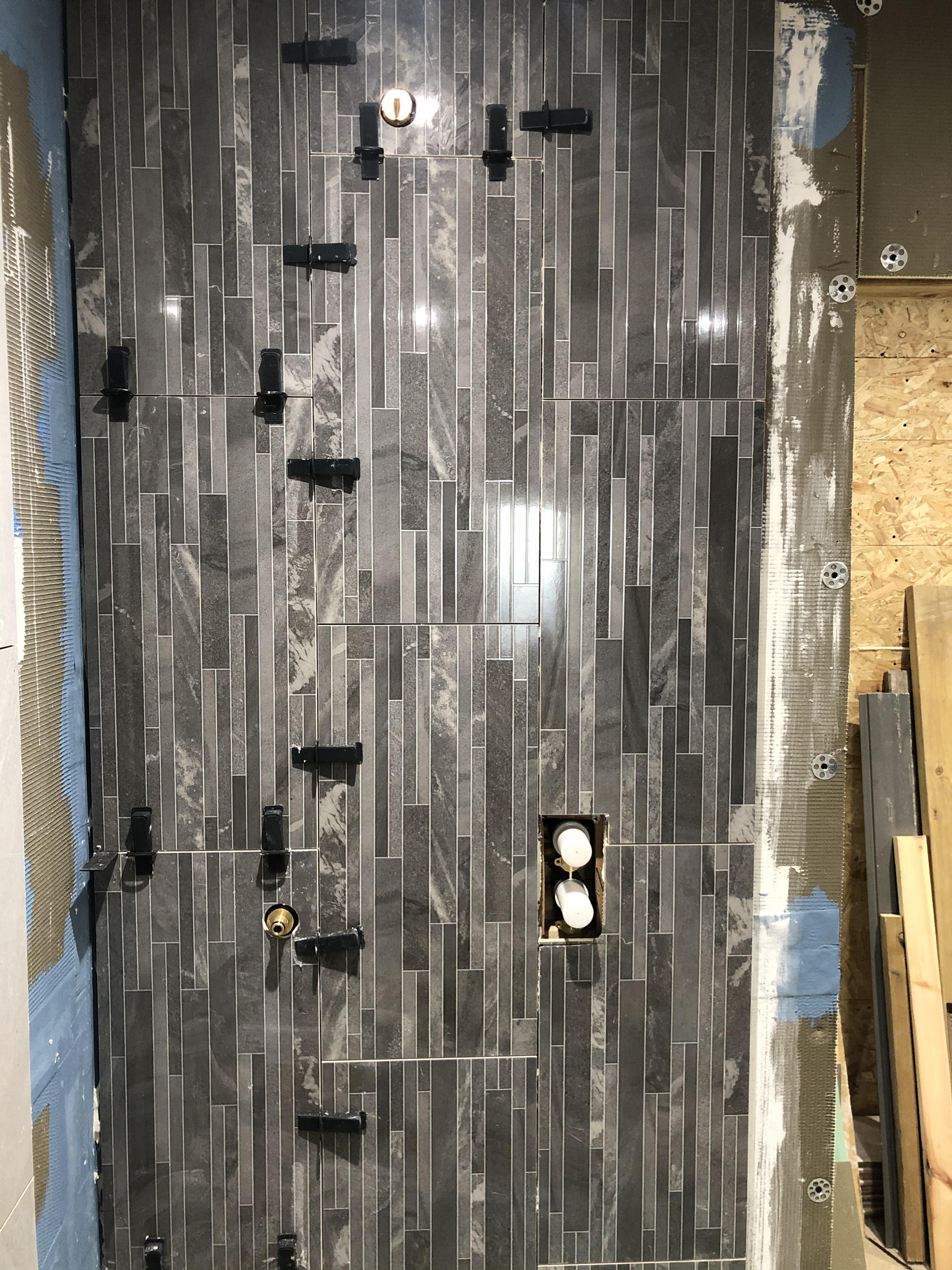

Finished tiling the ‘feature’ wall
@Onoff in your recesses you use spot led , I have led strips . Wondering if you set the light at the back of the recess or right at the front? . Can’t tell from your photos
I have an LED strip along side the bath. It's tucked up behind. I'll try and find a section drawing but it was all PLANNED! ?
