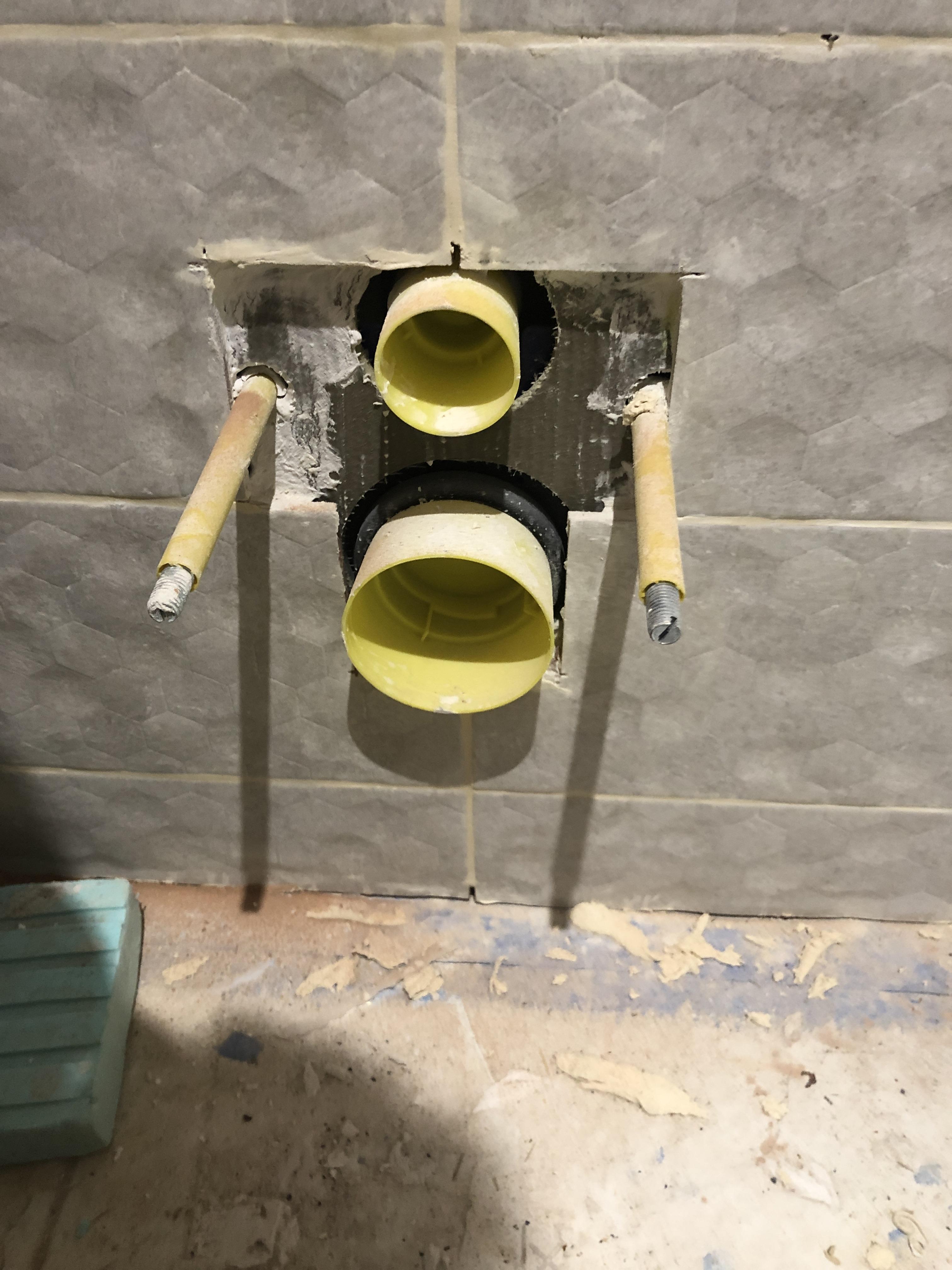

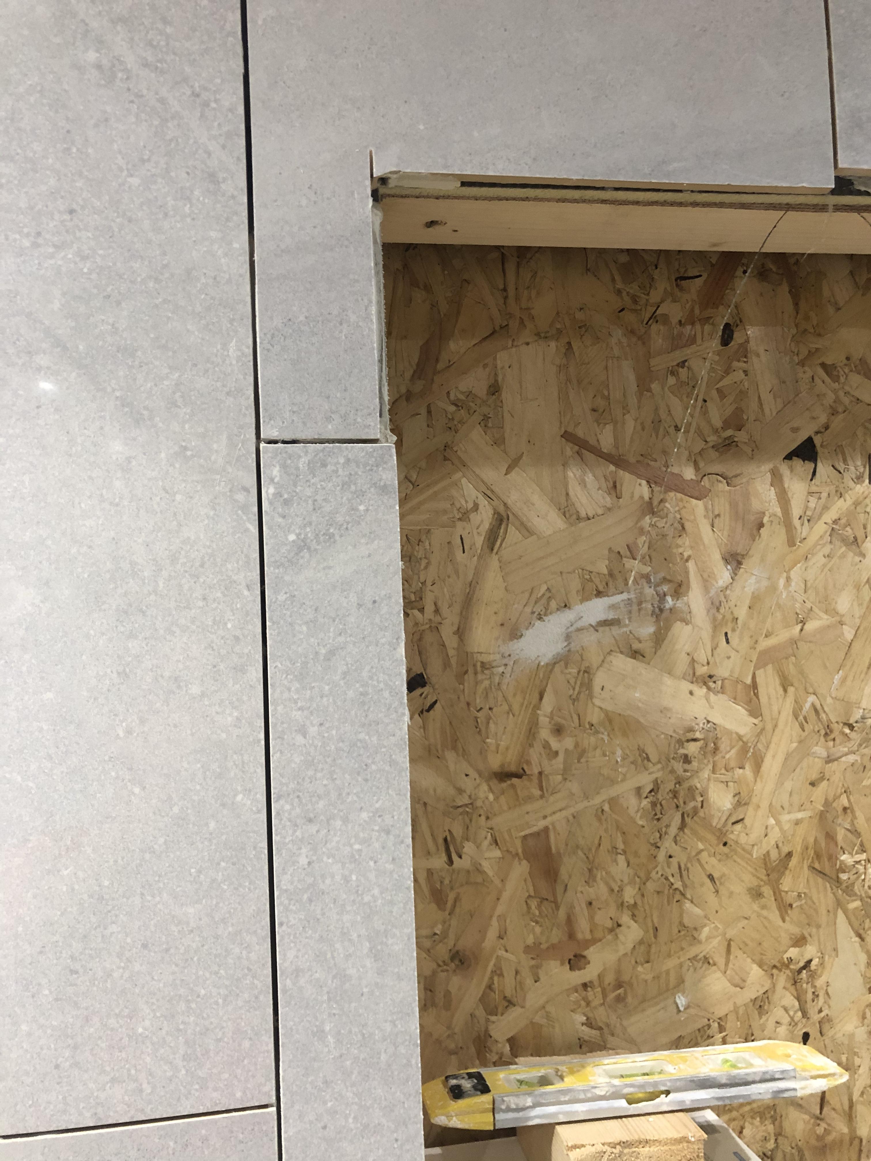

Pocster Posted November 4, 2020 Author Posted November 4, 2020 @Onoff - here around the recessed mirror - rough as f . Why ? because mirror has a nice 10mm lip . Nice profile hides poor workmanship- isn’t that why it was invented ? ??? 1
Pocster Posted November 4, 2020 Author Posted November 4, 2020 3 minutes ago, pocster said: @Onoff - here around the recessed mirror - rough as f . Why ? because mirror has a nice 10mm lip . Nice profile hides poor workmanship- isn’t that why it was invented ? ??? Who needs mm skills on bits you never see . Apart from you of course - cutting circle around pan etc . F ‘ that - here’s a sensible bad boy approach
Pocster Posted November 4, 2020 Author Posted November 4, 2020 I think this would do it - have to mitre the corners though.... https://www.protilertools.co.uk/product/brushed-stainless-steel-floor-dividing-strip-tfe?gclid=CjwKCAiAv4n9BRA9EiwA30WND59ZLF_pvxd-A1LUp9N0z7gQ9o5wK9hSTSetPM5RalxMnD1MCI5_zhoCdbMQAvD_BwE
Pocster Posted November 4, 2020 Author Posted November 4, 2020 Hmmmmm T profile for flooring might have a 'bow' in it. What about a corner protector piece ? https://www.protilertools.co.uk/categories/tile-trim/edge-corner-protection
Pocster Posted November 4, 2020 Author Posted November 4, 2020 I reckon this https://www.protilertools.co.uk/product/genesis-polished-chrome-aluminium-self-adhesive-edge-protector-2-6m-eaa206-91 Mitre the corners - hides all the sins. What does anyone else think?

Onoff Posted November 4, 2020 Posted November 4, 2020 12 minutes ago, pocster said: I reckon this https://www.protilertools.co.uk/product/genesis-polished-chrome-aluminium-self-adhesive-edge-protector-2-6m-eaa206-91 Mitre the corners - hides all the sins. What does anyone else think? 100% yes as long as the legs are deep enough to cover the tiles that'll "line" the box and the fubar'd edge. You will of course end up with a water trap on the bottom mind. Not in a wet room area is it? If so you'll have to mop in there with the towel you've just used. Tile away with gay abandon then stick the trims on with CT1 later. 1

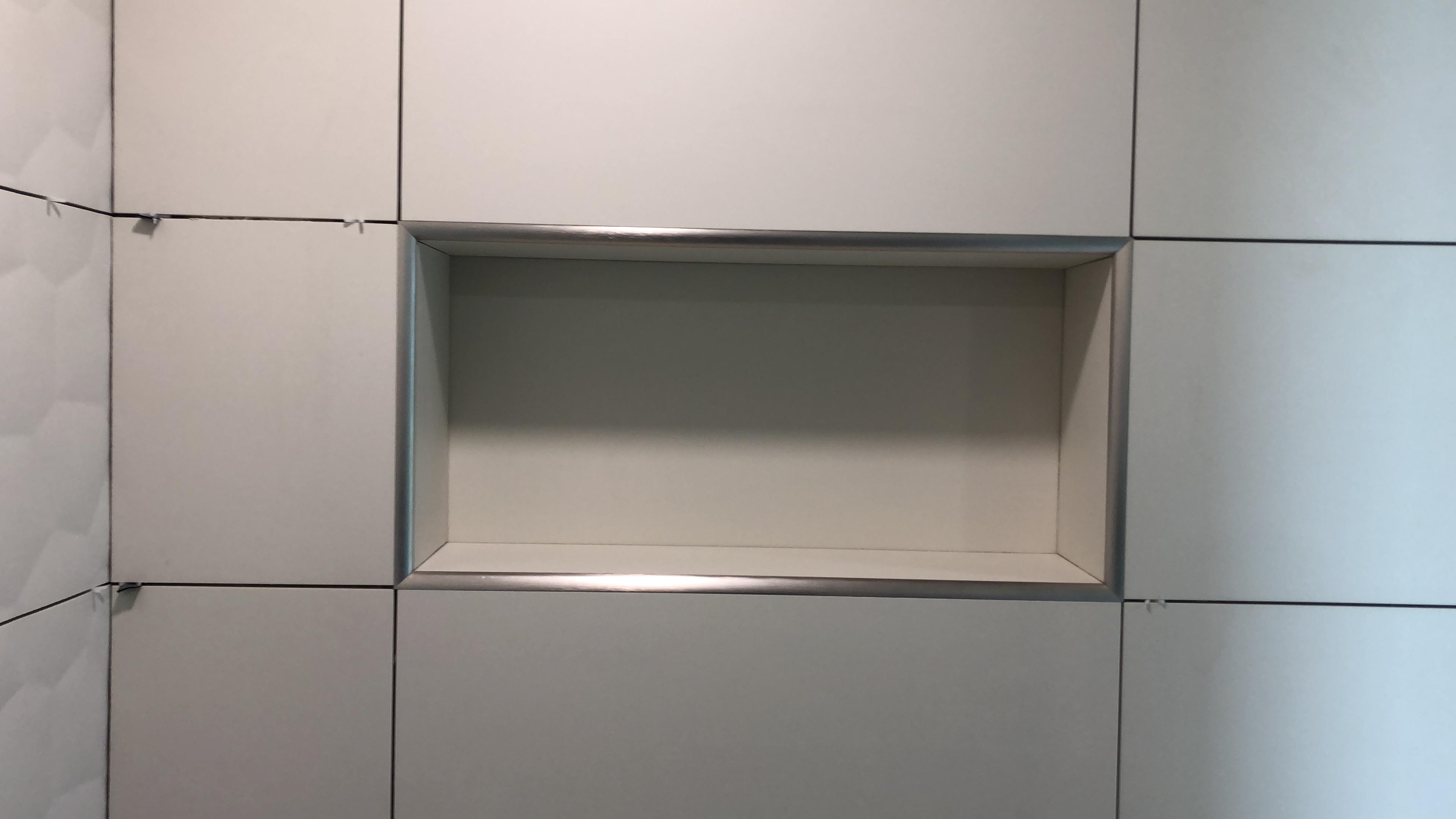

Nickfromwales Posted November 4, 2020 Posted November 4, 2020 3 hours ago, Gav_P said: But that might be because I’ve only seen trim on shite jobs. ?♂️ Get yourself some wet-wipes and enjoy ? 1 1
Pocster Posted November 4, 2020 Author Posted November 4, 2020 42 minutes ago, Nickfromwales said: Get yourself some wet-wipes and enjoy ? Bit shoddy - I can meet that 1
Gav_P Posted November 4, 2020 Posted November 4, 2020 41 minutes ago, Nickfromwales said: Get yourself some wet-wipes and enjoy ? Don’t think much of the grout tho, might look ok when it’s finished. ? The alignment of the tiles to the recess is amazing. But a lot of effort for somewhere to collect water and dirt. 1
Pocster Posted November 5, 2020 Author Posted November 5, 2020 12 hours ago, Nickfromwales said: Get yourself some wet-wipes and enjoy ? Looking at this again ; it’s a bit of a cheat ! The recess is positioned exactly to line up with the tiles so no cuts ! . Only way I could see to do this would be to tile AND build the stud ‘around’ it - I.e to suit . This what you did Uncle Nick ?
PeterW Posted November 5, 2020 Posted November 5, 2020 9 minutes ago, pocster said: Only way I could see to do this would be to tile AND build the stud ‘around’ it - I.e to suit . This what you did Uncle Nick ? Yes it’s what is called planning ....... but seriously, detail doesn’t happen by accident, it is planned from the outset. I’ve just done a conversion with a niche built into a very thick internal wall, that was for a specific sculpture and it has been sized to fit it exactly. But that went in when the blockwork was being done and it was all factored in to work with that one item. Same with light positions etc, you have to plan them when the roof/floor is going in, and then it works when you come to install a they are in the correct places. I use marked up plans with everything on them down to the last socket as otherwise you’re struggling to ensure you have everything in the right place. Plan plan plan ..!! 1 2
Ferdinand Posted November 5, 2020 Posted November 5, 2020 17 minutes ago, pocster said: Looking at this again ; it’s a bit of a cheat ! The recess is positioned exactly to line up with the tiles so no cuts ! . Only way I could see to do this would be to tile AND build the stud ‘around’ it - I.e to suit . This what you did Uncle Nick ? I'd say "well planned by someone who chose not to punch themselves in the face for the sake of spiting their nose". One of my cheats in renos is that the plug sockets backing kitchen worktops are always above the level of the tiles. And I don't put silly things like niches in my tiling. 1
