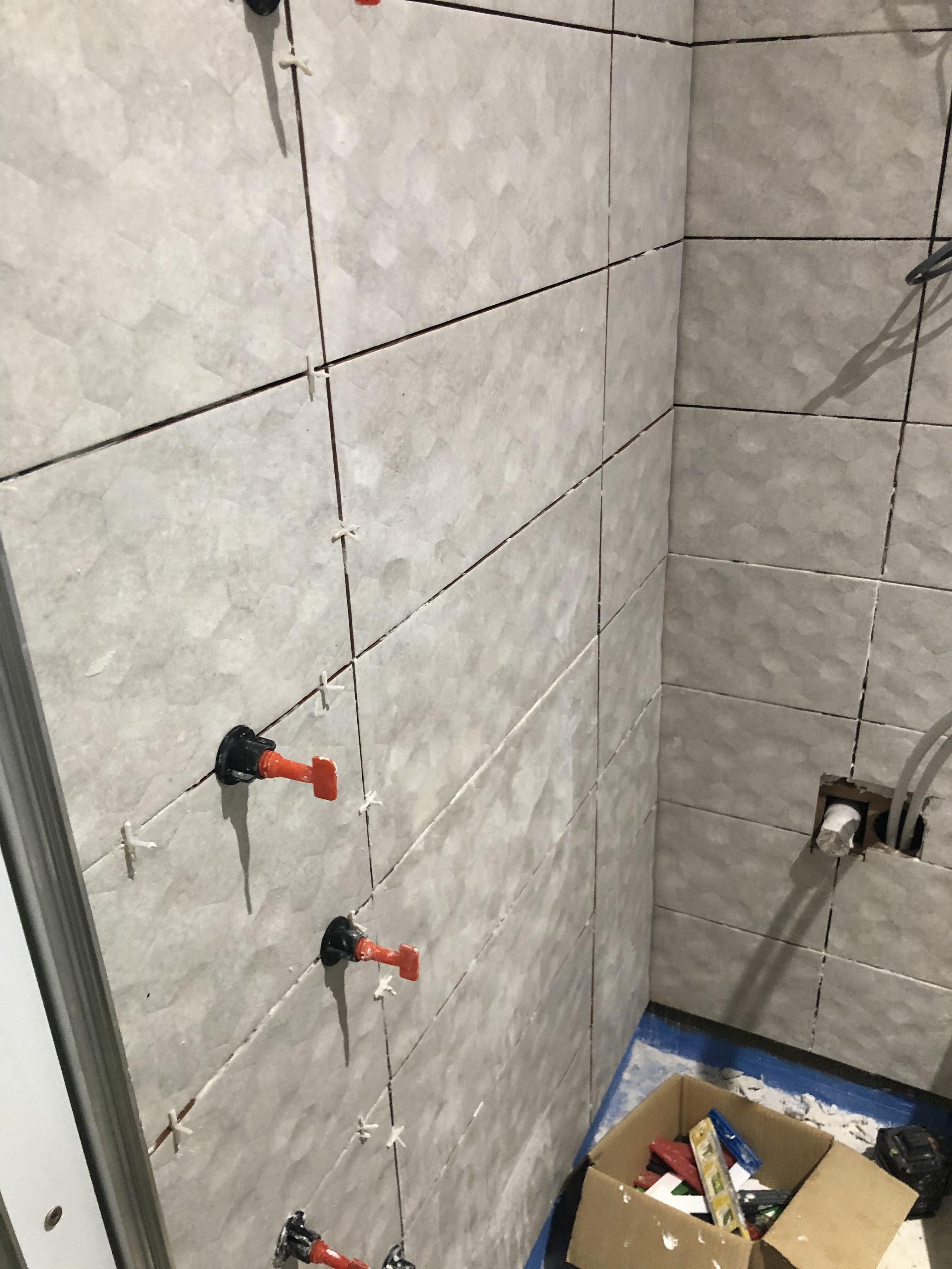

Pocster Posted September 15, 2020 Author Share Posted September 15, 2020 Tiling continues .... 1 Link to comment Share on other sites More sharing options...
Mr Punter Posted September 15, 2020 Share Posted September 15, 2020 Looks a bit cleaner than earlier. The pocket door looks promising (and expensive). 1 Link to comment Share on other sites More sharing options...
Pocster Posted September 15, 2020 Author Share Posted September 15, 2020 (edited) 2 hours ago, Mr Punter said: Looks a bit cleaner than earlier. The pocket door looks promising (and expensive). Yes - there’s much less mess . Also after A few hours I go round with a wet brush and try and gently remove any left over adhesive . Next day it’s ‘polishing’ with the dremel ... ? Pocket door expensive and a pita ! Edited September 15, 2020 by pocster Link to comment Share on other sites More sharing options...

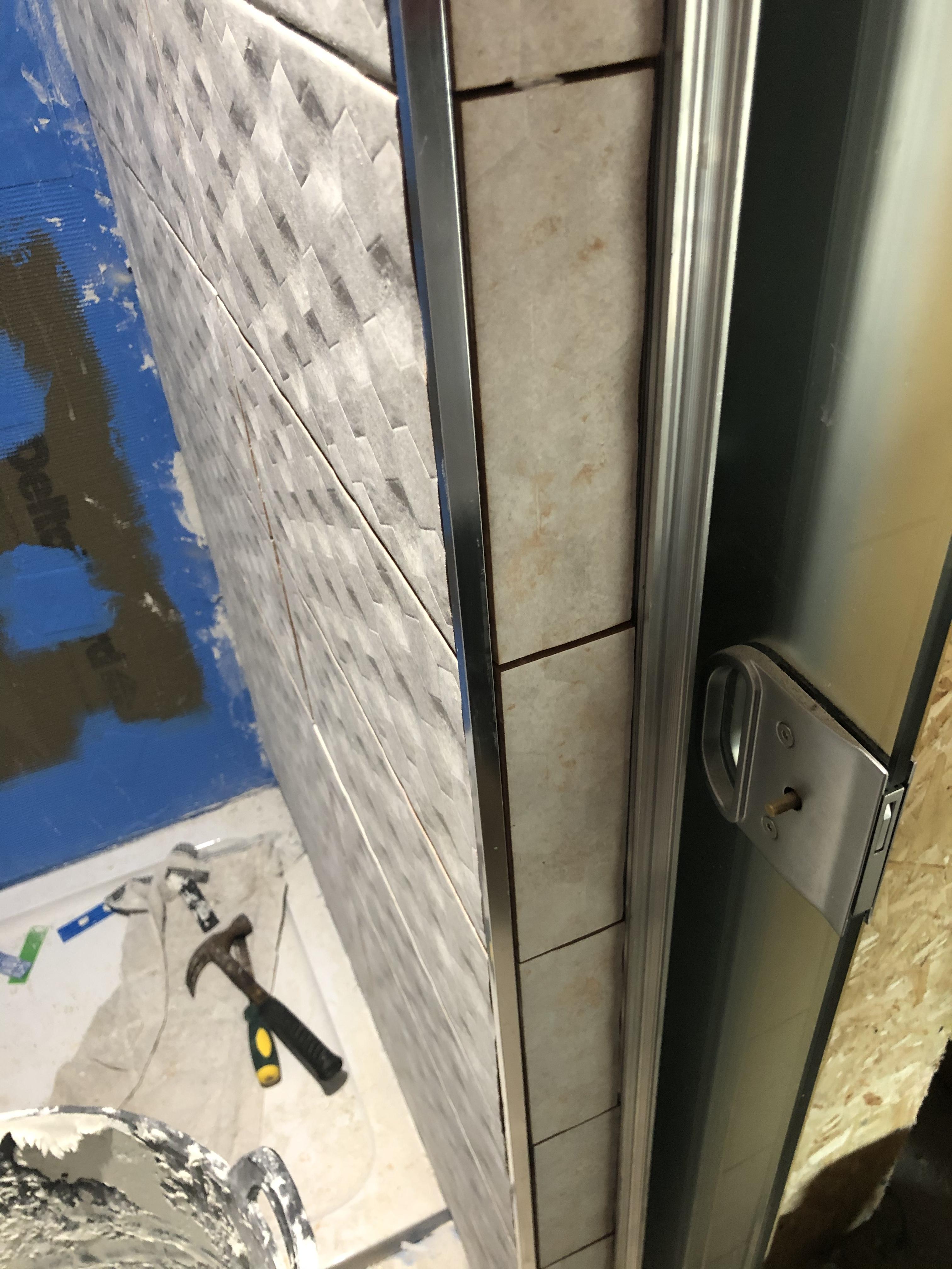

Pocster Posted September 18, 2020 Author Share Posted September 18, 2020 Don’t like the trim stuff . Awkward to cut dead straight . My previous limited experience of tiling was that the trim had a lip that cover the tiles edge , presumably to hide cut . Thought first about fitting the trim then the tiles . Realised that isn’t going to work ! . So tiles then trim . Assume on the gap between tile and trim I just ct1 the cack out of it . Uncle Nick can you come downstairs now please . Link to comment Share on other sites More sharing options...

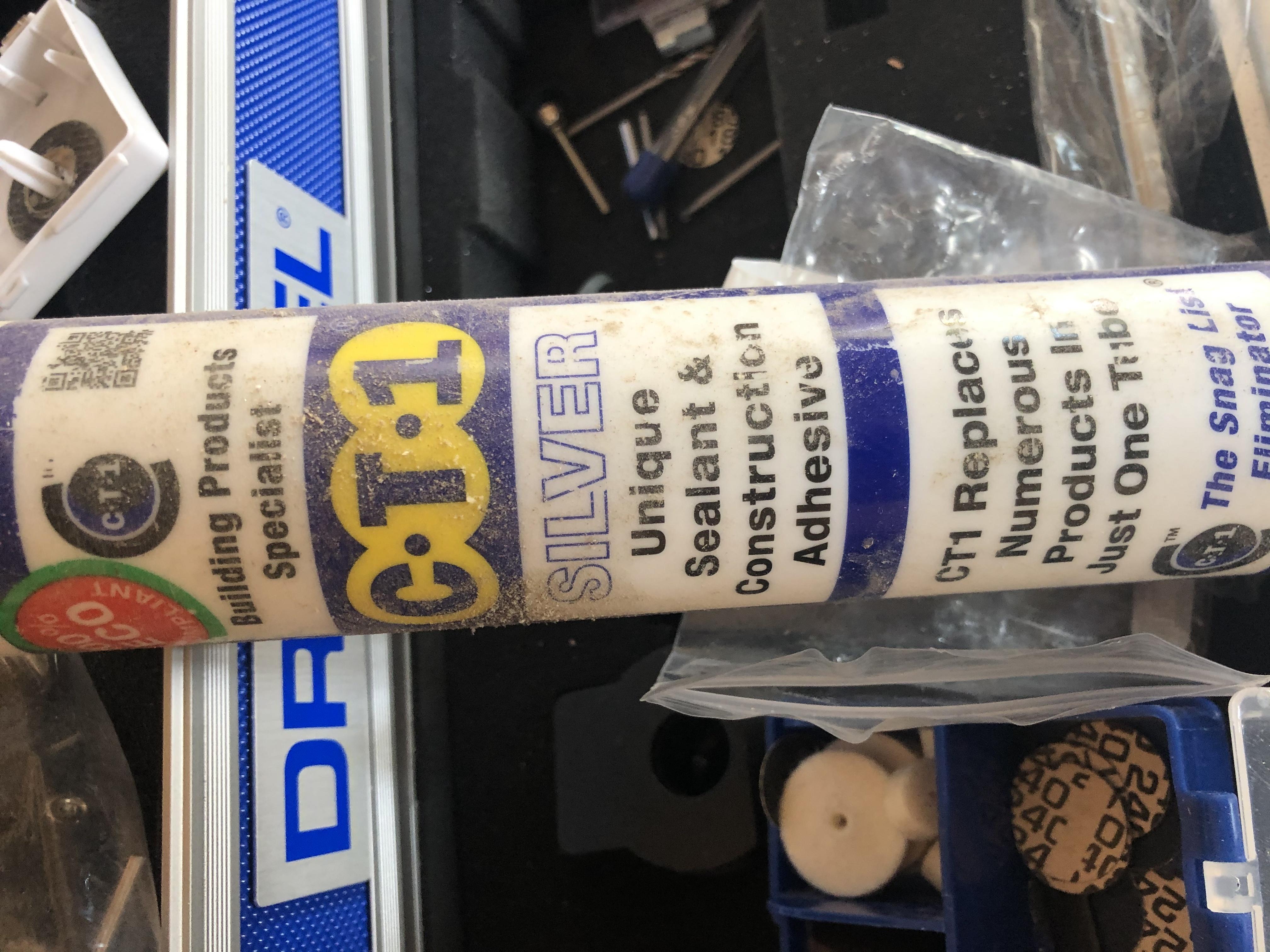

Onoff Posted September 18, 2020 Share Posted September 18, 2020 You can get silver CT1... https://www.ffx.co.uk/tools/product/C-Tec-Ct1-Silver-5060209630410-Tube-Sealant-290Ml-Cartridge--Silver 1 Link to comment Share on other sites More sharing options...
Pocster Posted September 18, 2020 Author Share Posted September 18, 2020 2 minutes ago, Onoff said: You can get silver CT1... https://www.ffx.co.uk/tools/product/C-Tec-Ct1-Silver-5060209630410-Tube-Sealant-290Ml-Cartridge--Silver Lol ! As soon as I read that look what I found ! I’ll loosely fit the trim - if it looks good I’ll bed it in ct1 ( any colour ! ) . Once gone off I’ll go round the edges of trim to tile with the silver .... Link to comment Share on other sites More sharing options...
Onoff Posted September 18, 2020 Share Posted September 18, 2020 33 minutes ago, pocster said: That'd annoy me, the grout line not being central! ? Nick told me to mitre bond the trim on. Maybe if you're a dab hand but I couldn't get on with it. Ripped it off and stuck new trim on with CT1. I used clear but wished BT1 had been about back then and I'd have used white. Link to comment Share on other sites More sharing options...
Pocster Posted September 18, 2020 Author Share Posted September 18, 2020 1 minute ago, Onoff said: That'd annoy me, the grout line not being central! ? Nick told me to mitre bond the trim on. Maybe if you're a dab hand but I couldn't get on with it. Ripped it off and stuck new trim on with CT1. I used clear but wished BT1 had been about back then and I'd have used white. F off I measured the base tile there and was certain the grout line was central . Must of ‘moved’ magically overnight .... ? I will live with this anomaly- it shows I am human and not a tiling machine . ? When I spent a king’s ransom on tiles and stuff I told the guy I wanted zero mitring . Because I (expletive deleted)ing hate it . These little square ends are nice . But they fit in either way round and wobble !!! . Even with a blob of ct1 they wobble - so need to be left to set . Ucking rubbish ! 1 Link to comment Share on other sites More sharing options...

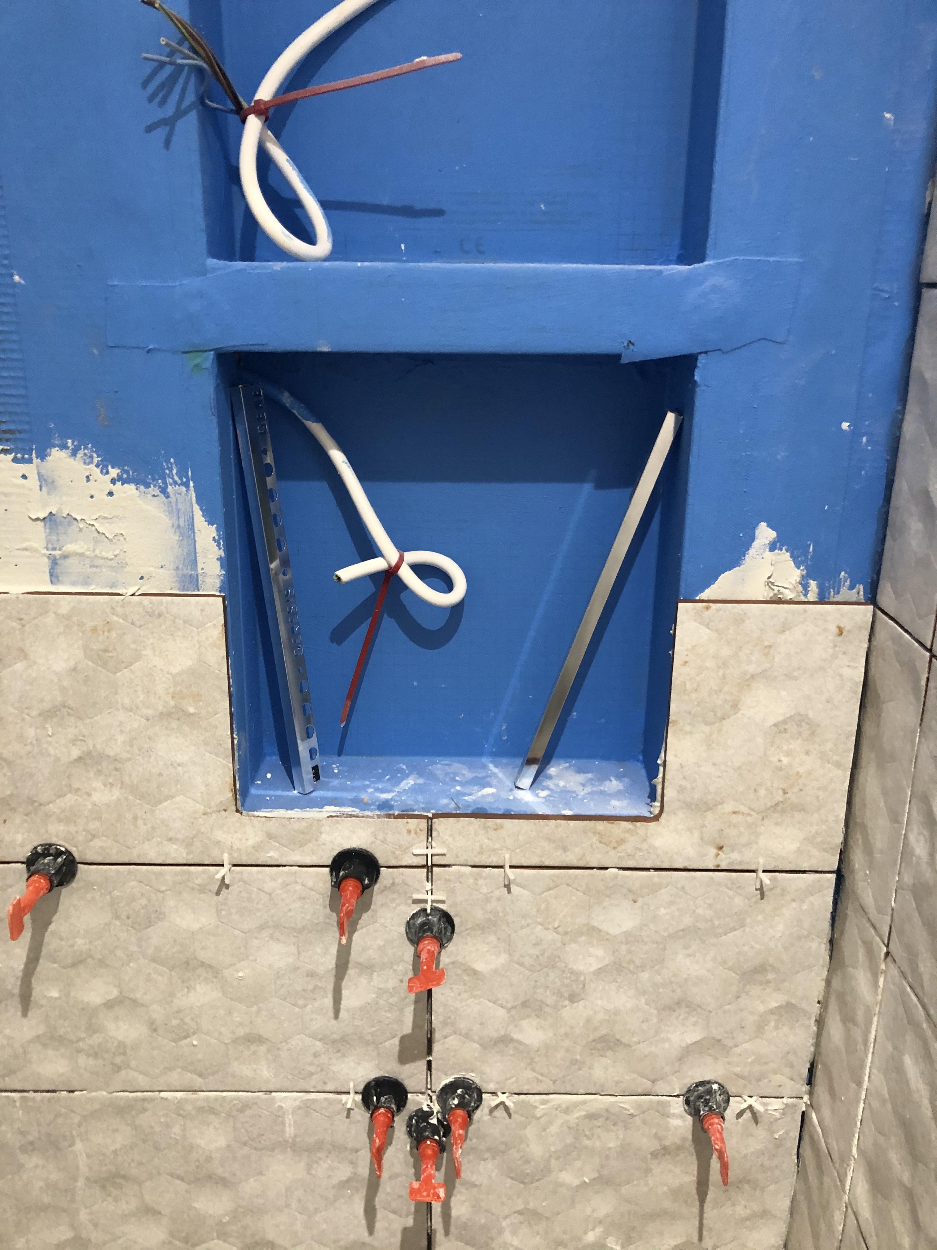

Onoff Posted September 18, 2020 Share Posted September 18, 2020 (edited) This was fun: Back tiles went on first: Then the bottom tile. My bottom tile is at a very slight angle. Then the top tile: Finally the sides: Yellow are 1mm packs. Edited September 18, 2020 by Onoff 1 Link to comment Share on other sites More sharing options...
