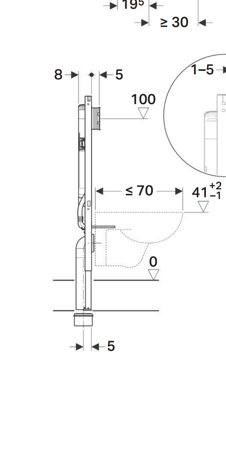

Pocster Posted September 14, 2019 Author Posted September 14, 2019 https://bathroomvillage.com/products/geberit-duofix-wc-frame-with-sigma-8cm-cistern-h114?variant=9004987875380&gclid=EAIaIQobChMIj9iE5uPQ5AIVQbDtCh2GXwtDEAQYAiABEgIVavD_BwE It says depth 80 - 110 . Is that simply the ‘range’ of depth it fits or does it mean depending on installation it could be 110?
PeterW Posted September 14, 2019 Posted September 14, 2019 4 minutes ago, pocster said: https://bathroomvillage.com/products/geberit-duofix-wc-frame-with-sigma-8cm-cistern-h114?variant=9004987875380&gclid=EAIaIQobChMIj9iE5uPQ5AIVQbDtCh2GXwtDEAQYAiABEgIVavD_BwE It says depth 80 - 110 . Is that simply the ‘range’ of depth it fits or does it mean depending on installation it could be 110? Ignore the sales sites, go direct to the technical pages on Geberit website. https://catalog.geberit.co.uk/en-GB/products/CH2_100901/Systems/Installation-and-Flushing-Systems/Geberit-Duofix/Frames 1
Onoff Posted September 14, 2019 Posted September 14, 2019 1 minute ago, pocster said: https://bathroomvillage.com/products/geberit-duofix-wc-frame-with-sigma-8cm-cistern-h114?variant=9004987875380&gclid=EAIaIQobChMIj9iE5uPQ5AIVQbDtCh2GXwtDEAQYAiABEgIVavD_BwE It says depth 80 - 110 . Is that simply the ‘range’ of depth it fits or does it mean depending on installation it could be 110? H114 doesnt have thd odour extract facility to connect to your MVHR I don't think unless you diy it like Jeremy and now I have. This page gives the current frames and usefully the flush plates available: https://www.geberit.co.uk/products/installation-systems/geberit-duofix/ 1
Pocster Posted September 14, 2019 Author Posted September 14, 2019 Hmmmm , the geberit website says 80 - 110 aswell . Peters link says 14/5 .... ?

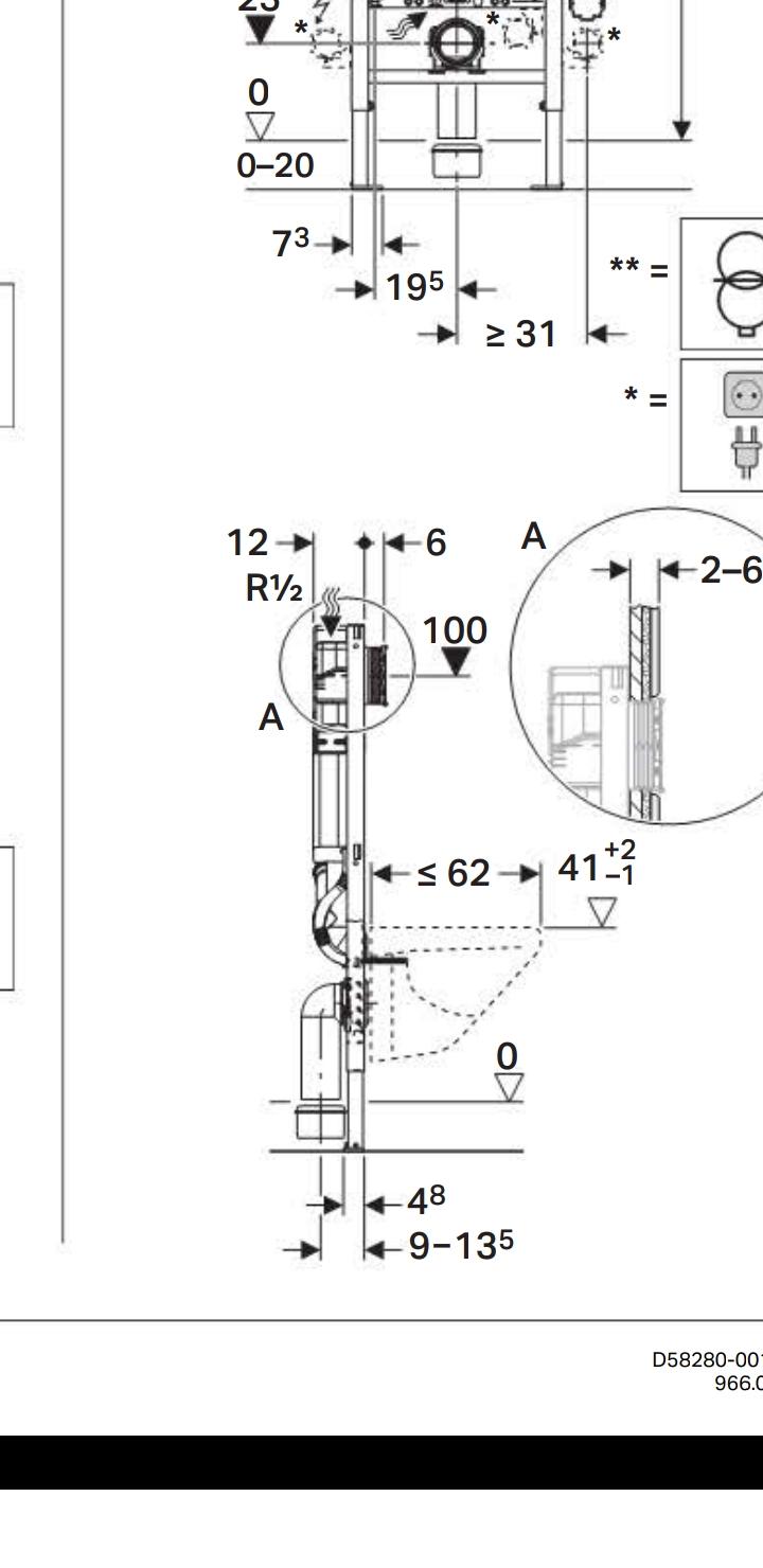

Onoff Posted September 14, 2019 Posted September 14, 2019 Data sheet for H114: ProductDataSheet_PRO_168879.pdf You're better using the product number when searching for best price etc imo for the 8cm one its: 111.799.00.1 Maybe look at the 12cm 111.353.00.5? Has odour take off. Installation bumpf here: 2013-7-29--10-13-50-231.pdf & 2013-7-29--10-13-39-425.243.00.0_00.pdf
Pocster Posted September 14, 2019 Author Posted September 14, 2019 26 minutes ago, Onoff said: Data sheet for H114: ProductDataSheet_PRO_168879.pdf 120.68 kB · 1 download You're better using the product number when searching for best price etc imo for the 8cm one its: 111.799.00.1 Maybe look at the 12cm 111.353.00.5? Has odour take off. Installation bumpf here: 2013-7-29--10-13-50-231.pdf 1.43 MB · 1 download & 2013-7-29--10-13-39-425.243.00.0_00.pdf 345.28 kB · 0 downloads Thanks . Not sure 12cm will fit . The depth from timber frame until ufh is 100cm I’ll stick some photos up with dimensions so advice can be given ! . How does ‘odor’ extract work ? Fan in bog ? ??

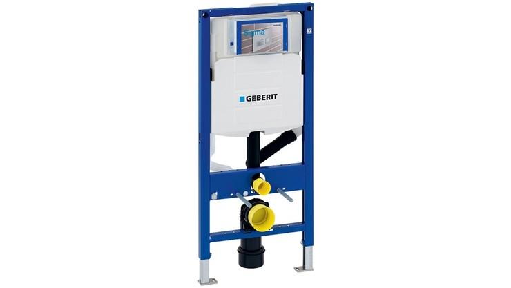

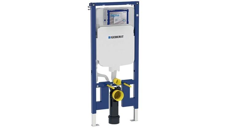

Onoff Posted September 14, 2019 Posted September 14, 2019 See the flush pipe comes up to the cistern, it branches off to the right at an angle. Until you flush the vertical pipe is empty to the pan so can suck up any nasty niffs. That angled pipe links to your extract: Whereas the 8cm one lacks the angled take off pipe:
Onoff Posted September 14, 2019 Posted September 14, 2019 17 minutes ago, pocster said: The depth from timber frame until ufh is 100cm You could add battens to your wall studs to deepen them a bit? 1
PeterW Posted September 14, 2019 Posted September 14, 2019 Shouldn’t need it as a Sigma frame comfortably fits inside a 95mm stud wall. 1
Onoff Posted September 14, 2019 Posted September 14, 2019 (edited) 7 minutes ago, PeterW said: Shouldn’t need it as a Sigma frame comfortably fits inside a 95mm stud wall. The 8cm one does: But this is the 12cm one with the odour extract (could be wrong): Edited September 14, 2019 by Onoff
