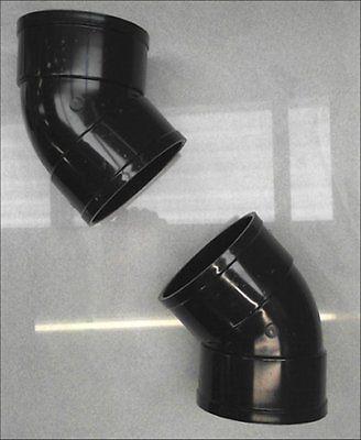

Loads of options from a couple of offsets like this:

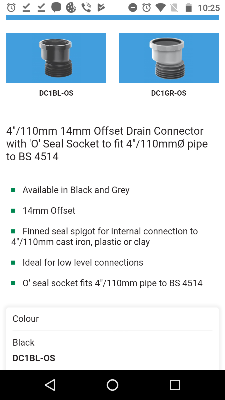

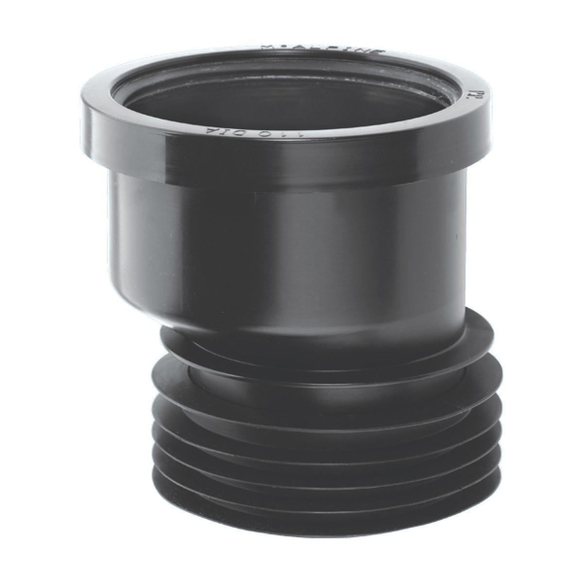

To a minimal offset like this:
mcalpine-dc1bl-os-offset-drain-connector.thumb.jpg.ea34941a446ea9e1e16efccf6323017c.jpg
I ended up having to fit one of the small offsets (like the lower one in the photo above) at the base of our soil stack for the same reason, the pipe came up a bit too tight to the inside of the wall at the rear of the house.  I chipped out a bit of space around the vertical pipe where it came up through the slab and slotted the offset fitting down into it so that the stack then cleared the inside face of the wall OK.  Seems to work fine, it's been in and working for over 5 years now.
That is a clay adapter and not an offset ..! It’s got a ridge in it that will collect crap....
@epsilonGreedy the correct gap is 35-40mm so you can get a branch with a boss in there, and you should also have a bracket or two to stop it vibrating when there is a flush dropping down it.
Best you contact McAlpine then and tell them they've got it wrong and that it can only be used to go into clay...
I went into this in detail when I had the problem, and someone on Ebuild suggested I use the McAlpine offset connector (can't remember who).  I ended up getting advice and was told that the fitting was perfectly OK for use at the base of a vertical soil stack.  TBH, I can't see how anything could get caught inside it, as there is a significant slope on the offset step inside.
+1
Used to be listed as an internal clay and iron adapter (hence the finned seal), not seen one listed as a plastic adapter before so looks like it could work.
I don’t like anything with steps or edges in them but assume it works fine.
