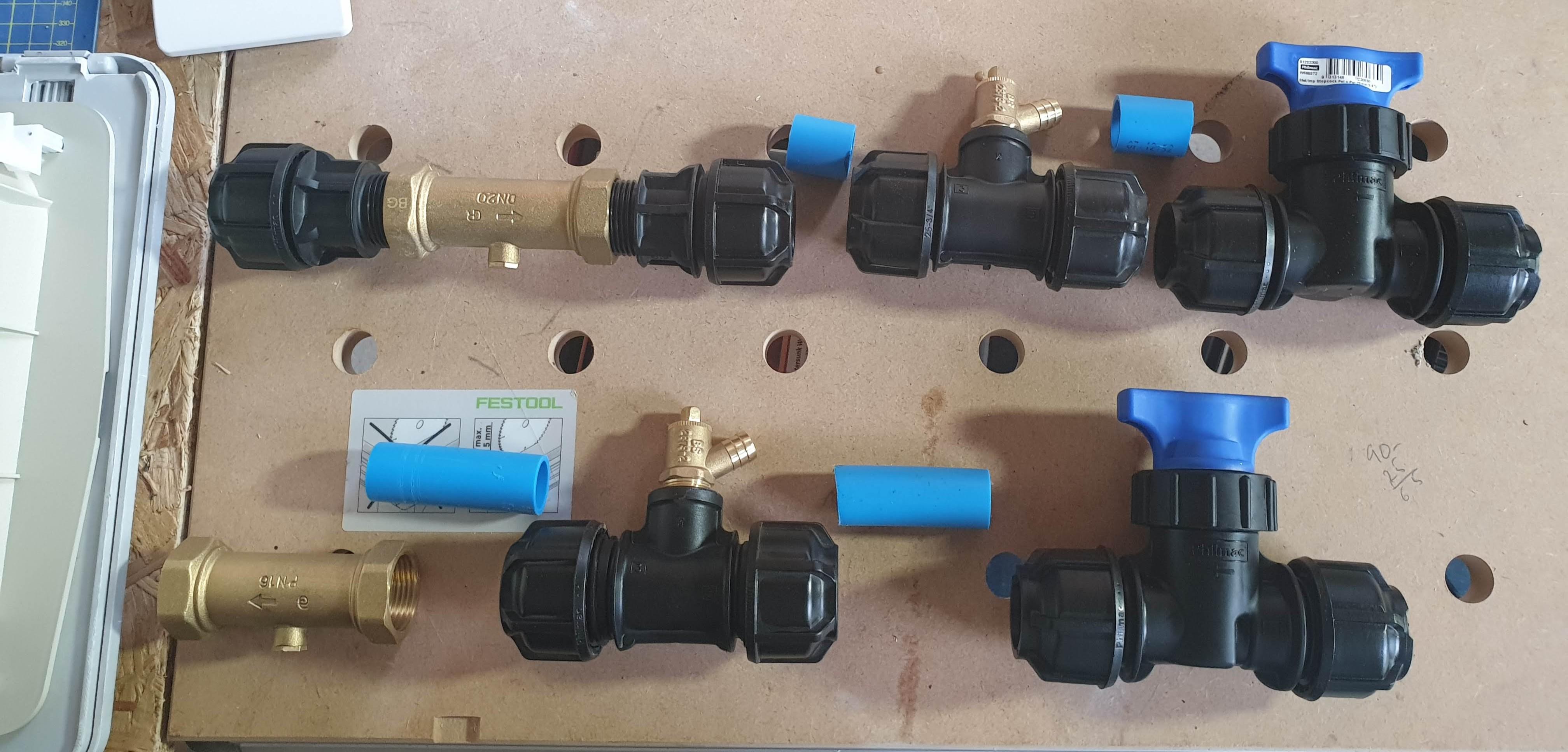

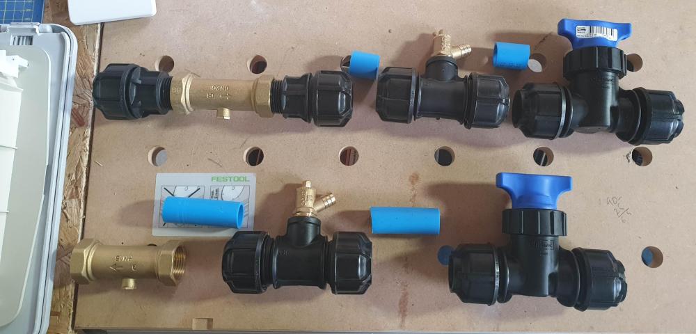

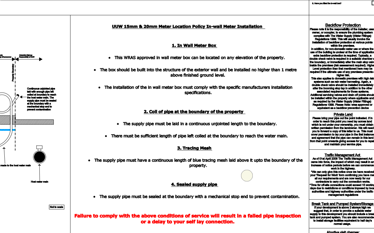

ToughButterCup Posted August 6, 2019 Share Posted August 6, 2019 I think I have followed both the manufacturer's guidelines (Atlantic Plastics, Talis Intex 2) and those issued by United Utilities. In the same vein as this post, could you please have a look - thanks. I'm a bit jumpy about getting this right because UU are coming to inspect my work soon. I'm not that confident about it either...... This is the layout of the; stop tap, non return valve , and the drain off tap. Bottom 'row' is incoming, top 'row' outgoing Thanks @Conor and @epsilonGreedy. I'll be sure to Moisten everything before tightening. (why?) Not use PTFE tape. Tighten just beyond hand tight. (instructions say the thread should not be visible) Use a Sharpie to mark a depth guide to help me check the 'fit' By accident, it seems the incoming pipe may well come out of the ground at the correct angle to match up with the meter box. I'll have more on that adventure later today. Is the sequence of piping and valves correct above, please? Thanks Ian 1 Link to comment Share on other sites More sharing options...
MikeSharp01 Posted August 6, 2019 Share Posted August 6, 2019 Are you being allowed to run from the local main into the water meter yourself, this is usually a utility type job? 1 Link to comment Share on other sites More sharing options...

Construction Channel Posted August 6, 2019 Share Posted August 6, 2019 Will you be putting inserts/stiffeners into the blue bits of pipe? Are all the fittings wras approved? Link to comment Share on other sites More sharing options...
soapstar Posted August 6, 2019 Share Posted August 6, 2019 stiffeners are a must or you will crush the pipe Link to comment Share on other sites More sharing options...

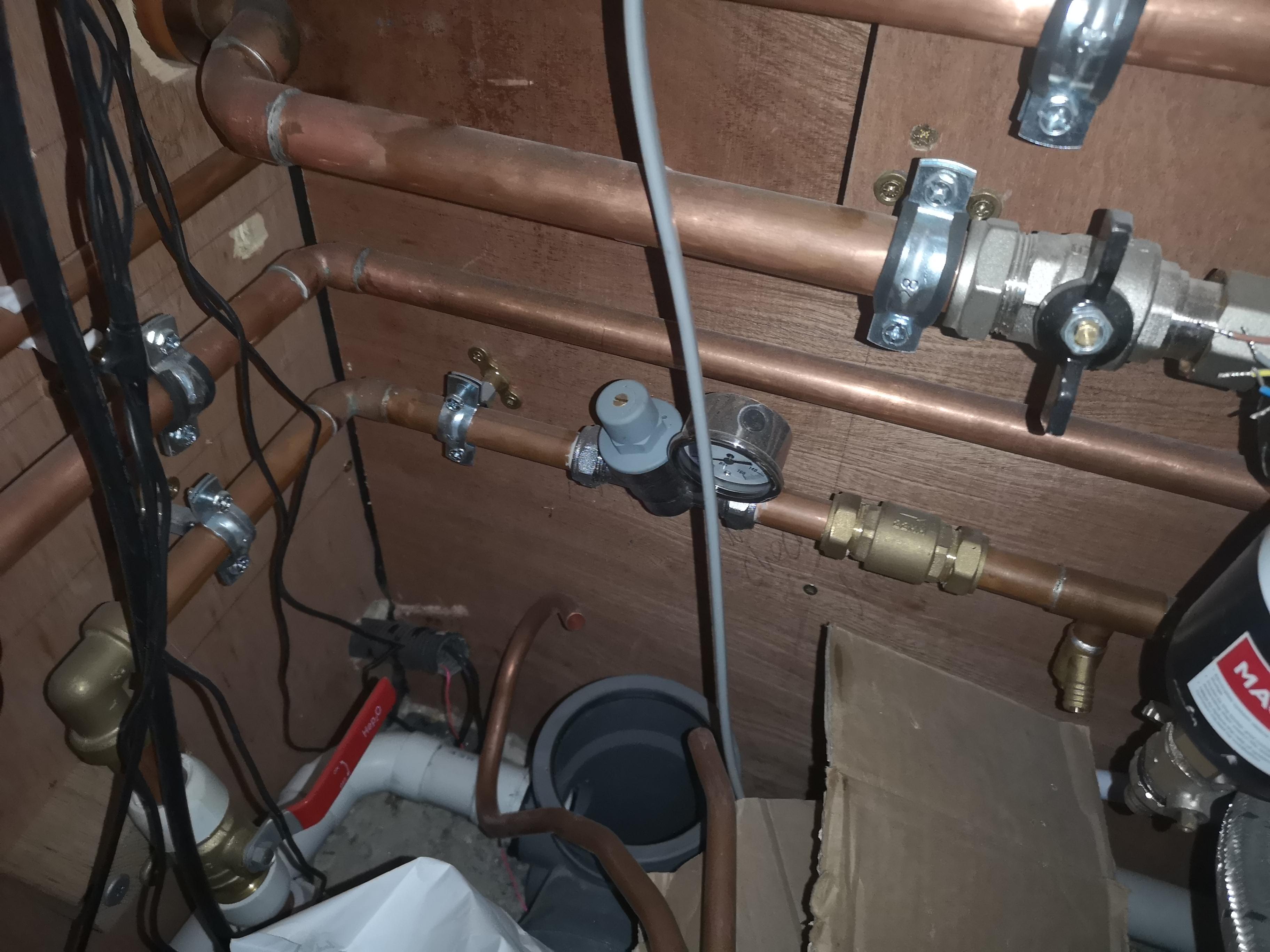

Construction Channel Posted August 6, 2019 Share Posted August 6, 2019 Hang on. I think you might have the non return and the drain the wrong way round. At the moment you will only be able to drain the section of pipe between the other two bits if I'm looking at this right. Link to comment Share on other sites More sharing options...
Construction Channel Posted August 6, 2019 Share Posted August 6, 2019 This is my incoming which I think is right. (ignore the mess) Link to comment Share on other sites More sharing options...
ToughButterCup Posted August 6, 2019 Author Share Posted August 6, 2019 7 hours ago, MikeSharp01 said: Are you being allowed to run from the local main into the water meter yourself, this is usually a utility type job? Yes. United Utilities require me to: from a meter or so short of the main to the meter itself. Link to comment Share on other sites More sharing options...

ToughButterCup Posted August 6, 2019 Author Share Posted August 6, 2019 1 hour ago, Construction Channel said: This is my incoming which I think is right. Ermmmmm Ed, you were in a rush to post , I can tell Have I got this right on your photo above: In through the big red valve Past the pressure gauge Through the non return valve To the drain point And what you suggest I should do is - on the incoming bottom row of mine In through the blue valve (bottom right) Then the non-return valve Then the drain point. On the outgoing top row Put the drain valve downstream (to the right of) the blue stop valve Should I - like you - put a pressure gauge in ? I have a pressure tester (4 bar at the furthest end of our system in our current house - next door) Link to comment Share on other sites More sharing options...

PeterW Posted August 6, 2019 Share Posted August 6, 2019 1 minute ago, AnonymousBosch said: Should I - like you - put a pressure gauge in ? Thats not a pressure gauge - it’s a PRV (Pressure Reducing Valve) and is probably preset at 3 bar. Useful as a failsafe if you don’t have an invented cylinder, but not a replacement for the control group that comes with the UVC. That sort of PRV reduces the flow too, so I tend to set at 4.5 bar and let the control group drop it to 3 bar before the cylinder. Link to comment Share on other sites More sharing options...

Construction Channel Posted August 6, 2019 Share Posted August 6, 2019 10 minutes ago, AnonymousBosch said: Ermmmmm Ed, you were in a rush to post , I can tell Have I got this right on your photo above: In through the big red valve Past the pressure gauge Through the non return valve To the drain point And what you suggest I should do is - on the incoming bottom row of mine In through the blue valve (bottom right) Then the non-return valve Then the drain point. On the outgoing top row Put the drain valve downstream (to the right of) the blue stop valve Should I - like you - put a pressure gauge in ? I have a pressure tester (4 bar at the furthest end of our system in our current house - next door) Probably yes to all but I don't fully under stand the prv part yet. I have been told and why it is where it is but that's still a grey area for me atm. As for the position of the drain and the non check valve. The check stops any water from going backwards. The drain is to empty your house system if you really needed to go that far. In your picture the check valve would stop your house from emptying. I also don't fully understand where your outgoing one is going? Link to comment Share on other sites More sharing options...
ToughButterCup Posted August 6, 2019 Author Share Posted August 6, 2019 11 minutes ago, PeterW said: Thats not a pressure gauge - [...] Ta! Is there any point in putting a pressure gauge in ? Link to comment Share on other sites More sharing options...

ProDave Posted August 6, 2019 Share Posted August 6, 2019 I fitted that type of PRV on the feed to the static caravan (because I did not trust the lousy push fit caravan plumbing to withstand >6 bar) On initial connection, it would not regulate. on strip down I found a bit of grit, cleaned it out and it worked. This summer, after having the water to the 'van off all winter, it won't regulate pressure again. I have yet to strip it down to find out what has upset it this time. Link to comment Share on other sites More sharing options...

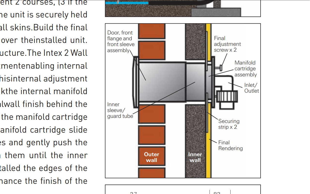

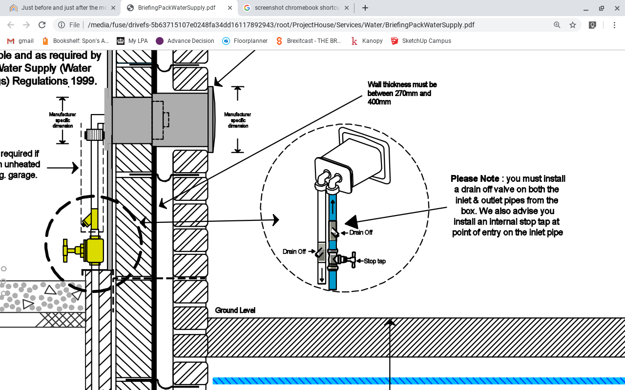

ToughButterCup Posted August 7, 2019 Author Share Posted August 7, 2019 Edward ( @Construction Channel ) you are a star, my son. I had another look at the instructions: The image as presented confused me because of the way the inlet and outlet pipes are portrayed : inlet on the right (in the call-out circle) and outlet on the left. In the meter box I have, the pipes are reversed. What matters is the arrows (indicating flow), not the position of the pipe (inlet left or right hand side). Your post , made me look at the situation again. Thanks. Now I am not going to bother with the NRVs (non return valve) in the Piggery. I am going to fit them in the house instead. That'll reduce the likelihood of error (in the meter fitting process) on my part greatly. Just for completeness, I add a screenshot of UU's general instructions in the hope it might help people planning their water supply strategy. and finally here's the manufacturer's cross-section drawing for the meter box : note the fixing straps (securing straps) for the 'inner' box - they look pretty flimsy to me. I'll post pictures of the final installation later today. Thanks everyone for the posts - for me it's especially valuable to see a range of opinion. Carefully argued, politely expressed and closely evidenced opinion, dissenting or not, is healthy. Link to comment Share on other sites More sharing options...
