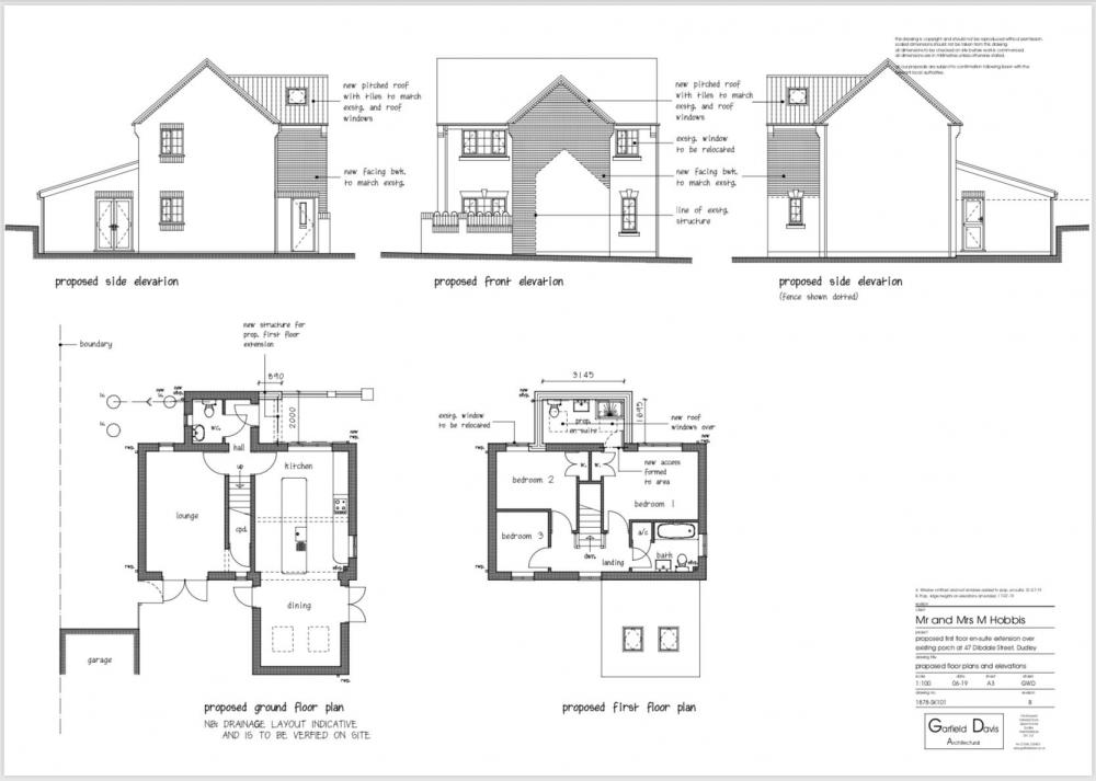

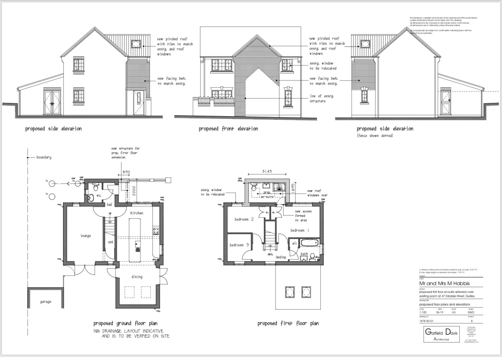

MarkJay13 Posted August 4, 2019 Share Posted August 4, 2019 Good Morning We are looking to build above our downstairs w/c to make a en-suite, but unfortunately our council have send the below email, we are unsure what they mean regards to below 1/ does not address the street? ALL other houses have a 2 storey section protruding from the house as our proposal 2/ proximity to highway? Our proposal brings us nowhere nearer to the path or road? Any advice what else they mean would be appreciated After a site visit and an initial assessment of the application, it is the view of the Local Planning Authority that we would not look to support a the proposed extension in the current design, as the proposed design does not address the street and given its proximity to the highway this is something that would be needed. Given the plot the house is sited on, alternative extensions are possible which would be looked at more favourably than the current proposal, such as either a side or rear. It is the view of the LPA that due to the siting of the extension and the design that does not address the street, we would not look to support the application in its current form. If you may wish to look at the above options as alternatives. Thanks in Advance Mark Link to comment Share on other sites More sharing options...

ProDave Posted August 4, 2019 Share Posted August 4, 2019 My only observation is that present gable end looks stark and uninviting, i.e. no windows or features. Design the extension to look nicer, e,g with a window or some other features. If they refuse it, there has to be a planning policy reason for refusal. I would like to see them show the planning policy that says "it does not address the street" If they start discussing it with you just make it clear you will appeal if it is refused. 2 Link to comment Share on other sites More sharing options...

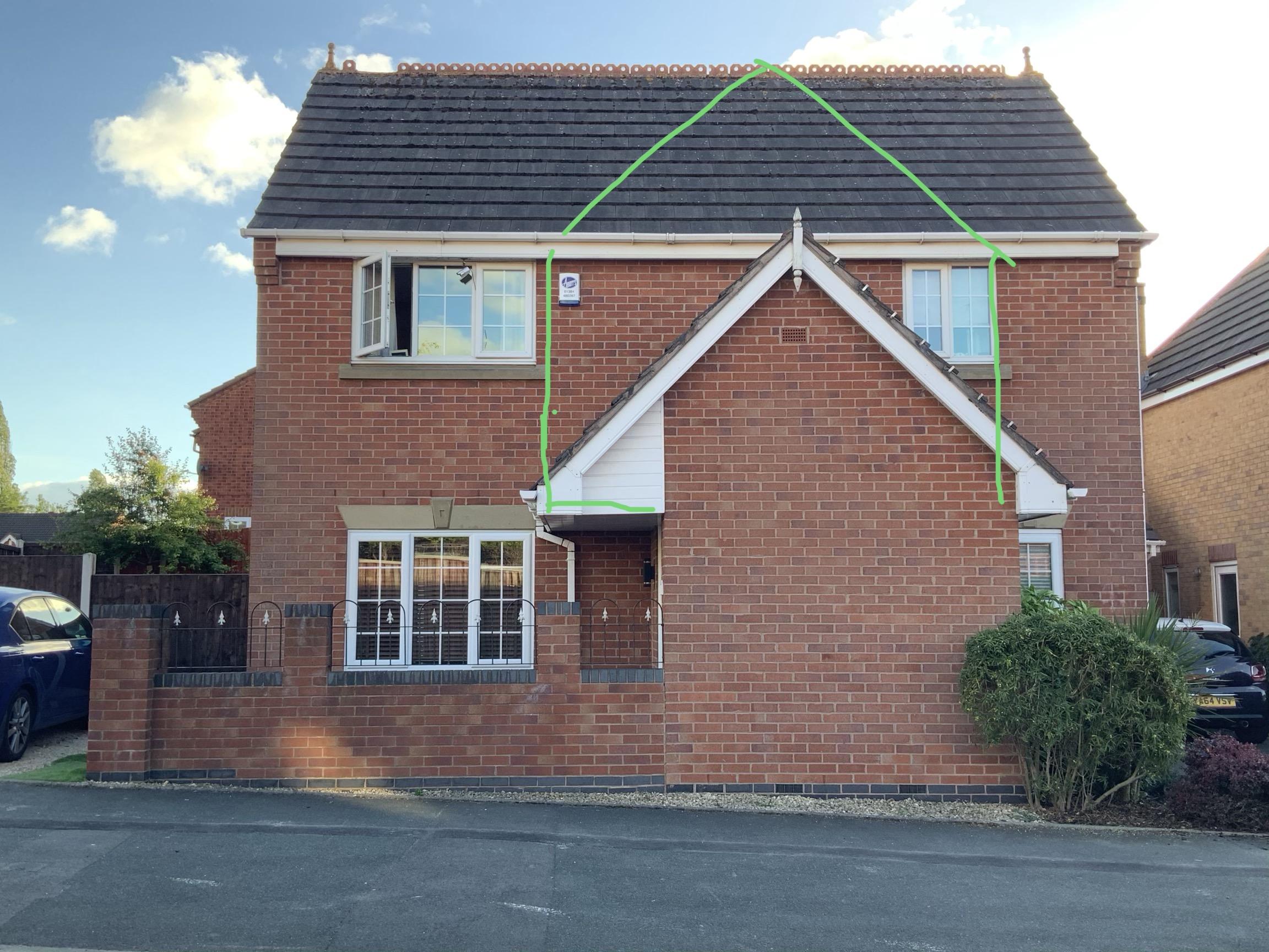

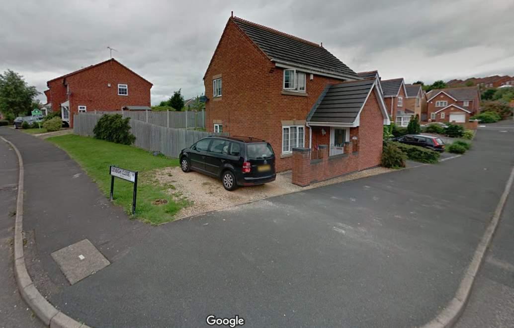

Ferdinand Posted August 4, 2019 Share Posted August 4, 2019 (edited) Looking at a slightly broader picture of the house on its corner, I can see a planner being unhappy about it not being quite clear which side is the "front". I think it mainly reads as if the frontage is on the right, whilst the porch and main door face the other way. You may win by leaning on them, but OTOH a clearer appearance of facades may help you too. Suspect this is an aspect of the "looK" that got through by default on the developer plan, and the "lot fell on you" (unfortunately). Looking through StreetView the other houses have an appearance where the entrance reads in the same orientation as the house. I think it is an artefact of being too close to the RH road originally to have the porch the other way round. As to what to do, I would suggest a further conversation to explore their reasons. What were the alternatives offered? I think that changing the roof plane by 90 degrees to face the other way could do it, as could some treatment to soften it - that could be something like a window, or even a climber up the existing. I think you get a free go having been refused, and I suggest asking how you can adjust it, and perhaps putting an artists impression in this time. That is some good garden sideways expansion someone has done there. ? Ferdinand Edited August 4, 2019 by Ferdinand Link to comment Share on other sites More sharing options...

bassanclan Posted August 4, 2019 Share Posted August 4, 2019 Have you got a picture or street view of the other houses on the street with the 2 storey protrusion? 1 Link to comment Share on other sites More sharing options...
Ralph Posted August 4, 2019 Share Posted August 4, 2019 1 hour ago, ProDave said: My only observation is that present gable end looks stark and uninviting, i.e. no windows or features. Design the extension to look nicer, e,g with a window or some other features. I think that's pretty much what is meant by addressing the street. I have seen it in other planning documents. Link to comment Share on other sites More sharing options...

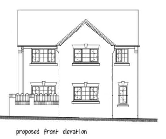

Temp Posted August 4, 2019 Share Posted August 4, 2019 (edited) 4 hours ago, MarkJay13 said: 1/ does not address the street? ALL other houses have a 2 storey section protruding from the house as our proposal 2/ proximity to highway? Our proposal brings us nowhere nearer to the path or road? Any advice what else they mean would be appreciated After a site visit and an initial assessment of the application, it is the view of the Local Planning Authority that we would not look to support a the proposed extension in the current design, as the proposed design does not address the street and given its proximity to the highway this is something that would be needed. Their comment in red is one point not two separate points. In plain English... "It doesn't won't look right when viewed from the road and that's important because it is/will be close to the road." 3 hours ago, ProDave said: My only observation is that present gable end looks stark and uninviting, i.e. no windows or features. +1 In my opinion your architect has also made it look worse by shading the extension to show the brick pattern where as the rest of the house is shown unshaded. Try something like this if you can afford the extra windows. The ground floor window could be frosted/wavy glass if its still going to be a WC. Edited August 4, 2019 by Temp Link to comment Share on other sites More sharing options...
Temp Posted August 4, 2019 Share Posted August 4, 2019 Think I might also be tempted to remove the low wall and railings at the front? Replace with planting or just railings? Link to comment Share on other sites More sharing options...
