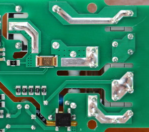

TerryE Posted August 9, 2019 Author Share Posted August 9, 2019 (edited) I've taken the board out and in fact it doesn't look like the relay, but in fact it's a case of a bad/dry contact overheating and failing / melting the connector. The board shows signs of thermal damage around the main relay and the through-hole solder joints have melted out. The actual relay itself is a Schrack RZ03-1A4-D012 which is a 240V/12A rated NO relay with a nominal life of 50,000 switching cycles. What really concerns me about the board is the trace geometry both in terms of cross-section and isolation. IMO, these are far below what you would want for 12A current. See the equivalent tracks in the Sonoff TH16 device below which do conform to CE requirements. Note that the 16A rails have been reflowed with lead to build up their cross-section; all of the little dots on the wide tracks are vias to mirror tracks on the top side of the board. Air gaps are used to isolate physically the phase rail from neutral and 5V logic. I might be able to repair this SunAmp board, but I am be reluctant to use it. PS. I've struck out my previous point on track width. I feel that JSH has addressed this in his comments below. Edited August 10, 2019 by TerryE Link to comment Share on other sites More sharing options...
Jeremy Harris Posted August 9, 2019 Share Posted August 9, 2019 Not sure any isolation is needed, really, as there are no low voltage bits outside the box that can ever be touched. If I had to guess, I'd say that the contact in the connector is the cause of the overheating, not the tracks on the PCB. I think they've just been heated up from the overheating connector. Looking at the connector, I suspect that the cause of the problem is the wire termination to the socket. This looks to be a screw terminal, and Sunamp failed to comply with the requirement to always fit ferrules to stranded wires until fairly recently (our old UniQ control box didn't have ferrules on any wires, the new one does). I'd repair the board if it were me. Get a pair of new connectors, remove the plug from the board, clean everything up and solder the new one in place. Trim back the wires to the socket (to get rid of damaged/corroded bits) fit ferrules to the wires and then fit them to a new socket, making sure all the screws are properly tightened. Loose terminal screws is the number one cause of overheating - happens all the time. 1 Link to comment Share on other sites More sharing options...
TerryE Posted August 9, 2019 Author Share Posted August 9, 2019 (edited) You are right in that I don't know the copper layer thickness but it would need to be about 2-3× the standard depth for this power trace geometry. I totally agree about the ferrules issue. I've had this problem before. Keep you posted. Thanks. Edited August 9, 2019 by TerryE Link to comment Share on other sites More sharing options...
Jeremy Harris Posted August 9, 2019 Share Posted August 9, 2019 5 minutes ago, TerryE said: You are right in that I don't know the copper layer thickness but it would need to be about 2-3× the standard depth for this power trace geometry. I totally agree about the ferrules issue. I've had this problem before. Keep you posted. Thanks. The copper doesn't look to have been overheating, though, so my guess is that they've probably used something like 4oz board, which would be fine for the thickness of those traces and the current they are carrying. I routinely use 4oz board on the motor speed controllers I've built, and some of them work at 50 to 60 A or more without any problems. I've just done some quick and dirty sums, and for normal 2oz board for a trace carrying 12 A continuously, a 25mm long track needs to be at least 4.65mm wide. For the same with 4oz board the track only needs to be 2.35mm wide. The Sonoff, being Chinese, almost certainly uses board with very thin copper. 1oz seems commonplace for Chinese stuff, as it reduces the cost of manufacture a lot (the board is cheaper and it takes half the time to etch 1oz, rather than 2oz). Link to comment Share on other sites More sharing options...
TerryE Posted August 9, 2019 Author Share Posted August 9, 2019 (edited) 2 minutes ago, JSHarris said: I've just done some quick and dirty sums, and for normal 2oz board for a trace carrying 12 A continuously, a 25mm long track needs to be at least 4.65mm wide. What a coincidence: that's what I worked out. I don't know about the Sonoff's. In the quantities that they use they might chose to use 2oz for the top layer. You just don't know, but really need to rely on the CE certification lab doing their job. Edited August 9, 2019 by TerryE Link to comment Share on other sites More sharing options...

TerryE Posted August 13, 2019 Author Share Posted August 13, 2019 (edited) OK, the board was rather more damaged than I feared. Here are the before and after with the new connector fitted. The two RH pins below had got so hot that the through-hole liners very damaged and partially delaminated from the PCB, as had the RH trace. This is why I bulked up the track between the connector and the next through-hole component (this was the common a.k.a. AC neutral) The image below shows the refitted unit with is working OK. @JSHarris Note the crimped ferrule connectors I've got a DS18B20 taped to the replacement connector to see if I have any thermal issues, but it does seem to be working fine. PS. The 2nd pin (the 240V phase line to the heater) is getting rather warm. I think that this is because this track is probably also lifting near the pin. I will probably need to do the same trick and expose the track to the relay and bulk it up with solder. What I really need is a replacement board. Edited August 13, 2019 by TerryE 4 Link to comment Share on other sites More sharing options...
TerryE Posted August 14, 2019 Author Share Posted August 14, 2019 And here is the updated board. The common line is now beefed up from the input to the output connector, and the phase from the relay output to the output connector. (The latter looks a little untidy because it is covered in a clear potting polymer.) This seems to have done the trick and the board is running cooler. Plugging in the P=I²R numbers, a track resistance of 0.025Ω would generate 5W or so resistive heating, and this is enough to create a hot-spot of 50°C or so on a board without any thermal management of this size -- and this was the rough temperature that my DS11B20 was logging. Before and after 1 Link to comment Share on other sites More sharing options...
