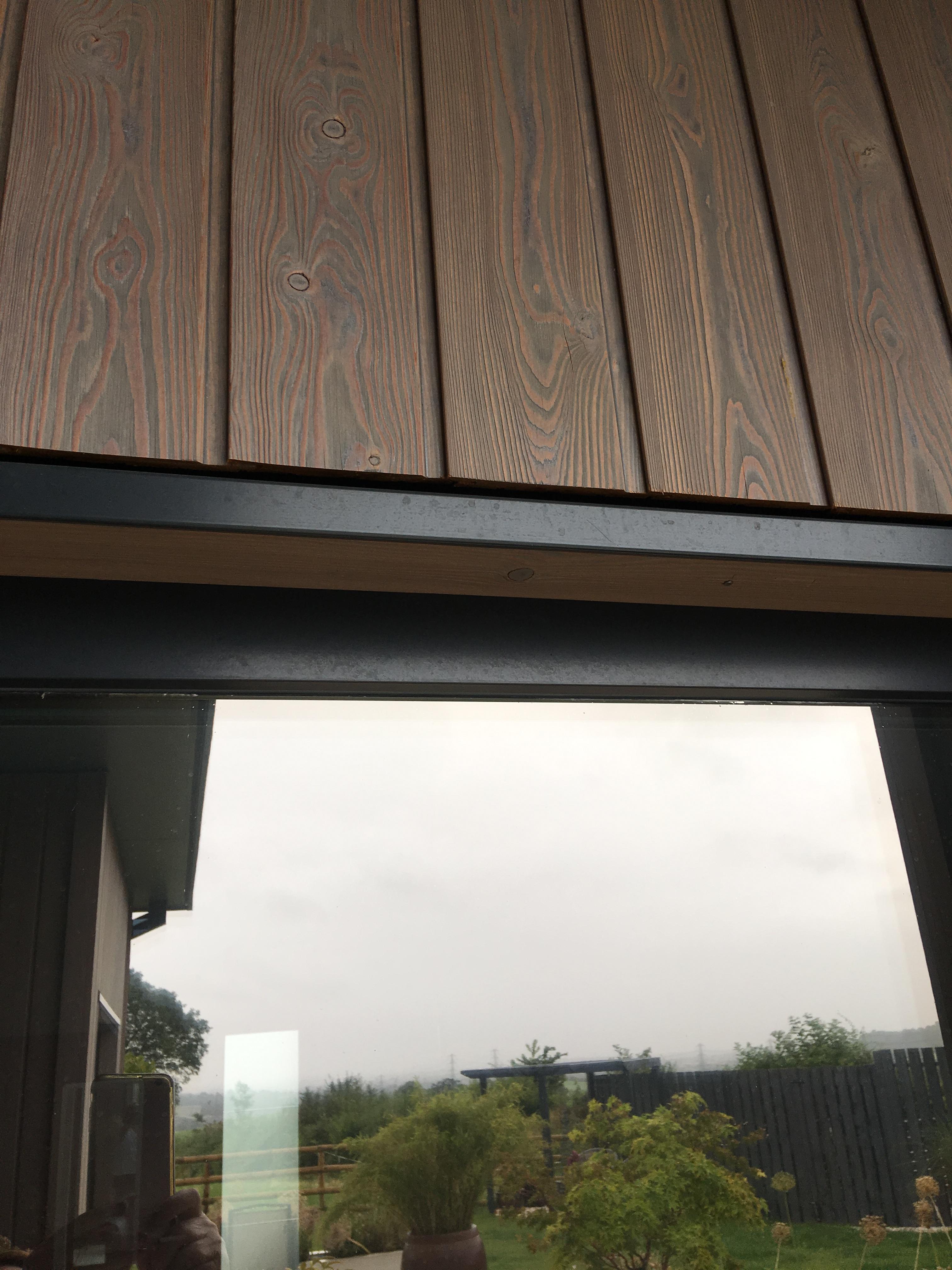

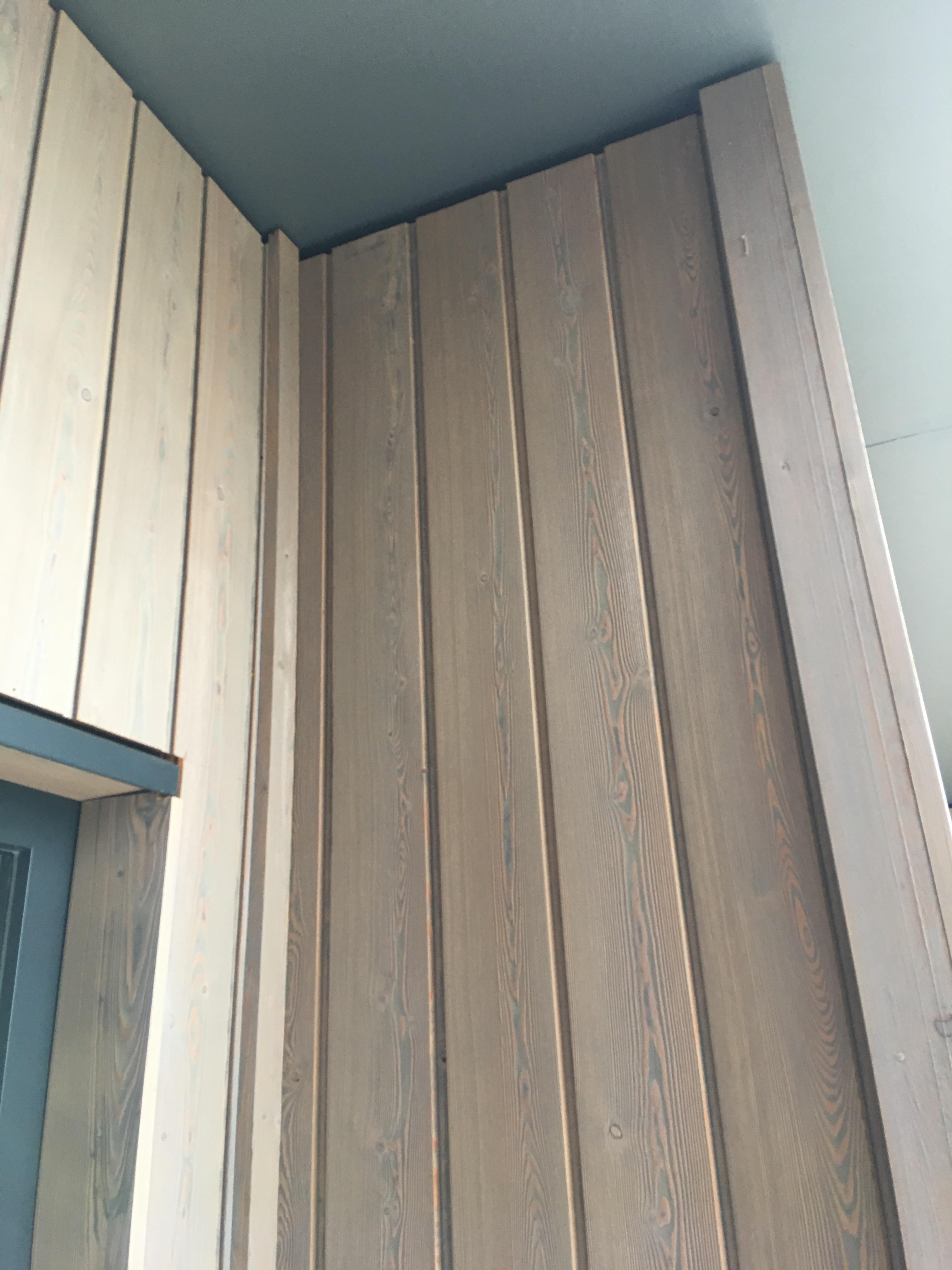

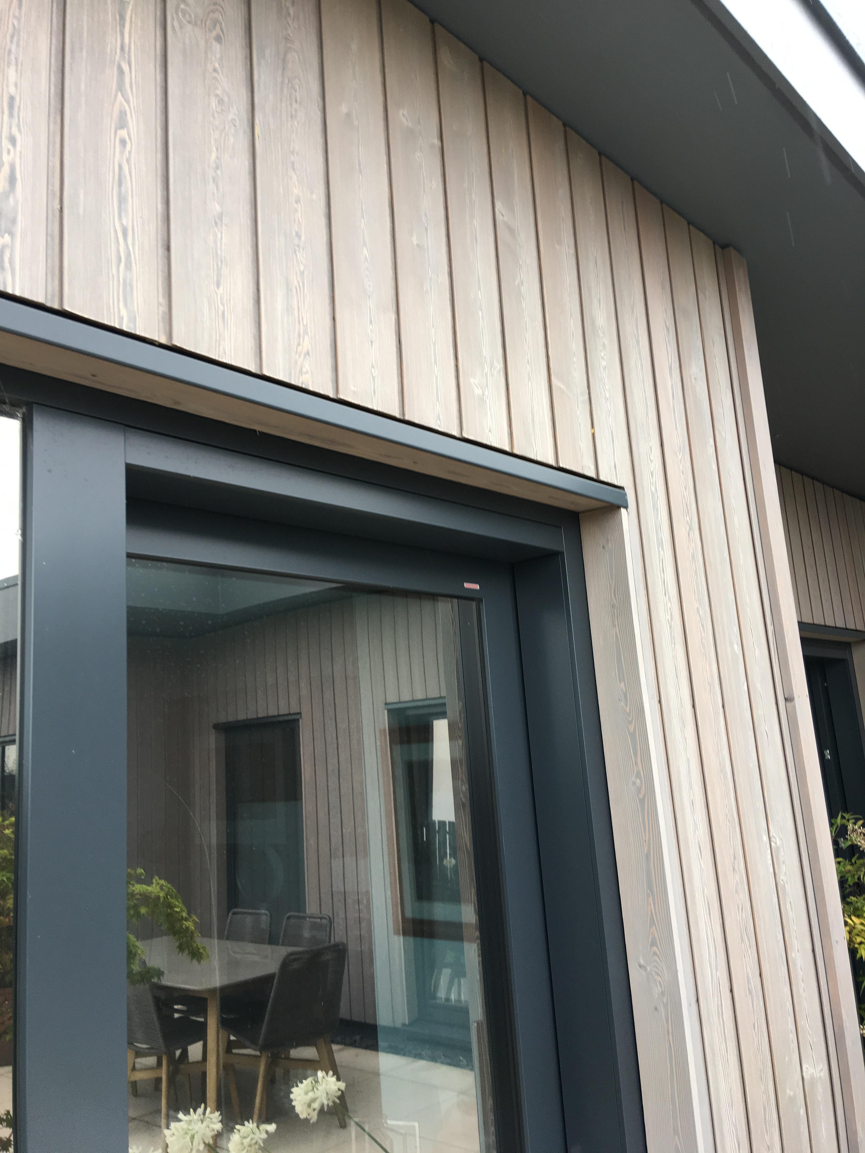

lizzie Posted July 30, 2019 Share Posted July 30, 2019 My vertical cladding goes to soffit and stops just short. I have metal drip over windows. Fabricated and powder coated to match window frames. 4 1 Link to comment Share on other sites More sharing options...
MikeSharp01 Posted July 30, 2019 Share Posted July 30, 2019 That's Chrisp detailing @lizzie love the drips. What is the finish on the timber? 2 Link to comment Share on other sites More sharing options...
lizzie Posted July 30, 2019 Share Posted July 30, 2019 Just now, MikeSharp01 said: That's Chrisp detailing @lizzie love the drips. What is the finish on the timber? Thank you. Its Siberian Larch Sivalbp with New Age Gris sacrificial coating for even weathering Link to comment Share on other sites More sharing options...

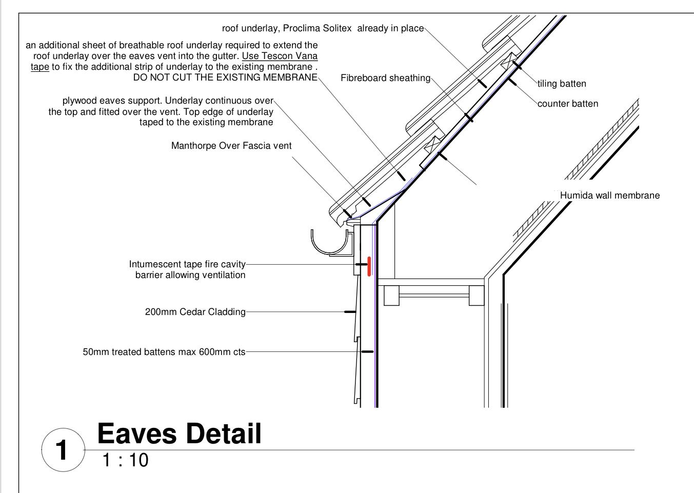

Tin Soldier Posted July 30, 2019 Author Share Posted July 30, 2019 That's really lovely lizzie Mine will be a little more rustic, whether I like it or not Another question I've decided how I will be affixing the larch barge board, question is how close do I put it to the bottom of the slates? They currently overhand a few inches, I intend to but the larch right up to them, subject to someone telling me what I should put in between barge board and the slates or that I should leave a small gap? 1 Link to comment Share on other sites More sharing options...
Cambs Posted July 30, 2019 Share Posted July 30, 2019 29 minutes ago, Tin Soldier said: That's really lovely lizzie Mine will be a little more rustic, whether I like it or not Another question I've decided how I will be affixing the larch barge board, question is how close do I put it to the bottom of the slates? They currently overhand a few inches, I intend to but the larch right up to them, subject to someone telling me what I should put in between barge board and the slates or that I should leave a small gap? Here’s my detail. Roofing company have suggested that I move the fascia board up by 50mm so that it aligns with the batten and counter batten. Note the requirement for a fascia vent - Manthorpe over fascia vent below Link to comment Share on other sites More sharing options...

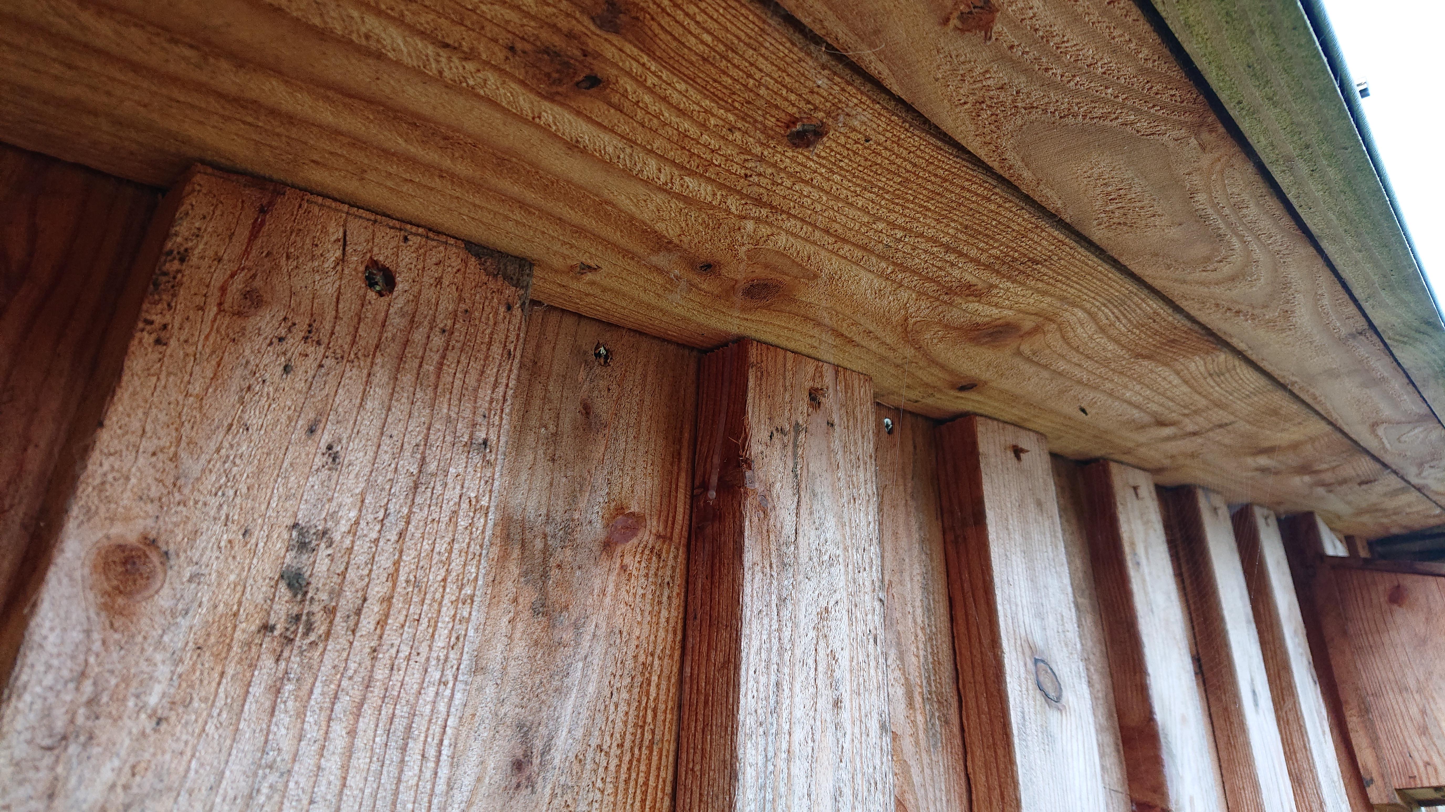

Miek Posted July 31, 2019 Share Posted July 31, 2019 This is a pic of my shed cladding, larch sawn board on board. Link to comment Share on other sites More sharing options...
