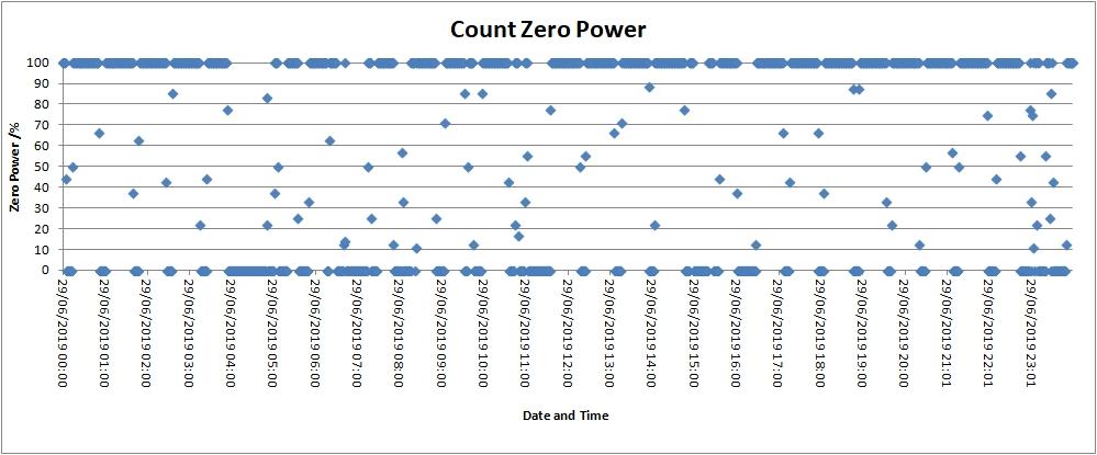

SteamyTea Posted July 27, 2019 Posted July 27, 2019 On 27/07/2019 at 11:54, Dan Feist said: No, just have PHPP estimated values. Expand Trouble with that is it just gives daily, weekly, monthly or annual loads, does not help much in finding out when you import and when you would export. May be worth getting an energy logger and finding out what you use in your current place. As an example, I found out recently that I import no energy 60% of the time. That is not a contiguous 60%, but a few minutes every half hour or so. Below is an example of a typical day.
ProDave Posted July 27, 2019 Posted July 27, 2019 On 27/07/2019 at 13:47, SteamyTea said: Trouble with that is it just gives daily, weekly, monthly or annual loads, does not help much in finding out when you import and when you would export. May be worth getting an energy logger and finding out what you use in your current place. As an example, I found out recently that I import no energy 60% of the time. That is not a contiguous 60%, but a few minutes every half hour or so. Below is an example of a typical day. Expand The 2 things you are missing in your evaluation, is you change your behaviour. It is better in summer to use the washing machine etc at mid day mostly for free, than use it at night on the E7 rate. And your immersion dump controller automatically sends spare power to the immersion heater whenever available, even if only for 30 seconds at t time.
SteamyTea Posted July 27, 2019 Posted July 27, 2019 On 27/07/2019 at 13:56, ProDave said: even if only for 30 seconds at t time. Expand Yes, I agree, but was highlighting the problems of choosing the correct battery/storage size, and the importance of data logging. 1
