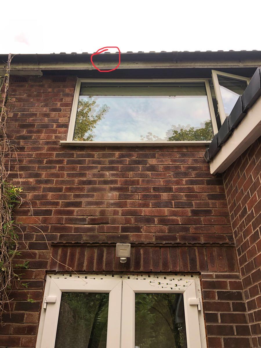

daiking Posted July 23, 2019 Posted July 23, 2019 I need to replace this light but the reason it doesn’t work is that the gutter is missing a clip so it sags and pisses rain straight onto the light. But I can’t work out how to get up there with a ladder safely. There’s no where to land the top of the ladder that isn’t window or gutter. Don’t think a stand-off beneath the window would work, I’d need to be stood at about that height to reach.

Ferdinand Posted July 24, 2019 Posted July 24, 2019 is there space to land a ladder on the top lintel of the window? Looks like a row of bricks above it. Though personally I would hate doing it. Cleaning a gutter at that height is bad enough. It would be a scaff tower for me. F
joe90 Posted July 24, 2019 Posted July 24, 2019 Difficult to see from the pic but I reckon a ladder would rest on the lintel/brick above the window.
daiking Posted July 24, 2019 Author Posted July 24, 2019 (edited) I'll report back with some hire quotes but I didn't think it would fit in a normal car. And there is no brick work above the window. The dark bit is the black underside of the facsia board assembly and its pretty much in line with the top of the window. Its not really any easier to see in the uncompressed photo due to the light/dark contrast. I'll take one from inside the bedroom later to show. Edited July 24, 2019 by daiking

joe90 Posted July 24, 2019 Posted July 24, 2019 Length of 2x4 (longer than width of window) screwed to top of ladder to bridge the window resting on the brickwork either side ( note, I used to be a climber and don’t hold with all this health and safety stuff, bit like @JSHarris mounting his new external kit!!!). 2
Jeremy Harris Posted July 24, 2019 Posted July 24, 2019 I'd agree with @joe90, strap a bit of timber across the top of the ladder. It won't have much of a load on it, as most of the load in a ladder goes downwards. I'd probably use a bit of alloy tube, just because I probably have a bit and it'd be lighter to lift up. 2

joe90 Posted July 24, 2019 Posted July 24, 2019 3 hours ago, daiking said: Would have been fine for a smaller window but that one is about 2.1m wide and that side return I'm stood in is only 2m wide. Swinging round a 2.4m+ length of 4x2 on the end of a 6m extended ladder in that gap is not the sort of you've been framed moment I'm looking for. Nor do I have a glazier on speed dial. Nah, what could possibly go wrong ?????.tho I agree with @JSHarris about alloy tube being lighter and more manouvarable (if you’ve got some?).
daiking Posted July 30, 2019 Author Posted July 30, 2019 So last weekend I couldn't arrange anything but the weekend was a complete washout anyway. The only benefit of the heavy rain was the opportunity to see what was happening at the overflow point. The excess water was overflowing from the gutter and running down the fascia rather than shooting off the roof and past the gutter. Therefore I am far more confident it is the issue with the missing clip and not the tiles hanging a little low. I also noticed that a couple of the joins were dripping as well so maybe it all needs a bit of work. I could just about managed to fit another downpipe if I could run it down the lean too roof into the gutter on the base of that (which would also need another downpipe)
