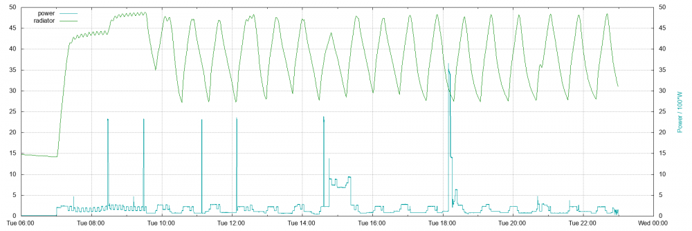

Onoff Posted July 18, 2019 Posted July 18, 2019 46 minutes ago, Toppers said: Can anyone confirm thats it ok to connect UFH to a conventional boiler? I believe that without a buffer tank the boiler can suffer from short cycling?
Carrerahill Posted July 18, 2019 Posted July 18, 2019 (edited) 32 minutes ago, Onoff said: I believe that without a buffer tank the boiler can suffer from short cycling? I may not be a UFH buff but I know enough about boilers to answer this one. It can do but depends on the UFH loads and boilers modulation ratio - a buffer tank is a mitigation measure but an inefficient one at that. So the best way to engineer out short cycling is with with things like a towel rad on the circuit on full flow or heat a central colder area like a hall with a rad which can consume enough to consume enough of the boilers minimum capacity. This of course is only an issue when other rads on the system are drawing very little from the system - if the house is being heated and the system demands enough it won't be an issue. Sometimes having a slightly smaller boiler is actually better than a bigger boiler in these circumstances. Edited July 18, 2019 by Carrerahill

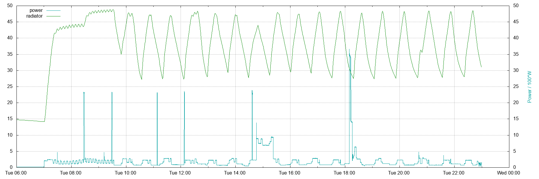

Ed Davies Posted July 18, 2019 Posted July 18, 2019 OTOH, it's likely that a lot of radiator systems short-cycle, too. Here's my rented house for New Year's day this year. Blue line is the overall household electricity consumption and green line is the temperature of the flow to the radiator in the bedroom I use as a study. The heating comes on at 07:00. It runs steadily for about 20 minutes then starts to short cycle as you can see from the castellated power consumption as the blower and oil pump switch on and off. The spike at 08:30 would have been the kettle for tea with breakfast. Not sure why the flow temperature to the radiator changed at about that time, maybe removing something left on a radiator to dry? It continues to cycle until 09:30 when the the thermostat in the living room was satisfied and both the boiler itself and the circulation pump turn off. Some of the other pulses of heating needed early in the day also have a few short cycles. I think there's a problem that plumbers are motivated to oversize boilers. No customer is likely to call them back for a bit of short cycling but if the boiler is underpowered for the coldest days they'll get it in the neck. When the boiler here was replaced I showed a graph like this to the plumber and suggested if he had a choice to round down on the boiler power compared with the previous one. He didn't seem much interested.
Toppers Posted July 18, 2019 Author Posted July 18, 2019 1 hour ago, Carrerahill said: I may not be a UFH buff but I know enough about boilers to answer this one. It can do but depends on the UFH loads and boilers modulation ratio - a buffer tank is a mitigation measure but an inefficient one at that. So the best way to engineer out short cycling is with with things like a towel rad on the circuit on full flow or heat a central colder area like a hall with a rad which can consume enough to consume enough of the boilers minimum capacity. This of course is only an issue when other rads on the system are drawing very little from the system - if the house is being heated and the system demands enough it won't be an issue. Sometimes having a slightly smaller boiler is actually better than a bigger boiler in these circumstances. Our radiators are in regular use, would I need to fit something else?
Carrerahill Posted July 18, 2019 Posted July 18, 2019 6 minutes ago, Toppers said: Our radiators are in regular use, would I need to fit something else? Should be good, the load on the boiler from the rads would probably stop short cycling - it's easy enough solved to be honest so I would not worry.
Carrerahill Posted July 18, 2019 Posted July 18, 2019 8 minutes ago, Ed Davies said: OTOH, it's likely that a lot of radiator systems short-cycle, too. Here's my rented house for New Year's day this year. Blue line is the overall household electricity consumption and green line is the temperature of the flow to the radiator in the bedroom I use as a study. The heating comes on at 07:00. It runs steadily for about 20 minutes then starts to short cycle as you can see from the castellated power consumption as the blower and oil pump switch on and off. The spike at 08:30 would have been the kettle for tea with breakfast. Not sure why the flow temperature to the radiator changed at about that time, maybe removing something left on a radiator to dry? It continues to cycle until 09:30 when the the thermostat in the living room was satisfied and both the boiler itself and the circulation pump turn off. Some of the other pulses of heating needed early in the day also have a few short cycles. I think there's a problem that plumbers are motivated to oversize boilers. No customer is likely to call them back for a bit of short cycling but if the boiler is underpowered for the coldest days they'll get it in the neck. When the boiler here was replaced I showed a graph like this to the plumber and suggested if he had a choice to round down on the boiler power compared with the previous one. He didn't seem much interested. You keep producing lots of good graphs from your house, it makes me think you have a control room and lots of sensors and a home management or at least monitoring system that I suspect you made, can you elaborate if you do? I love metrics, I am looking at an Arduino based BMS for my house just because I can and I love this sort of stuff.
