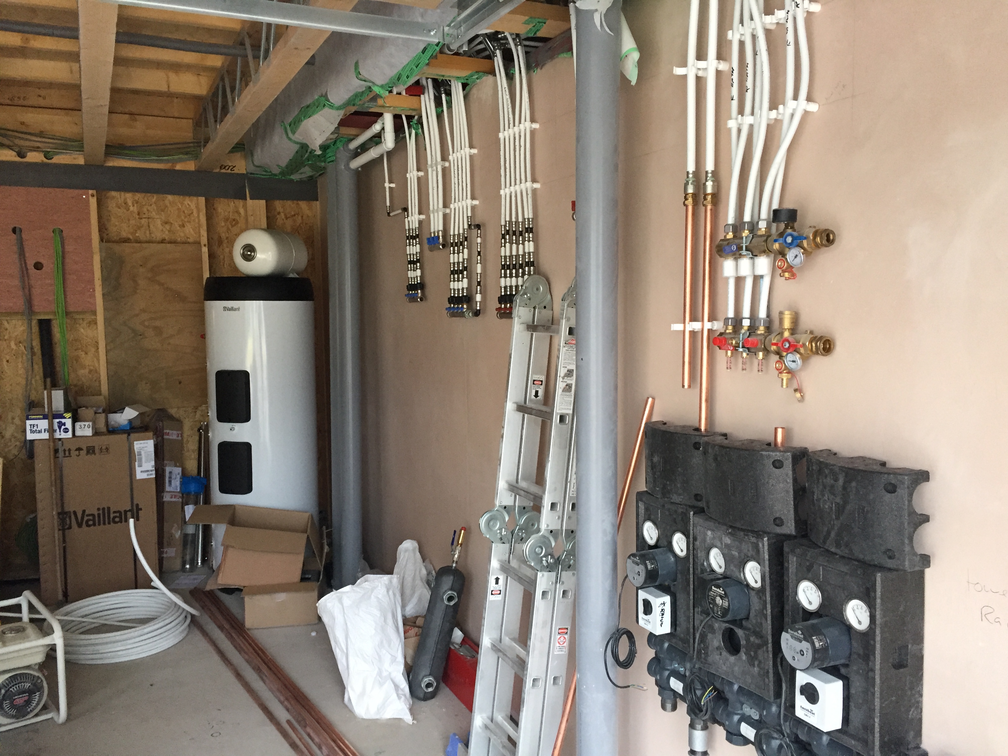

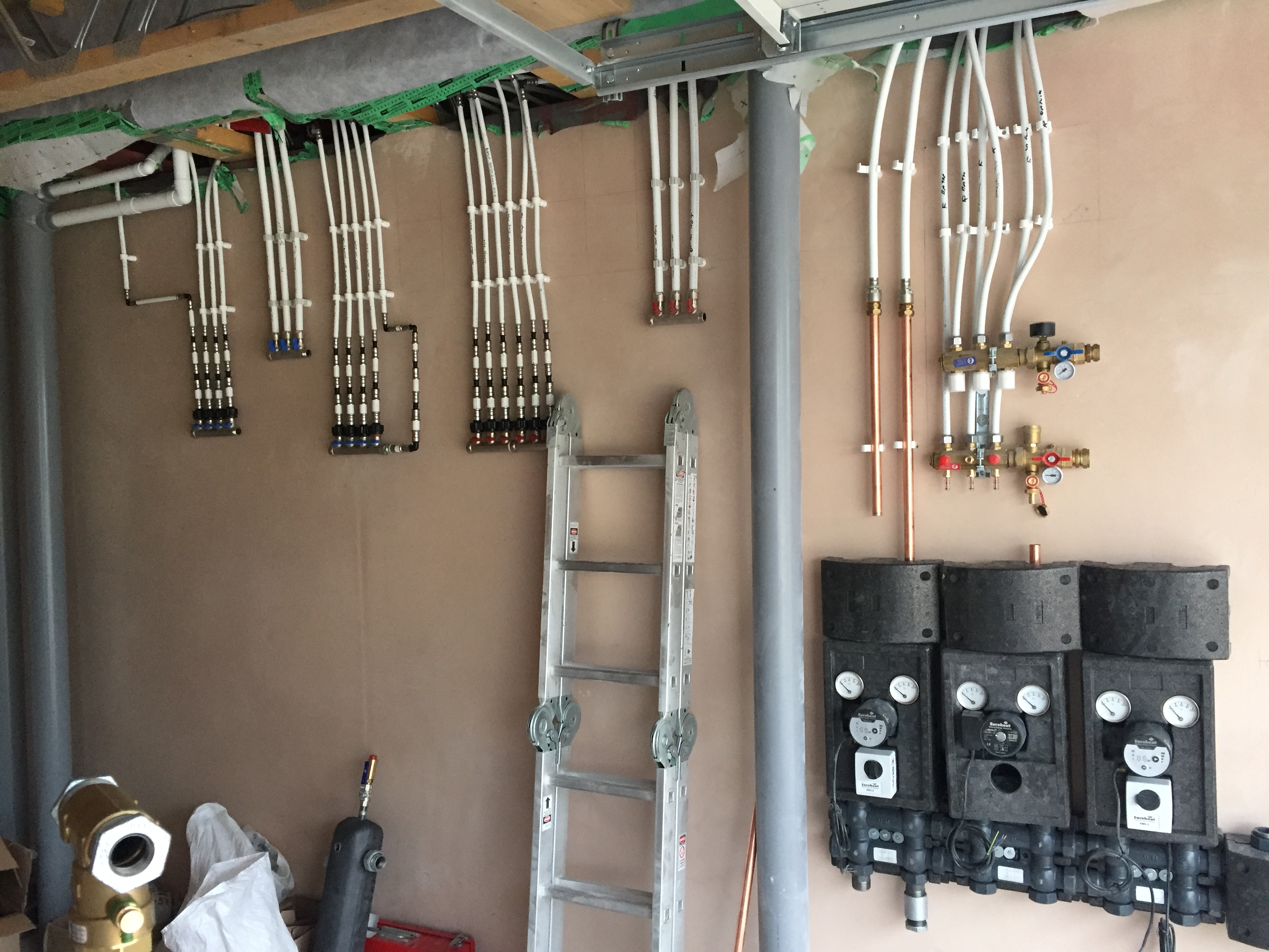

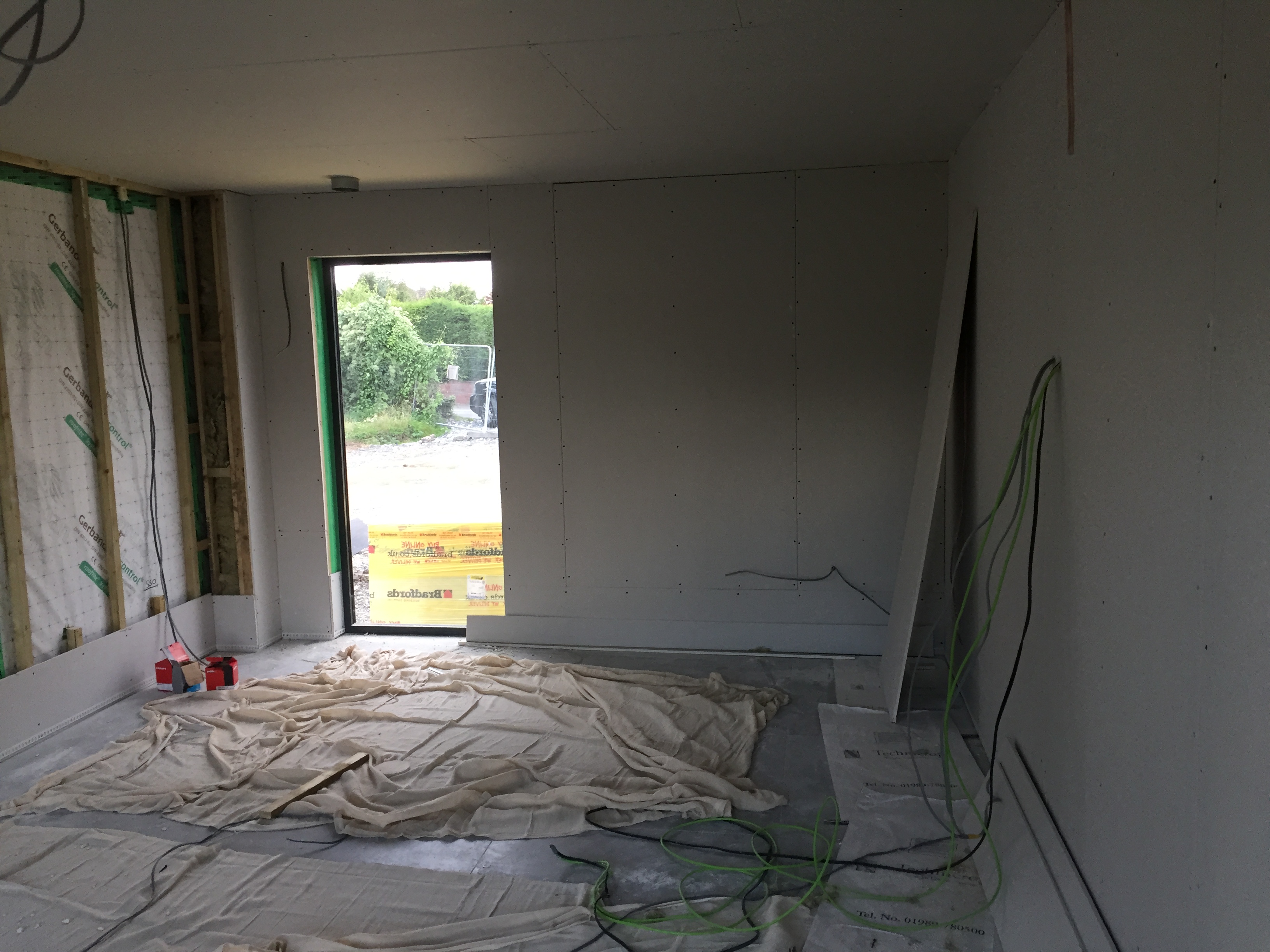

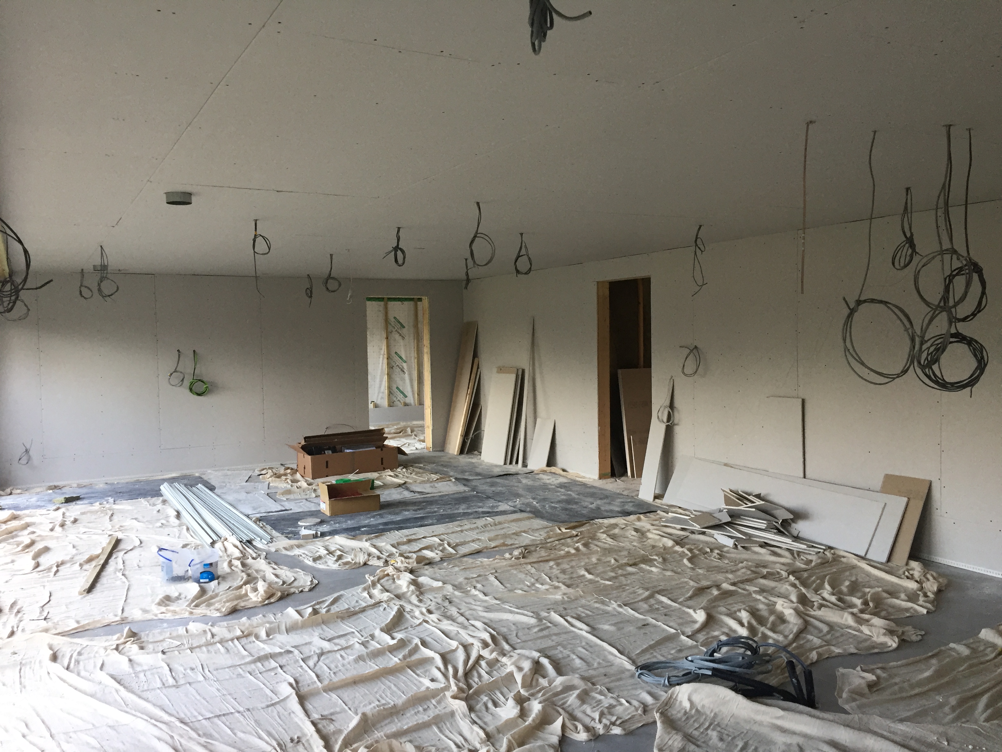

House feels like it's finally getting there now the plasterboard is going on and plumbing is going in so thought I'd share some pics as I m feeling happier with progress tonight....

Your plant room appears to bigger than our planned living room :D

That plant room is actually the side of the internal double garage hence why it looks big. I have a much smaller one where the mvhr and home automation kit is going (and probably the Hoover and ironing board!).

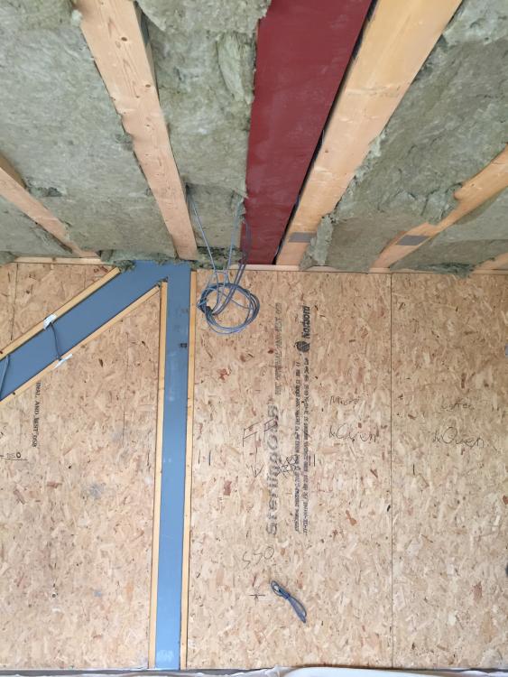

Great progress - our electrician left cables for spots in the ceiling behind the board so the plasterer could do a better job (always gets a bit scrappy around protruding cables) and then cut out the holes after. Would recommend trimming your MVHR plenums before plastering (we didn't) to get a smoother finish.

Thanks for the heads up on the mvhr plenums, will get them cut off before skimming.

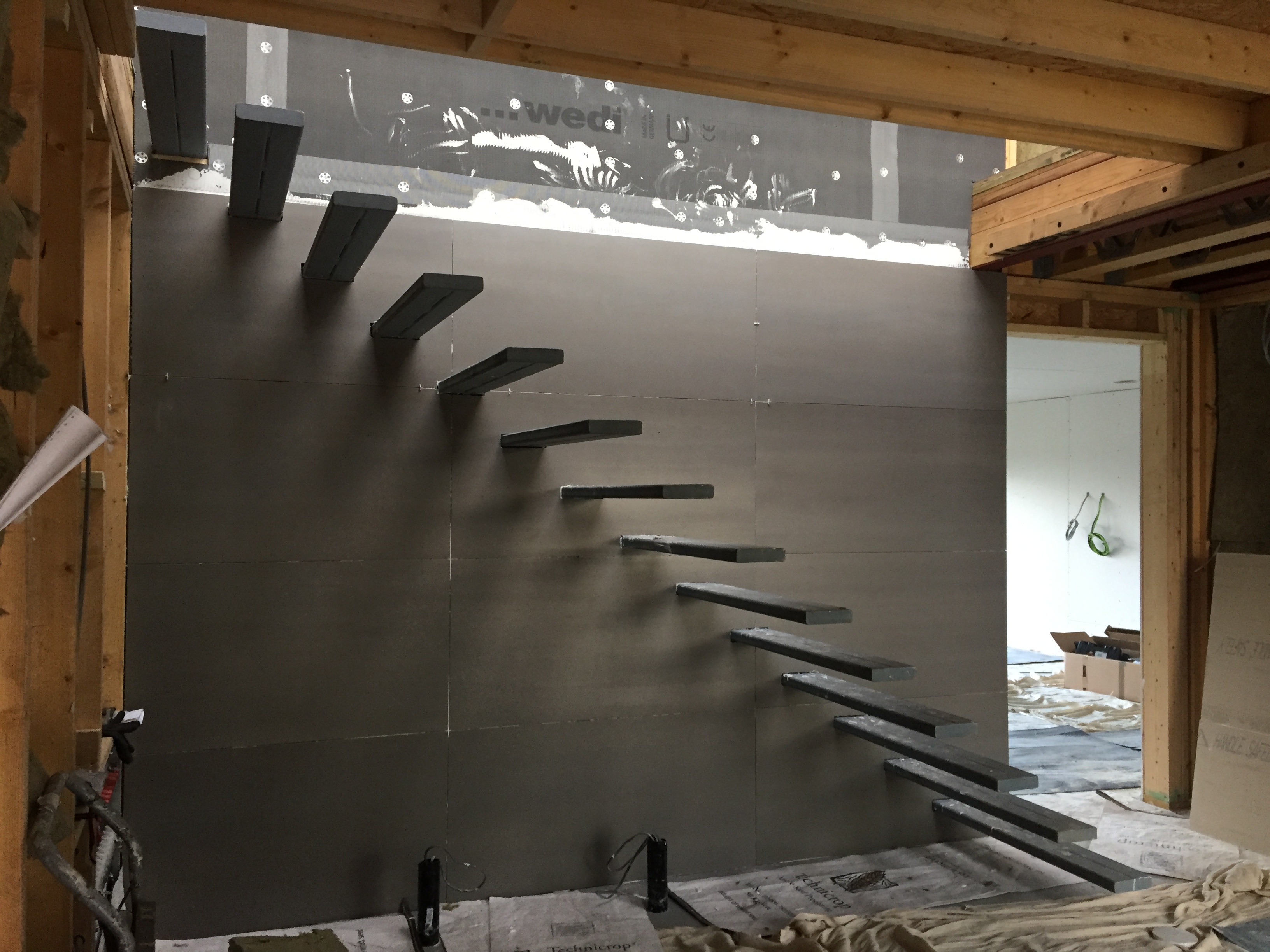

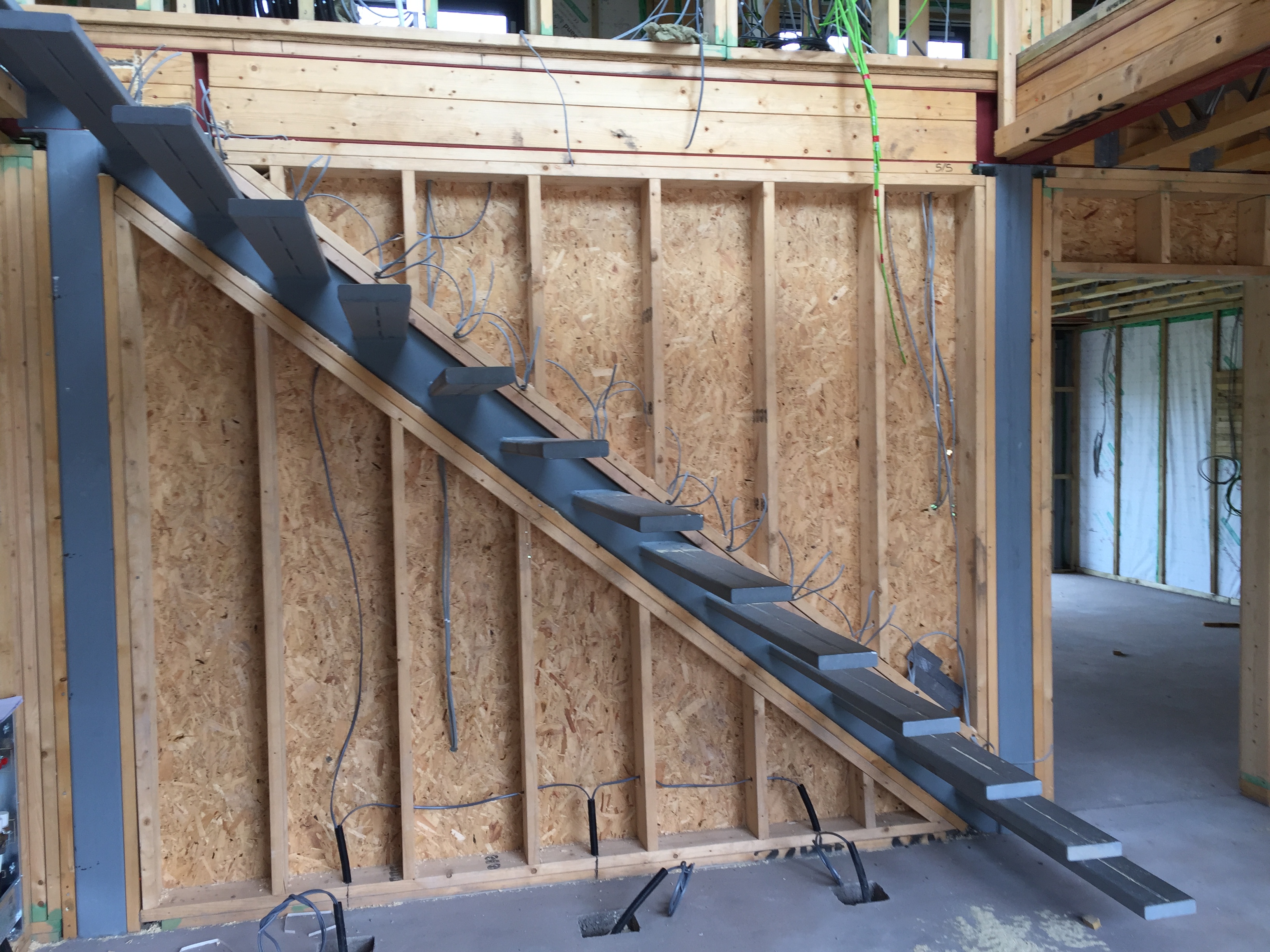

I like the stairs as well. I don't suppose you have a picture of the other side of that wall before it's been covered. Is that wall thicker than standard?

Here you go.....
I ll have to measure thickness of the wall but it's nothing excessive. The treads are two box sections welded together. I have a cad drawing of it if it's any use?

I presume you have to partly close the risers? I am sure the regs here are no gap that a 100mm diameter sphere can pass through.

Yes, those box sections are something like 45 x 160mm, they need packing out with ply and then the final wooden finish will be a 15mm thick "sleeve" that will fit onto each tread. Final dimension will be 230 x 100mm

2 hours ago, Trw144 said:
Here you go.....
Thanks, that's a brilliant idea. I often wondered now to create a floating staircase in a timber frame.
They don't have much flex to be honest, and I m told the glass (which will be fixed to every tread) brace the whole lot even more. The only one that had some flex was the top tread that was welded to the I-beam rather than the steel stringer. The I beam was thinner steel than the stringer and was flexing on the vertical so we welded some additional plates to stiffen it and it's fine now.
I seem to remember watching a Grand Designs where they had quite a fancy floating staircase, but had to put in a slender vertical support half way up to prevent flex, as the occupants were a bit heavier than average.
I'm assuming the finished cladding will be taken right to the tile, or do you have to leave a couple of mm expansion gap?  Likewise, what size of expansion gap did you leave between tread and tile?
I ll take it within a couple of mm and use a rubber gasket to stop it rubbing on the tiles, ditto at the glass end of the steel. The tread is going to have a 5mm rebated shadow at the end also.
