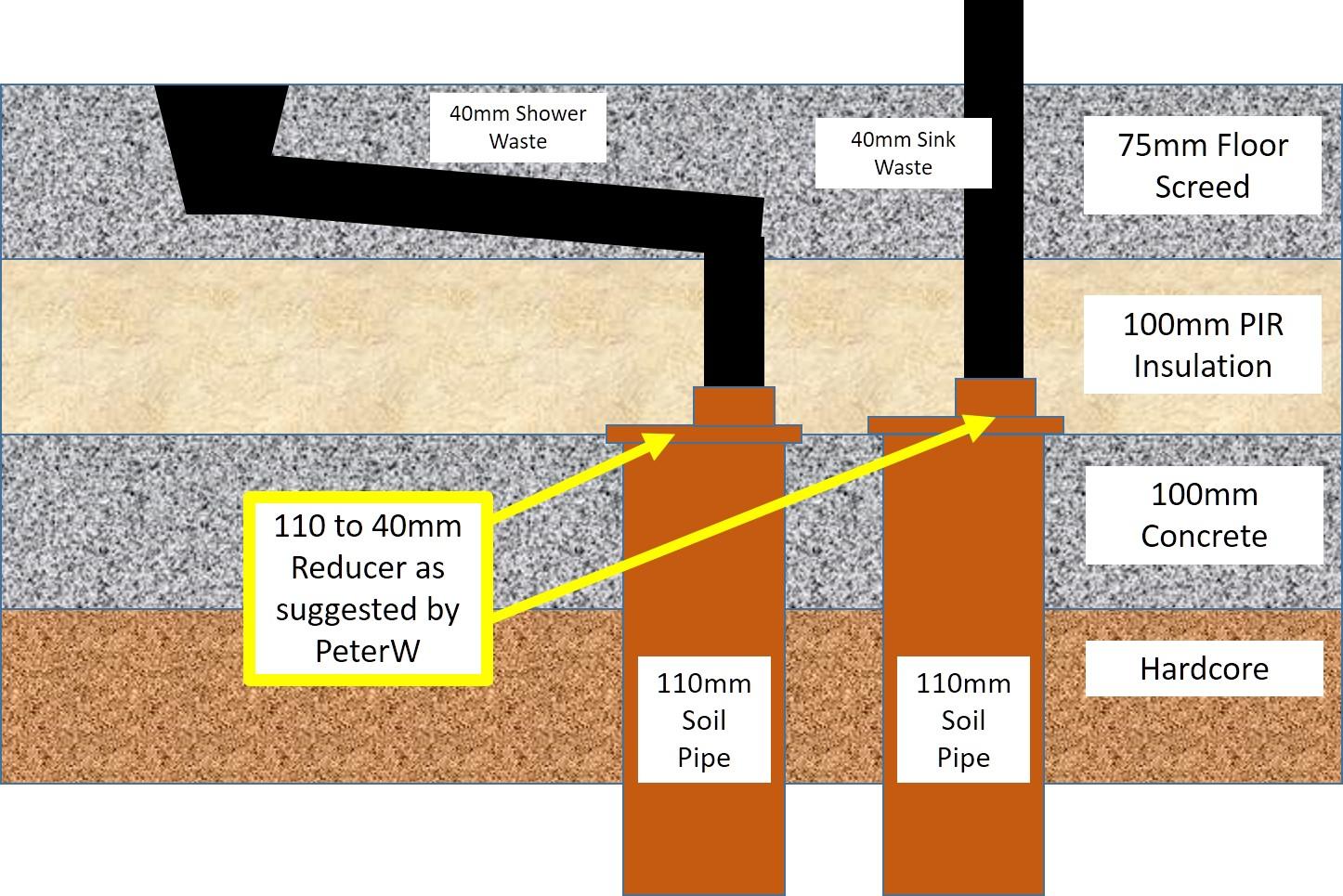

wozza Posted June 25, 2019 Author Posted June 25, 2019 (edited) Ok Guys, Please see my crude diagram below and let me know if its ok (its not to scale) My plan is to run the soil pipe up to and level with concrete sub floor - to then add 110mm to 50mm reducers so that the 50mm pipe runs through the PIR insulation and then straight up to the sink and the shower. The shower waste will need to have the screed cut out to fit the waste flush with the floor when the tray is fitted so I intend to take it straight up to start with (so the floor can be laid) then when the floor area is cut out, it can be shortened and the bend added. The length of the pipe from the shower to the soil pipe with only be about 300mm before the bend. Thanks, Wozza. Edited June 25, 2019 by wozza Sorry the first pic is wrong - it should be 50mm pipe - cannot delete it doh 1 1
wozza Posted June 25, 2019 Author Posted June 25, 2019 2 hours ago, Onoff said: Crude? Bang tidy "sketch" that. ? 10 mins in powerpoint
