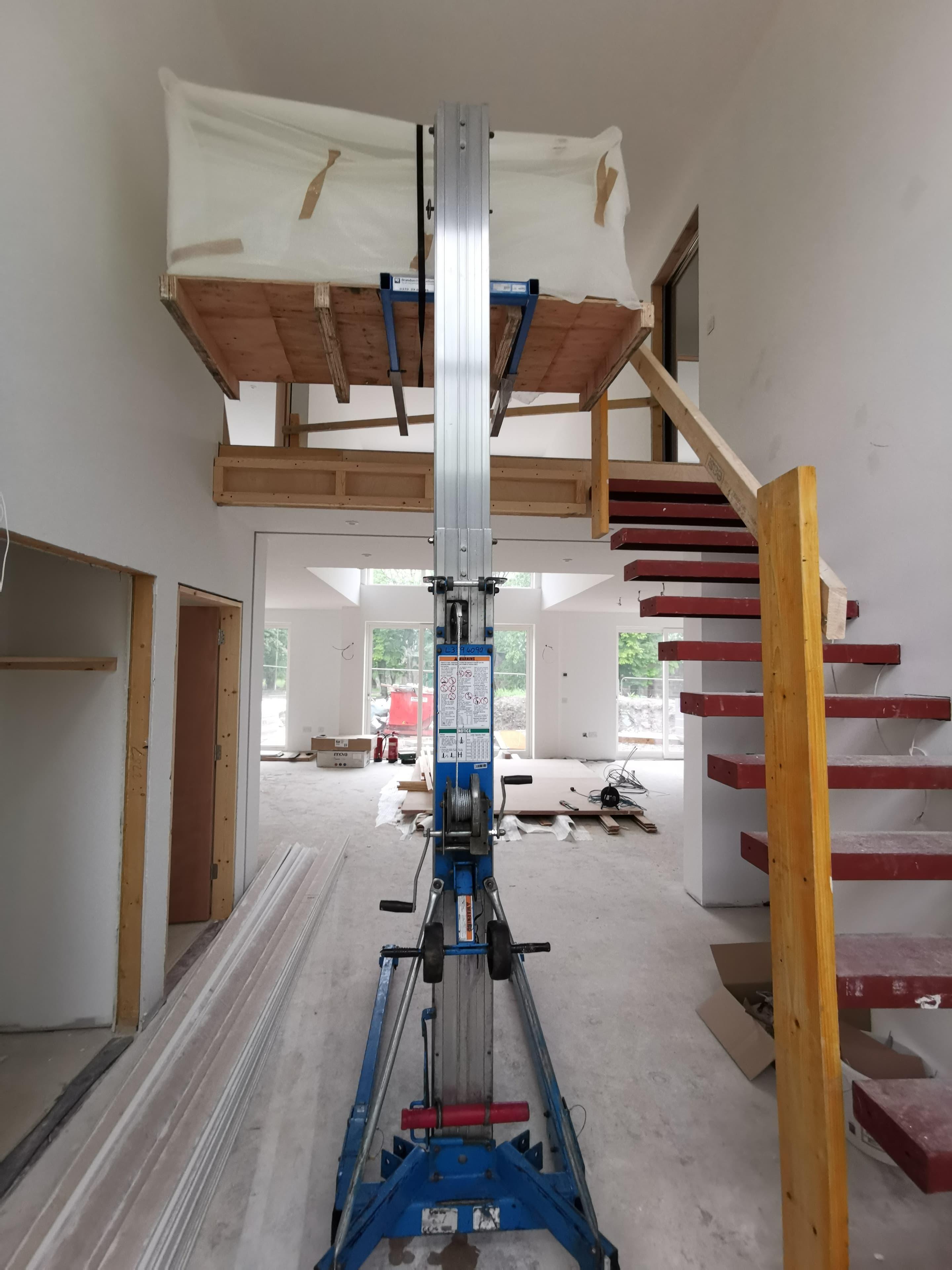

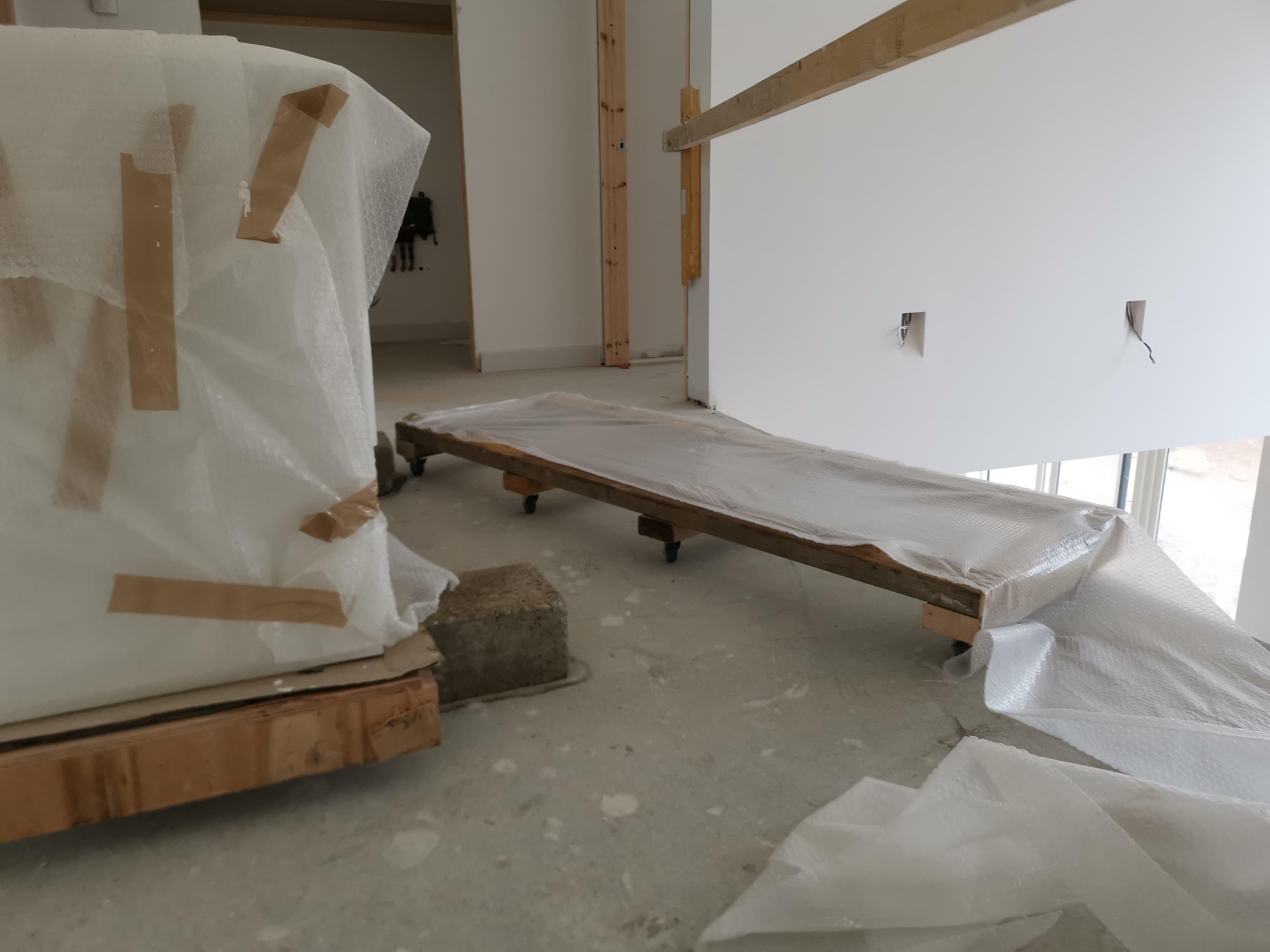

ultramods Posted June 22, 2019 Share Posted June 22, 2019 (edited) I had to get our180kg bath up stairs last week. Hired a genie lift for a day to get the bath onto the first floor, then made a trolley with 8 castor wheels from ebay to move it about. If you are physically struggling to to move the tray by your self a trolley is a great way to move heavy objects about. Once in position you could remove the trolley and leave the tray on top of a couple of bits of wood ready for applying the adhesive I was also really impressed with the genie lift, one of those things in life that just works Edited June 22, 2019 by ultramods 1 Link to comment Share on other sites More sharing options...
