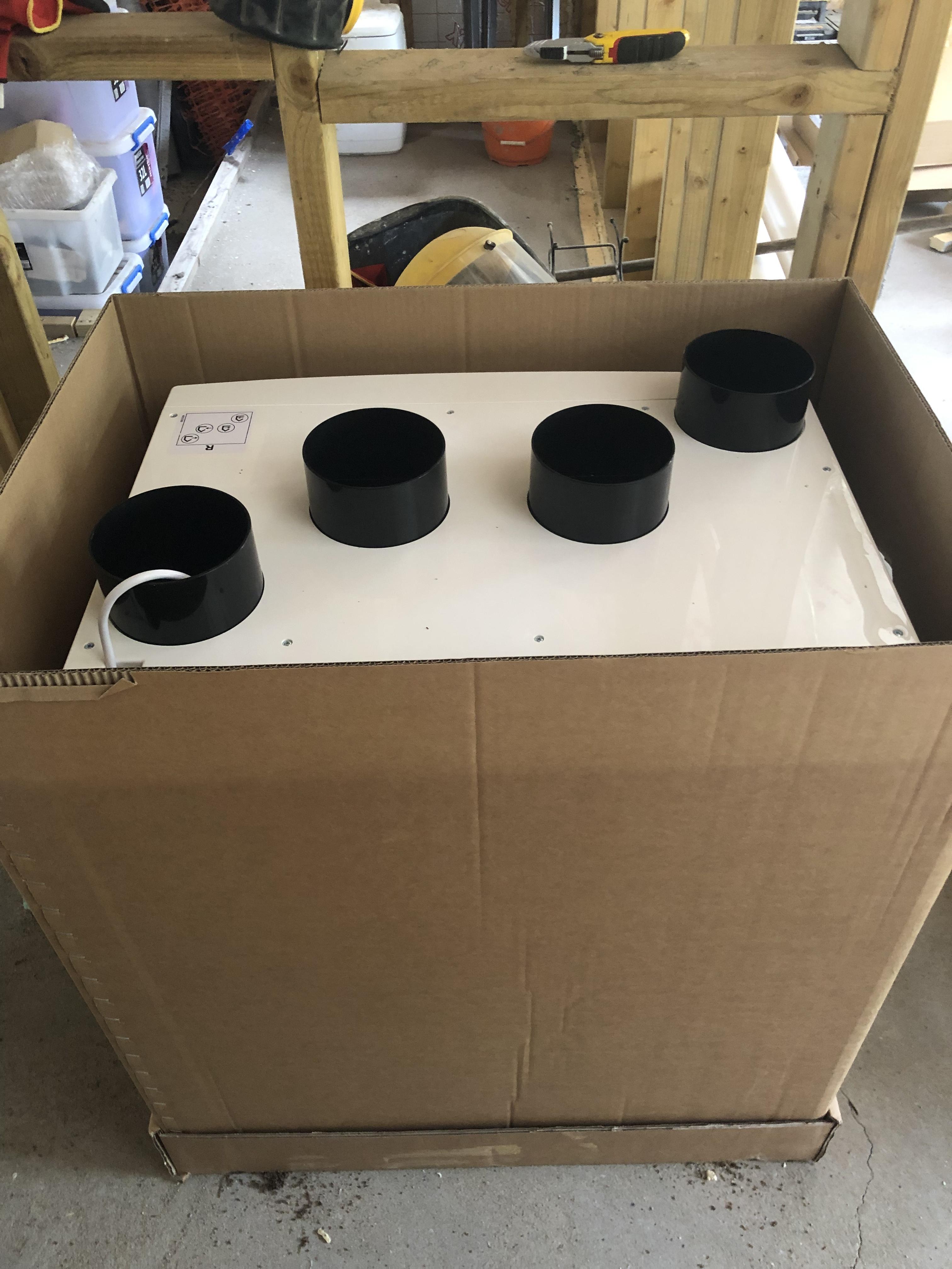

Pocster Posted July 30, 2019 Author Posted July 30, 2019 Erm ! Funny how much bigger it is when it arrives ! . No idea how to get this through a loft hatch and positioned so that filters etc can be altered . The roof trusses get in the way completely- snookered !!

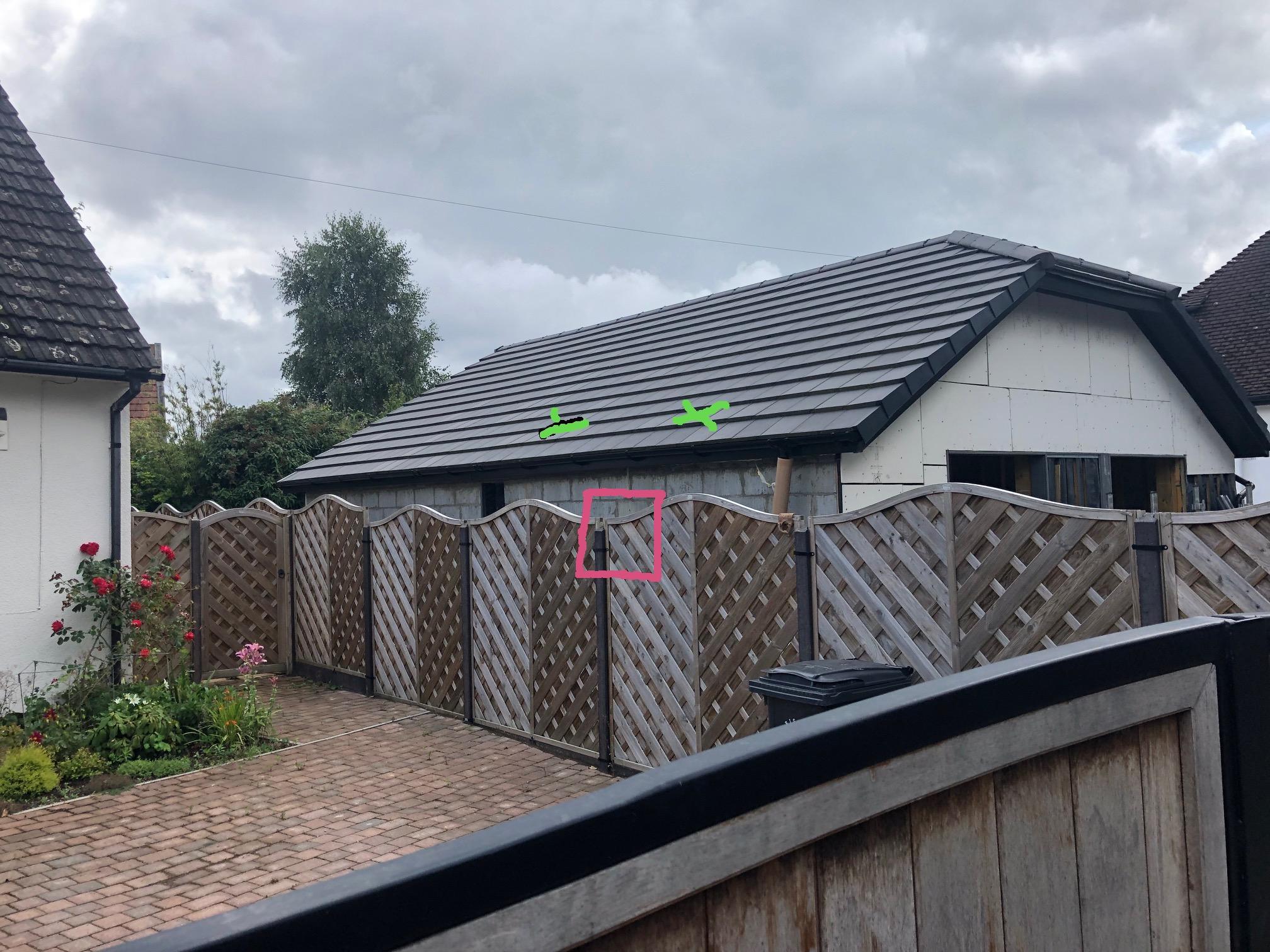

Pocster Posted July 30, 2019 Author Posted July 30, 2019 Do the roof vents have to go high up on the roof ? All photos I’ve seen put them near the ridge . Can they be lower ? . If units in bedroom shortest run is to vents lower on roof
PeterW Posted July 30, 2019 Posted July 30, 2019 Vents are better on the roof plane rather than the ridge. Ridge vents are more for exhaust from gas and soil stacks where you want to create a negative pressure to draw the air from the vent. 1

Pocster Posted July 30, 2019 Author Posted July 30, 2019 1 hour ago, PeterW said: Vents are better on the roof plane rather than the ridge. Ridge vents are more for exhaust from gas and soil stacks where you want to create a negative pressure to draw the air from the vent. Problem is I don’t want to scupper where PV panels will go at a later date .
Pocster Posted July 30, 2019 Author Posted July 30, 2019 19 minutes ago, joth said: This does make me wonder: do any units have filter access from below? Positioning it with its own loft access hatch directly underneath it would be pretty convenient in our install: just stand on steps, open a ceiling hatch and reach up to access the filters. Hey @joth that would just be too easy ! My unit is about 35cm deep ; so you need at least 70cm to get the filters out . Pita in the limited loft space ( if possible at all ) . Dream in a bedroom for access !
PeterW Posted July 30, 2019 Posted July 30, 2019 4 minutes ago, pocster said: Problem is I don’t want to scupper where PV panels will go at a later date . Roof has 2 sides ...??? 1
Pocster Posted July 30, 2019 Author Posted July 30, 2019 (edited) 1 hour ago, PeterW said: Roof has 2 sides ...??? Yeah . But it makes sense for me to put half the panels on either side . Vent placement probably not going to effect PV position - just trying not to shoot myself in the foot later . Will put a photo up later of where I intend vents to go Edited July 30, 2019 by pocster
Pocster Posted July 30, 2019 Author Posted July 30, 2019 @PeterW So!, green crosses approx location of roof vents (1.5m or slightly more apart) Red box MVHR unit mounted internally on wall. This seem good? Distance from in/out vents to MVHR will be short. I was thinking (oh no!) before I wall mount it if I should say do OSB , then thick rubber ( to reduce noise) then unit onto that.

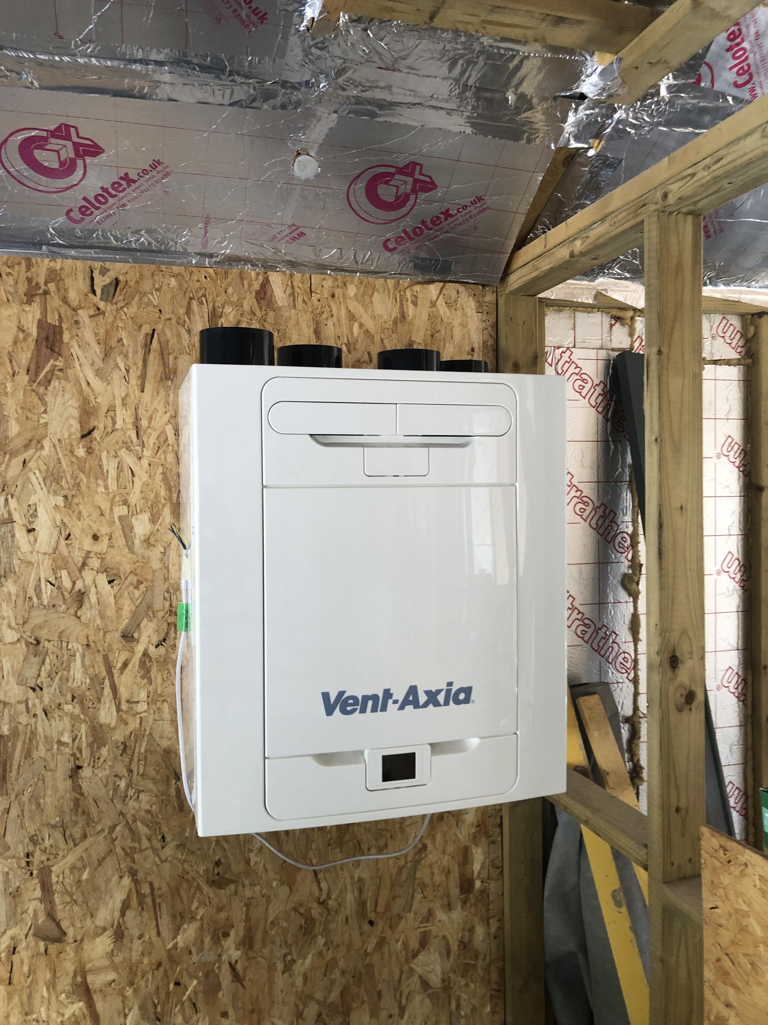

Pocster Posted August 21, 2019 Author Posted August 21, 2019 Beast is on the wall . I’m sure it’s grown !!! 1
Dreadnaught Posted August 21, 2019 Posted August 21, 2019 That's the model I'm thinking of using. Following with interest! Condensate-drain arrangement ready? 1
Pocster Posted August 21, 2019 Author Posted August 21, 2019 3 hours ago, Dreadnaught said: That's the model I'm thinking of using. Following with interest! Condensate-drain arrangement ready? Not yet ! But bathroom to the right so in theory should be easy ( he says )
