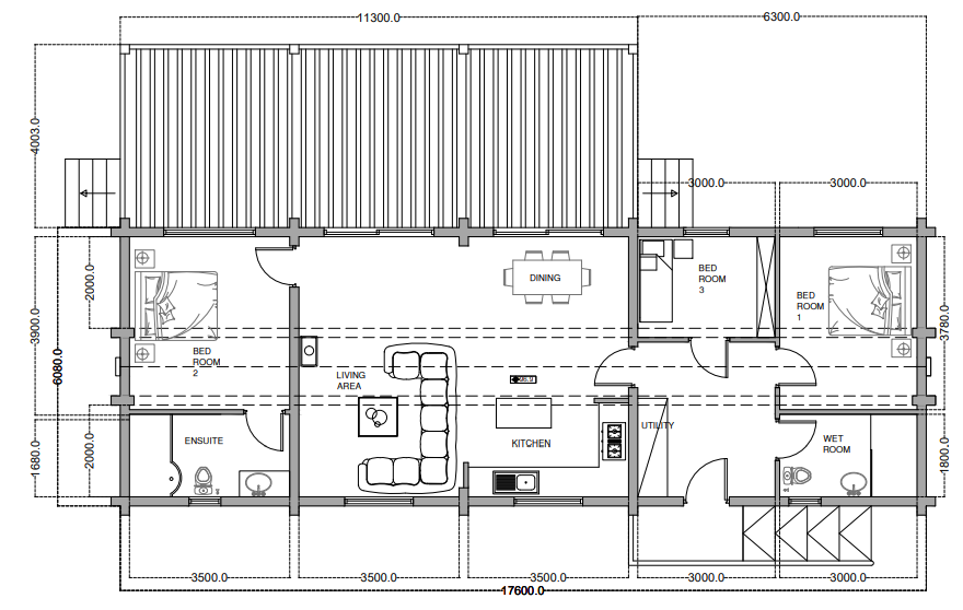

Ferdinand Posted June 15, 2019 Share Posted June 15, 2019 (edited) How does this design handle a typical family? Say parents, 11 year old boy, 15 year old girl? or those plus grandma and granddaddy? or plus childrens’ friends for a holiday? (Yes, I am positing awkward but typical use cases.) F Edited June 15, 2019 by Ferdinand Link to comment Share on other sites More sharing options...
iSelfBuild Posted June 15, 2019 Author Share Posted June 15, 2019 (edited) 43 minutes ago, scottishjohn said: thats £842sqm for a bare shell then add plot + services + fitting out + delivery and erection costs ,certainly premium market you are aiming at Yes - This is a 200mm round log cabin, it is not a wendy house. If customers want slimmer square logs then the price flies down, however I'm very happy to discourage the market who are looking for the wendy house type cabins. FYI see my budgetary figures for my project (let's pretend I'm charging a client for design & build, my costs are less because I'm not charging myself) they are very rough. All in costs come to £200,000.00 furnished and set up for renting. £55,000.00 – Land £10,000.00 - Legals, electric connection, foul drainage design and installation, site scraping £4,000.00 – Brick Piers, Landscaping & Driveway £90,000.00 – Log Cabin Design, Supply & Build £1,200.00 – Armoured Cable Upgrade £1,500.00 – LPG Boiler + Fitting £1,000.00 – Water Pumping Solution £2,000.00 – Internal Electrics £2,000.00 – Plumbing + Radiators £2,800.00 – Bedroom Furniture £1,000.00 – Bathroom £1,000.00 – En-suite £1,000.00 – Log Burner £1,000.00 – Curtains + Decorations £5,000.00 – Kitchen + Appliances £1,000.00 – TV + Entertainment £1,600.00 – Dining Table + Sofa £1,000.00 – Cupboards and coffee tables etc £1,000.00 – Bedding & Towels & Accessories £3,000.00 – Decking Construction £2,000.00 – Wood Fired Hot Tub It's also interesting that 1 mile away a holiday park is selling a 75mm glulam chalet version (3 beds in the same floor space), unfurnished, less land, same sole residency restriction, on a holiday park but nestled at the top away from the caravans and in a nice woodland setting - no where near as nice and private as my plot. These sell for £300,000.00. They have sold about 7 of them I think. Some people rent them out for £680 - £1,250.00 a week depending on the time of the year. P.S. Kitchen and furniture might look cheap for solid oak free standing but I import directly from Vietnam through a wholesaler contact. Edited June 15, 2019 by iSelfBuild Link to comment Share on other sites More sharing options...
iSelfBuild Posted June 15, 2019 Author Share Posted June 15, 2019 32 minutes ago, Ferdinand said: How does this design handle a typical family? Say parents, 11 year old boy, 15 year old girl? or those plus grandma and granddaddy? or plus childrens’ friends for a holiday? (Yes, I am positing awkward but typical use cases.) F Second bedroom will be zip link beds. Sofa will be a sofa bed. Sleeps 4 officially. But 6 unofficially considering the sofa bed. Link to comment Share on other sites More sharing options...

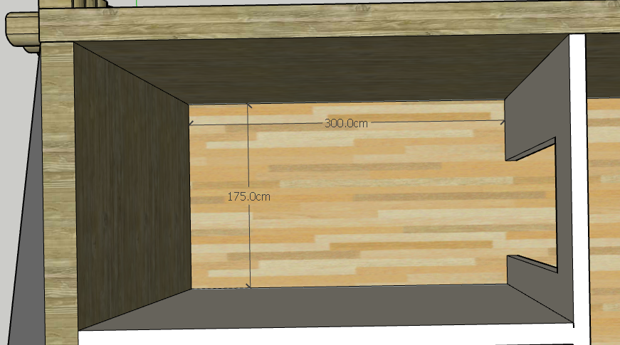

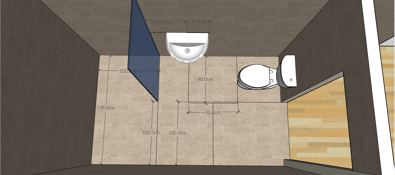

iSelfBuild Posted June 19, 2019 Author Share Posted June 19, 2019 Is this enough space for a disabled compliant wet room? I will also need to batten and panel board the room. I'm a little confused by the guidance online for disabled space (Scotland) has anyone got a floor plan for something like this? Thanks Link to comment Share on other sites More sharing options...
ProDave Posted June 19, 2019 Share Posted June 19, 2019 The only thing that makes a bathroom "accessible" is having the prescribed "activity space" in front of the bath, shower, basin and WC. I planned the layout of ours by cutting out large bits of cardboard of the required size for each activity space and laying them on the ground,. Also things like the door must not swing over an activity space etc which might mean outward opening. Link to comment Share on other sites More sharing options...
iSelfBuild Posted June 19, 2019 Author Share Posted June 19, 2019 Is it not a 153cm accesible circle in Scotland? If so I don't think it's possible? Link to comment Share on other sites More sharing options...

ProDave Posted June 19, 2019 Share Posted June 19, 2019 2 hours ago, iSelfBuild said: Is it not a 153cm accesible circle in Scotland? If so I don't think it's possible? I see no mention in the 2013 regs which is what I am working to. If there is, my bathroom won't comply. There is a 150cm diameter or 140 by 180 eleipse circulation space requirement in a kitchen. Link to comment Share on other sites More sharing options...

iSelfBuild Posted June 20, 2019 Author Share Posted June 20, 2019 Well after watching the impossible build I'm glad I'm assembling on site! With regards to the disabled accessible bathroom I believe this complies - https://www2.gov.scot/resource/buildingstandards/2013Domestic/chunks/ch04s13.html Hopefully I have interpreted the rules correctly as a side entrance toilet would allow: Where allowing side transfer, a small wall-hung wash hand basin may project up to 300mm into the activity space in front of the WC. This also allows a glass screen so the whole bathroom doesn't get soaked when showering ? Link to comment Share on other sites More sharing options...

iSelfBuild Posted June 23, 2019 Author Share Posted June 23, 2019 On 20/06/2019 at 21:03, iSelfBuild said: Well after watching the impossible build I'm glad I'm assembling on site! With regards to the disabled accessible bathroom I believe this complies - https://www2.gov.scot/resource/buildingstandards/2013Domestic/chunks/ch04s13.html Hopefully I have interpreted the rules correctly as a side entrance toilet would allow: Where allowing side transfer, a small wall-hung wash hand basin may project up to 300mm into the activity space in front of the WC. This also allows a glass screen so the whole bathroom doesn't get soaked when showering ? @ProDave - What do you reckon? Have I interpreted the regs correctly? I'm having nightmares about making the whole room a wet-room, partly in case of leaks but also I don't feel covering the logs with panel board is very wise as it will create an un-ventilated humid space which is just asking for rot. I'd prefer to have a shower tray and full width sliding doors. Is there any shower tray that is compliant or must it be 100% level? Link to comment Share on other sites More sharing options...
ProDave Posted June 23, 2019 Share Posted June 23, 2019 20 minutes ago, iSelfBuild said: @ProDave - What do you reckon? Have I interpreted the regs correctly? I'm having nightmares about making the whole room a wet-room, partly in case of leaks but also I don't feel covering the logs with panel board is very wise as it will create an un-ventilated humid space which is just asking for rot. I'd prefer to have a shower tray and full width sliding doors. Is there any shower tray that is compliant or must it be 100% level? I think you will be okay as long as the door opens outwards so does not swing over an activity space. Don't forget you can have the front access WC activity space, there is a clause saying the activity space does not need to be in line with the axis of the toilet, so it can slew round a few degrees so the activity space misses the basin. But why are you bothering with this and why are BC being a pain? This is being built as a "caravan" so all BC have to do is check the drain connection. The rest is outwith building control. Link to comment Share on other sites More sharing options...
iSelfBuild Posted June 23, 2019 Author Share Posted June 23, 2019 35 minutes ago, ProDave said: I think you will be okay as long as the door opens outwards so does not swing over an activity space. Don't forget you can have the front access WC activity space, there is a clause saying the activity space does not need to be in line with the axis of the toilet, so it can slew round a few degrees so the activity space misses the basin. But why are you bothering with this and why are BC being a pain? This is being built as a "caravan" so all BC have to do is check the drain connection. The rest is outwith building control. Thank you! BC have told me that they disagree with my classification that this is a caravan and that they want to refer it to 'Local Authority Building Standards Scotland' Partly down to it being 200mm round log rather than the usual 70mm type chalets. The main reason is that I originally proposed to build the unit in one whole piece, which I agree is taking the Michael a little - they wanted a structural engineers report to say it was capable of being lifted in one piece. Link to comment Share on other sites More sharing options...

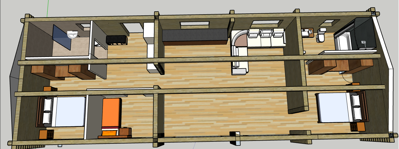

iSelfBuild Posted June 23, 2019 Author Share Posted June 23, 2019 Since changing the location of the bathroom I have looked at the space on offer and feel that there is more value to be had by adding a single bedroom in place of the store room. I can still have a cupboard in there with ironing board, mop, hoover etc. LPG boiler will be relocated to cupboard in the hallway. Water pumping station could be housed underneath the cabin and to be honest is probably better there as when pressurising it's noisy! Garden furniture/cushions can be stored underneath the cabin as there will be a 6m x 8m space with about 1.3m headroom. YAY or NAY? 1 Link to comment Share on other sites More sharing options...
iSelfBuild Posted June 25, 2019 Author Share Posted June 25, 2019 Thanks again to everyone for your help! Just need to make that wetroom door swing into the hallway and it will be spot on. 1 Link to comment Share on other sites More sharing options...
