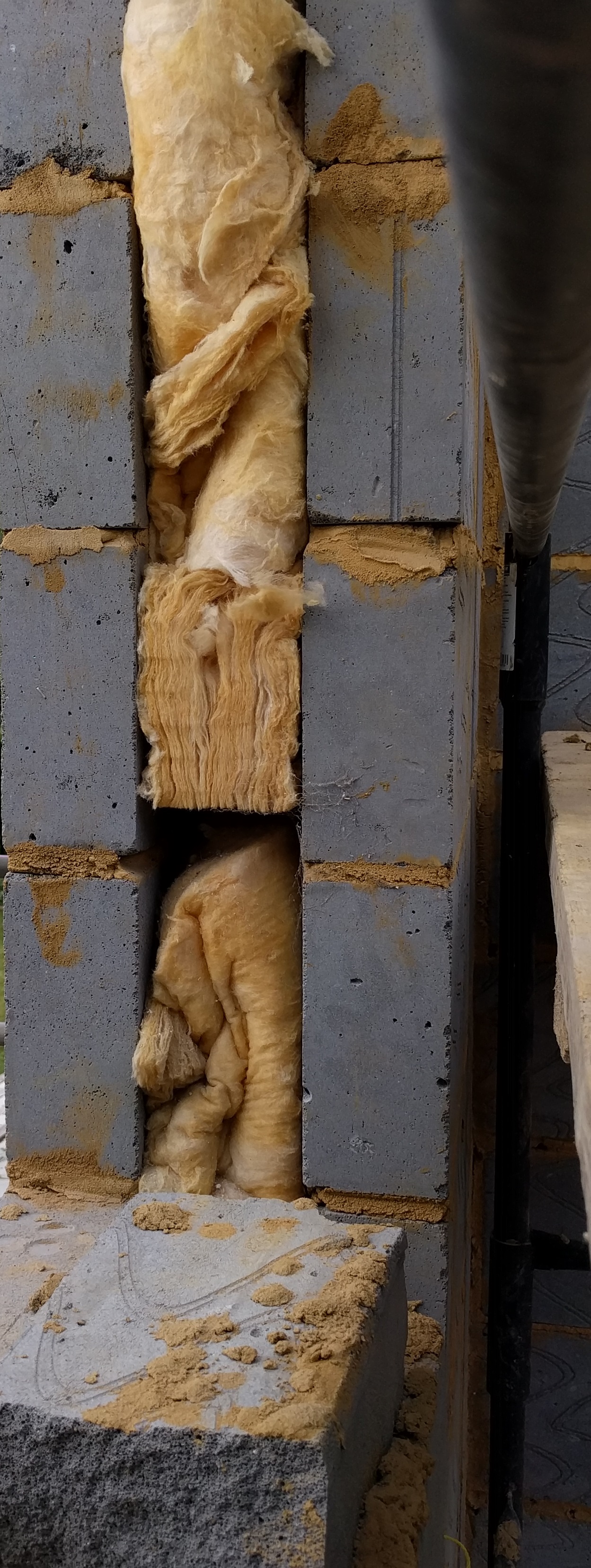

jack Posted September 12, 2016 Posted September 12, 2016 21 hours ago, Brickie said: Trust me-the finished job you'll get if the builder fits the insulation will give you a lower insulation performance than on paper. The care & attention to detail needed when fitting is beyond 99.9% of bricklayers,honestly. With fulfl fill,you're more likely to get what expect. Even then, perfection isn't assured. From a friend's extension going up at the moment: He mentioned that their current house (loft bedroom) is quite hot at the moment so they're getting air conditioning upstairs. I asked about increasing the insulation depth instead or as well, but he said they don't have the ridge height.
ProDave Posted September 12, 2016 Posted September 12, 2016 That picture is quite shocking Jack. It shows the builders regard fitting insulation as a "box ticking" exercise, rather than actually giving any thought to making it well insulated.
ADLIan Posted September 12, 2016 Posted September 12, 2016 Sorry been awol on trans atlantic flight! Nice pic Jack. I've seen similar with polyurethane and gaps of several cm between the slabs! Back to the main topic. Generally no need to vent the cavity on standard masonry cavity or TF with brick/block cladding (though weep holes will allow some vent this is not the primary aim of these gizmos). Extra insulation can be applied external to the TF studs but the render should not be applied directly to this. With render finish on timber frame there should be a vented and drained cavity behind the render system (and carrier board or mesh) but in front of the extra insulation. The performance of the insulation will not be affected in this instance. Sorry ProDave but I do not see any meaningfull approval, i.e. BBA or similar, on the link and your detail is not supported by TRADA (see Timber Frame Construction, 5th Ed), NHBC Standards or Building Regs. The fact that BC accepted it may simply mean a lack of undertsanding here. It is not a condensation issue but an issue with rain/moisture penetrating the render system and then having ready access to timber and wood based materials - the drained/vented cavity avoids this problem and is shown by the mainstream insulation manufacturers in TF systems. Ian
