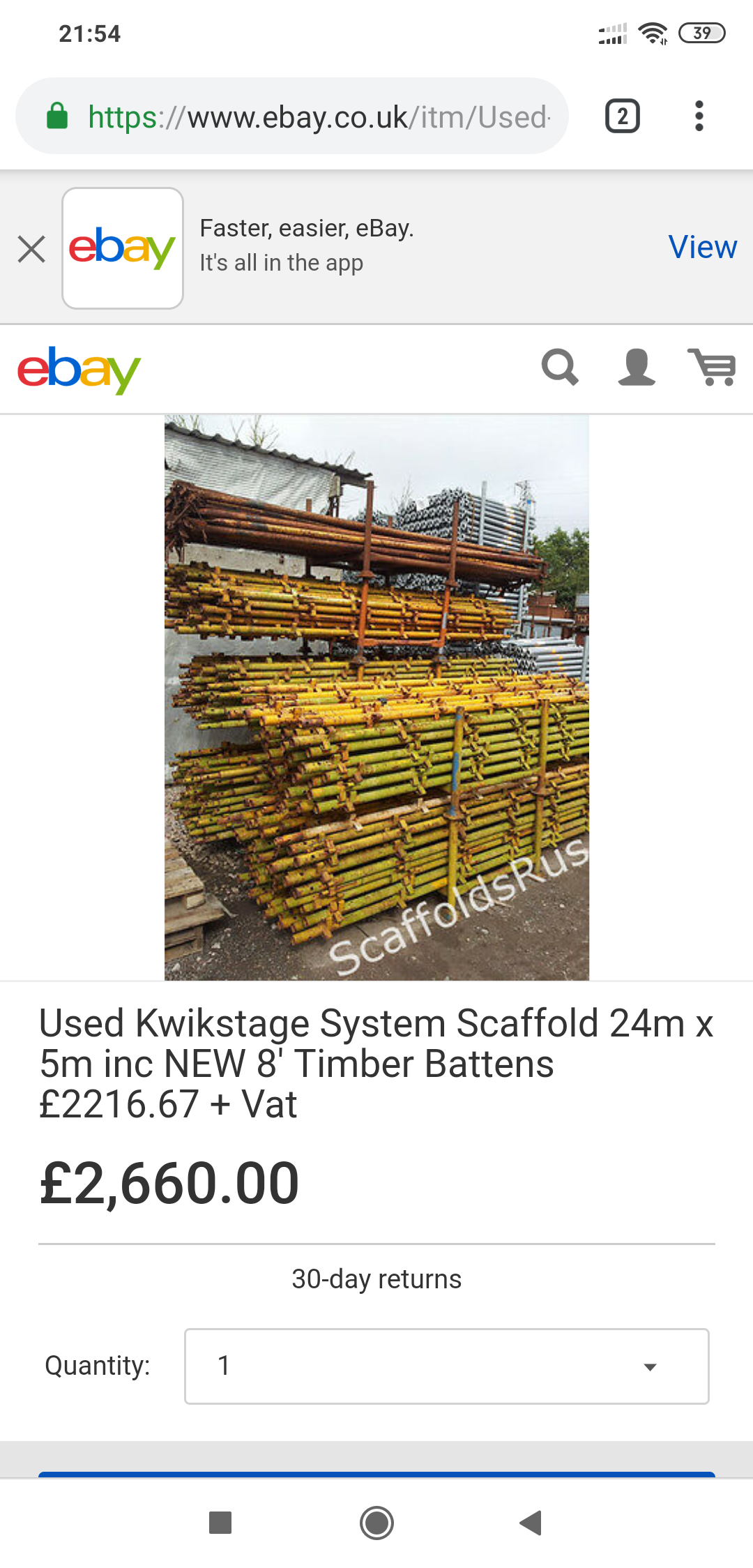

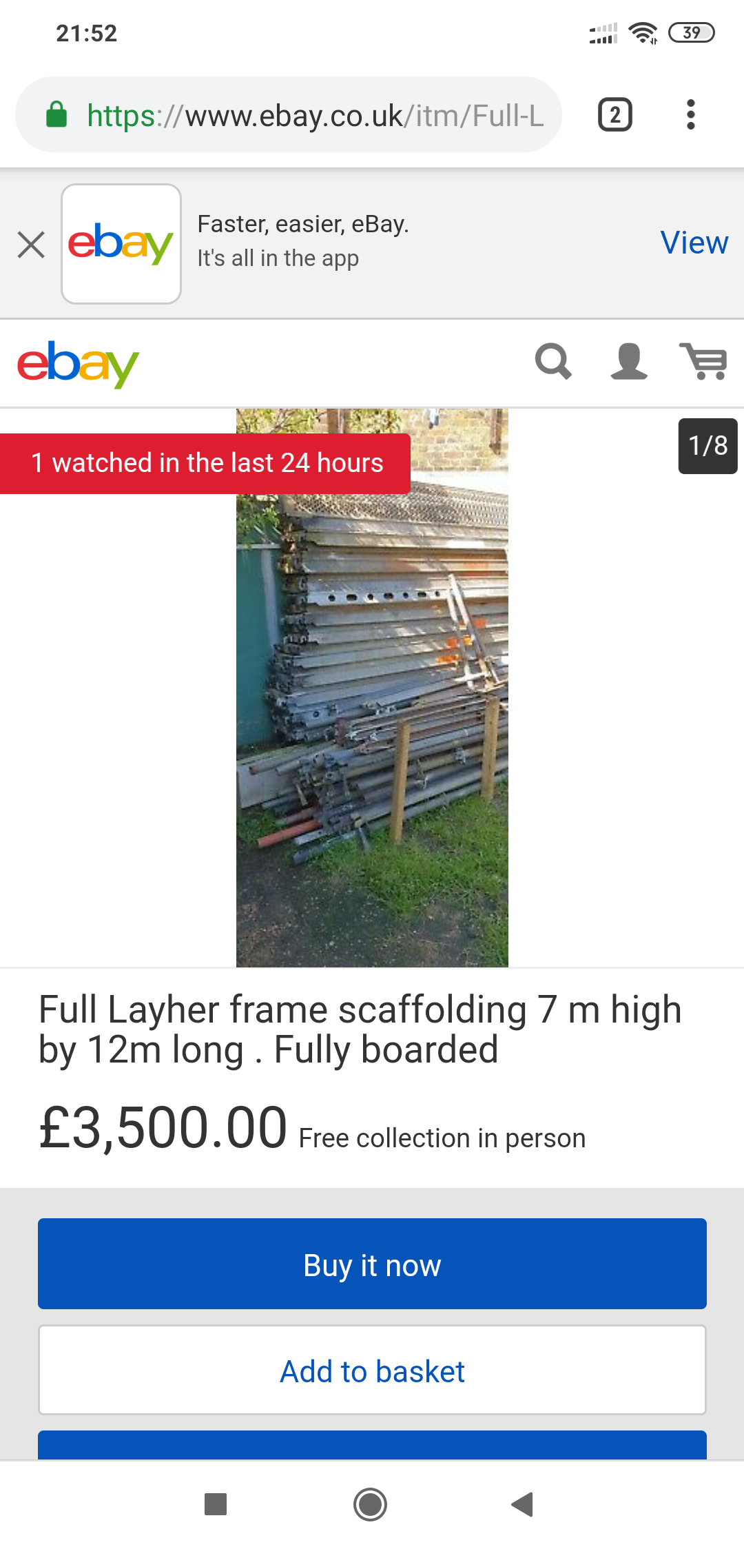

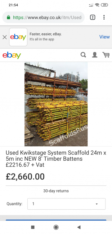

Declan52 Posted July 11, 2019 Share Posted July 11, 2019 Not many sets for sale and none of the usual scaffolding sites have any prices listed which doesn't usually bode well. Found these 2 entries on eBay. So you can get close to twice the amount for £1k less with kwikstage. Link to comment Share on other sites More sharing options...
Patrick Posted July 11, 2019 Share Posted July 11, 2019 Fair play. New they are not that different I believe. But might be wrong as well. ? Link to comment Share on other sites More sharing options...
