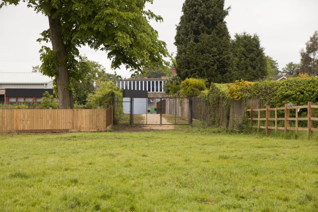

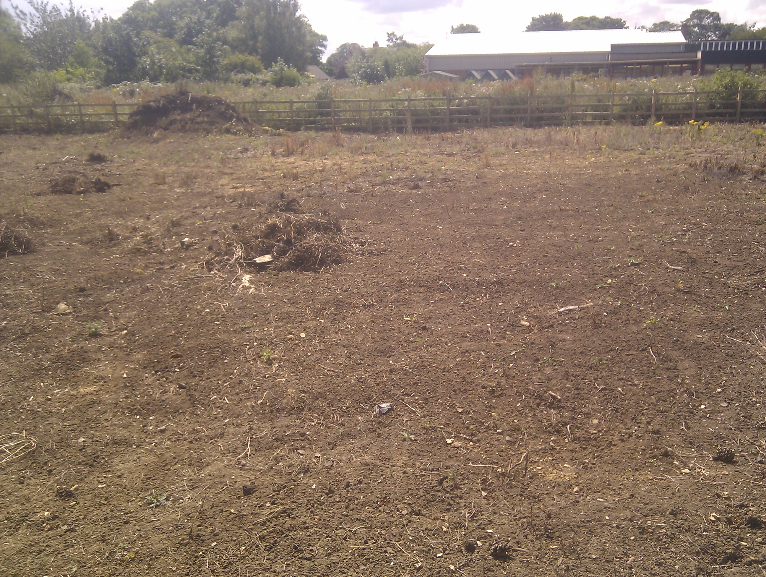

Vijay Posted September 11, 2016 Author Posted September 11, 2016 The problem is the footings won't be started for a few months as I'll be doing them with my own digger. As I mentioned, my Mum has to go in for heart surgery next month (it was supposed to be last Monday but got cancelled), so I need to be local for her for the 6 weeks recovery. The last thing I want to do is be an hour away if she needs anything I agree with what you guys have said, there seems absolutely no reason why GCN would decided to live on my land when there is absolutely nothing there to support them. All I'm concerned is that I would not be able to stop them moving the pond (to where ever it is going to go as I cannot find anything on the council website to do with the ecology reports), if I don't raise it with them now - which I'm loathed to do!! What is newt protection fence made from? If I put it up, then basically I have admitted that I am aware of the situation. Would a weed control mat put up along the 4 bar fence help stop them exploring my plot?? Another issue is that the plot between me and the school is not being maintained at all. You can see it in this pic (the 4 bar fence is the boundary between my plot and the unmaintained one, then the school is on the other side of that plot)

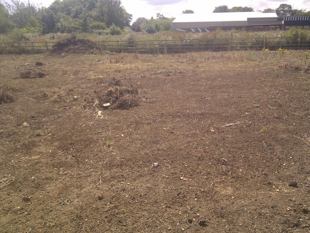

PeterW Posted September 11, 2016 Posted September 11, 2016 If that is your plot in the foreground then it looks to have been cleared of vegetation ..?? That is enough to be classed as starting development, not for building control but for planning as for CIL it relates to any "material operation" that includes starting roads, service connections or demolition. Newt fences are a long plastic fence but you also need all of the environmental stuff that goes with it that takes 3-6 months so unless you want the delays and also have deep pockets I would ignore it. @recoveringacademic can tell you all about the vagueness of the rules - he's spent thousands on his plot doing GCN protection but the neighbours had to do nothing ... Treat that as your case study ..!
Vijay Posted September 11, 2016 Author Posted September 11, 2016 Yep, that's my plot nearest and that was last year, it was completely cleared by the time I'd finished - actually raked by hand!!!! lol What I meant is would any weed control fabric/membrane act as a GCN barrier as I could happily use that to hold back that overgrowth you can see in the next plot - and not my fault if it stopped newts exploring my plot Yeah I read one of his posts, 6k and 2 years of hoop jumping

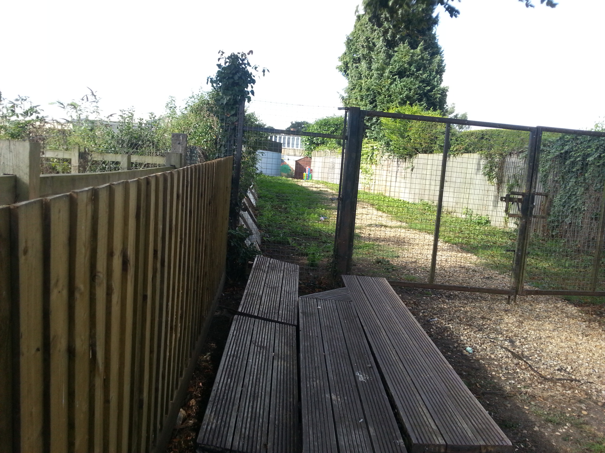

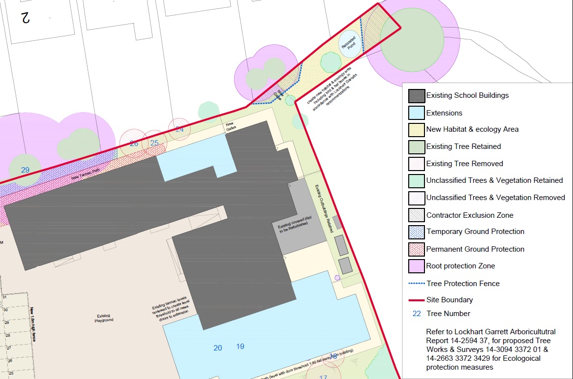

Vijay Posted September 12, 2016 Author Posted September 12, 2016 (edited) I've just found out that the pond is being relocated to a walkway at the end of my plot, which kids walk though to get to a new playing field. The walkway can't be more than 4-5m wide. The large tree you can see on the left is in my plot and the grass area is their new playing field (land is loaned to them for 10 years). I can't believe they're relocating the pond to where kids will walk/run to a playing field!!! Edited September 12, 2016 by Vijay
ProDave Posted September 12, 2016 Posted September 12, 2016 I would have a serious word with the council. It is the School project that is causing the "issue". I would respectfully point out that YOUR plot did not have a problem, you already had an ecology report, and you have STARTED your development. Any newt problem that now arises, is clearly the result of the school project and the relocation of the pond, and I would poin tout that it is the contractor responsible for that work that should take all precautions including a newt fence along your plot boundary.
Vijay Posted September 12, 2016 Author Posted September 12, 2016 from what I gather and other opinions, I think it's Natural England who take over, so the council would just say we're doing what we're told by Natural England. And from what I've read, Natural England won't care who's problem it is, they just care about the GCN's.
