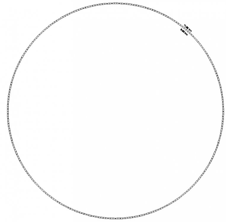

Mr Punter Posted July 15, 2019 Share Posted July 15, 2019 On 11/07/2019 at 07:16, Russell griffiths said: How are you going to get blocks to sit nicely in that radius. Would you not be better with a shorter block, brick so it follows the radius better, it will be awfully notchy otherwise and a major pain to fit your external insulation. Are you dead dead set on this method. On 11/07/2019 at 10:04, Declan52 said: You have to cut each block in half to get a curve anywhere near decent. Which is very time consuming. Building a radius with blocks can't be done with a line so having to cut each block plus build free hand you will be paying a massive premium to build in that shape. Then as @Russell griffiths also says how are you going to bend enough insulation around that shape so you get it to passiv standards. No so, you will easily get standard concrete blocks to go round with no problem and no need to cut the blocks. Given your diameter of 20m, the building circumference is 62.83m, so 279 blocks per course. The difference between the inside and outside of each perp join will be about 2mm and the maximum deviation in render thickness will be about 1mm. 4 Link to comment Share on other sites More sharing options...

Declan52 Posted July 15, 2019 Share Posted July 15, 2019 3 hours ago, Mr Punter said: No so, you will easily get standard concrete blocks to go round with no problem and no need to cut the blocks. Given your diameter of 20m, the building circumference is 62.83m, so 279 blocks per course. The difference between the inside and outside of each perp join will be about 2mm and the maximum deviation in render thickness will be about 1mm. That's a tidy bit of working out alright. It's still going to be free hand though which will take a fair bit of time to set out for a start then doing the actual building of the blocks. Link to comment Share on other sites More sharing options...

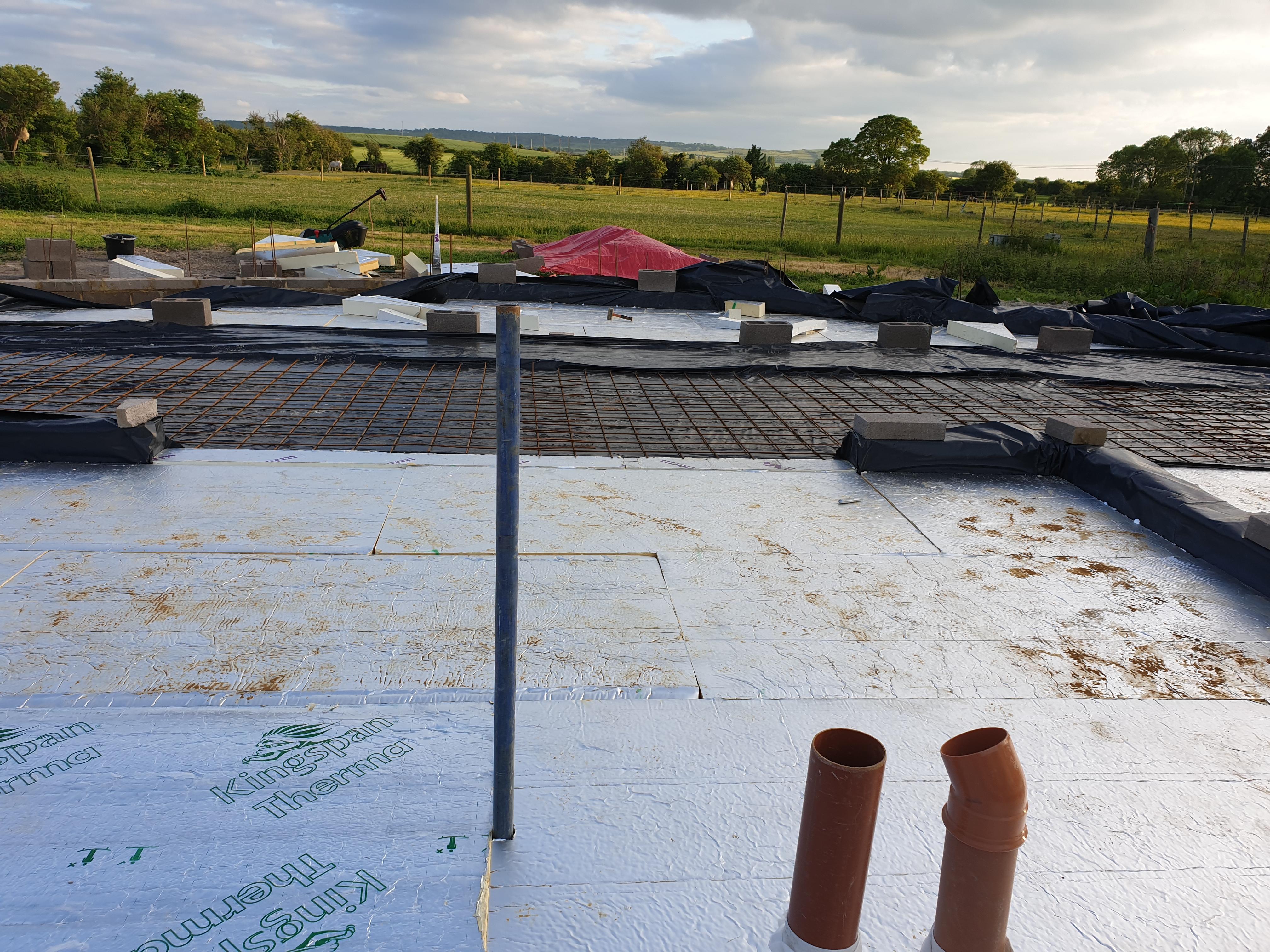

Jeremy Harris Posted July 15, 2019 Share Posted July 15, 2019 Just a slightly wacky thought, but I wonder if it would be possible to set up a dead vertical scaffold pole in the centre, firmly set down into the ground so it can't move, and then have a 10m long arm that pivots from that to provide a reference to help keep the blocks following the curve? Some sort of adjustable stand might be needed to hold the arm at the right level for each course, but I doubt it'd take more time to set something like this up than it would to set up a line several times on a conventional build. 2 Link to comment Share on other sites More sharing options...

romario Posted July 19, 2019 Author Share Posted July 19, 2019 On 15/07/2019 at 13:51, JSHarris said: Just a slightly wacky thought, but I wonder if it would be possible to set up a dead vertical scaffold pole in the centre, firmly set down into the ground so it can't move, and then have a 10m long arm that pivots from that to provide a reference to help keep the blocks following the curve? Some sort of adjustable stand might be needed to hold the arm at the right level for each course, but I doubt it'd take more time to set something like this up than it would to set up a line several times on a conventional build. We've been thinking the same way. I exactly used scaffold pole in the centre Link to comment Share on other sites More sharing options...

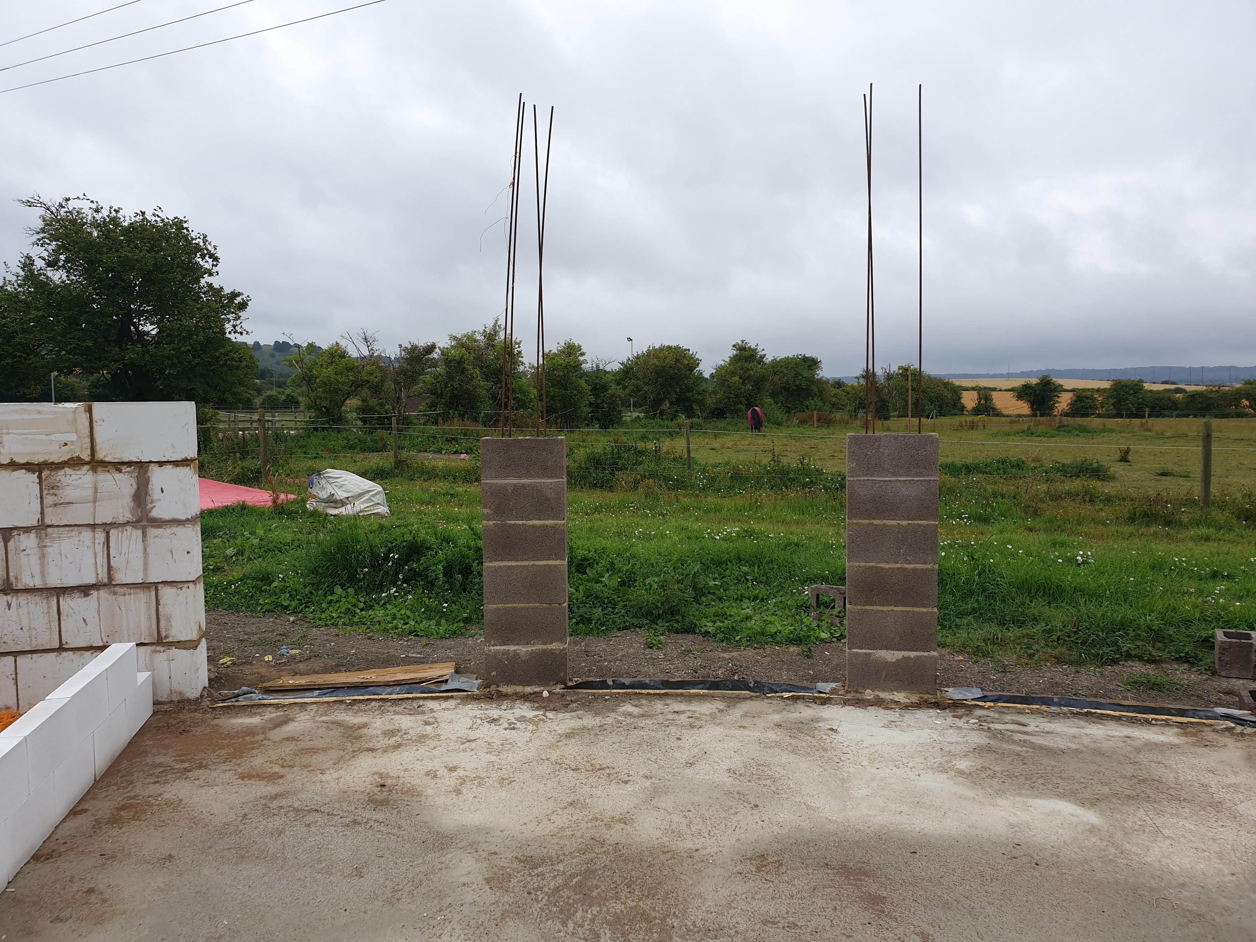

Mr Punter Posted July 19, 2019 Share Posted July 19, 2019 What a great location! So it looks like you have gone for a mix of hollow and solid concrete blocks. Are you filling the hollows with concrete? Jumping ahead a bit, what fixings are you looking at for the timber support battens through the insulation? Link to comment Share on other sites More sharing options...
romario Posted July 19, 2019 Author Share Posted July 19, 2019 50 minutes ago, Mr Punter said: What a great location! So it looks like you have gone for a mix of hollow and solid concrete blocks. Are you filling the hollows with concrete? Jumping ahead a bit, what fixings are you looking at for the timber support battens through the insulation? Below DPC structural engineer preferred concrete blocks. I could either go for solid concrete or hollow concrete and fill them in with concrete. As the wall thickness is 215mm solid concrete blocks would need to be laid flat as the largest size I could get in solid format was 140mm x 215 x 440 I understand this is due to the weight of the blocks. I suppose the cost of laying solid blocks flat and so more courses comparing to hollow blocks and filling them in would be similar. I decided on hollow because when filled in with concrete they are actually a lot stronger. Also on South side there will be quite a few larger window openings so the hollow blocks when reinforced with steel bars and concrete can be used for columns. You can see on the photo the metal bars going down right to the footing. 1 Link to comment Share on other sites More sharing options...
Mr Punter Posted July 19, 2019 Share Posted July 19, 2019 Must have been a pain lifting the blocks over the rebar. How are you getting the concrete up to fill them? Will you wait until the wall is full height? Link to comment Share on other sites More sharing options...
romario Posted July 19, 2019 Author Share Posted July 19, 2019 1 hour ago, Mr Punter said: Must have been a pain lifting the blocks over the rebar. How are you getting the concrete up to fill them? Will you wait until the wall is full height? I suppose I had a choice to cut the 3m bar lengths to shorter lengths and overlap the rebars. I left the 3m lengths and went for the standing platform to slide the block down but it is a 2 people job. I've chosen the hard way but without cutting I've been filling the hollow blocks every 4 courses as I am not sure if it would be a good idea to leave them free standing on its own. I suppose they are not very strong without the rebar and infill. Link to comment Share on other sites More sharing options...
