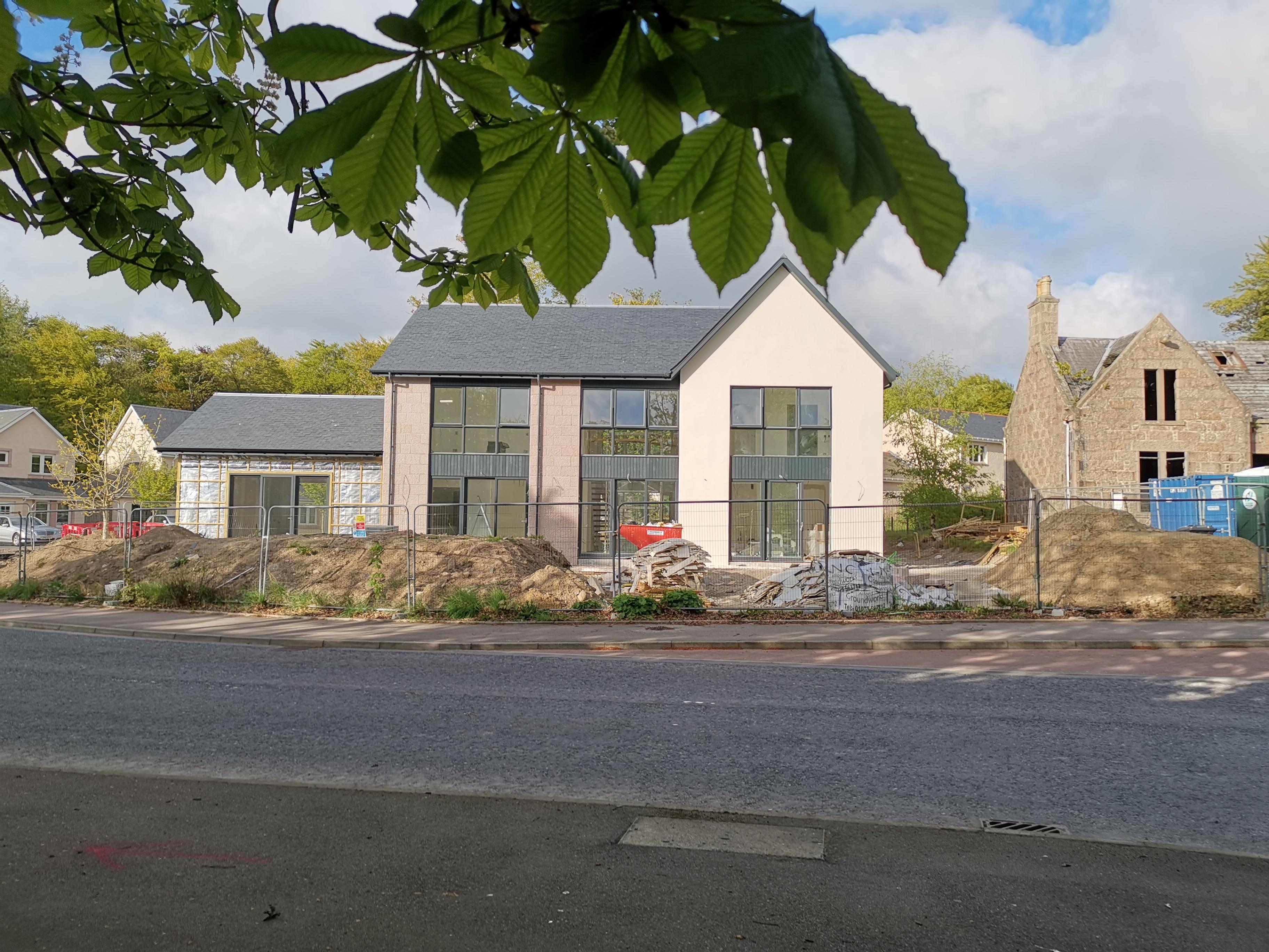

ultramods Posted June 11, 2019 Author Posted June 11, 2019 (edited) The wall would be at the front of the house in this photo, so that the lawn is the same level as the house floor. the wall would be at its highest of 800mm to the left of the photo and maybe only 400-500mm to the right hand side. Edited June 11, 2019 by ultramods

Thedreamer Posted June 11, 2019 Posted June 11, 2019 1 hour ago, ultramods said: The wall would be at the front of the house in this photo, so that the lawn is the same level as the house floor. the wall would be at its highest of 800mm to the left of the photo and maybe only 400-500mm to the right hand side. Going off the point, but the build is looking good! 1
K78 Posted June 11, 2019 Posted June 11, 2019 (edited) Cheapest way to do this is concrete Lego blocks. They have capping stones for the top. I done the same on a much bigger scale. Don’t need a SE design or foundation at your height if the ground is adequate. Digging could be done in a day with a digger n driver (£150). Edited June 11, 2019 by K78 1
patp Posted June 11, 2019 Posted June 11, 2019 1 hour ago, Thedreamer said: Going off the point, but the build is looking good! Yes, beautiful! 1
