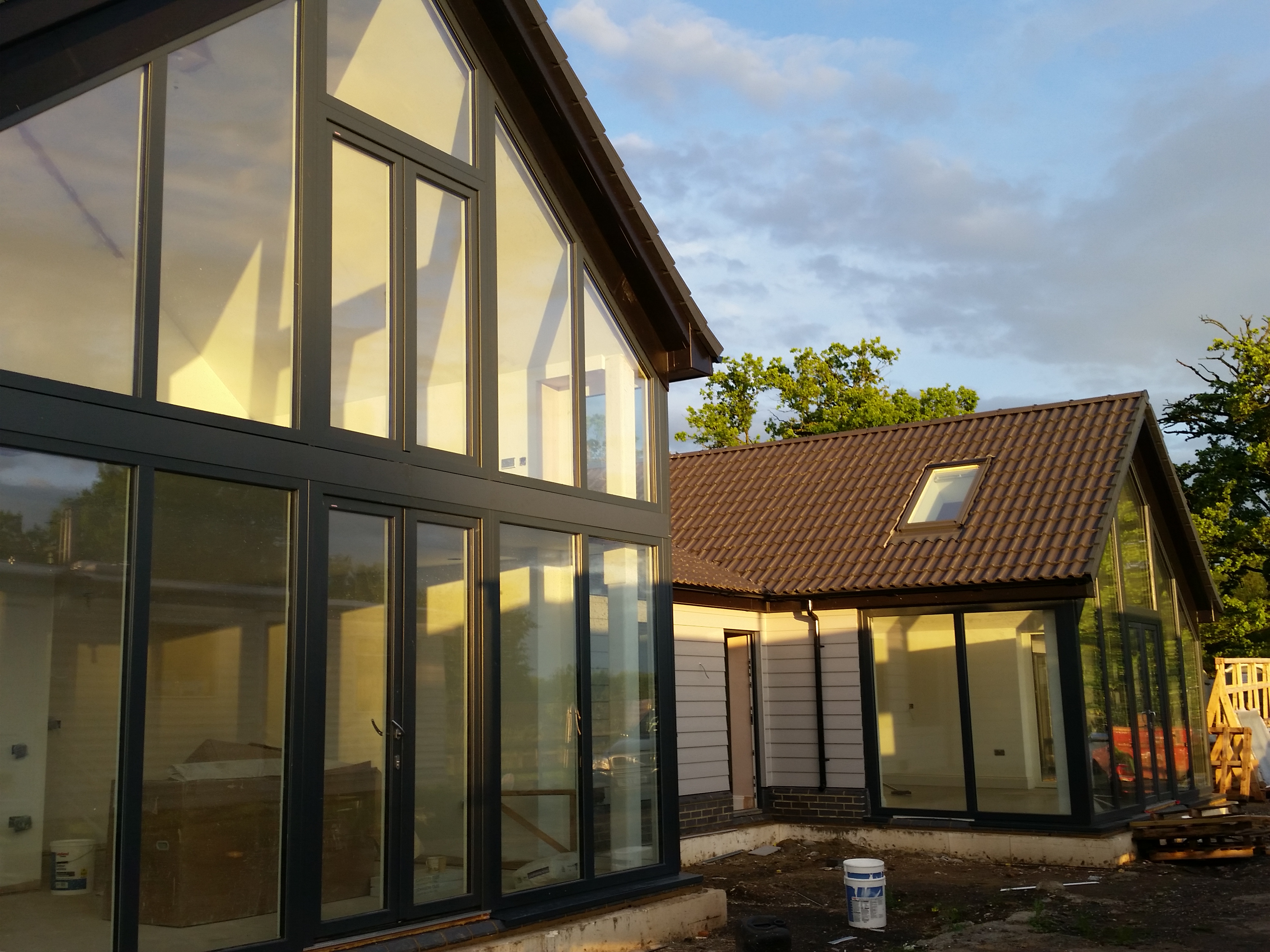

jamiehamy Posted September 9, 2016 Share Posted September 9, 2016 With no science behind it, I can share our experience thus far. We have 12m2 of glazing on the lower SW elevation. My worry was that it would heat up too much on sunny days. We have no UFH, but 80mm of concrete slag on top of the Tetris. We built the overhang to be 500mm, which means in the height of summer, almost no direct sun hits inside in the middle of the day bar the sill area. In addition, we specified Solar Tint glazing to reduce the heat gain (on that elevation only). We have only been wind and water tight for a month, but we have an inside and outside temperature sensor installed to track patterns. In short, the internal temperature downstairs is fairly contant and only increases of decreases very slowly and steadily. When you track against the outside air temperature, even when it's 22degrees outside, it might only reach 16.8 inside before sundown (there is no heating yet). But during the night when it might drop to 11degrees outside, the internal temperature will not go below 15degrees before dawn. Our overall U-value is targetting 0.15. So, hopefully the theory has paid off and we will not suffer overheating in the summer. If required, we can open windows and put ion by-pass mode, but slab cooling was never on the cards - too complex. Only time will tell tho! Link to comment Share on other sites More sharing options...
jack Posted September 9, 2016 Share Posted September 9, 2016 9 minutes ago, jamiehamy said: So, hopefully the theory has paid off and we will not suffer overheating in the summer. If required, we can open windows and put ion by-pass mode, but slab cooling was never on the cards - too complex. Only time will tell tho! I suspect we're coming into the most dangerous time for potential overheating. The sun is lower in the sky so penetrates further into the house and under overhangs, plus we still have some warm periods. Certainly our house has at times been a little stuffier lately than I've wanted but it's generally been fixed by opening windows. We haven't yet bothered to enable cooling on the ASHP and I'm not sure we ever will. In part this is because downstairs is always comfortable - it's the bedrooms that get warm, and they'd get hardly any cooling effect from reducing the slab temp. Link to comment Share on other sites More sharing options...

jamiehamy Posted September 9, 2016 Share Posted September 9, 2016 13 minutes ago, jack said: I suspect we're coming into the most dangerous time for potential overheating. The sun is lower in the sky so penetrates further into the house and under overhangs, plus we still have some warm periods. That's my hope! Bear in mind we're always a bit cooler up here, when the sun is low, hopefully it'll get to the back where it otherwise would not get. I suppose it depends how much the Solar Tint reflex - iirc the G-value was around 0.35 - would that be right? Partner still wants two 2.4x900 rooflights over the kitchen and dining area at the front but I'm pushing back until I know what the heating cycle looks like. You can see the tint in this pic - when you're below the level of the window it reflects the sky, but from above no difference. Link to comment Share on other sites More sharing options...

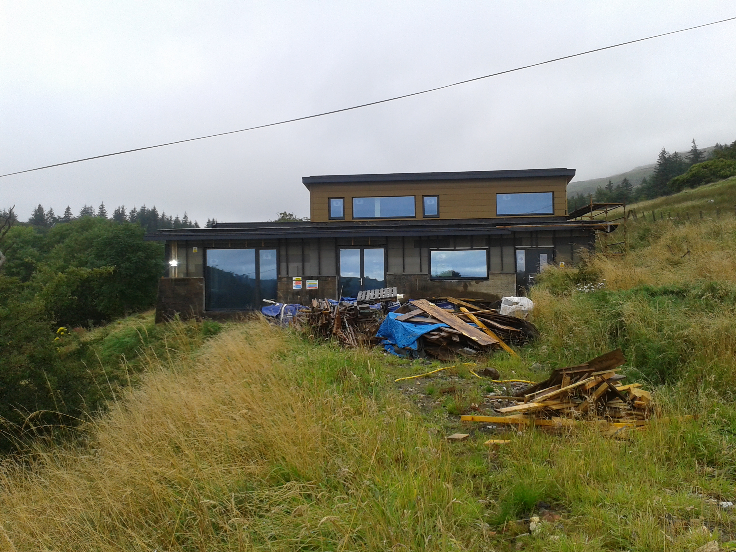

jamiehamy Posted September 9, 2016 Share Posted September 9, 2016 13 minutes ago, TerryE said: PS. I really can't understand all this fascination with glass. @jamiehamy, you must have what 15m² of glass there. It's U-value is at least 10× worse than wall and this must generate up to ~8kW solar gain in direct sunlight which must all play havoc with your internal temperature control. The fascination is about the view 5 Link to comment Share on other sites More sharing options...
TerryE Posted September 9, 2016 Share Posted September 9, 2016 It is a fantastic view, but you only use two of these to appreciate it: Seriously, I can understand why you have chosen all the window area -- as long as you are happy with the heating and cooling consequences of that choice, and have addressed them in your design. In our case we currently live in the centre of a village in a farmhouse built as part of a ribbon development from 1680-1850s. As with other farms, the farmland that was part of the farm attached to the house was split off and developed as a housing estate in the early 70s. The LPA have insisted that we build our new house which sits in a plot divided off from our garden in a style that is sympathetic to the adjacent traditional stone cottages -- but to our rear we overlook some rather tired and poorly maintained 1970s houses, so no nice view Link to comment Share on other sites More sharing options...
