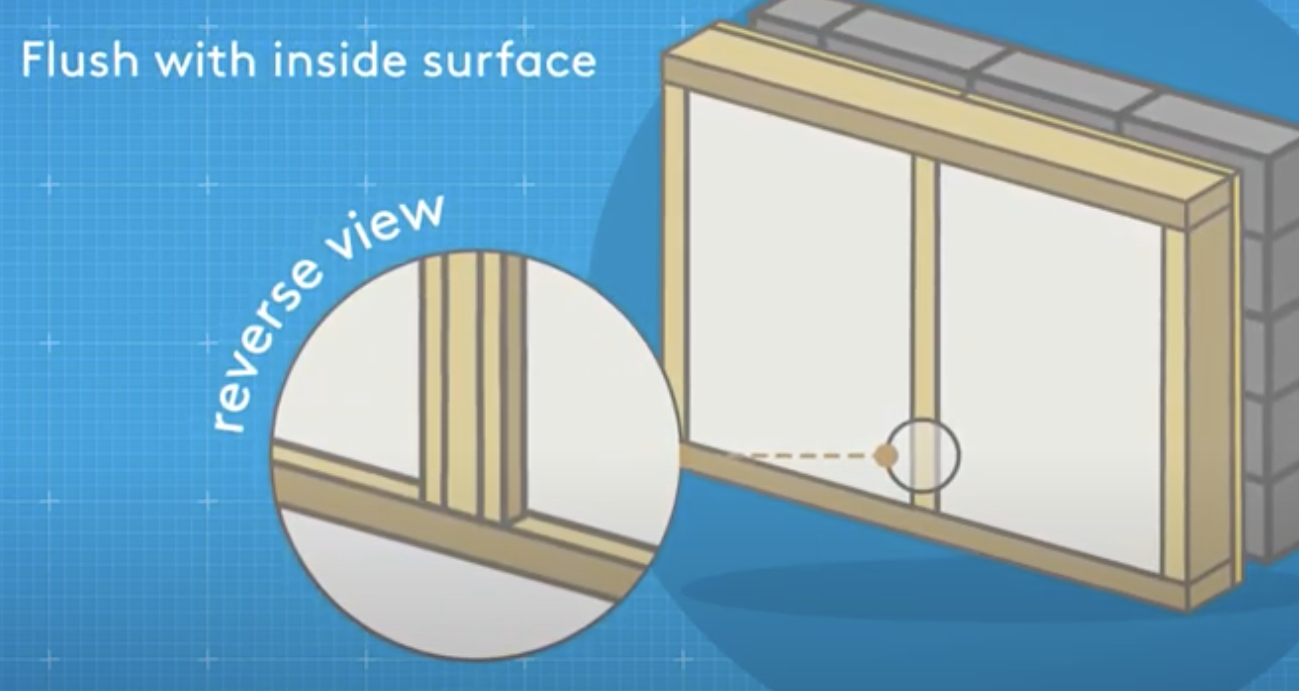

Great thank you so this for studwork? It says "Please note: Finished size is 63 x 38mm" which is why I put down the 63mm https://www.selcobw.com/products/timber-mdf-sheet-materials/cls-timber/cls-softwood-studding-75-x-50mm-3-x-2-nom-pefc And you're right, I should not skimp on the PIR for between rafters. I wasn't aware there was such a perf difference. Thanks a lot

Thanks a lot. Sorry for being a dimwit but assume you mean the battens/studs? I was going to use this cls https://www.wickes.co.uk/Wickes-Studwork-CLS-Timber---38-x-63-x-2400mm/p/107177 because it's dirt cheap and strong. There will be a boiler attached to the wall (making sure I get the studs in the right place) as well as other things which will need a bit of structural oomf so wanted to use something with some strength Concrete screws to attach to the wall 13mm spacers sounds like a great idea. Will just rip some cheap battens for this

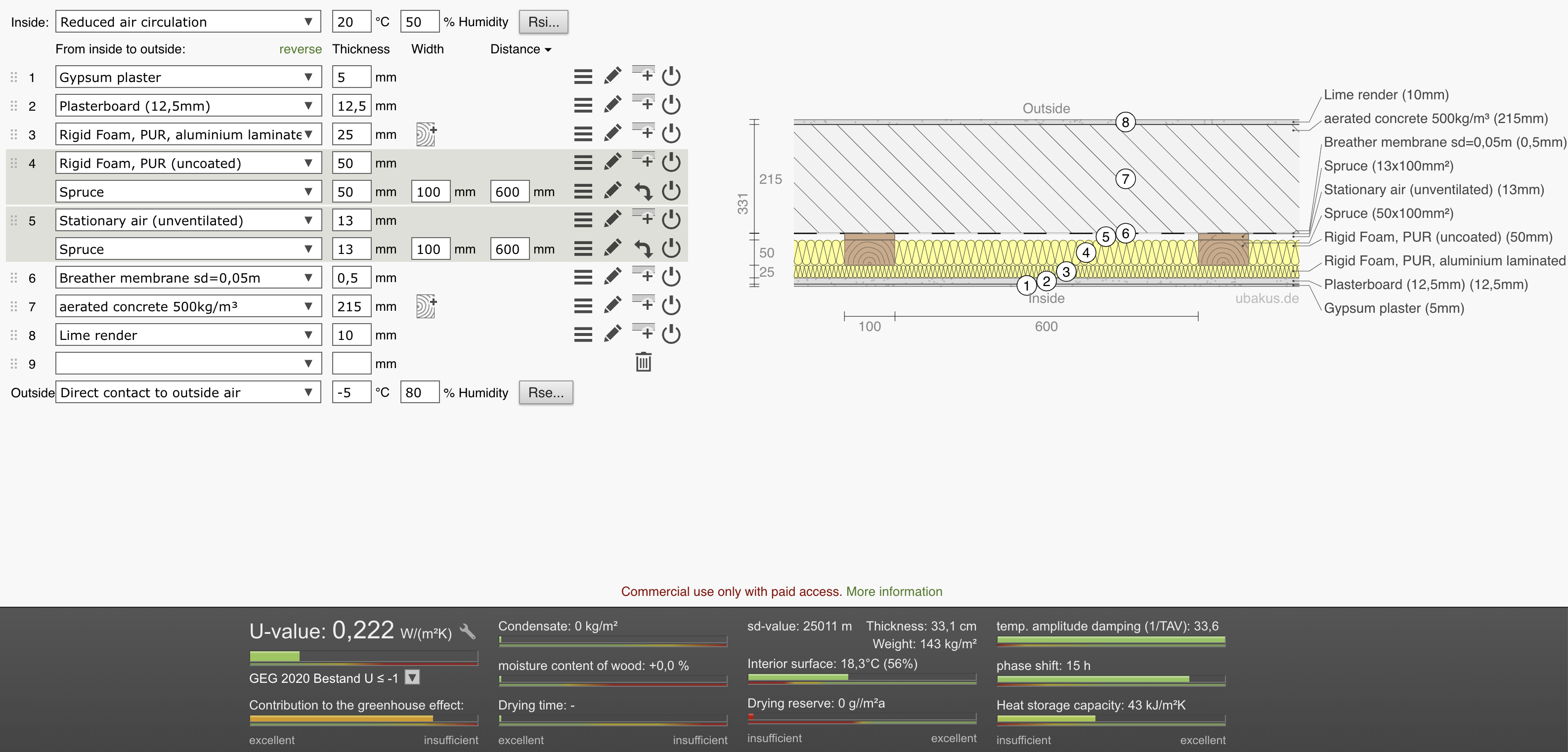

Could someone please sense check this insulation for a solid wall for a garage conversion. I have asked building control but they said they weren't interested. Things I'm not sure about. I have a very small air gap but I think this is countered by the breather membrane, does this make sense? Using uncoated PIR (thinking this General-Purpose-Polystyrene to save quite a few pounds) between the battens because the outer layer of PIR will be coated and act as the vapour barrier. Apologies have asked this question before but slight change here in the makeup so want to make sure I get it right. Thanks in advance

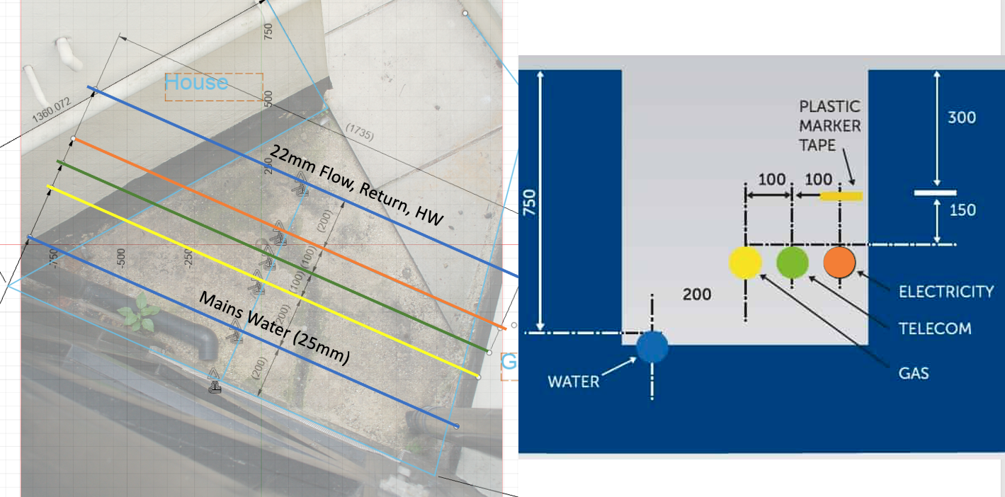

Currently in the process of moving some services from our single storey main house to a single storey detached garage (which will be converted into a living space). I will need to run the services underground between the two buildings, a distance of less than 2 meters. Looking around I can see the depths and distances of the various services. I will clearly be getting the appropriate trades to run the pipes and cables but will most likely be digging the services trench myself. Given the sizes of the services (and protective conduit) I am concerned about weakening the foundations of both buildings. Should I be looking to put a lintel or steel in the footings above where the services will enter, much in the same way you would for building over drainage pipe or are the holes going to be insignificant overall? Structure of the garage is 215mm single skin blockwork, house is cavity wall standard brick Services to be brought through the footings Mains Water - MDPE Pipe insulated inside 110mm plastic drainage pipe Gas - Most likely 32mm TracPipe with 40mm sleeving Telecom - 25mm MDPE conduit Electricity - SWA inside 40mm conduit Hot Water from Boiler in garage to house - 3 x 22mm PB Barrier pipe individually insulated inside 110mm plastic drainage pipe

A bit more research on this. Reading the HSE document Safety in the installation and use of gas systems and appliances here: https://www.hse.gov.uk/pubns/priced/l56.pdf I note Regulation 19(2)–(6) paragraphs 5 (5) No person shall install any installation pipework or any service pipework under the foundations of a building or in the ground under the base of a wall or footings unless adequate steps are taken to prevent damage to the installation pipework or service pipework in the event of the movement of those structures or the ground. Which suggests the pipework could be joined to the existing incoming supply pipe using TracPipe, routed under the floorboards, exit the wall on the opposite side of the room and connected to the new meter cupboard on the external wall. Any regulations people are aware of that would prohibit this? I would like to be well armed before speaking with the gas supplier to move the meter as they will inevitably suggest metal pipework clipped to the exterior wall. This is a listed building so something like that visual from the outside is never going to cut it with the conservation officer.
Many thanks Tony. So gas supplier rather than gas transporter in this instance if I can do the whole move under the floor and through the external wall? And presumably gas transporter if the move needed to be done externally digging up the pavement to route the pipe externally?
Just to be really clear I will not be doing any of the work mentioned below. This will all be carried out by Gas Safe Engineers. We're in the process of buying a property which is a bit of a doer upper. One room houses the gas meter and boiler and we are keen on moving both of these to turn the room into a bedroom regardless of whether regulations state they are safe in a bedroom. As we don't currently have access to the property to show round plumbers would like some advice on whether my ideas make sense or are completely nuts. The gas meter is currently in the middle of an internal wall behind which is a small garden facing on to the street seen in the picture below. The Gas Safety (Installation and Use) Regulations 1998 state: Protection against damage 7.1 Any person installing a gas fitting shall ensure that it is properly supported and so placed or protected as to avoid any undue risk of damage to the fitting. In my mind the meter in its current location is in breach of this regulation as whilst against the wall is protruding into the room and could be easily knocked. We are looking at having this moved to a external meter cupboard. Looking externally this is a move of approx 2.3m But if looked at internally this would be a move of around 1.78m. So the first question is can a Gas Safe engineer move this meter or would it need to be the current supplier? Taking a punt on saving money is there any chance I am correct that the current install is dangerous and that I could magically get this done free of charge? Next question is how will the gas pipe from the new meter location enter the property? Is under ground level (as you can with mains water acceptable) with the correct sleeving? Would this use TracPipe or similar? Or would it need to enter the building above ground level above the DPC? I ask about entering the building as I already need to dig a trench/pit where the proposed new meter will be for other services so thinking of the neatest solution. Also planning on moving the boiler from this room to a detached garage ~1.3m away from the main building so this will already require buried gas pipework.

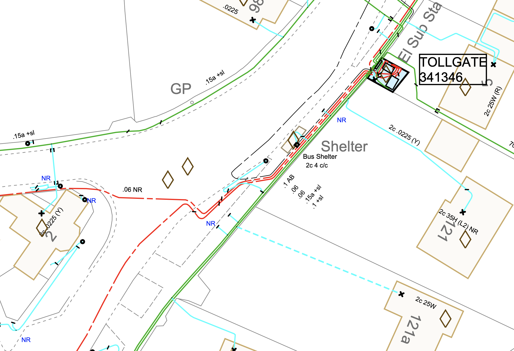

Obtained a safe dig plan from uk power networks. Very annoyingly they don't include a key. Does anyone know where I can get hold of one? Specifically interesting in what the green and red lines are the diamond shapes NR .15a +sl Also, is it possible to find out for a given substation any info on the earthing system etc? Thanks in advance

Thanks a lot Mike. You missing it off actually prompted me to use www.ubakus.com. What a fantastic site. Will be using this again and again- 6 replies

Awesome thank you. So: Render 200mm block-work 100mm studs filled with 75mm foil backed PIR Foil tape for joints 12.5mm Plasterboard Skim Layer Any idea where to get the U-values this would generate?- 6 replies

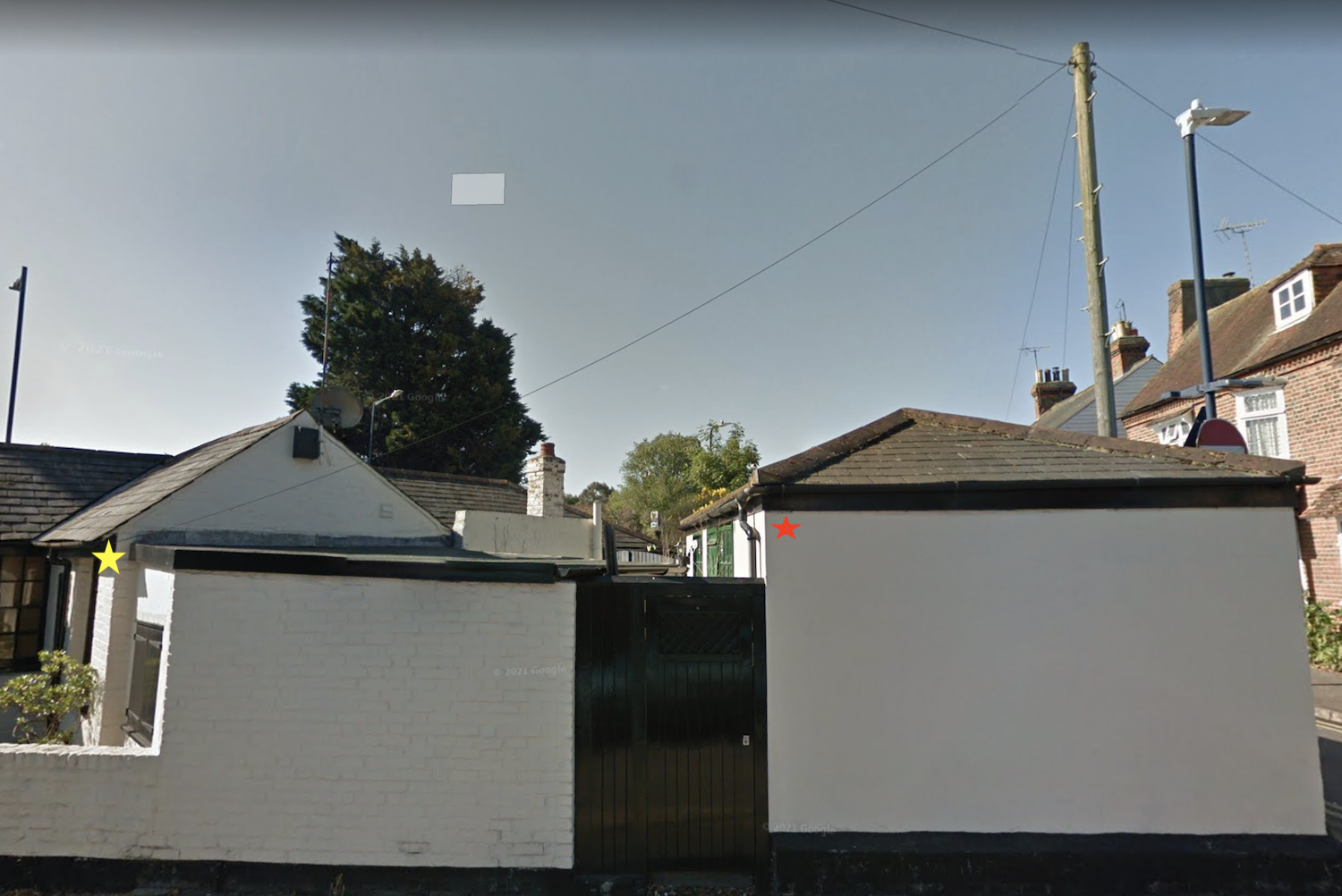

hmmm. Sounds like a roost for seagulls given the location of the house. I’d sooner pay openreach to move it than this.
Yeah I get what your saying but this would be through the house, chased down a wall, under a floor and through a trench to the current garage to get it where I want it. I just think that's far too much rat fodder
This looks great, thanks a lot
I would like to move my phone cable entry point to the house as it currently wraps around the building and ends up in a pretty useless place meaning loads of horrible internal cables. Are there any regulations on the gradient from the pole to the building that anyone is aware of? Current entry point is the yellow star and proposed is the red star. Also is this something I can do myself or do I have to get a phone engineer to do it? Totally understand there's voltage going down it (50v?) so would obviously take great precautions.
