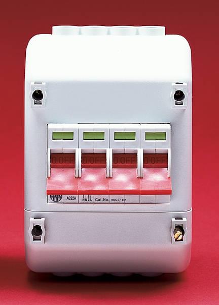

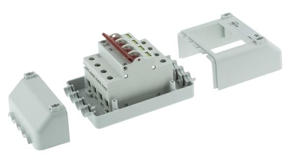

Just to preempt any concerns, all the works below will be carried out by a qualified electrician. In the process of buying a house and just trying to get a head start on planning electrics. As I am trying to eliminate untidy mess is putting a Henly block inside a consumer unit allowed? I only need a 3 way (1 in and 2 out) for 25mm 100A and seems a waste to have yet another thing on the fire resistant board when there is a load of space inside the consumer unit. If not allowed does such a thing as a 3 way din rail connector of this size exist and would this be allowed? Thinking of something like this with 1 x in and 2 x out Or this but for 25mm cables

Combined Henley block 100amp DP Isolator
tvrulesme replied to tvrulesme's topic in Consumer Units, RCDs, MCBOs
Ah, you genius. Yup, that's the bit I was missing. Thanks so much for the explanation -
Thanks a million Dave. I kind of assumed because it would be behind the main fuse and this isolator switch that would be sufficient. Just out of curiosity what's the reason that's not enough? Just in case I haven't explained my crazy idea well enough Incoming supply cable > main fuse > meter > Isolator switch (splits into two) > house & garage CUs -
Just to preempt any concerns, all the works below will be carried out by a qualified electrician. In the process of buying a house with an outdated meter, mains fuse etc which I intend to get UK Power Networks and the electricity supplier to replace with 100A Smart meter etc. I will be running power to the detached garage at some point and may as well add enough umpf for an EV charger. Currently there is no Isolator switch and my question is considering an already crowded electricity cupboard, does such a thing as a combined Henly Block and Isolator exist? I've seen these 4 pole 100 amp isolators so in my unqualified mind joining the two left lower poles and the two right lower poles with a chunky busbar would do the same thing as a Henley Block. The outputs would then feed two respective consumer units, one in the house, one in the garage. Am I thinking crazyness or would this make sense/be signed off?

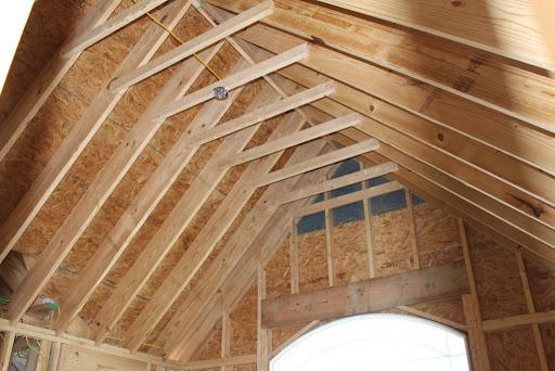

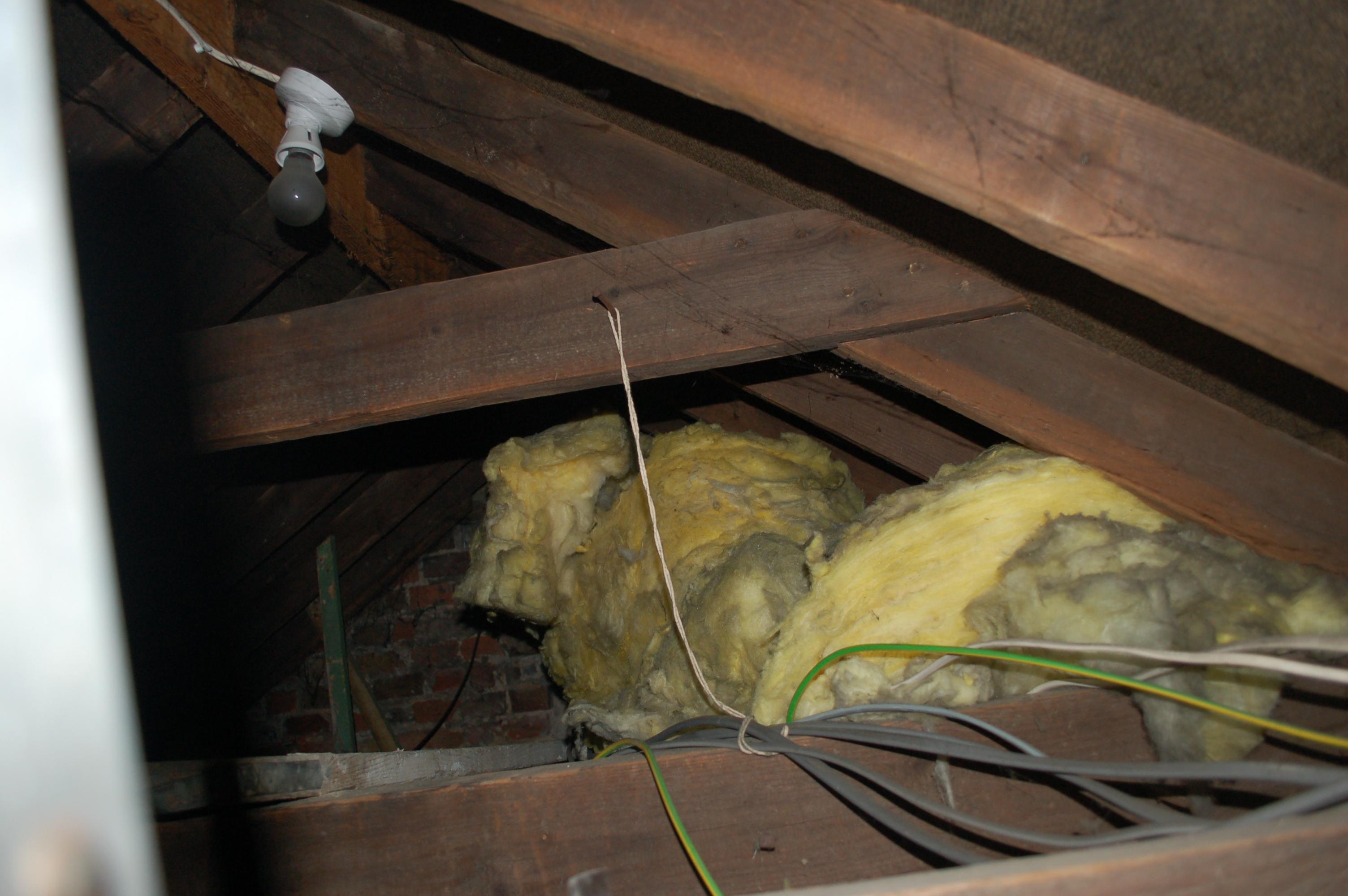

Thanks Dave. Yes pretty much a full rewire and loads of cables which are no longer in use there. In terms of the void thinking along the lines of this where the triangular bit at the top is effectively for all the cables etc but all plastered. All existing timber to remain in place as a "feature", or replaced with more decorative structural oak

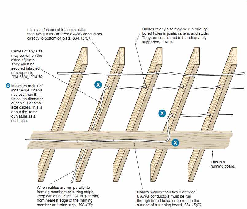

We are looking to vault the ceiling in our property and so looking to get a qualified electrician to sort out the mess of cables running though the loft. As we're considering having a service void just below the main ridge, is it compliant to put a timber running board on the rafters next to the ridge and have an electrician secure the cables to it? Found this image but I suspect it's US rather than UK.

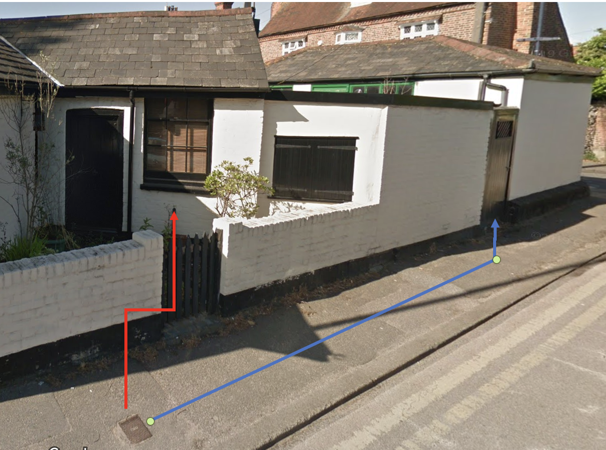

tvrulesme replied to tvrulesme's topic in General Plumbing
Thanks Tony. In that case once the water pipe is inside the property, assuming I can take it under the floorboards to the more convenient place without having to dig down to the 750mm I would need outside?- 3 replies

I have an old lead water pipe which I am looking to replace with MDPE. My supplier (Southern Water) state: "If you have lead pipes and you decide to replace these, we will also replace our part of the pipe that connects your pipe to our main (known as the communication pipe) free of charge if this is also lead" My part of this is to bring the MDPE to the boundary which in this case is the pavement. The question is could I bring the pipe to the gate shown in the image below by the blue arrow rather than use the existing shown by the red arrow? Would the water supplier then trench to the street stop cock? Clearly this assumes a trench dug to the correct depth etc. We're renovating the property and in future would make more sense to enter at this point as we are moving the boiler to the building on the right side of the gate.
