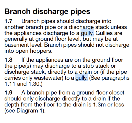

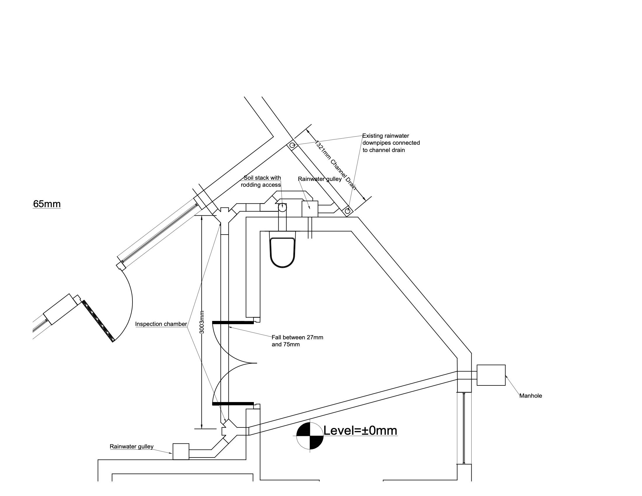

Unfortunately not. I would not be able to get the levels as it's a wetroom so the waste is lower than the soil pipe, particularly as it's a wall hung toilet which will discharge horizontally out of the wall. Confused though, 1.8 states I can discharge to a gully if the pipe only carries wastewater. Would this not count as wastewater?

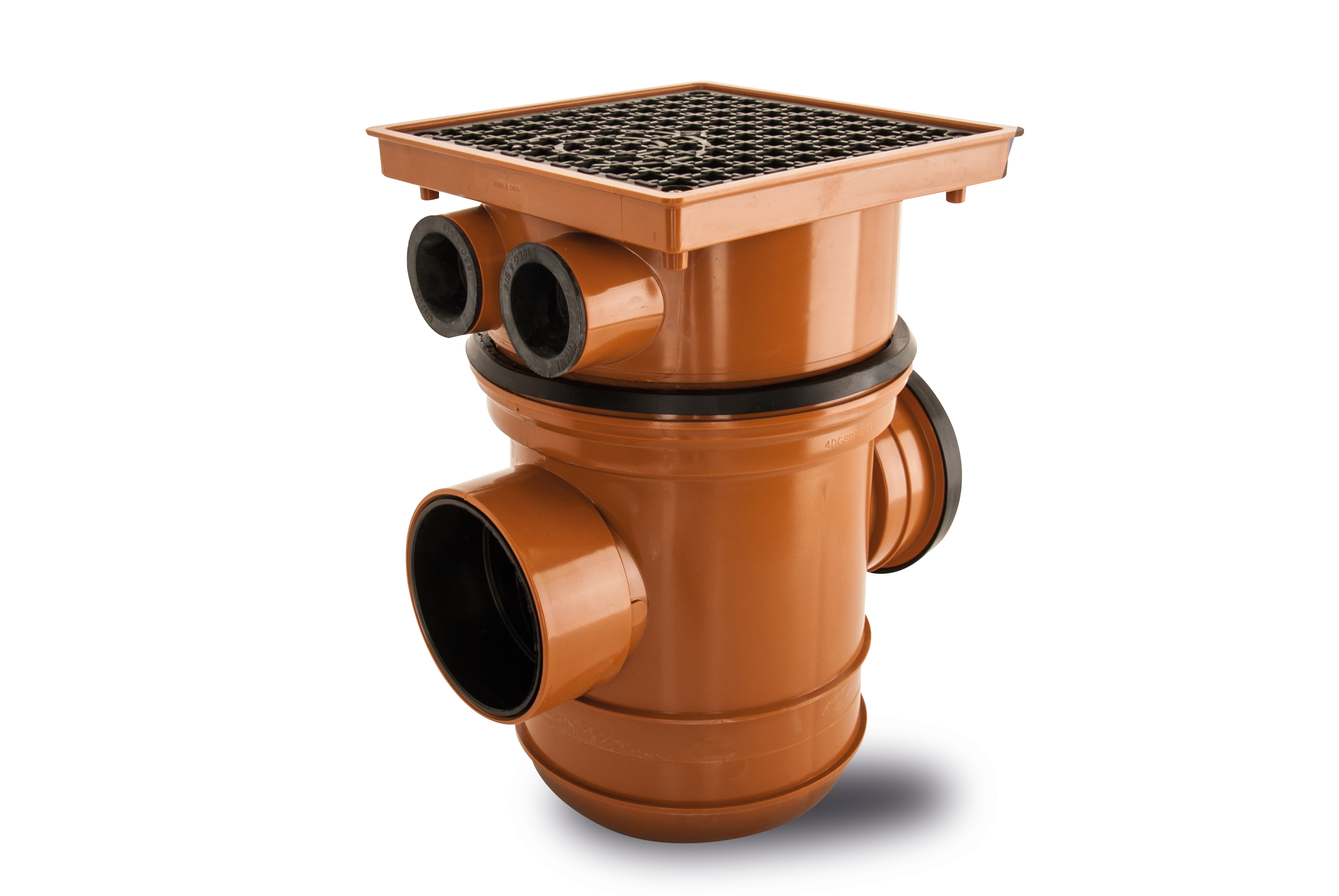

Thanks Conor. One thing I am unsure of is if I can connect the shower waste to the gully underground using something like this: I have the option to bring the shower waste either above or below ground level outside. Preference for tidiness would be underground but I don't want to screw myself over with the slab down if this is not allowed. Building regs approved document H state: "A branch pipe discharging to a gully should terminate between the grating or sealing plate and the top of the water seal" Which is what it looks like the above would do perfectly well

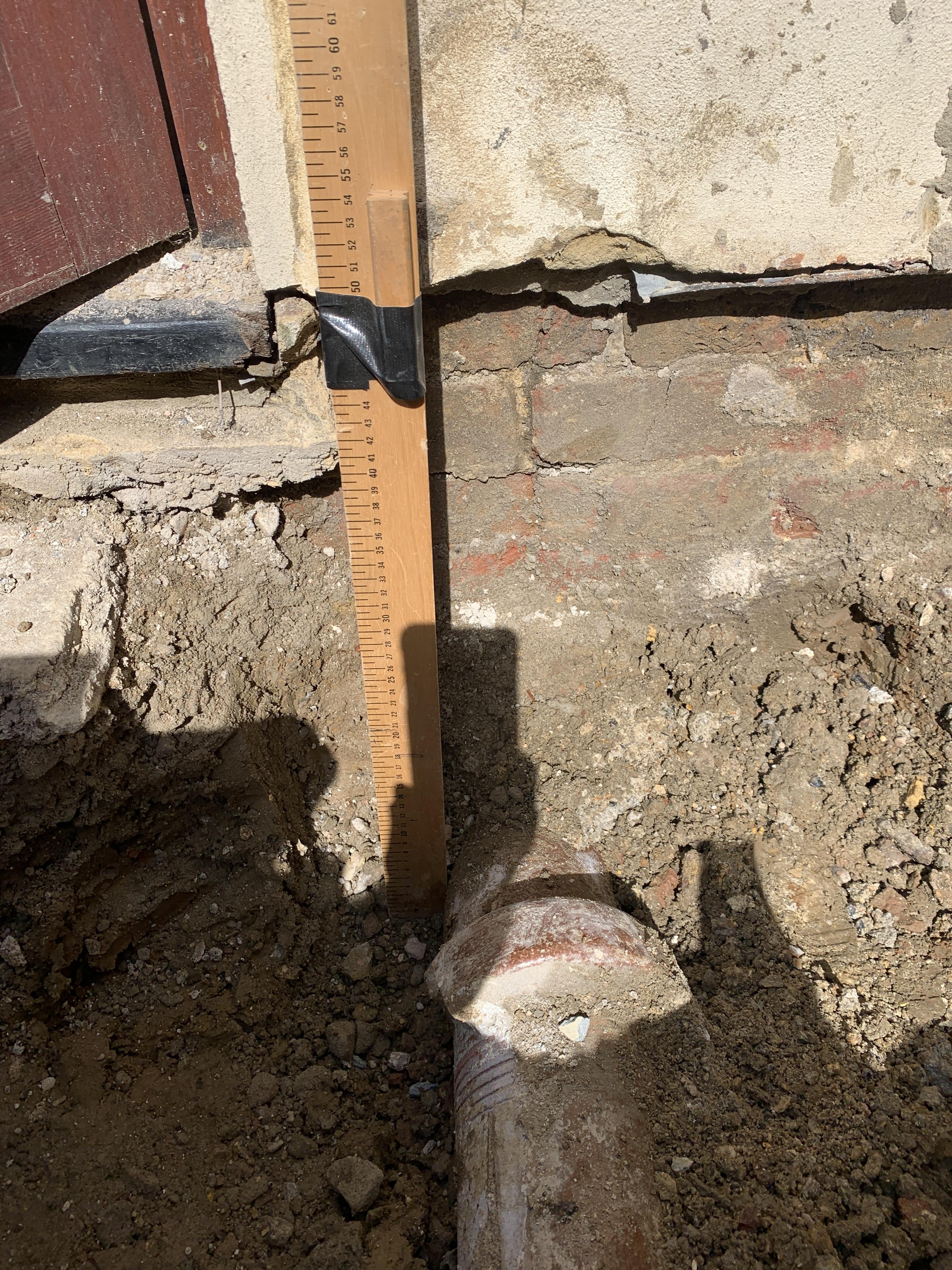

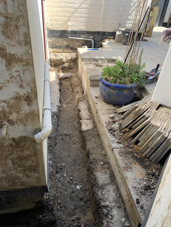

Close up of the existing clay. Top of the black gaffer tape is the same level as the DPC inside the house

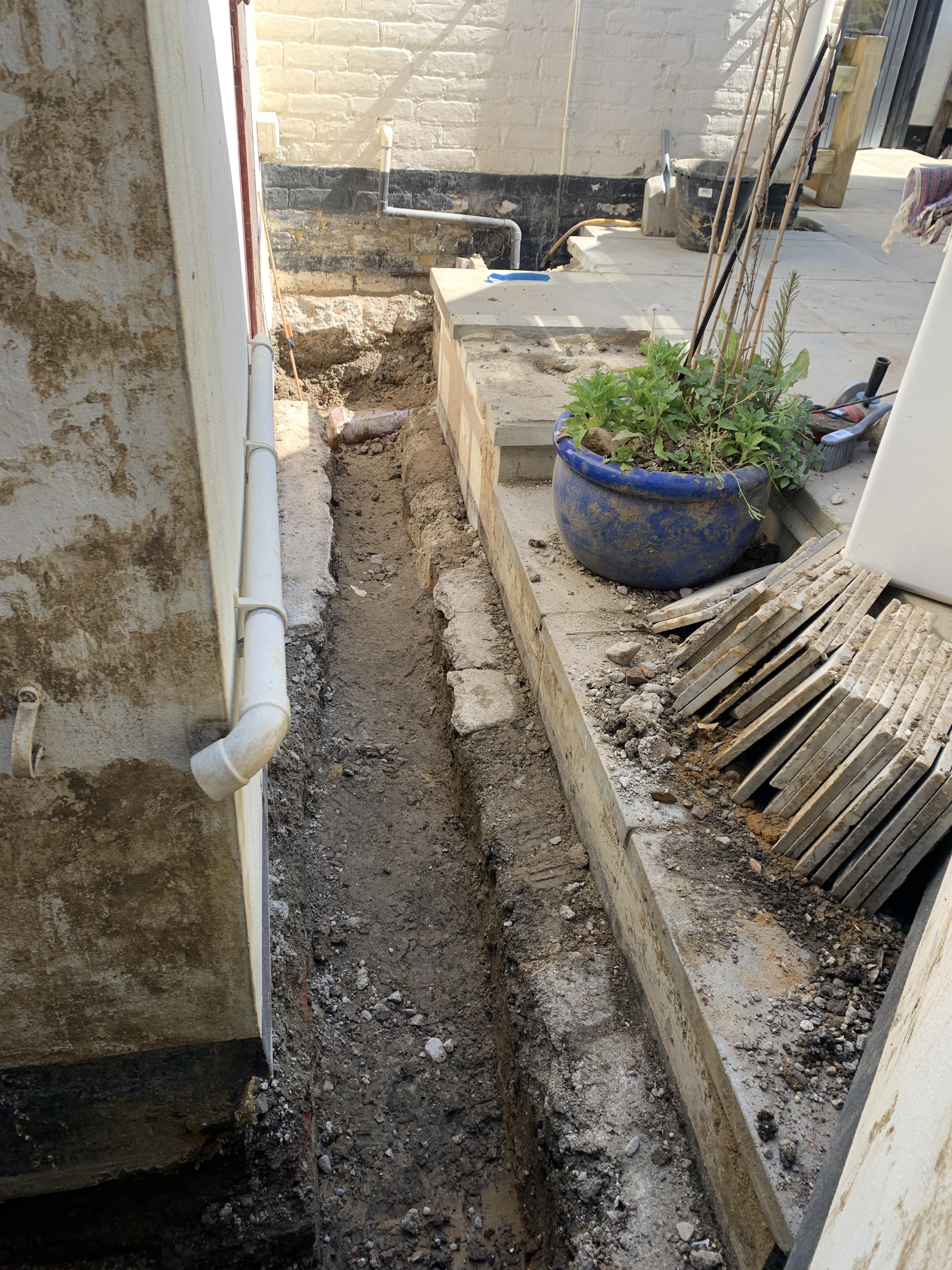

Kind of cheating because I already have the ground opened up. Needed a trench for moving a gas main so I just kept going. My heights are all determined by an existing clay soil pipe which runs under the house which you can see at the end of the trench. Have to lay some waste for a shower this weekend which will be buried in a slab so I'm trying to do as much planning as I can before I do that
Thanks Conor. I was trying to use it as an exercise in working out what parts I would need It is combined yes. Yeah I'm going to rethink the gully part. I'll do it detailed for me and then simplify for building control once I've got it clear in my head

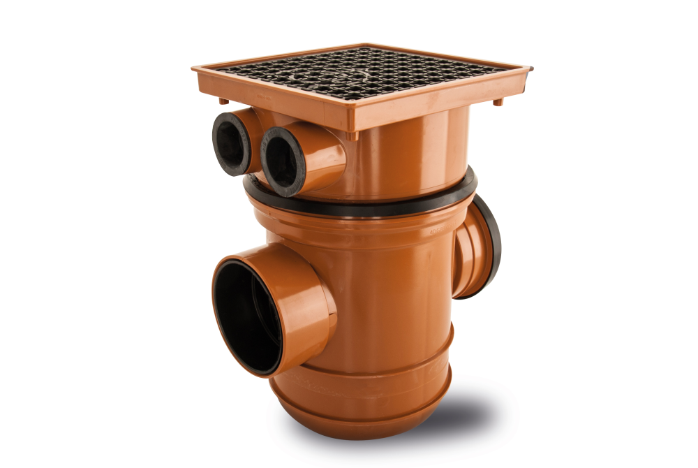

About to submit some drainage plans to building regs so I was hoping that I could get some views on here as to what they would likely object to as it's easier to make changes before submitting than after. Assuming the gradients are within spec does anything look out of place or could be simplified here? The shower/sink waste goes into a gully because I can't get the 450mm above the invert of the soil pipe to connect a boss to 04-foundations-drainage.pdf
Planning drainage for a new bathroom. Assuming that all the falls/gradients are correct is there anything wrong with this plan? Soil pipe from toilet goes through wall below the floor level so that I can connect a shower waste (wetroom so flush with floor). On the other side of the exterior wall is the soil pipe vent (with rodding access) and an inspection chamber where it joins the underground drain pipe at a 90 degree angle. Been through all the regulations I can find and seems ok but maybe I am missing something? Does the shower trap adequately stop the stench from the WC waste or is there a key component I'm issing?

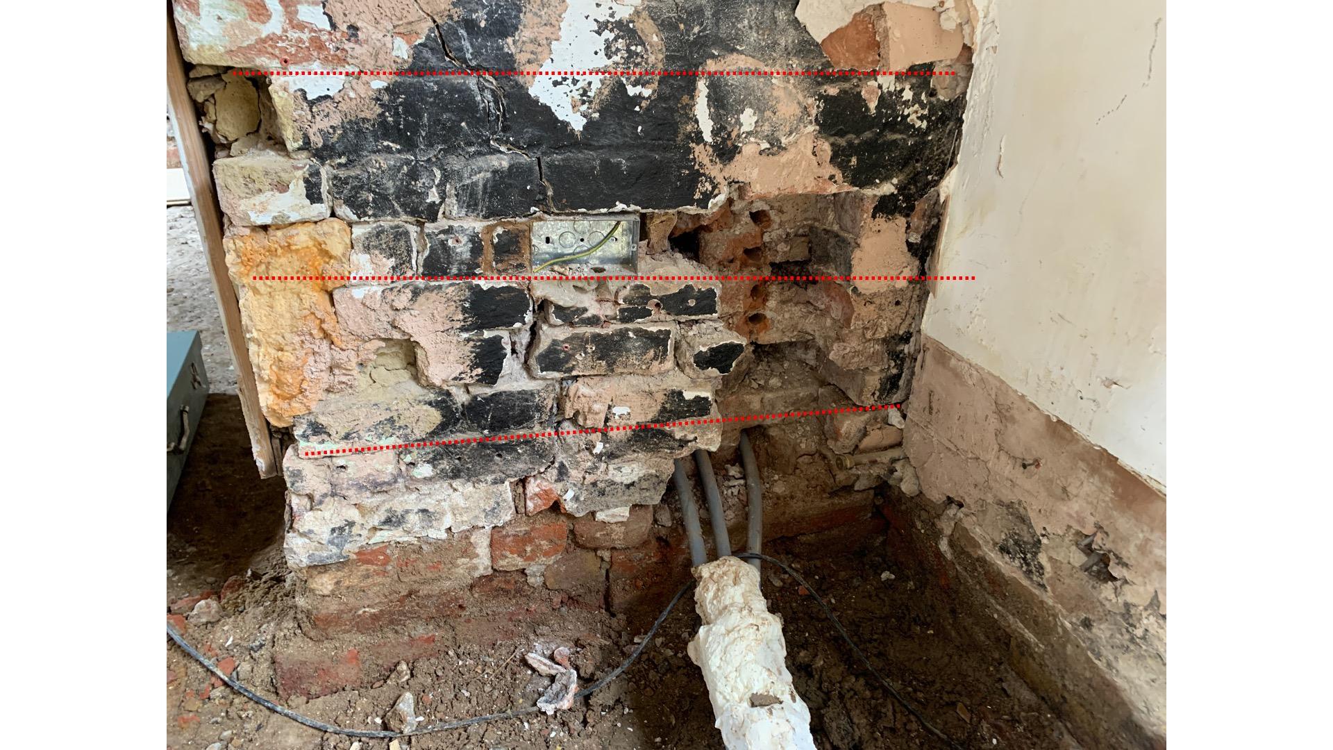

The whole house is going to be rendered in 3 coat lime so ideally I will be using lime mortar but it's such a pain to get hold of and the thought of this loose wall is losing me sleep so I'm going to have to see if my fear overcomes my patience Like the idea of SS expanded metal lathing. I also have some left over slate so packing is a great idea thank you.- 6 replies

Thank you. The pipes have no real reason to go through the wall any more. I had to dig out the existing slab as it was in a terrible state so for a little extra plastic pipe I may as well route them through the doorway to the left of this section. Seeing as I have a load of helical bars I got in bulk you don't think it's worth shoving a few in for the sake of a few minutes work?- 6 replies

In the process of renovating an 1810 bungalow (cottage). Having ripped some plasterboard off the wall I was greeted with this horror show. This was the original exterior wall of the house. It was all very damp because there used to be a toilet here and a previous builder decided to just lay DPM and a thin concrete slab over the waste pipe without bothering to cap off the unused soil pipe. All the bricks in this section are very loose (I could probably pull them out by hand). Struggling to know where to start with it. I was thinking of putting in some 6mm helical bars along the dotted red lines in the picture and then rerouting the plastic pipes so they don't go through this wall and slowly replacing/adding in missing bricks leaving each part to set as I go. Does this sound sensible or like a stupid plan? The wall will eventually be rendered so I am more interested in structurally sound than pretty. Any advice very gratefully received.

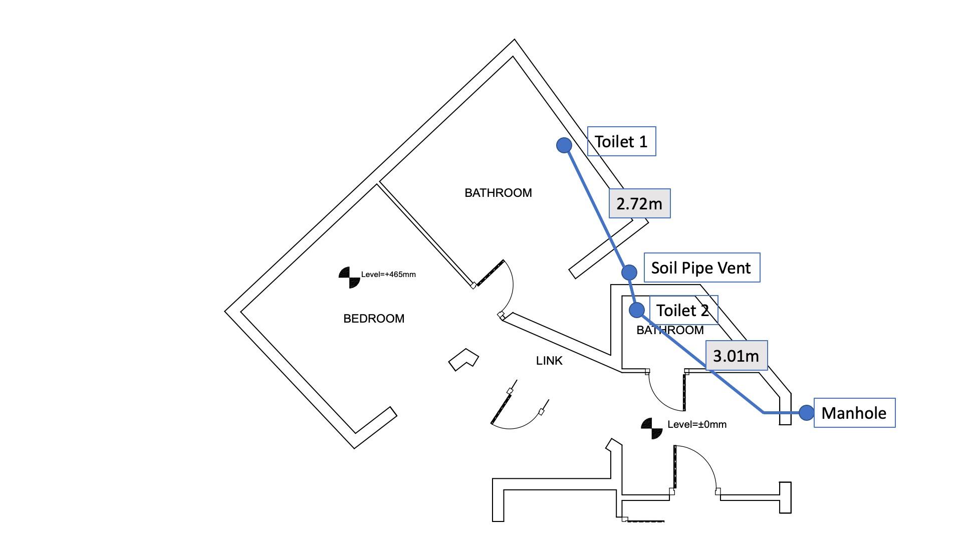

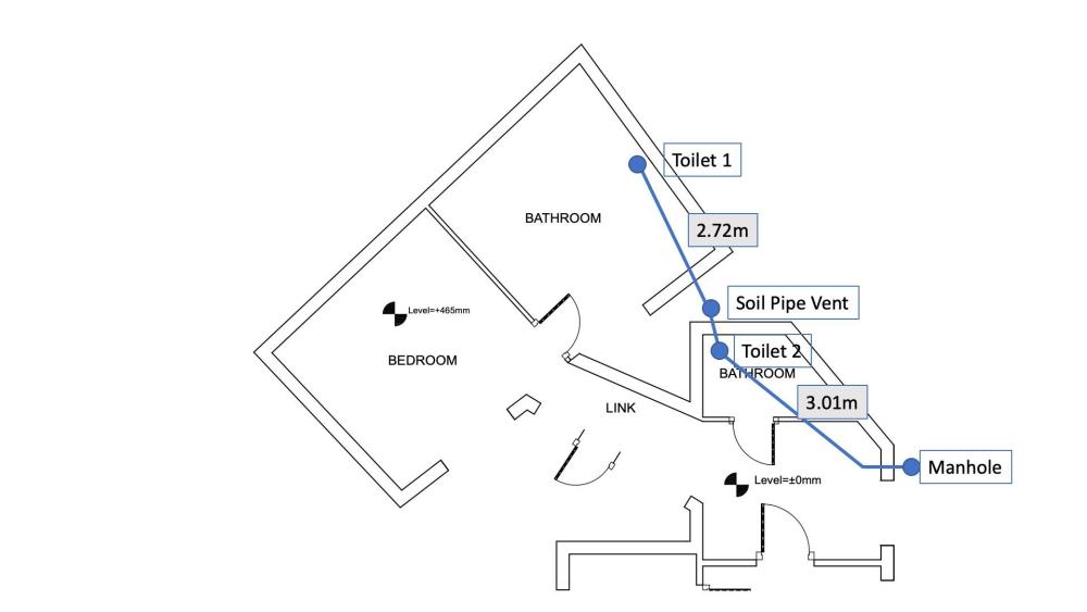

It is outside yes. And yes, a very odd space. It’s a very unusual plot. Neither toilet exists at the moment so this would all be new pipework
The manhole/inspection chamber in the picture is on my property. Should have said

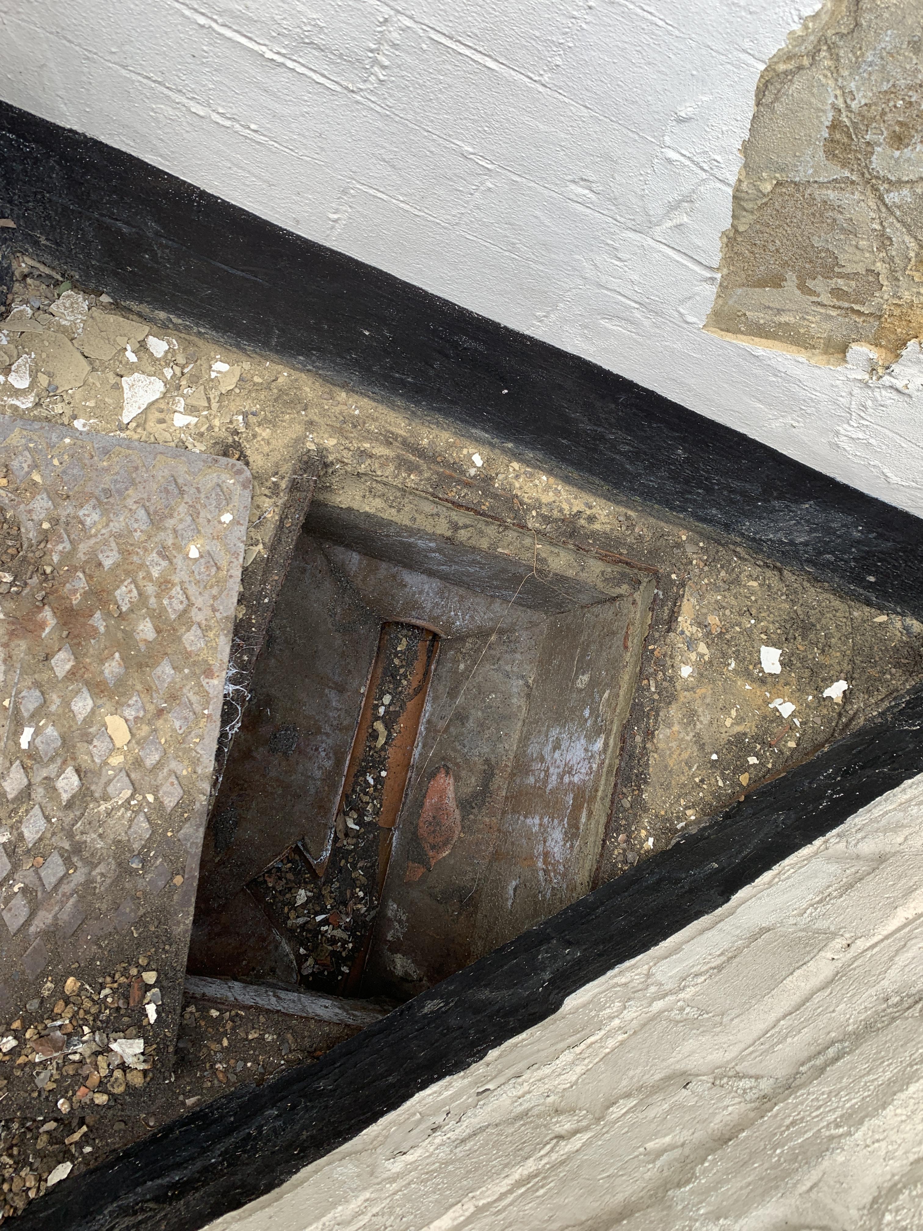

Yes the pavement is directly on the other side of the wall. The existing drain also runs directly under the room where Toilet 2 will be so hoping to make a connection to this underground within the room. I understand this will not require an access chamber inside the room if the branch junction is 45 degrees or less. Here's the inside of the manhole. Am I am confusing my manholes with my inspection chambers?
Where the vent pipe is? I didn't know that, but luckily for me there's a bloody great trench where the vent will be which I dug for other services so should be easy. Thanks a lot for pointing it out
Renovating a bungalow which has a detached garage which is ~46cm higher than the main dwelling. Planning a drain run for the two bathrooms. Can I put the vent in the middle of the run as in this picture? Assuming the gradients are correct and the bends are nice and smooth, is there anything else I should worry about from this plan?
