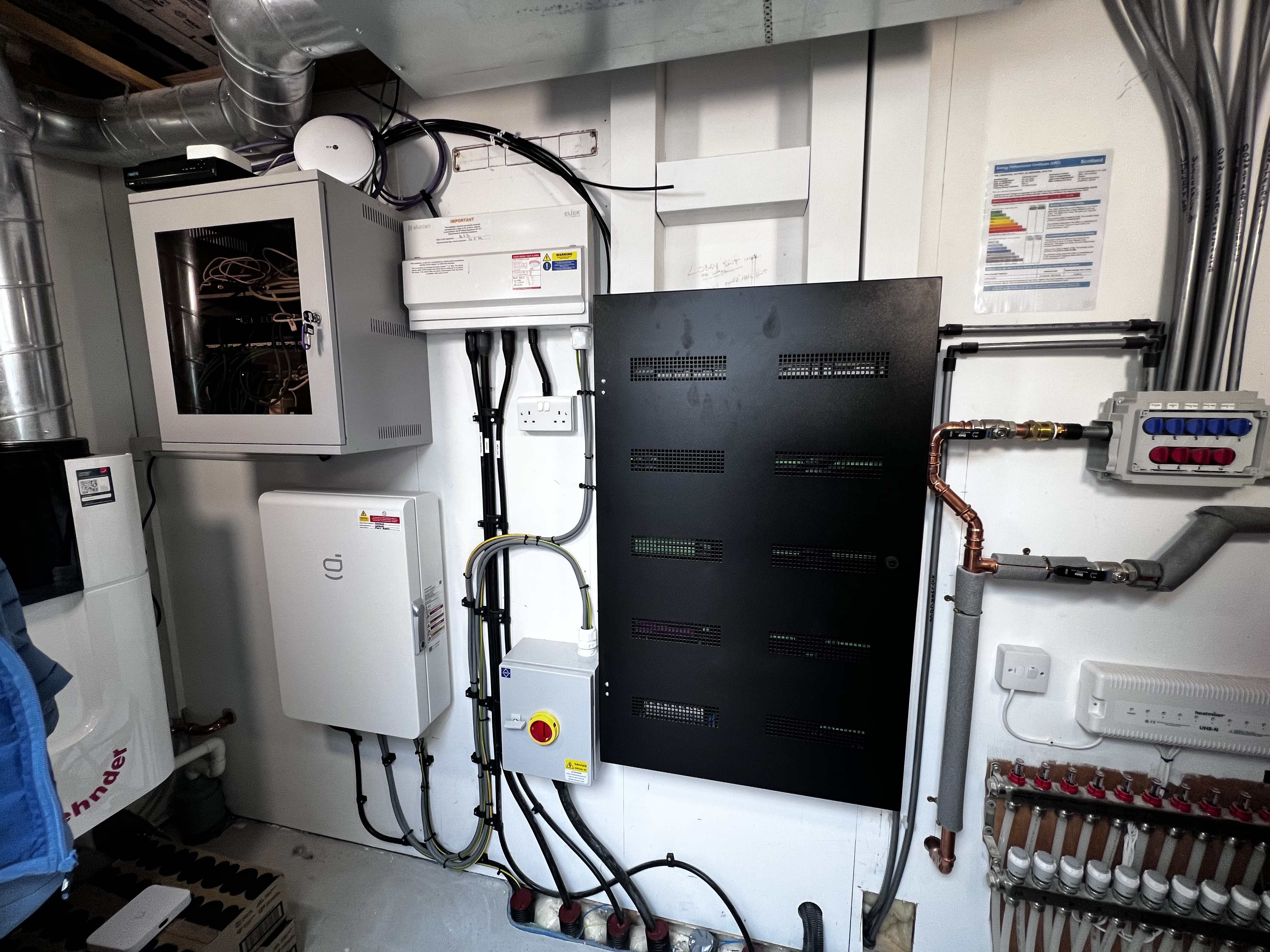

  5. These cable monkey cabinets are on the dearer side but they are very well made. I bought a previous one from Amazon you had to assemble and it was made from tin foil so returned it. The issue I had is I couldn’t fit a full depth cabinet as the MVHR unit is in the way. This is a 320mm deep cabinet but it only has 230mm of working depth inside from the mounting rails to the back of the panel which made cabling it hard work with CAT6a cable as it’s a bit inflexible. If also doesn’t have any inbuilt cable routing that some of the bigger cabinets have. It’s not as tidy inside as I like. At some point I’ll tidy it up. Winter weekend job.

  10. Do you mean the Loxone cabinet or the comms cabinet? The Loxone cabinet was from @Rob99on here. The comms cabinet, shelves, patch panel, and PDU was from Cable Monkey. I have abother one in the garage. All the other kit was from various places or I already had.

  22. https://www.futureautomation.co.uk/Enclosure/Loxone-Lighting-Enclosure Comes with a door and a screw on panel. This is the door fitted.
