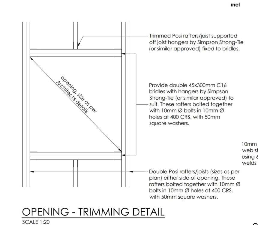

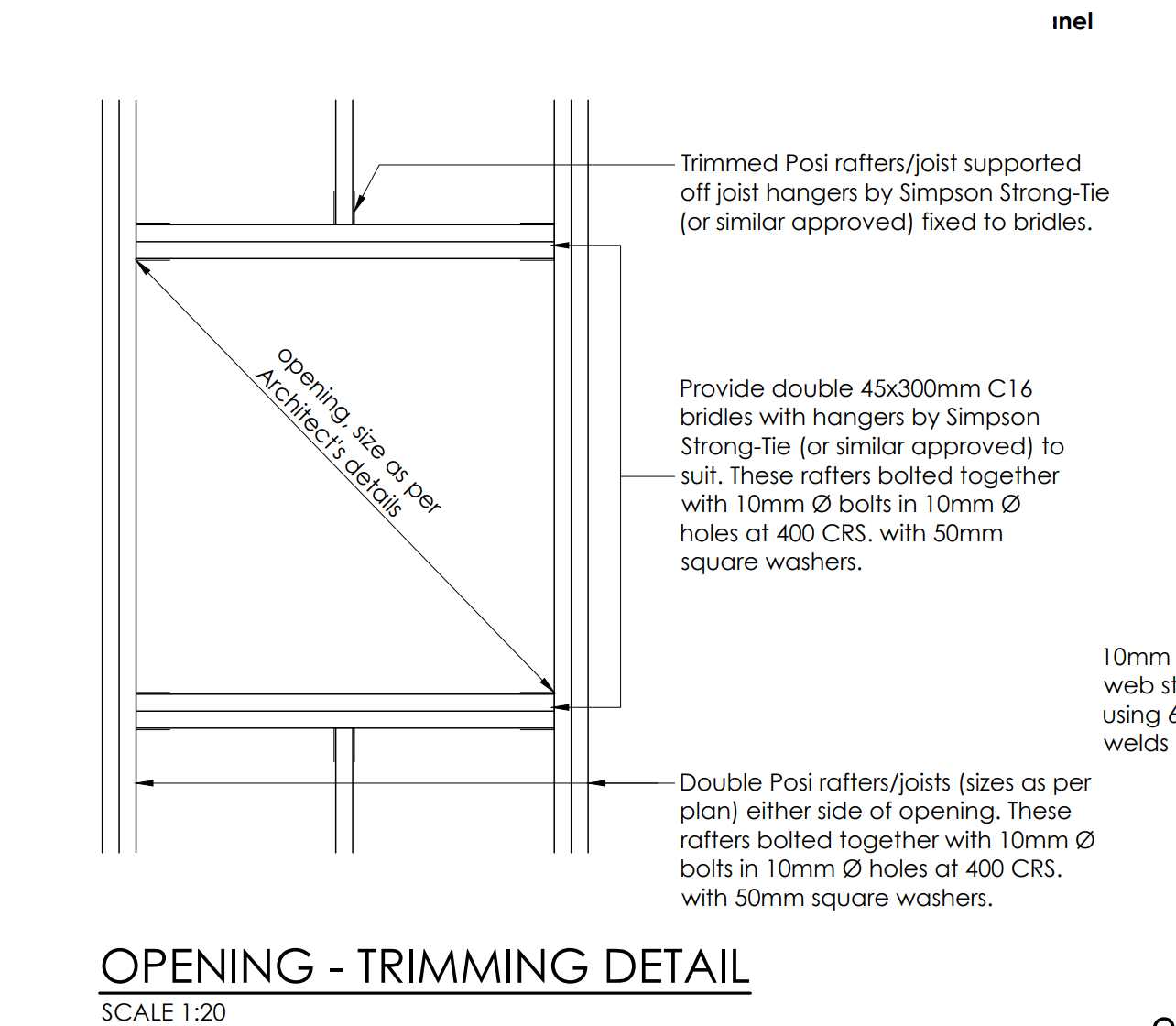

Is this flat roof structurally sound
Kelvin replied to Surfer-Rosa's topic in Surveyors & Architects
We have a similar rooflight arrangement. Our trimmers bolted together as defined in the structural engineering drawings albeit I had to add them after the fact as they were forgotten about. -
