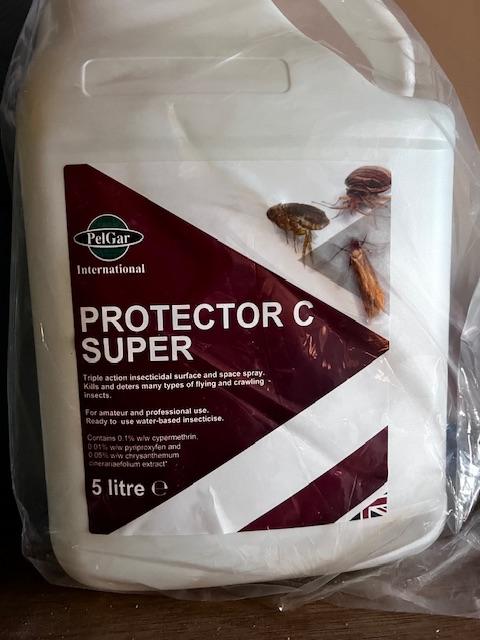

  4. In case anyone has a similar problem. I bought this stuff and wiped it around the inside of the frame and the underside of the cladding and it seems to have worked.

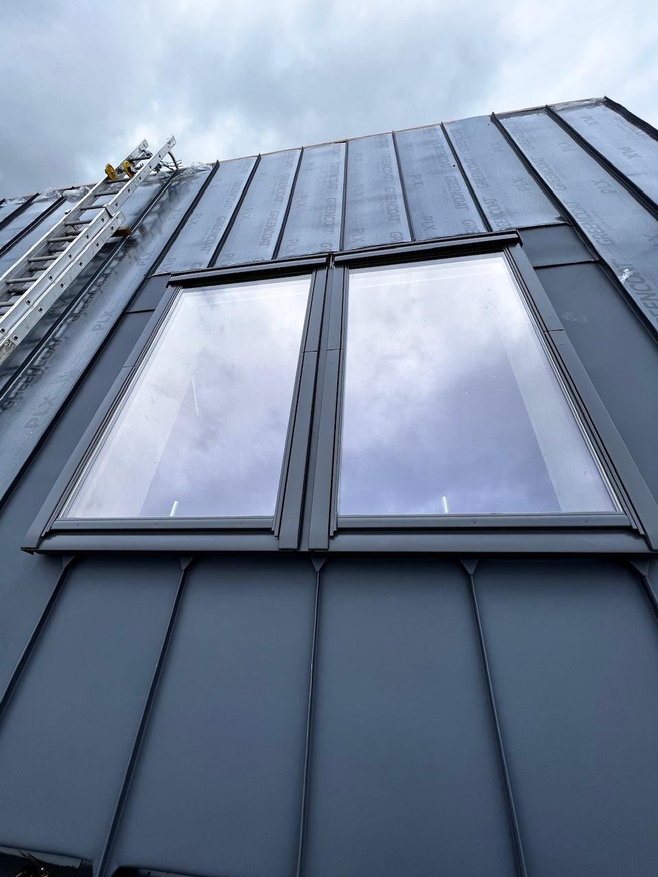

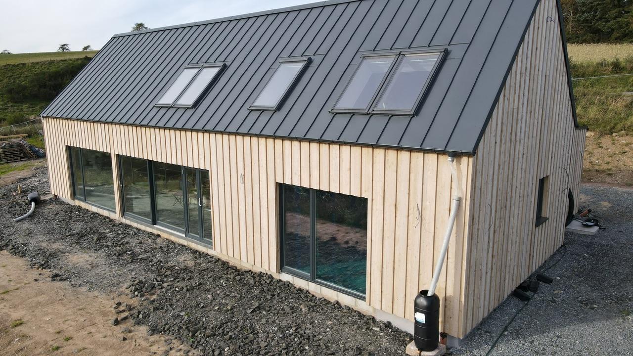

  11. Velux here. My understanding is they can’t fit flush and need a minimum upstand. If they were flush wouldn’t rain run down the roof and across the window? Ours are opening and fiited on a standing seam roof so it might be different for fixed rooflights on a different roof. Ours are fitted direct to the roof deck and the frame provides the upstand which is 90mm. There’s a flashing around it and another over this so the rain runs down and around the window.
