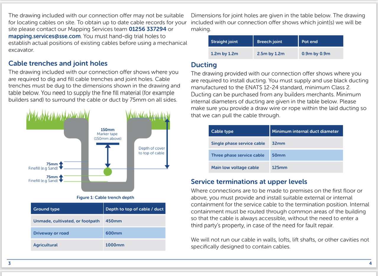

Reasonable price for quite a big box. Some of them are stupidly expensive. I tried to search for the UKPN guide and it returned a page not found error! If this is going under an agricultural field it needs to be 1000mm deep. Driveways are 600mm and cultivated ground 450mm -

Yeah don’t use drainage pipe. Didn’t you get a customer works guide from UKPN that specifies what you need to do? The guide I got from SSEN says this. Your cabinet is quite big so plenty of room to get the ducting in. You could use smooth wall flexible 50mm electrical ducting into the kiosk for UKPN and your connection to the house and a 38mm hockey stick for the earth requirement to save a bit of space. The hockey sticks are mostly used to bring the cables up into a meter box on the side of a house. -

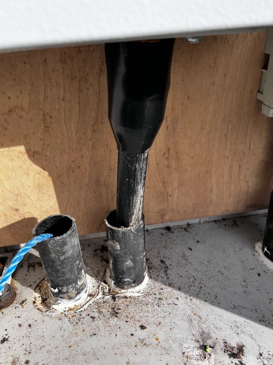

The cable from the kiosk to the house is 35mm2. I’ll take a picture and post it shortly. Have you been asked to provide your own earth? I generally add extra ducting just because it’s hard to add it afterwards. -

I used a 44mm hockey stick for 35mm2 SWA cable. It fitted but it was hard work. If it’s into a kiosk the guys won’t care if it’s a hockey stick or the smoothwall flexible electrical ducting. I put an extra hockey stick into my kiosk just in case I had a need to run something else into it. -
