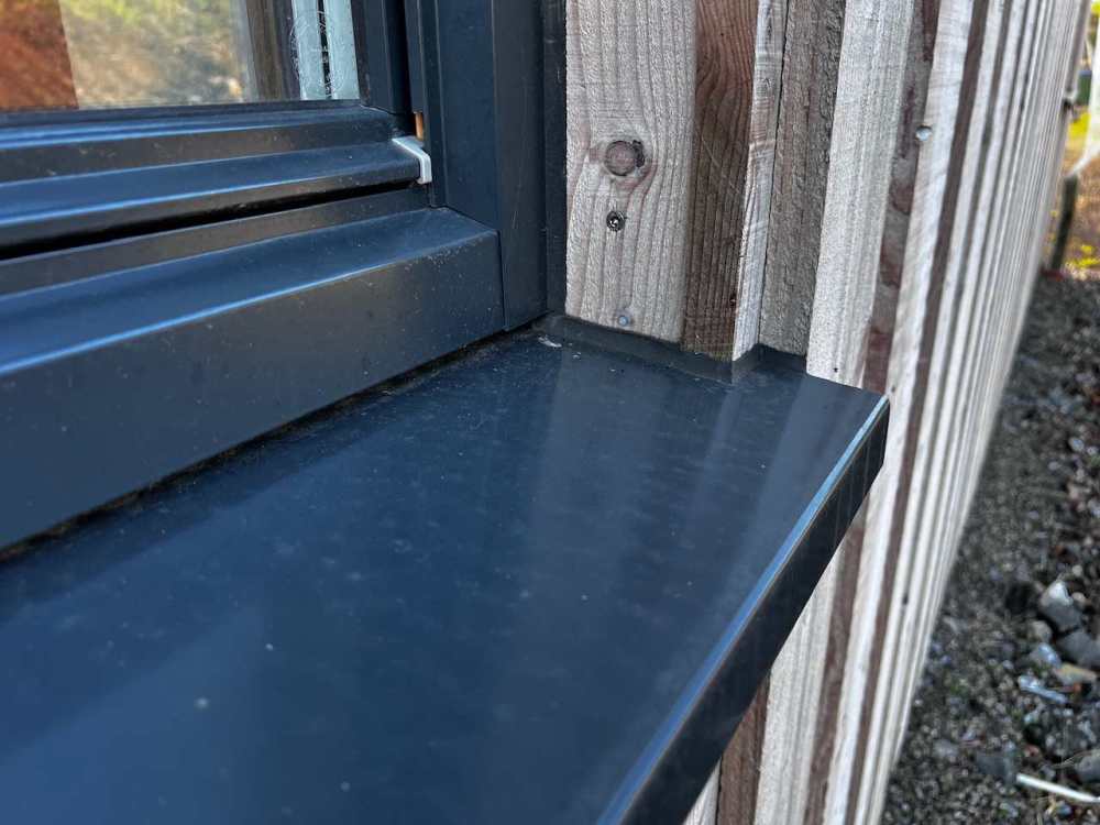

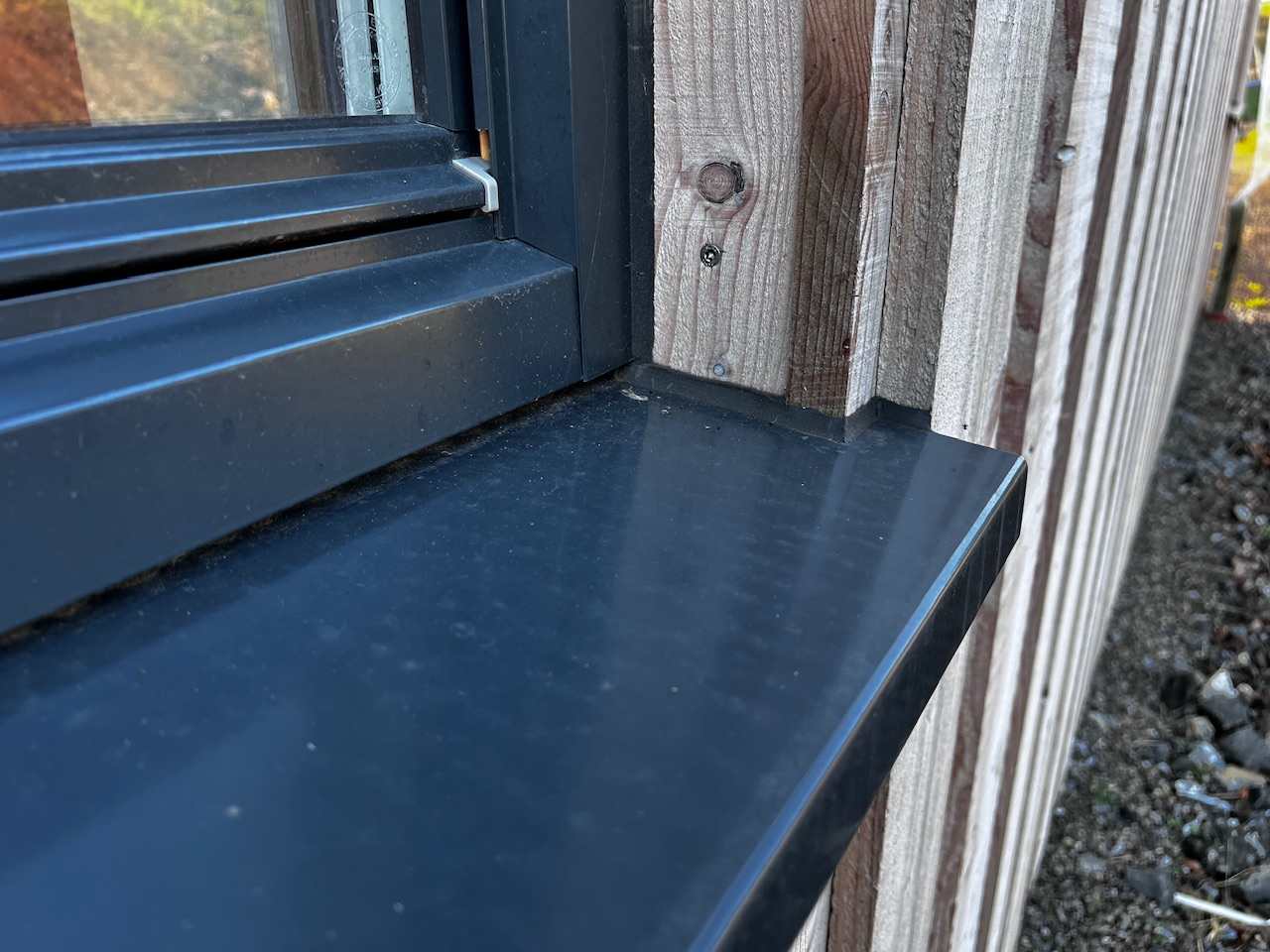

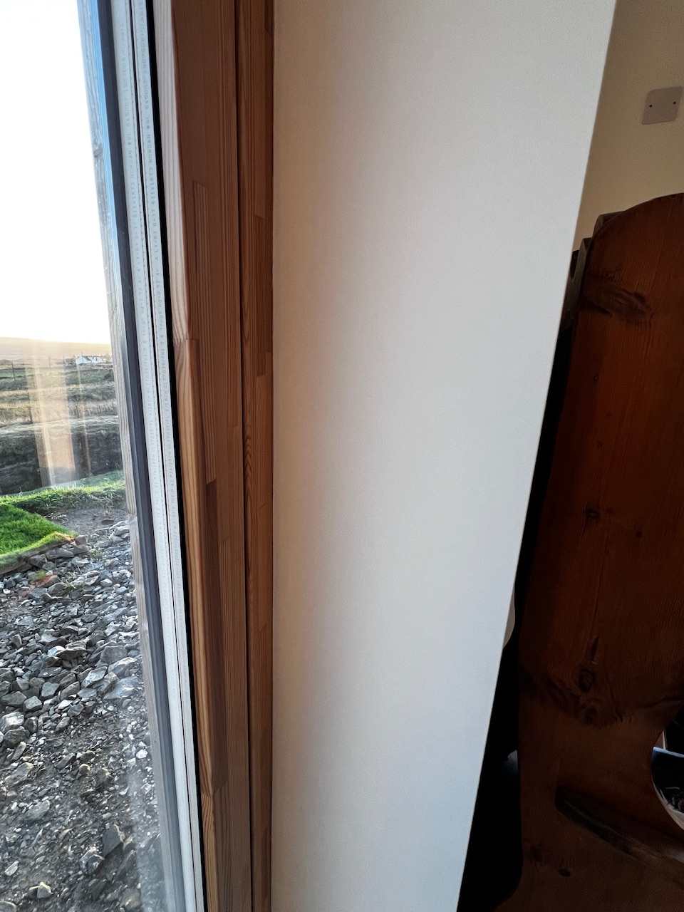

Frames are flush which made fitting the Nordan cill on the full length windows difficult as it has a crimped edge that needs some force to make fit. The custom made cills were easier to fit but less secure so I glued them in place. Because they are flush it does make sealing around them easier. I used Wigluv tape on the outside and Pro Clima on the inside. Our walls are a space frame system with a 302mm stud depth. From outside face to inside face it’s almost 500mm. Consequently, even with the windows flush, our internal reveal is 245mm. It means we get all the performance benefit of the windows being inside the thermal envelope of the building and the deep reveal look we wanted. -

The cill is 170mm deep to give us the recommended drip over the edge of the cladding. These are 3G windows so quite deep themselves. A standard timber kit SIP wall build and 3G windows fitted flush would give you a very shallow internal reveal. -

You’ll need to have cills made up. Nordan don’t do them deep enough. Caused us a huge amount of grief. All our windows are flush with the kit. The French doors and sliding door have a few mm overhang but our walls are pretty wide for a timber kit so we have a deep interior and exterior reveal. I can post some pictures if it’ll help. -
