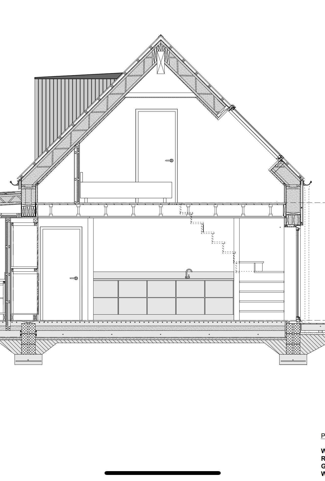

Yes, ours is 1.4m and I wouldn’t have wanted it much smaller. Due to the pitch of the roof the ceiling gains height quickly so it means you can stand at the head of the bed quite comfortably but I am only 5’9” which helps. The wall at the bed head isn’t structural so you’ll be able to adjust that once the frame is up and decided then how far to bring it out. It’s what we did. I marked out the king size bed dimensions on the floor and then made up a headboard out of cardboard to determine where to place that wall. -

This is the issue we had albeit our ridge height is slightly higher at 6.1m and roof pitch 45°. My concern was about being in bed and feeling the ceiling was really close to us. Here’s a drawing of what we did. -

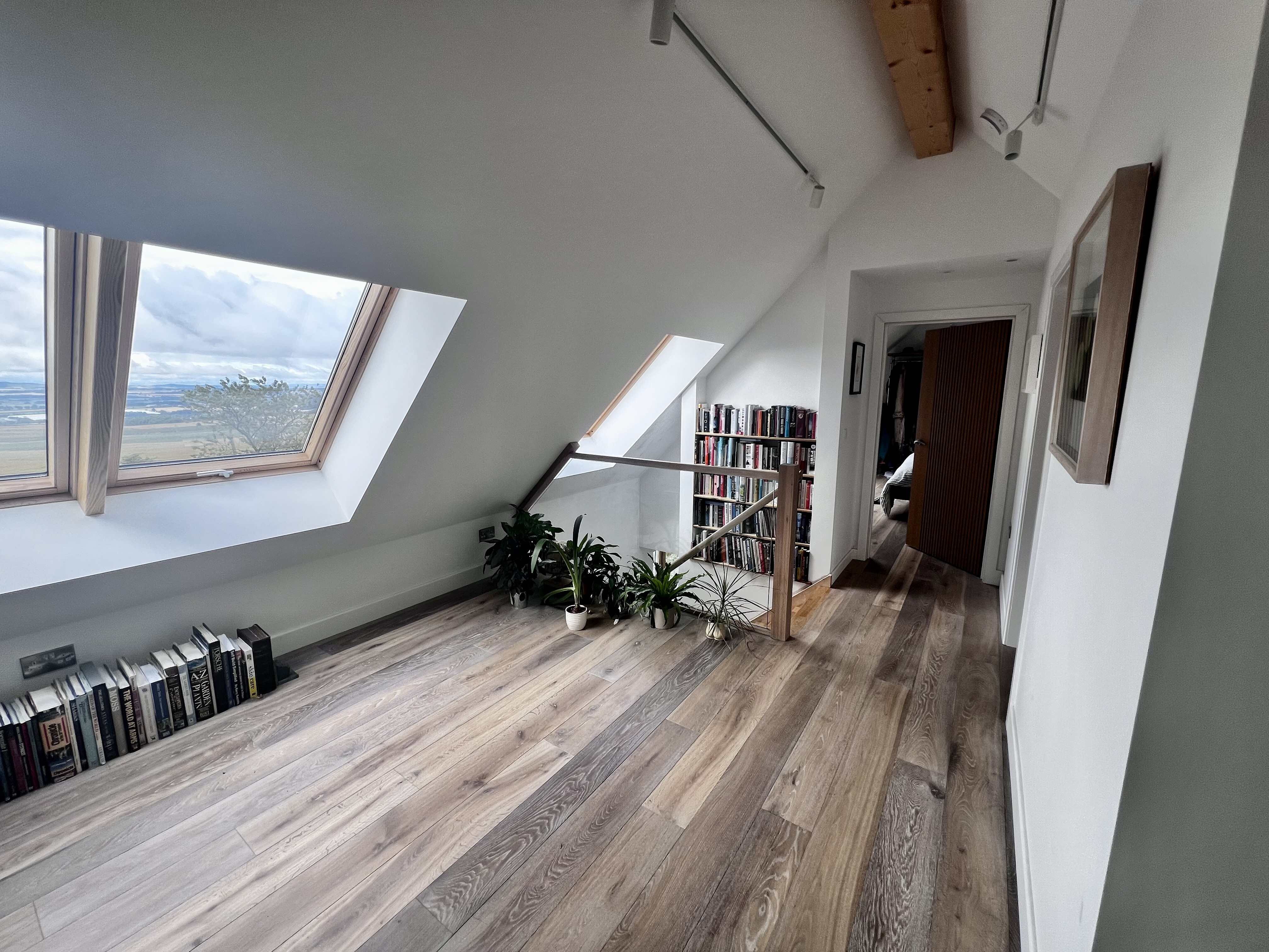

The plans had the wall on left coming out 750mm either side of the rooflight as this should have been separate bedroom. We changed it to open plan upstairs multi-purpose room and opened up the ceiling to the ridge beam. It’s 3.6m wide at this point. Had we left it as per the original plan it would have been a smallish slightly cramped feeling bedroom. Done like this it feels much bigger than it is. Similarly had we built the wall at the stairs making it a bedroom it would still have felt bigger. The other picture shows the curve in the plastering. We brought this wall out to 850mm rather than 750mm which made it higher pushing the ceiling up a bit. It also gives us handy accessible roof storage that runs the full length of the room. There’s a similar space in the other room. I put all the shower plumbing in these voids which makes them really easy to access. One for the upstairs bathroom and the other serves the downstairs bathroom. -

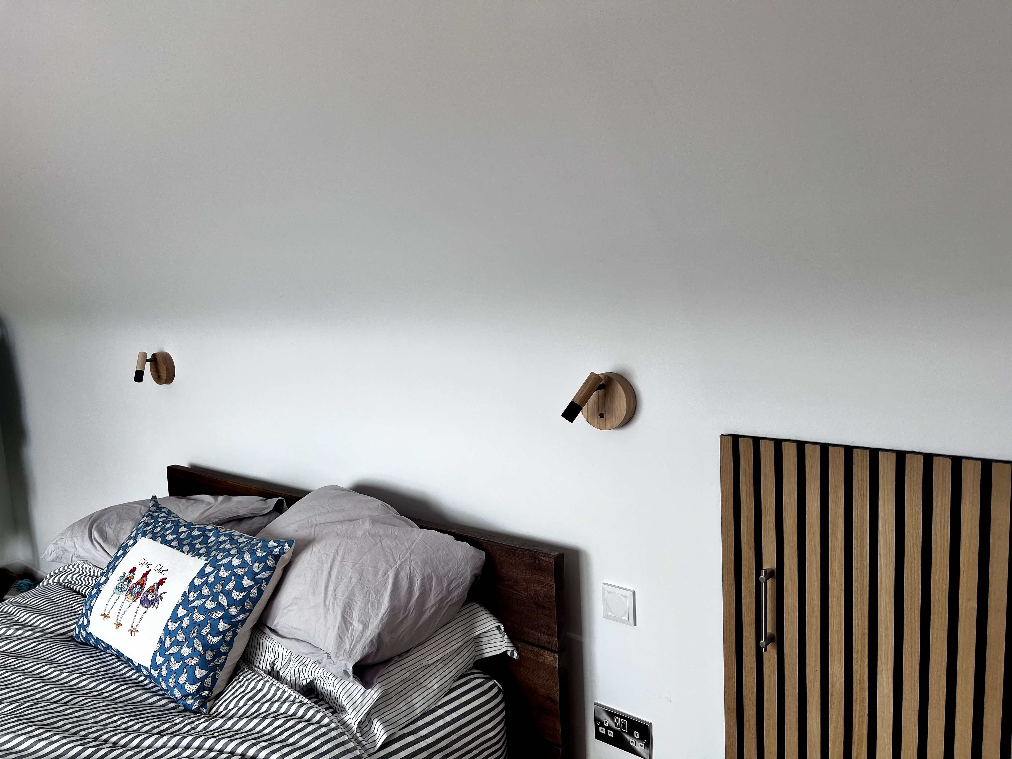

We went to see a lighting designer when we were planning everything. She had a holiday rental that she also used to show what could be achieved with lighting. She was a big advocate of up lighting shelves/alcoves and the like. She used a lot of small directional led lights that they use in museums and display cabinets. It was really effective. One of the most effective and cheap to do was a tiny LED built into a shelf (it was routed in) with a large glass paperweight sat on top of it to diffuse and scatter the light through it. She had these on the floor as well.
