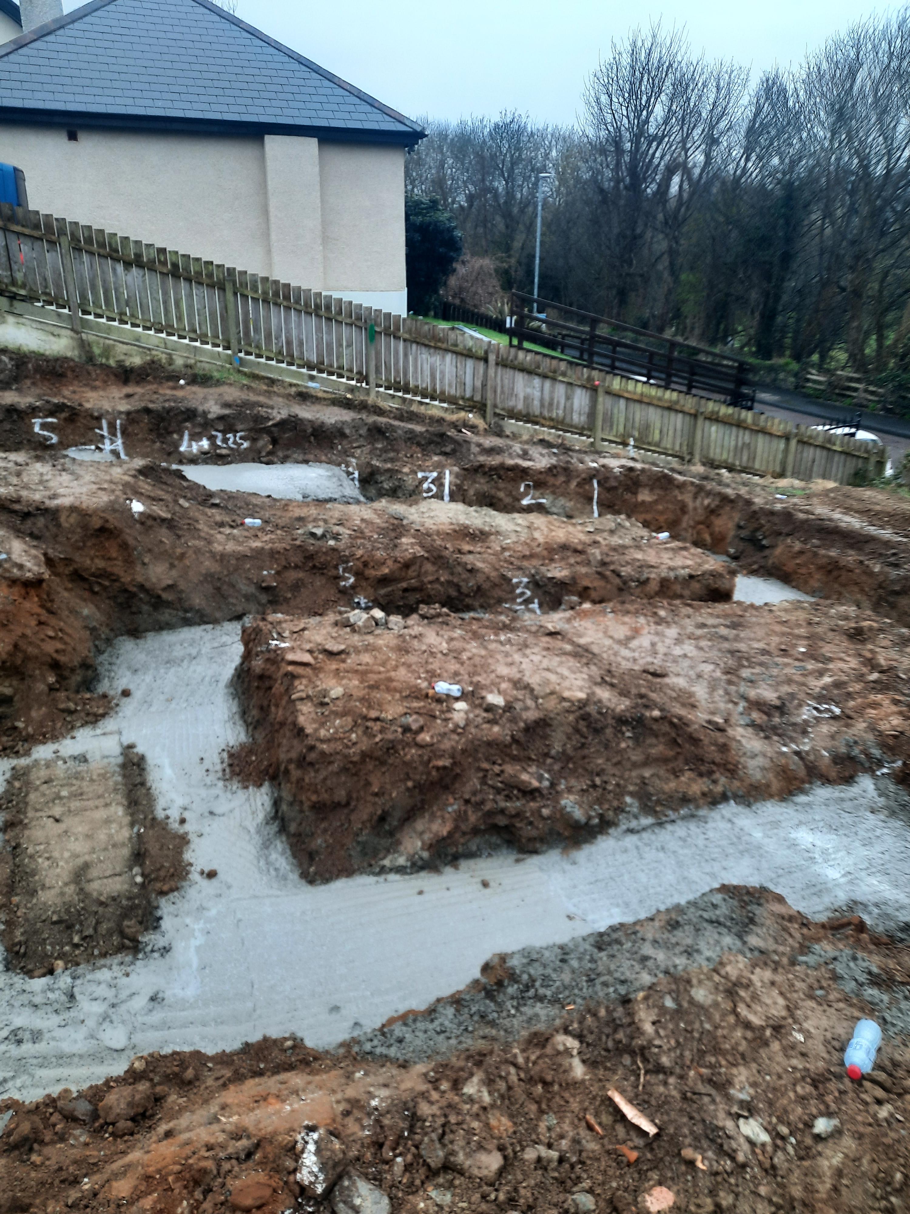

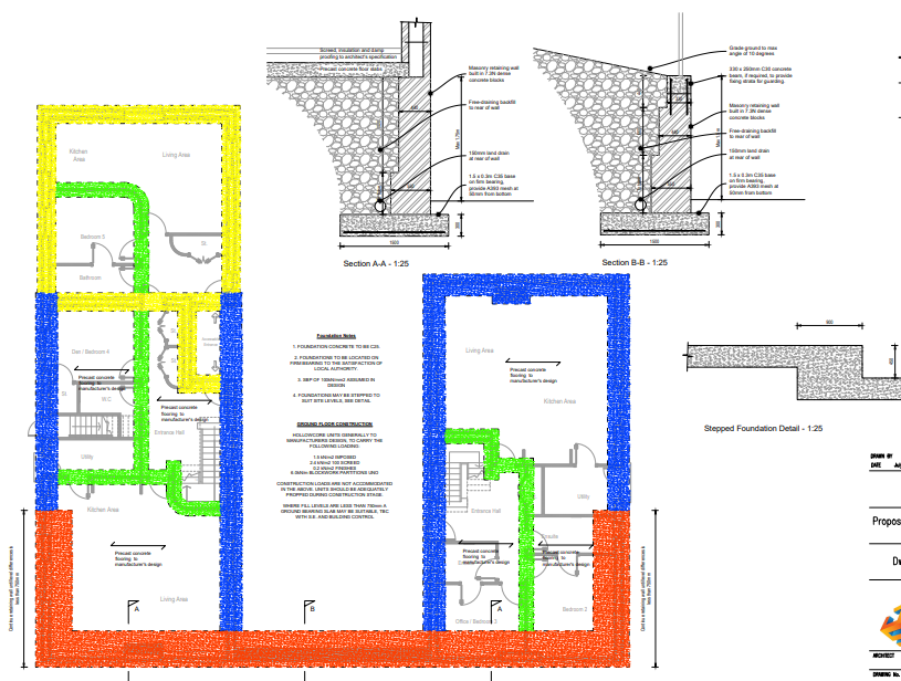

  8. Digger on site so guessing will restart soon. Stupid question from a greenie: how are bison slabs positioned? Site is sloping, I see we have a retaining wall to be put in the middle. Thank heavens we have a great groundsman.
  9. They determined shallow foundations will be ok, soil good. Because its a sloping site it turns out finished floor level will be 1.4 above ground at the front end. So we will need bison slabs for the front half. We have quite a lots of bricks from the demo to lose. Yes some are being used for the entrance , we will get some broken stone to put on top so it isn't a mud bath. Groundsman suggested we could put some under the front of the building. Question is. I am still concerned there could be the fungus from the dry rot in the brick (no wood)and it will work its way up over 10+ years. I would love to save money but is it too risky?

  11. I agree, I thought an 8 tonne would have done it but thats what the guy has and we have the rubble from the 2 cottages to move as well, going to put it in the corner (where the garage was planned - we are just doing the 2 houses, red on the plan is where the cottages were) till the end when it might be needed plus the surveyor will be out as well as the engineer . The surveyor wants levels as near as poss so was hoping it would be done quicker with the bigger digger. Hoping to goodness we get away with the shallow foundations. The goundsman thinks the ground looks good so cross fingers.
  12. Have to ensure engineer is present to tell digger driver where to do the test holes so he can provide a foundation layout. Architect thinks they will be shallow foundations but I guess it depends where the hard ground is.Hoping it's a quick turnaround because the digger can't sit for long (3 days max). Also surveyor has to show up too while he is there to mark it out including levels. The sloping site is definitely more of a challenge. Still, pleased it's happening and I have confidence in them.
