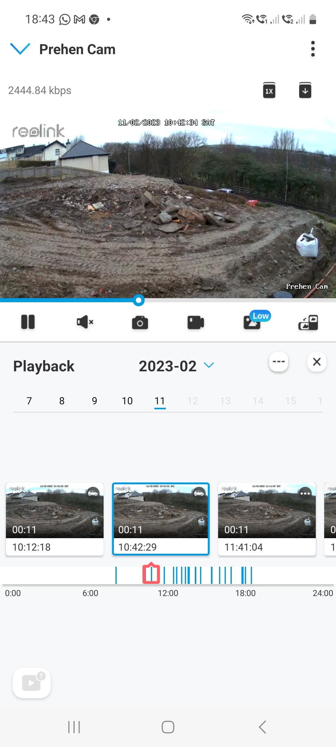

  5. Yes £2 a month it gives me 3gb which seems to be enough but I have 100 extra gb on the my sky app so I can put more in if needed. The busier the site the more data presumably will use and its only passing cars for the next 3 weeks.

  9. Rather pleased with this. I just put a cheap sky sim in (£2) and its great. I had to recharge during the very cold but now its running great.
