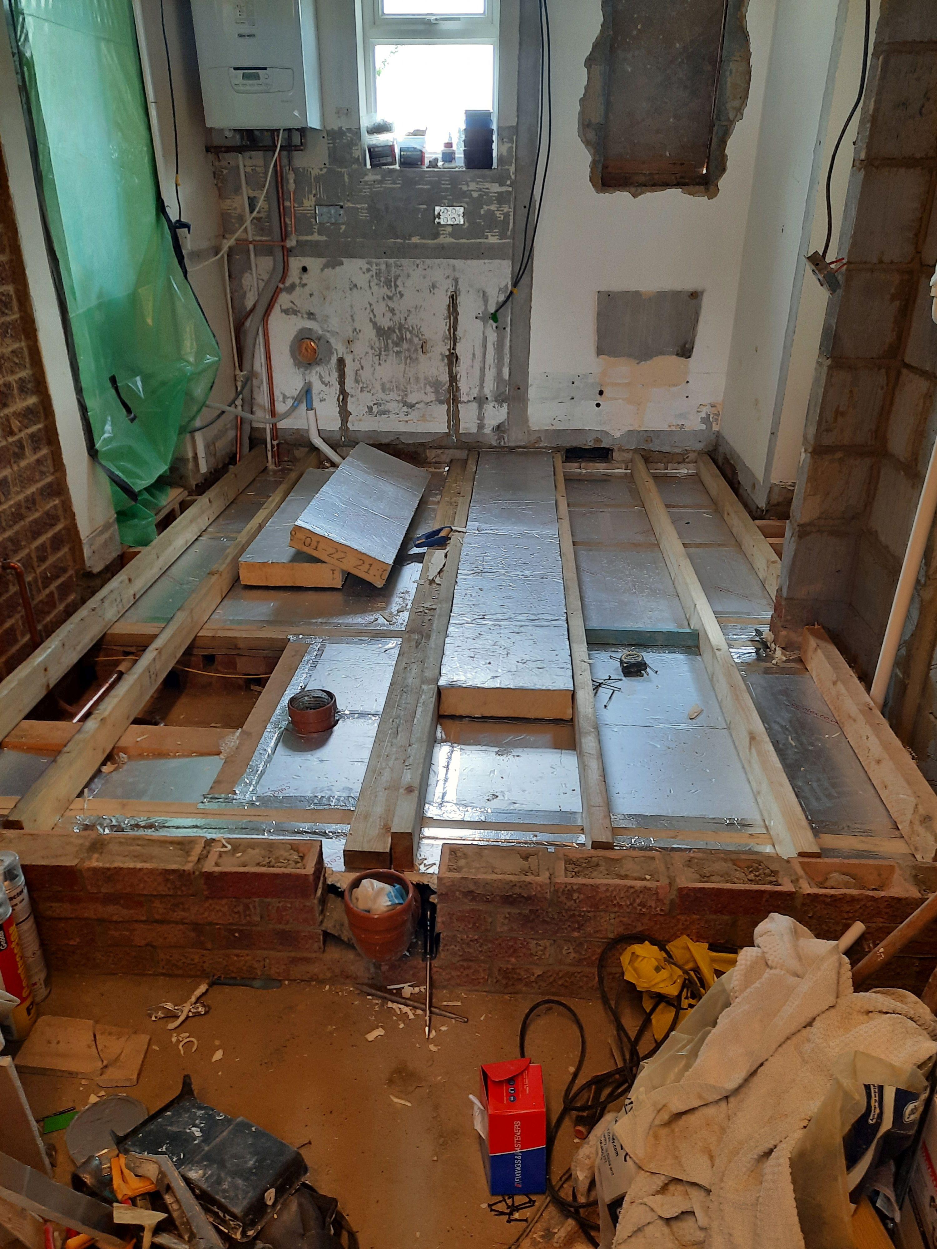

Hi @jpadie Basically I insulate suspended floors with 100mm PIR (Celotex or similar) under the floor joists and 100mm in between the joists with 22mm 22mm moisture resistant floor boarding above. If the joists are 47mm wide by 97mm high at 400 centres then you should achieve a U-value of about 0.115. To work the lower PIR has to cover the underside of the joists from supporting wall to supporting wall. Obviously to allow the boards under the joists you have to cut the boards to suitable sizes. The question is how do you fit the PIR under the joists. I use 25 by 50mm treated batten screwed up with stainless steel screws. However this assumes there is enough free air space under the floor after fitting 125mm of extra materials. In extreme cases I have fitted the PIR this way retrofitting by making hatches in the floor and working like a potholer. As cutting the boards can be a bit hit and miss. If I am putting new joists down then I run 25 by 50mm cut to 25 by 25 and screw it to the sill plates if a thin coat. This means the joints and the PIR between them will cross over the lower level. Fill any gaps between PIR and walls/joists with foam filler to stop cold air blowing around. Good luck M
