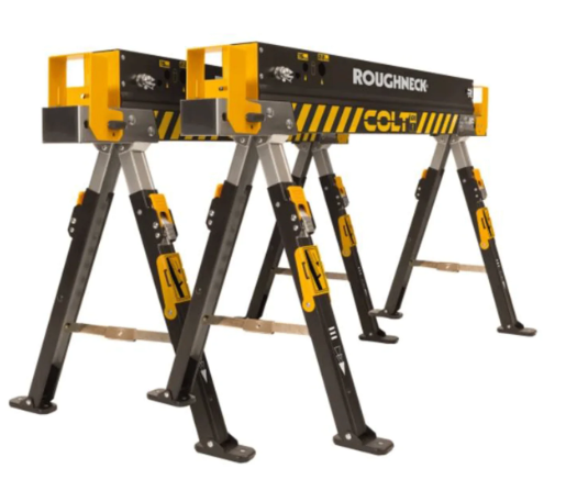

  15. This is what our chippies are using on site, with 2 bits of 4x2 on the brackets, and a sheet of osb. very sturdy. Roughneck sawhorse twinpack. £120 but I've seen them cheaper.
