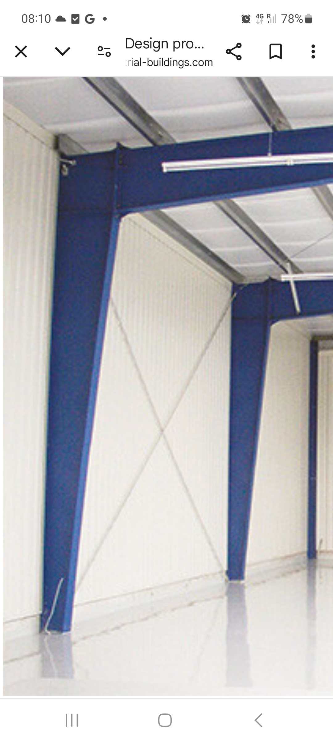

@scottishjohnA relevant degree and 50 years working with steel buidings wasted? Maybe I'm explaining badly. I was expanding on the query by @Iceverge so maybe it doesn't coincide with your post. May be the confusion here. Is the other confusing factor. It will buckle unless restrained.
They can be and are, for big structures. The standard ones are "hot rolled" through formers from a yellow hot balk of steel. But beams can be welded from flat plates which can be whatever thickness and width is required, in which case they don’t even have to be parallel. Your picture shows the possibility of increasing the web height from a hot rolled section. Castellated beams are cut to zigzag halves and moved relatively sideways and welded together. The weld is visible in your picture. The circle option is a prettier effect, with some offcut waste resulting. Very strong and allows services through. Also note plate girders on victorian bridges, made from flat steel plates riveted together.
Sorry, no. The web (the central vertical bit) is there to keep the flanges apart. Then it has to resist deflection but that is secondary. Increasing the distance the flanges are apart increases the lever for the flanges, and making them thicker gives strength....but it's a class for another time. There is permanent deflection from the load above the beam, and that doesn't concern you ( it bends and stays put, and the door gear can be fixed kevel). Dynamic deflection from the doors moving is your concern. (Loading and unloading). There is no such thing as zero deflection. Thus it may well be ok, but probably needs clarification.
