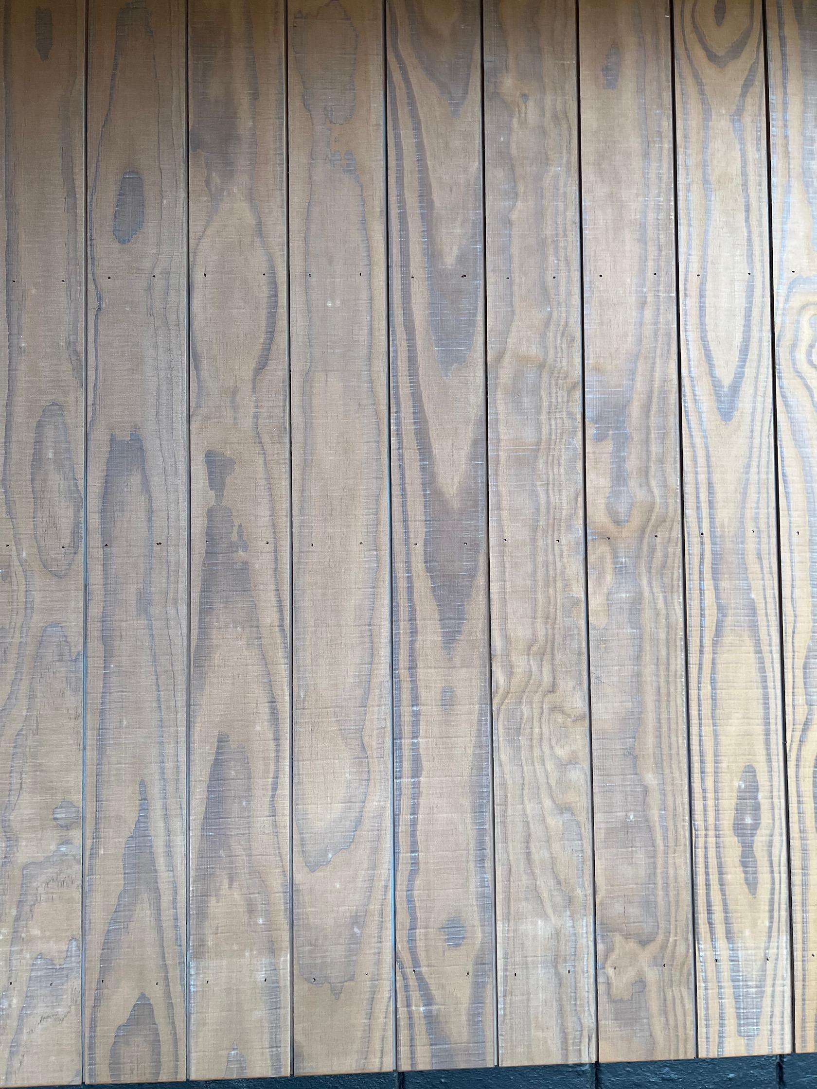

  10. Just for comparison we've just face-fixed our vertical Adobo (Radiata Pine) cladding with stainless steel nails and nail gun. There are six nail holes showing per board in this pic if you zoom in. A nice quick way to fix - and it has a fine sawn face rather than planed so nailing fine plus sits recessed under deep soffit so quite sheltered.

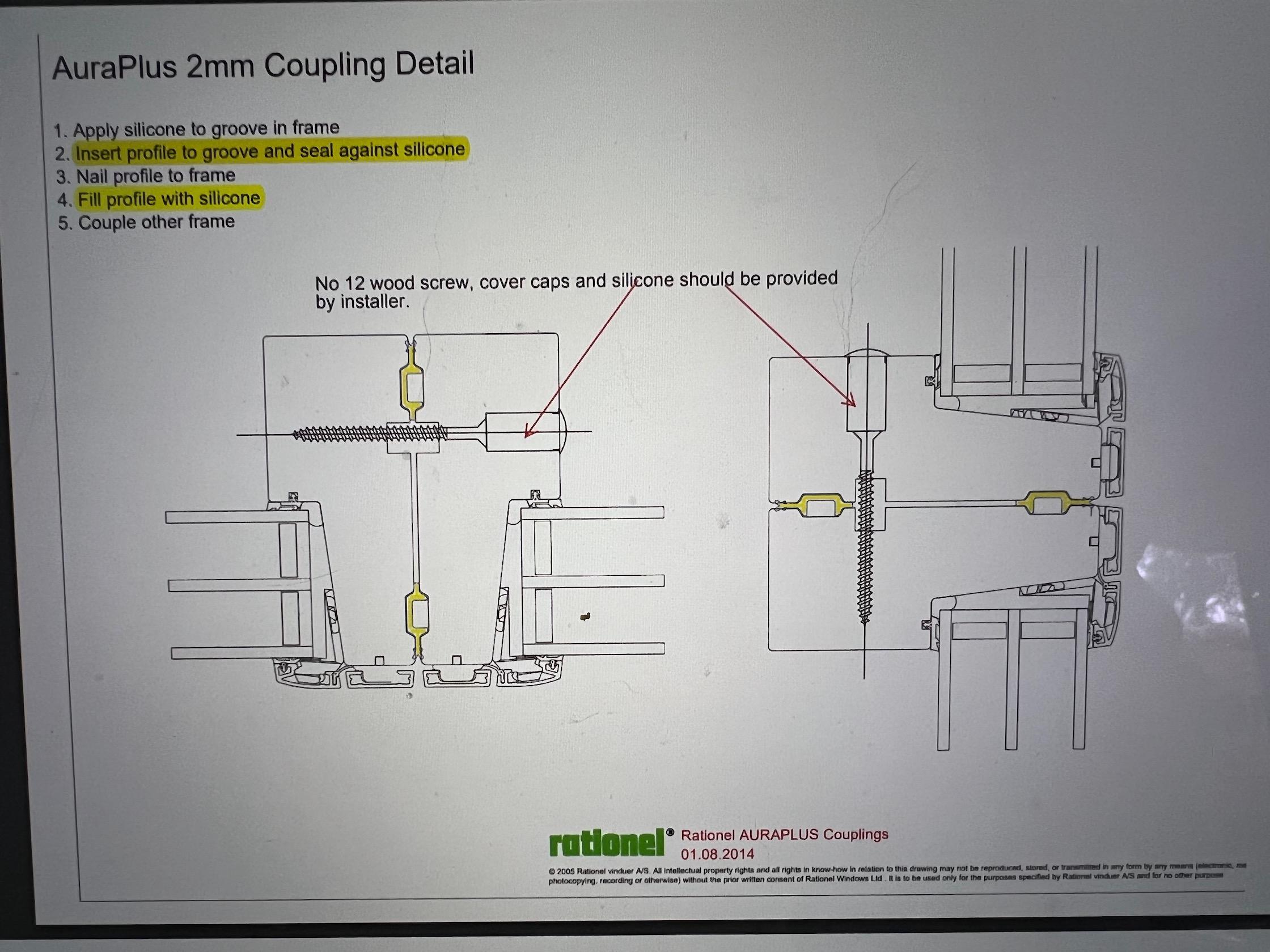

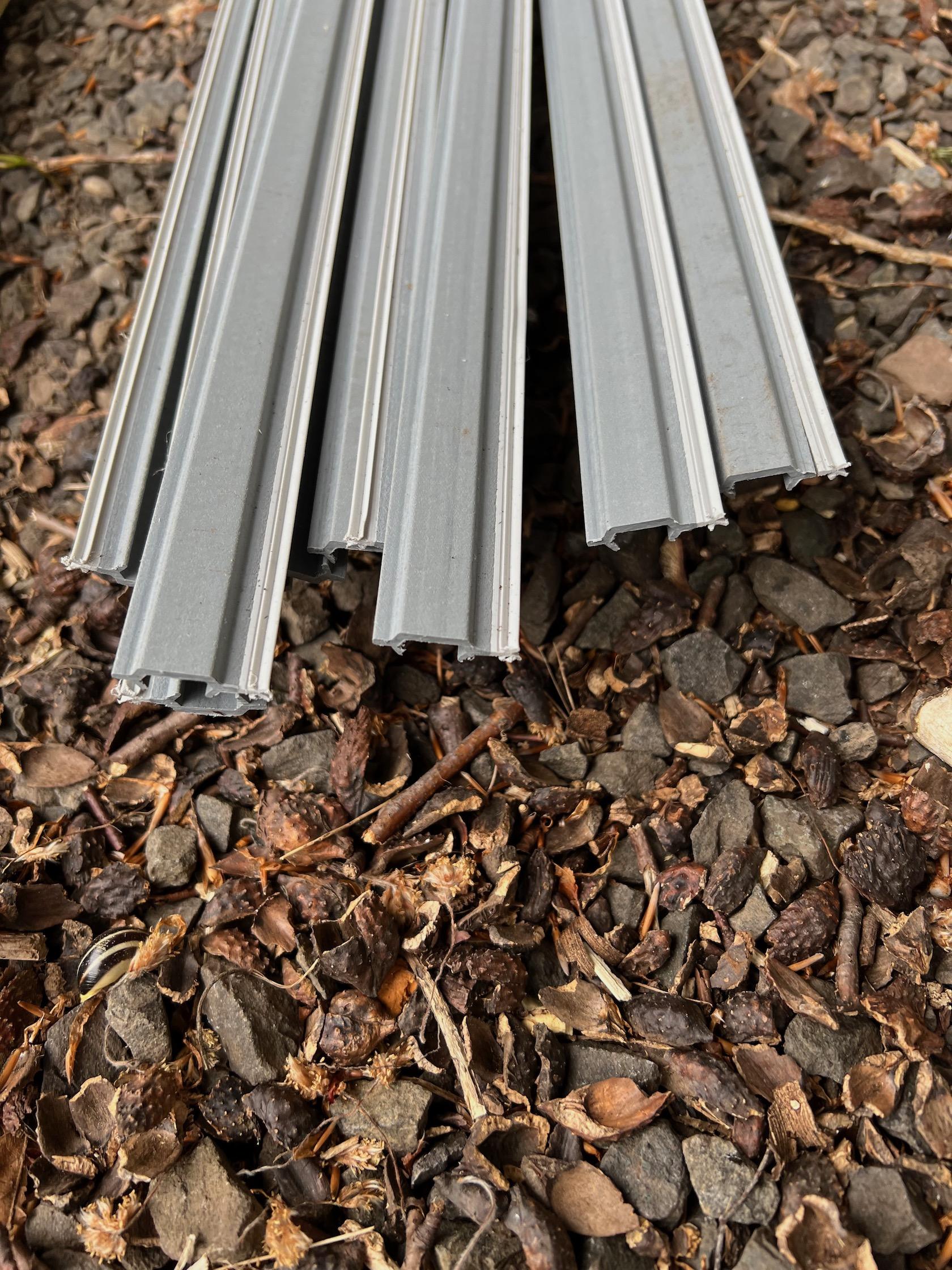

  13. I wonder if it may be different for door frame sections (we used the casement 'windows' as doors to have slender sections so they were effectively big windows but just to say as an aside that Rationel will make them 2.4 high without a transome so very good from that perspective). The standard detail still includes the caps and screws as others have noted but obviously this can be hidden in a rebate where you have opening lights. But the joining strips give a very neat airtight joint without anything showing.
  14. We've been using the Rationel jointing strips and the joiners have coupled as per Rationel instructions and all fine.

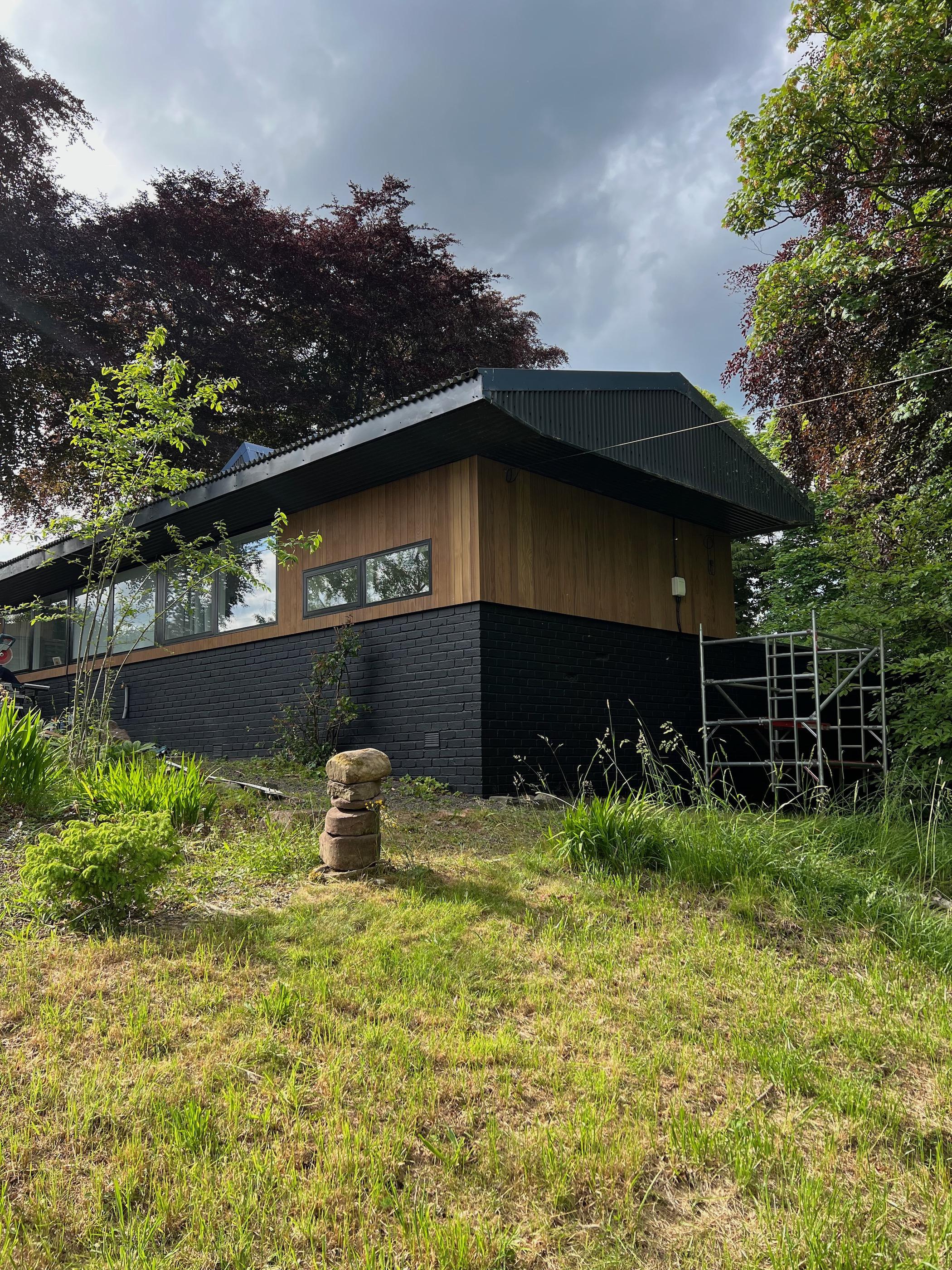

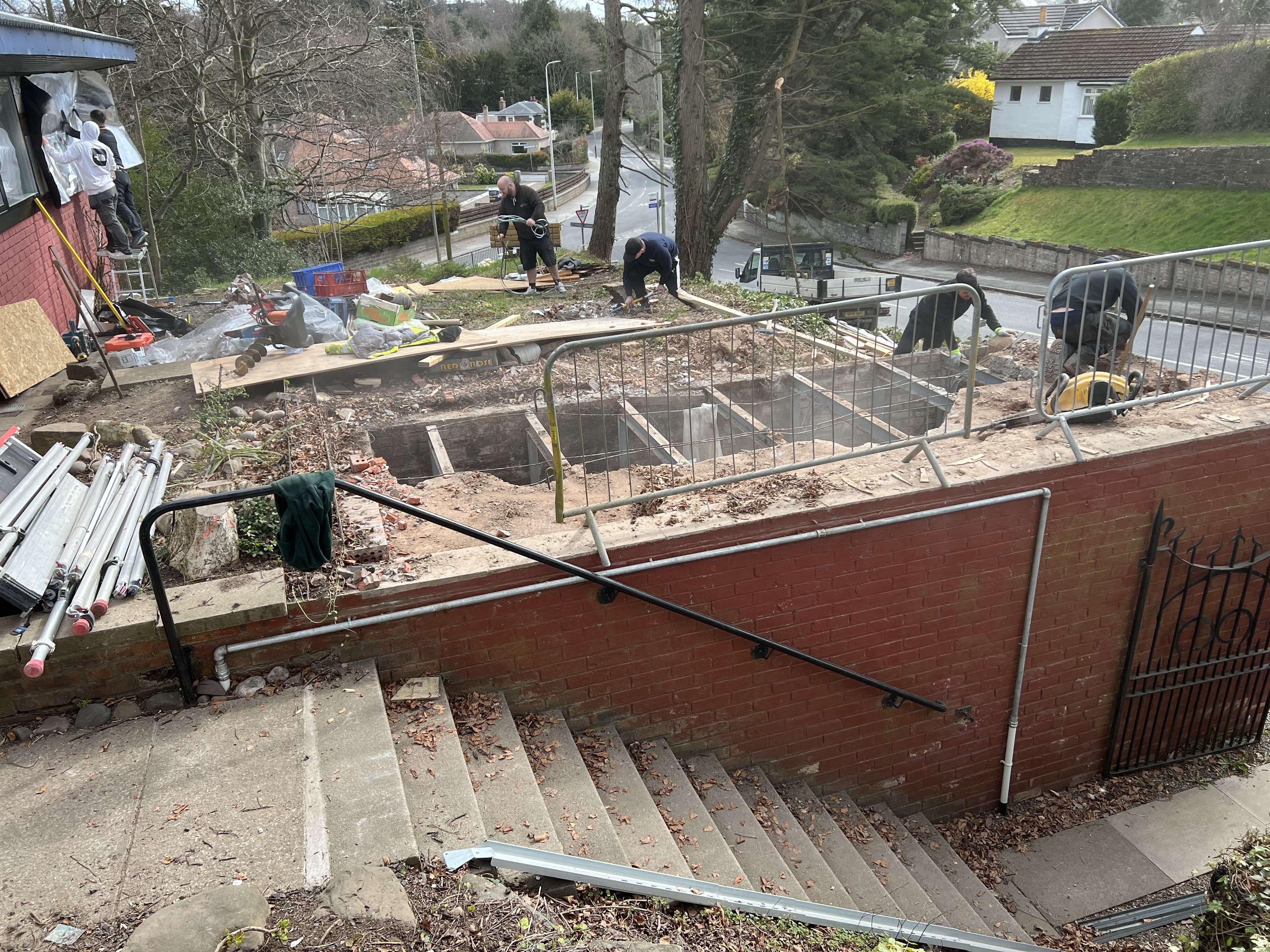

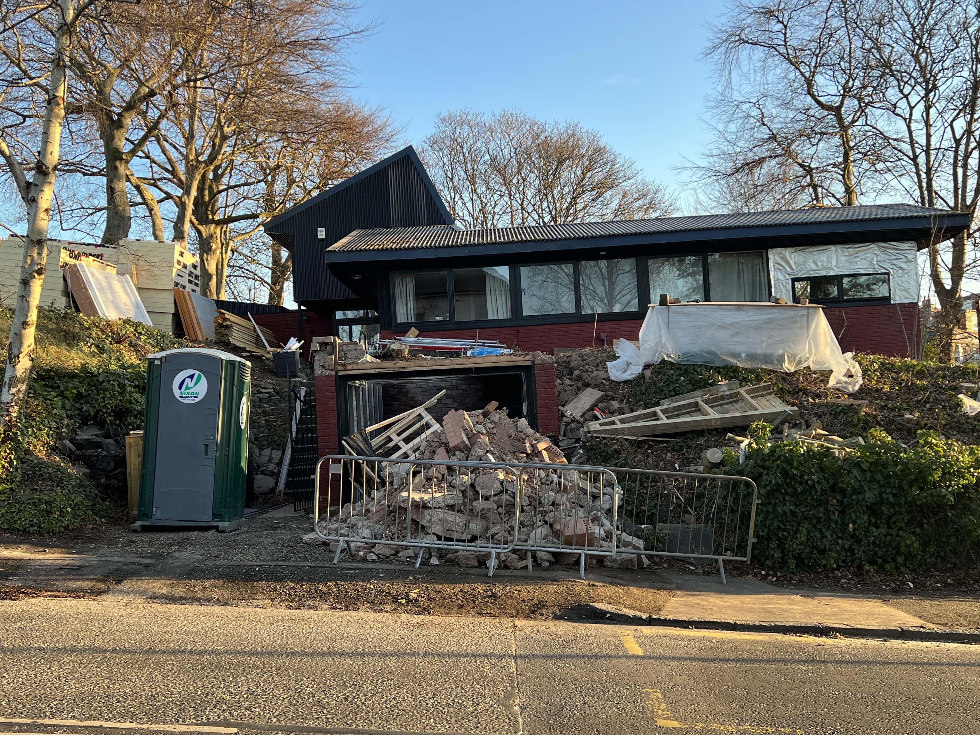

  19. After going round in circles on wood cladding choices and getting very close to ordering Siberian Larch we've just settled on heat-treated radiata pine (Abodo). It's from NZ so can't beat home grown on wood-miles -and may be on the dark side colour-wise for some tastes but we've been worried about wetting and splashing in our house-with-no-gutters. We're having it stained a straw colour and it's to contrast with black-painted brickwork, so fingers crossed. Will post a pic when it's up.

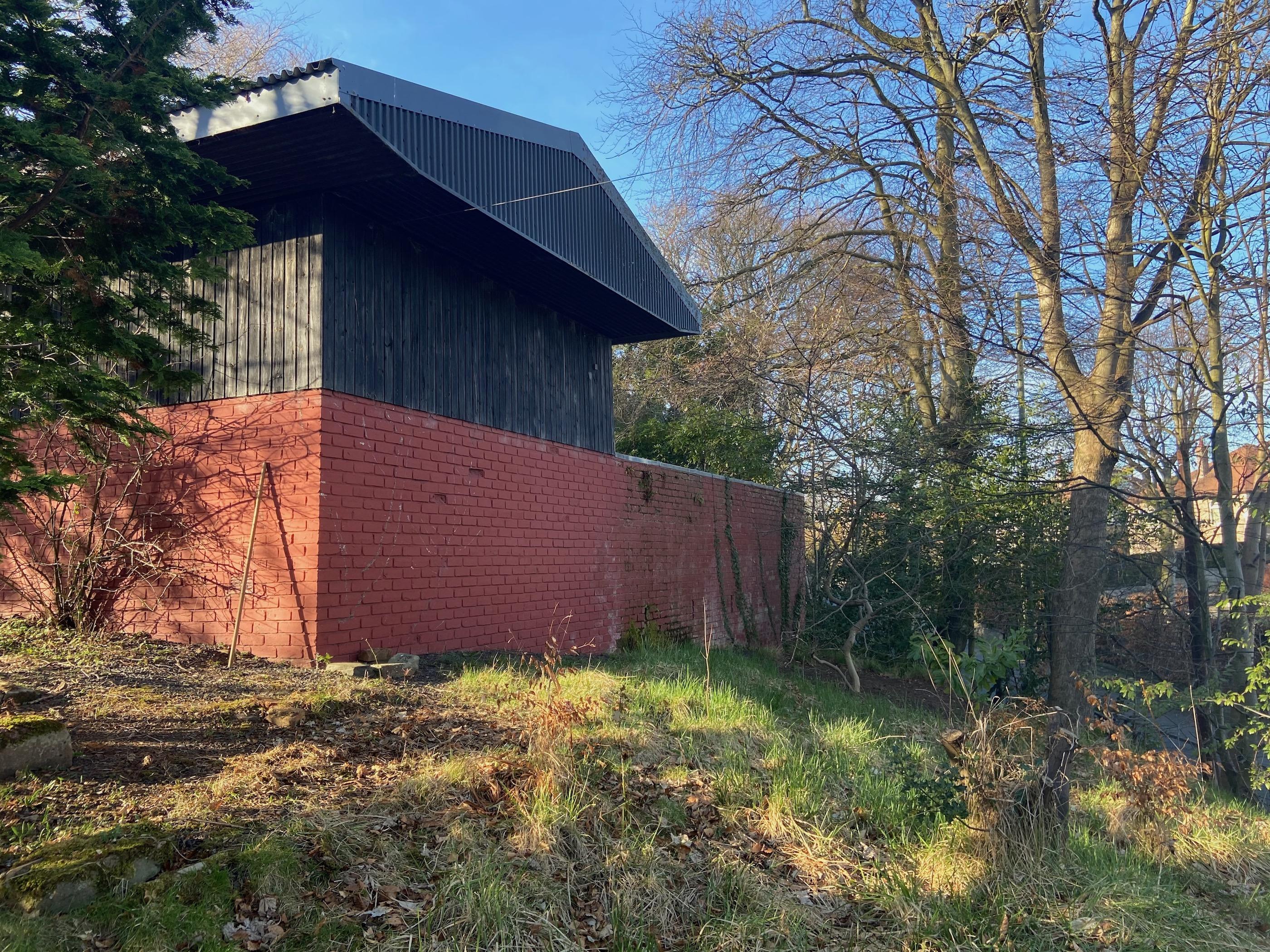

  20. Thanks - yes I was thinking of doing that on the engineering front. Interestingly, the previous owner clearly had a living roof idea in the 70s as there was a 200mm layer of earth on top of the concrete (with no membrane under!!) and I think that must have contributed to the demise of the concrete over many years, even though he later covered it (earth and all) with a pitched roof and added the steels under with ply panels to catch the fist sized concrete chunks that started to fall from the underside of the roof! As it is just a garage we think we will DIY the sedum roof on a pro-built roof deck and membrane. Looks like an amazing project that you have! Presumably OSB is ok as the decking if you have a sealed membrane on top? I was thinking we'd have to use plywood of at least class 2. Are the drains to your living roof integral?
  21. Thanks for the interest - here's a couple of pics. The steel you can see inside the garage will be going (it had been put there for safety by a previous owner because of instability of the concrete roof). In terms of using as part of a garden probably not, we don't need extra garden and would have to guard it too - so we will stick with standard sedum species mix for vegetation.
  22. We've just demolished the (unsafe) reinforced concrete roof on a 60s garage which is recessed into a bank (so the roof is easily accessible from the adjacent garden). Approx size 3m x 6.5m. We plan to replace with a lightweight, pebble-edged sedum room on a fairly standard timber roof (44x170 C16/ 400cc, 18mm EN636:2 ply deck and EPDM base membrane). Be interested on any hints / tips / trusted supplier suggestions (we are in Scotland). Also any experience of creating a drainage fall across the width - do we need more of a slope than a standard flat roof? Any suggestions for best way to have water run-off points at the pebble edges? The previous roof had been covered over with a pitched roof to slow the concrete decay and that discharged straight to the ground without any problems so we can do that again - or we can add a gutter if necessary - or even an integral drain point as there is a garage floor gully and we will only be using the garage for electric bike storage and charging, not a car.

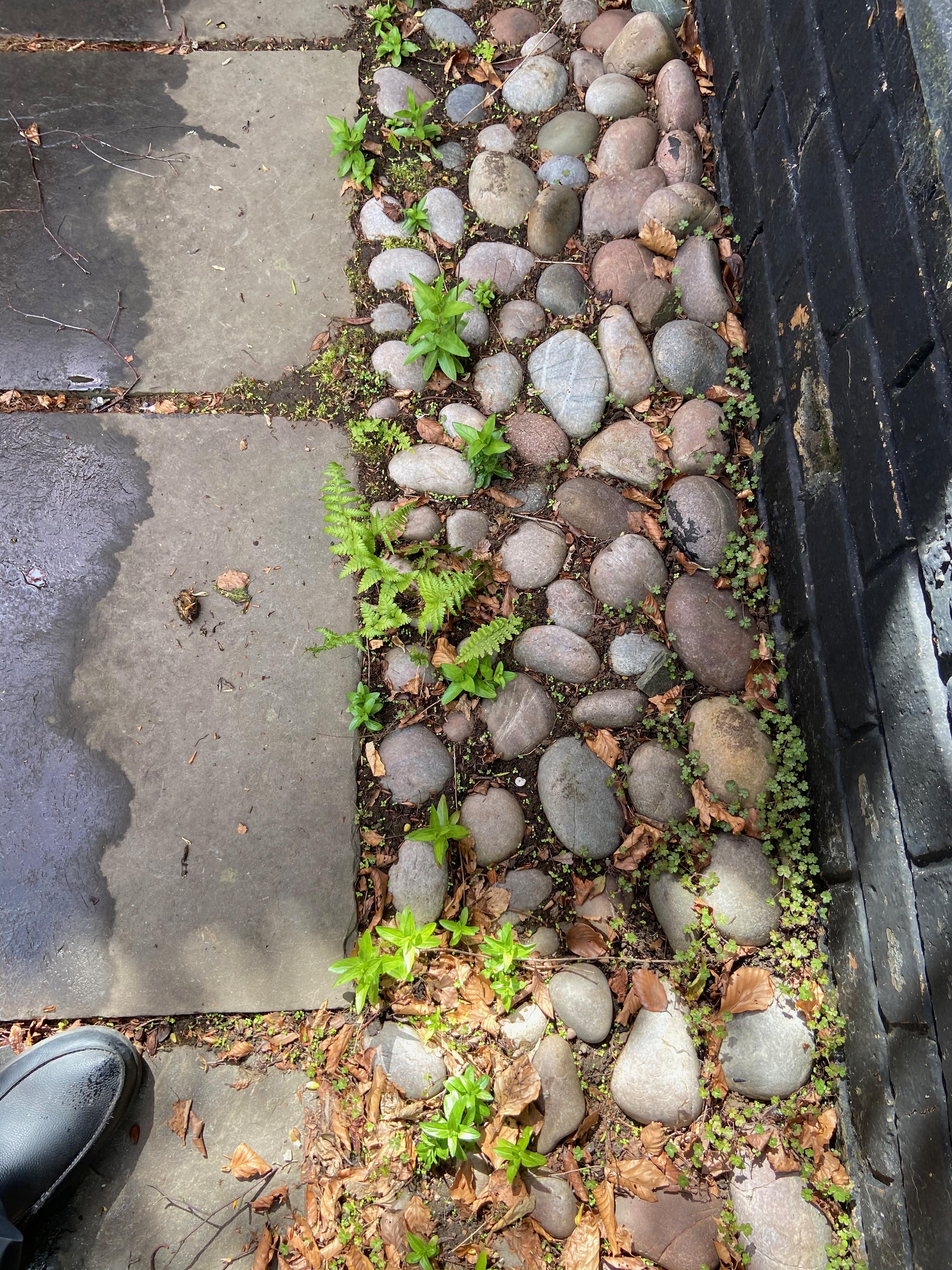

  24. Just by way of a postscript here is a pic of the possible french drain. I can't dig it out to inspect the layers underneath until I own the place next month but it does look like the stones aren't set in any mortar or grout - so it looks as if you are right about the decades of muck - thank you! The alignment isn't directly under the roof run off (see the wet line in the pic) but presumably that reduces the chance of any gravel infill etc being eroded by falling water. Looks like a maintenance job required - but I'll also need to find out where it goes as the foul drains are choked with tree roots and any drain runs from these french drains to any soakaway will be no different probably..... These are only present where there is paving. Elsewhere the run off is direct to ground (although again it may be that any original french drains are just covered with layers of general leaf and soil debris.)
