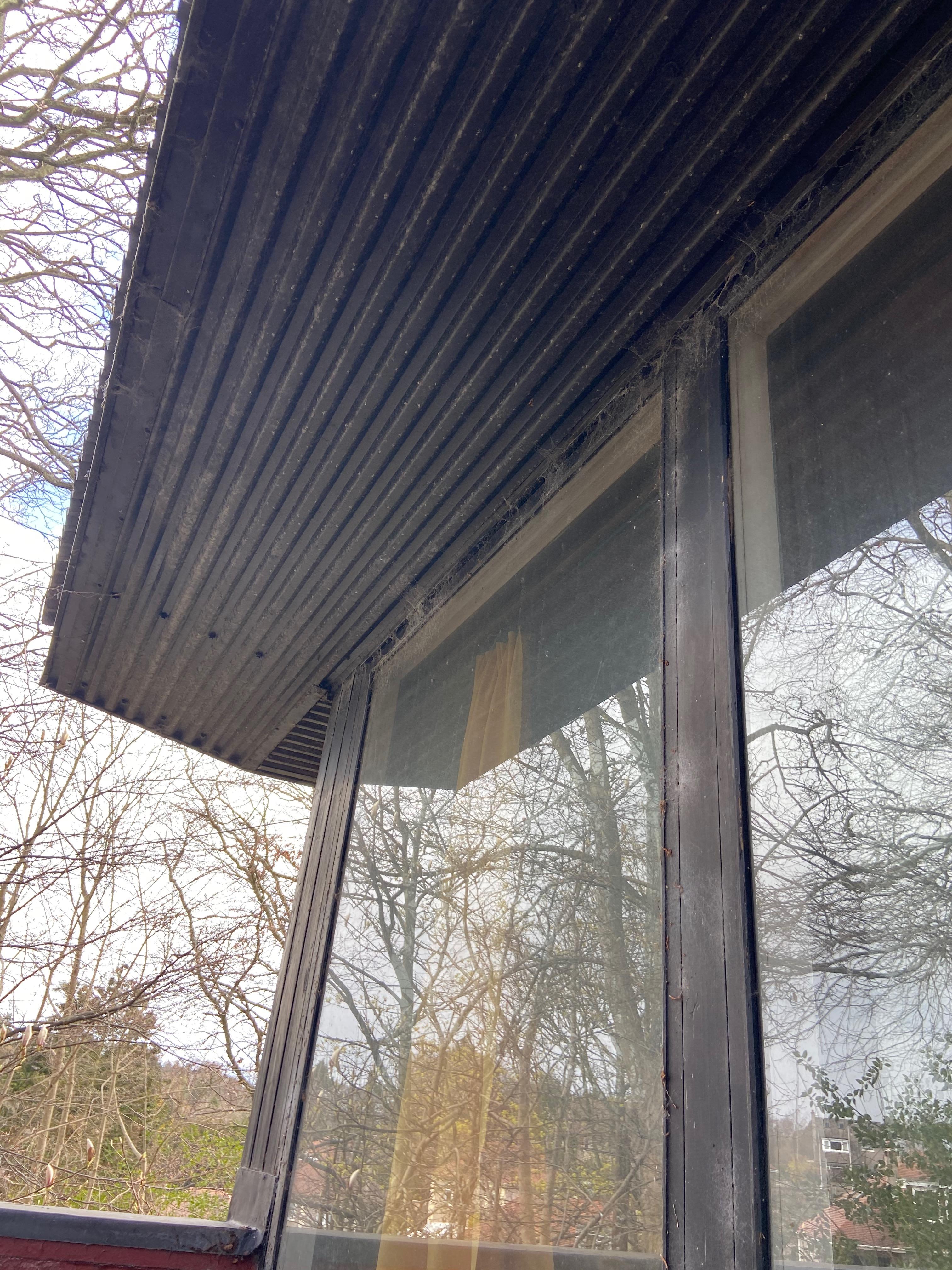

  3. This is probably a silly additional question but it seems to fit in the context of the discussion. The existing house we are about to refurbish has no gutters. So rainwater runs straight off onto the ground as a 'design feature'. The eaves projection is around 600mm (see pic) so the waterfall that ensues is discharged away from the walls and there is an additional projecting shelter above the external doorways to avoid getting soaked as you come and go in the rain. I've been wondering seeing various posts here if we can anticipate the LA (Scotland) not being happy with that and if as soon as we submit plans we'll have to manage rainwater according to current regs. That would be costly and challenging, but not impossible and I'd rather avoid it if I can. In heavy rain the water discharged doesn't seem to pond anywhere - it runs away into the surrounding garden, which is heavily wooded. So I guess my question is if you don't collect rainwater from roofs at all, might we be required to and then deal with it via a new soakaway etc?
