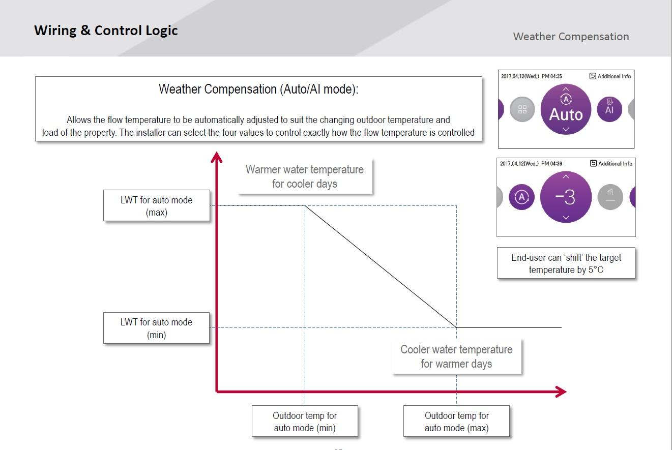

I also have an LG Therma V and I had the same problem the first time I used the AI mode. However I tried AI again a few months later and the problem has not happened again since. Either it's a (lack of) learning thing by the LG controller and/or the room thermostat. Or you have the temperatures for auto mode set incorrectly. With the parameters you are using if the outside temperature is +3 C then the maximum leaving water temperature will be 45 C. Perhaps that's not enough? If it happens again I suggest you switch from AI mode to direct temperature control and set the Leaving Water Temperature to 50 C. If that does not work then there is really something wrong. -

I have only just found this thread but see here: for how the Auto/AI mode works. In my case (all radiators) the settings (as recommended to the installer) are: Outdoor Temp for Auto Mode: Min 5 Max 19 LWT for Auto Mode: Min 34 Max 50 So if the outdoor temperature is 5 C or less then the Auto mode does not operate and the leaving water temperature target will be 50 C. By the way, my system has two pumps, one inside the Therma V and another for the central heating inside the airing cupboard. The latter is not at its maximum output speed. I had to tell my central heating controller that my heat pump was a oil boiler in order to prevent it from short-cycling. -

Your minimum outdoor temperature is much lower than mine. As a consequence your Leaving Water Temperature will almost never (if ever) reach 46 C; only when the outside temperature is -7 C or less. With your settings' the LWT will be 43 C when it is 0 C outside, 40 C when it is +7 C outside and 37 C when it is 14 C outside. Then add-in whatever number your AI is set to. -
