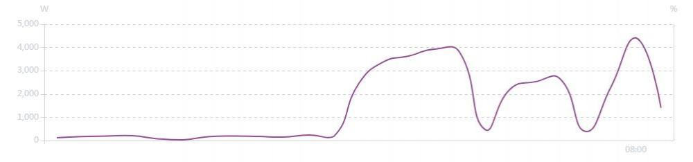

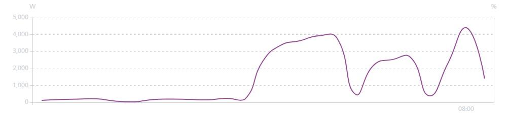

So are we saying that when the radiators are cold they won't give out as much heat so the delta T between flow and return will be less? The heat pump cares about this so modulates its power down to control delta T whereas an oil boiler would go at full power until the return water gets too hot? These are the first three power cycles my ASHP goes through, starting when it comes on at 7 am and showing the first hour until 8 am. Thereafter most cycles are like the last one in shape. The power consumption certainly rises to a peak and then goes down. -

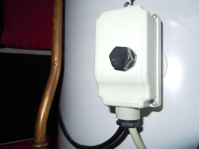

ReedRichards replied to ProDave's topic in Air Source Heat Pumps (ASHP)
So it's a Building Regulations requirement to guard against the unlikely eventuality that the Heat Pump managed to heat the water in the cylinder to 75 C (or whatever temperature causes the trip)? Edit: It looks like a Reliance – Single High Limit Cut-off Thermostat With Pocket (82°C) -
LG Therma V mono block Air Source Heat Pump
Inside this little box is a temperature sensor which trips out if the water in the cylinder gets too hot. The consequence of the trip is that the valve which directs water around the heating coil in the tank does not activate so you cannot reheat your DHW. Under the black cover is a button which you can press to reset; you also need to restart the system, it seems. I can see that you do not want to overheat the water in your cylinder but surely it is a physical impossibility for the heat pump to do this so I am struggling to understand what useful purpose this trip serves.
