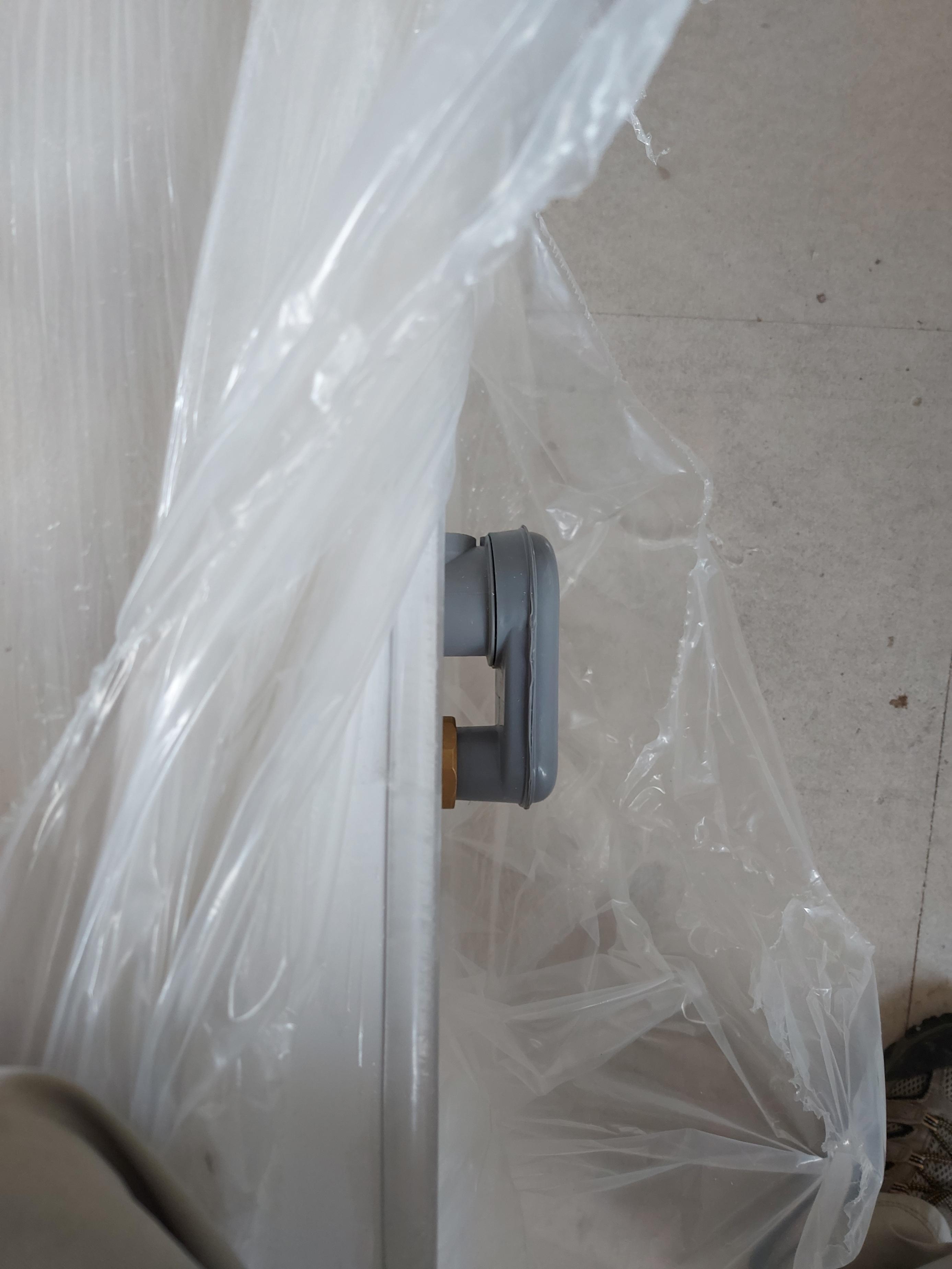

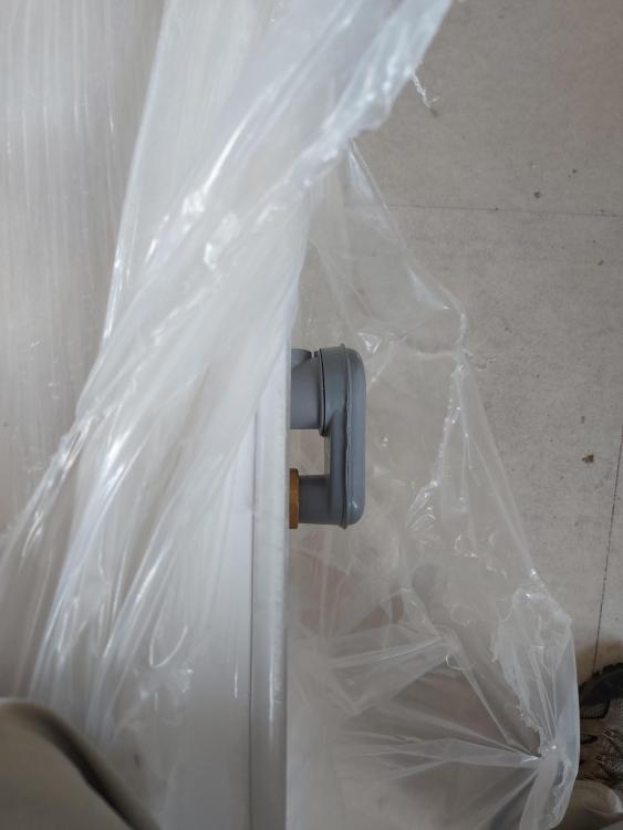

Yes it needs to be under the bath- it has a clever system to stop the bath overflowing - there are no other overflows cut into the bath. Sounded great at the time as the bath looks great freestanding with nothing attached to it or holes other than the drain. -

Just spoken to the manufacturers and there are no alternatives but to raise the bath up off the floor - daft design. We got that bath at such a good price there is no chance of exchanging for one which will work without costing a £1000 or more. So we will raise it up on wood and cover with the flooring material that we have. -

Happy Valley replied to Happy Valley's topic in Bathrooms, Ensuites & Wetrooms
It shows how far out the trap is from the bottom of the bath - bath is on it's side in the pic -

This is the waste kit - not your usual: https://www.ukbathrooms.com/products/victoria-and-albert-intelli-waste-kit.html -

Unfortunately our bath drain is positioned directly over one of a double posi joist. It has some fancy combined overflow and waste trap which means that we need to raise the bath up by about 50 to 70mm. Floor is granite coloured LVT and the bath is white. Suggestions from the plumber/builder so far are for wood to raise it up but purely around the base and clad in LVT or a thick piece of stone/granite (which I think will be too expensive). We want to hide the raised section as much as possible. Any other suggestions please.
