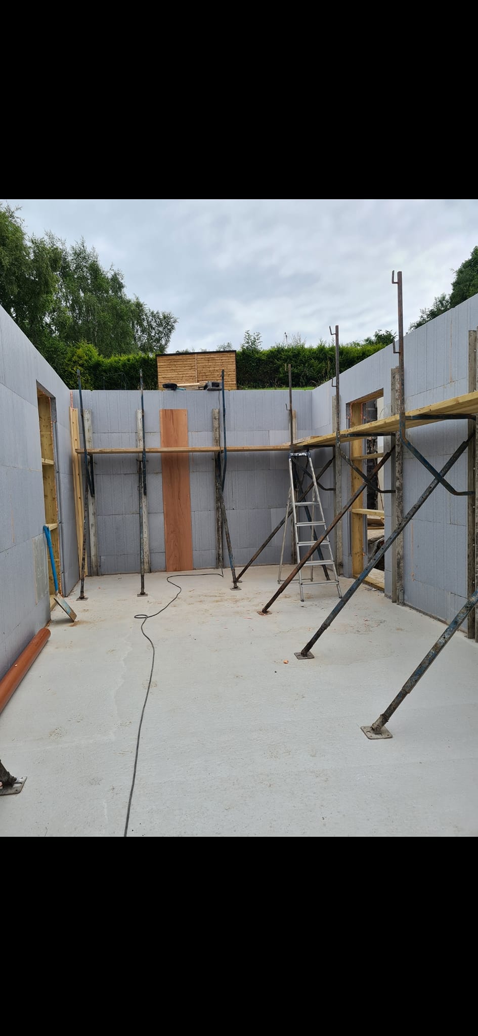

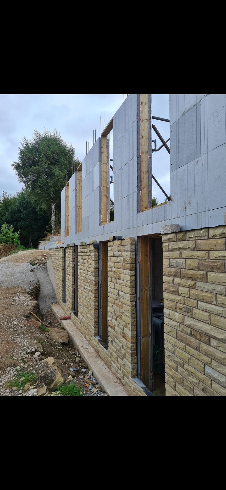

Wood infill 6 x 2 from memory and braced on the 150mm core. Pics attached - last one was taken 10 days ago as now living in the property -

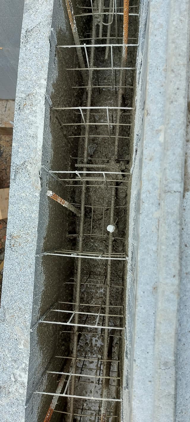

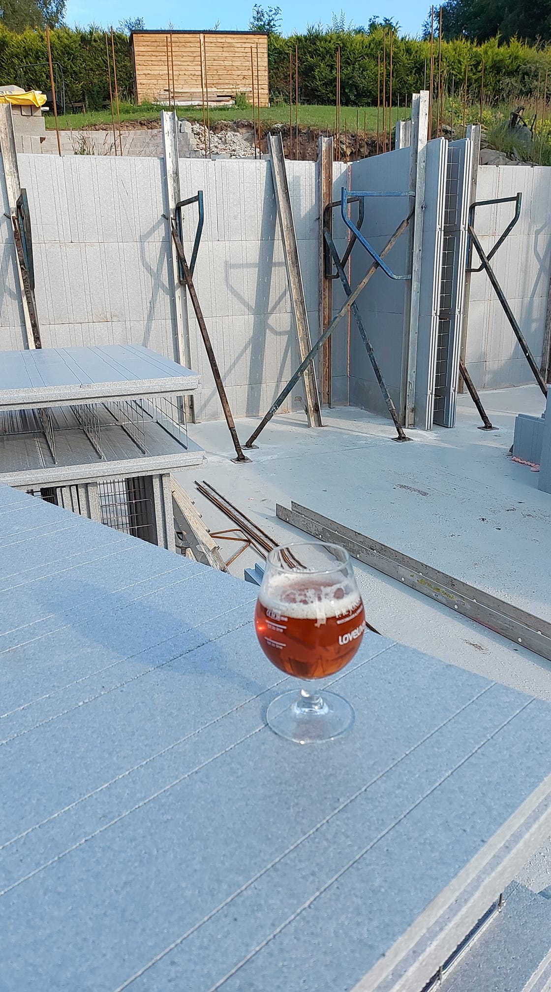

We built with Polysteels Warmerwall ICF on the recommendation of our architect who has designed a number over the years. No issues or bursts during pours. The SE though clearly didn't understand it as specified rebar both vertically and horizontally throughout whereas I believe you can build up to 4 floors without it. The steel web also has a strip of steel which line up when the blocks are put together. These are great for self tapping the upright supports and then the brick ties (if used) or you could just directly tap cladding onto it. One thing I would try and work to is to build your design around the size of the blocks so reduces the amount of cutting required. Here are some pics. -

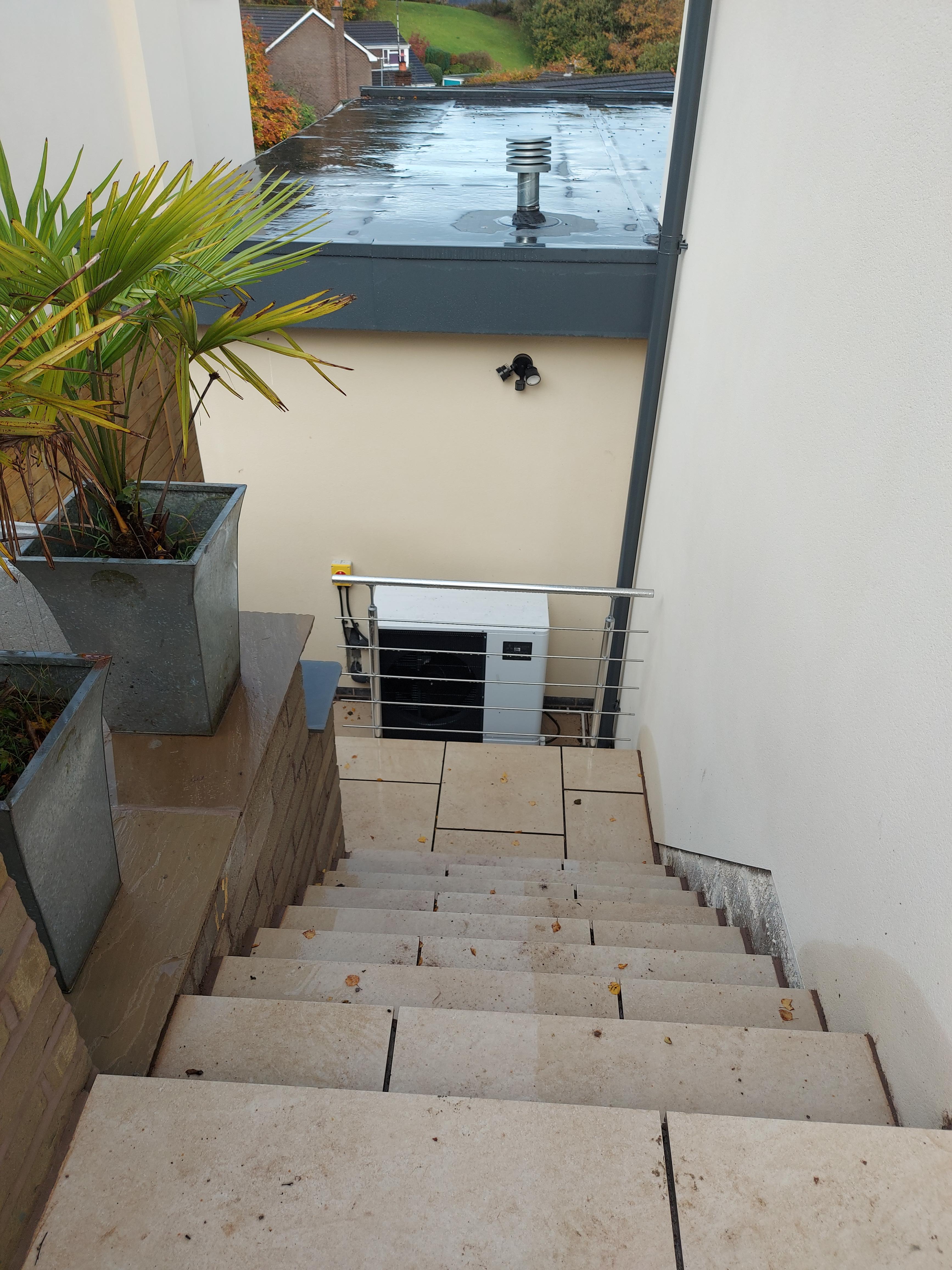

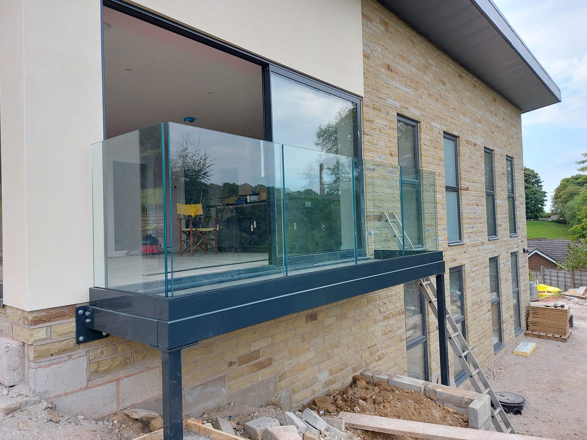

It's the air source heat pump. There is a greater distance to the landing wall than the picture suggests and distance to it was OK'd by the installer. -

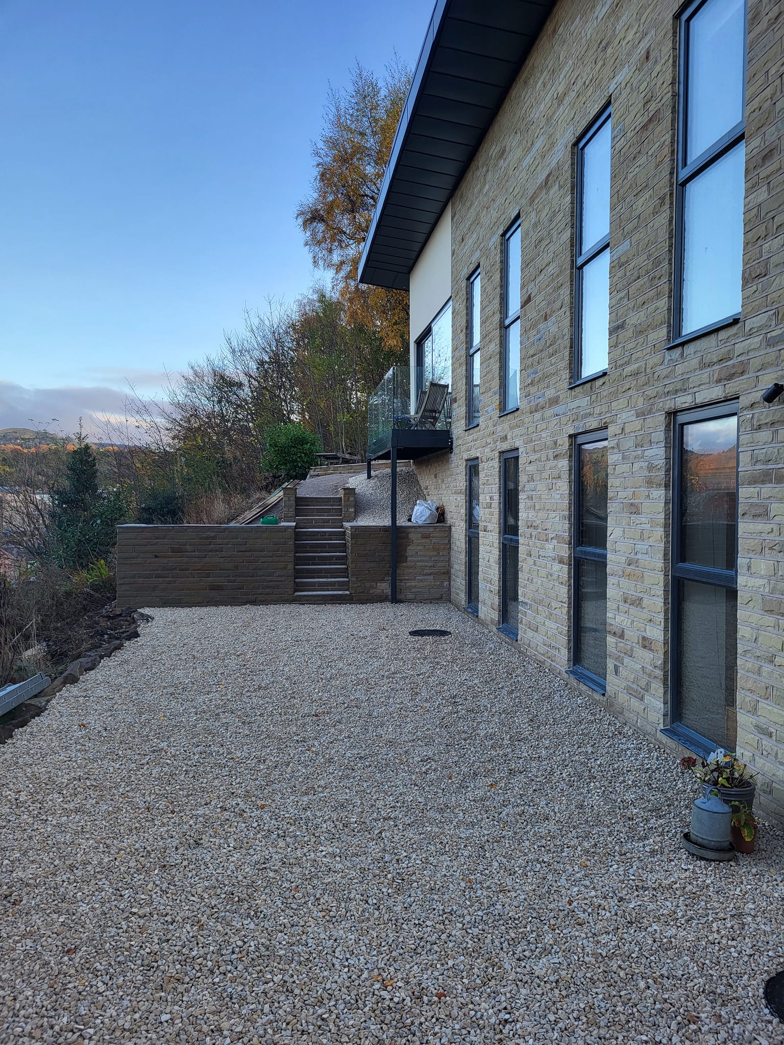

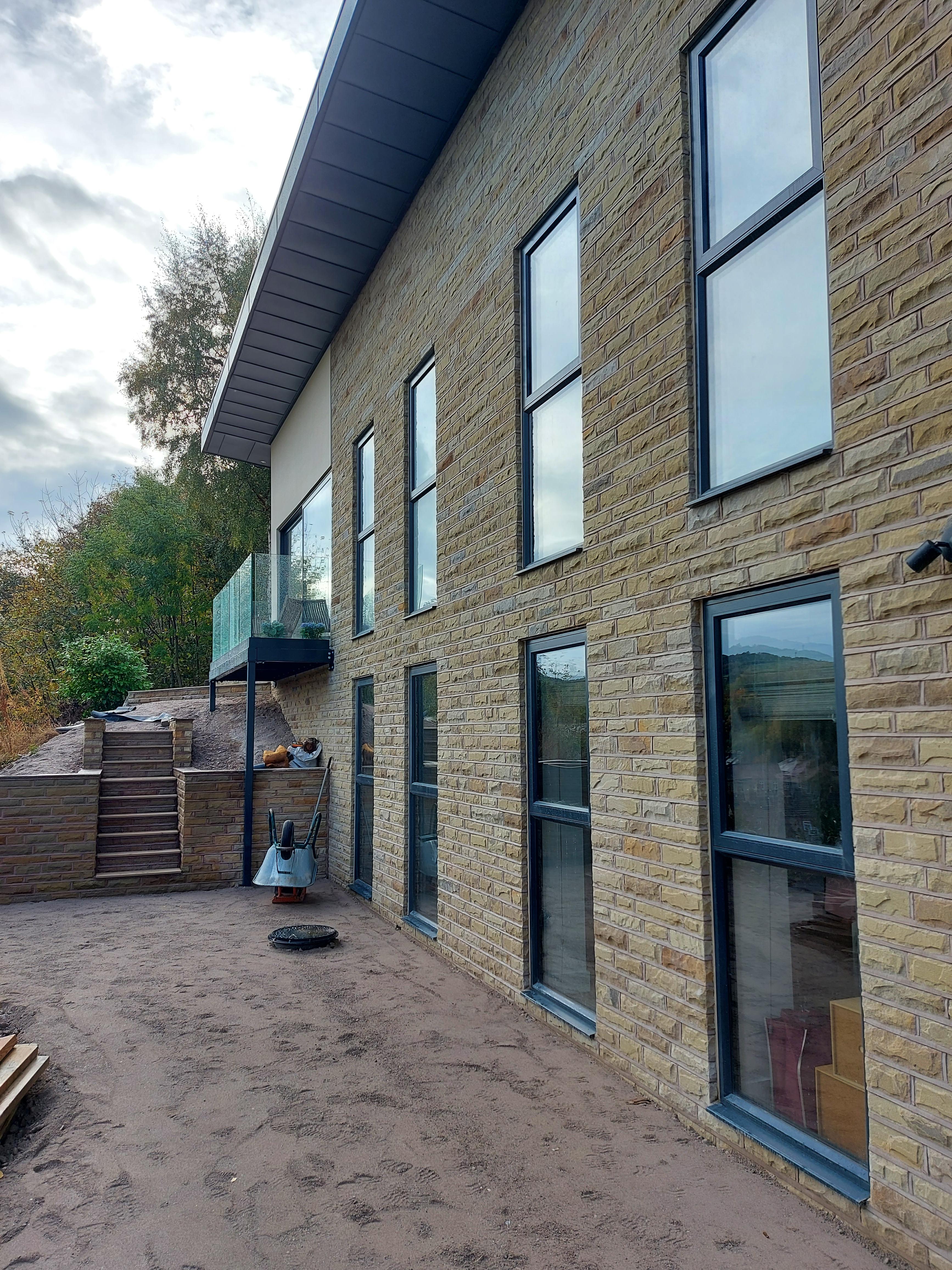

Thanks for the positive comments. I wanted the house designed that way to take advantage of the height and view from a large kitchen/day room. Living on the plot for 21 years gave me plenty of time to mull over exactly how the new house should take advantage of the views. The build into a hill was not as bad as may seem - the site is within an old quarry that was first developed in the 1970's. Luckily we had enough land to the side of our original house to build a new one (with the assistance of demolishing a large unused annex - ex swimming pool). Two levels of raft foundations 200mm think in concrete. The build itself was relatively stress free baring the utility companies, a neighbour and the prolonged sale of our old house due to the buyers panel conveyancer being a nonce!! I'm relieved though that it's coming to an end having project managed. We will be 20% over budget; some of it down to material increase costs, some not compromising on the look of the building and some down to more time than anticipated. We started the demolition in mid April 2021. Would I change anything significant? No. Would I do it again? The current thought is no but as I can start relaxing a bit more if the opportunity presented itself maybe but as a turnkey where I do not have to do the project managing. Appreciate all the assistance on here - it's a brilliant forum with a wealth of knowledge and good banter. Cheers from the Happy Valley!! PS: the cushion is the dogs bed! -
