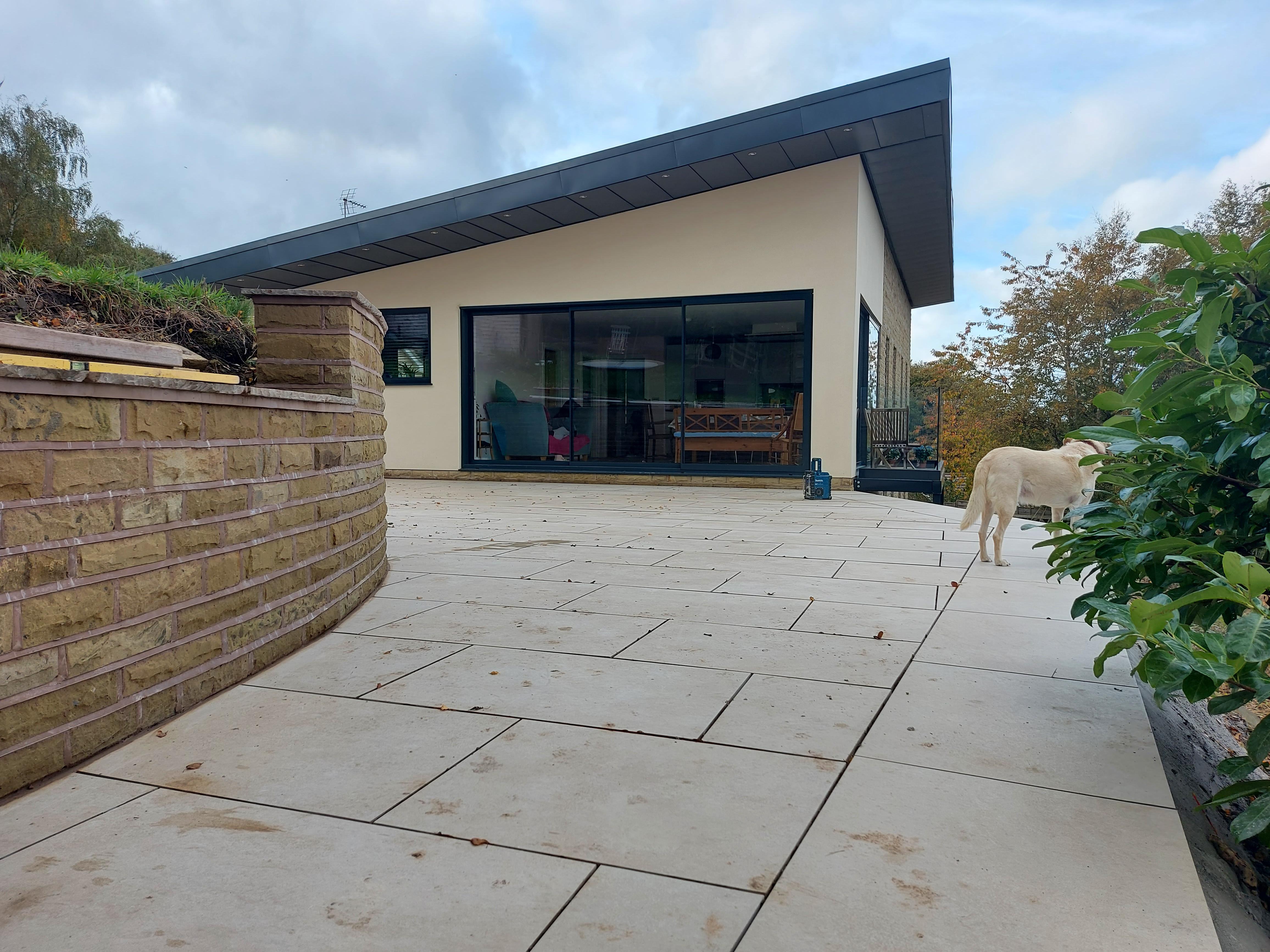

We've moved in and loving it!! Old house, adjacent, completed sale yesterday so can now pay off the build debt. Getting used to running ASHP and MVHR but no heating needed so far. Here's some pics
